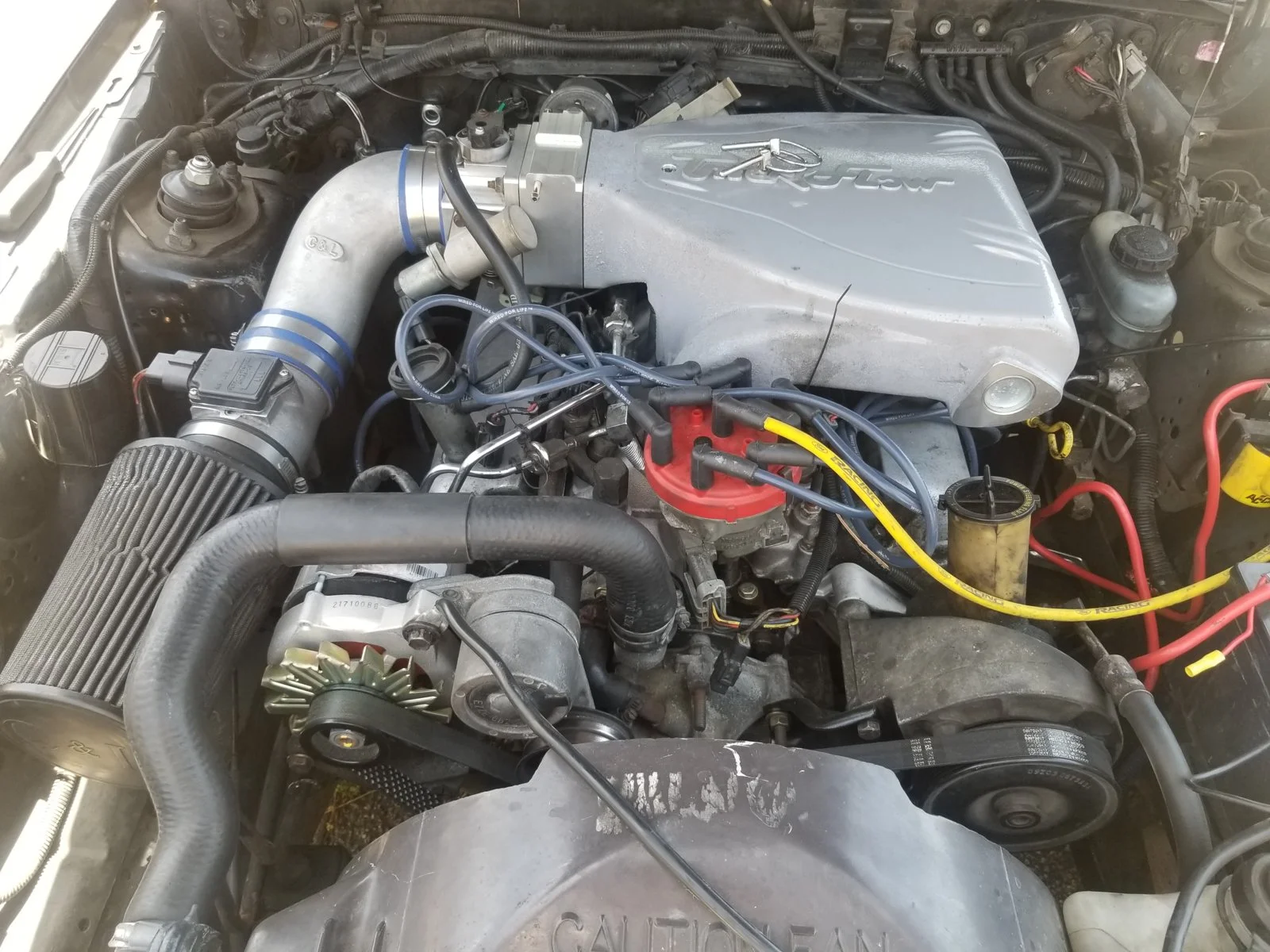

I currently have an 89 5.0 with a F Cam stock 302 block headers exhaust pulleys Gt40 heads Brand new 24 pound fuel injectors,brand new fuel regulator, brand new upgraded field pump and and street burner intake manifold with 75mm throttle body and 75 c and L maf qnd a custom tune from American muscle!
I have a 1989 5.0 stock 302 block with A F Cam GT40 heads exhaust pulleys herders 24 pound fuel injection brand new brand new fuel pressure regulator brand new upgraded fuel pump I have A 75 MM C and MAF And A75MM throttle b ody with a trick flow street burner and take Running 75MM! The problem started when I put the new intake on The check engine light flashes on and off M when it does Flash on the car loses power and the rpm drop but the card does not die and since then my feel pump will not work like maybe there is a short somewhere so that's when I put in the new field pump and it ran good for a little bit, I was wondering if anybody ever had the same issue if I am running too much air to the motor should I be running a Turbo or a supercharger what that in take just looking for opinions I also think it might be the fuel but I also did just buy her a new fuel injectors 24 pound! If anyone could please help I would much appreciate it or even a mechanic I'm located in Monterey California

Sorry ment to be a little more specific, I put the parts on, the maf sensor came with the c and l tube its is supposed to be calibrated to the my 24 lb injectors, I I have GT40 heads they are not ported, I was running A GT40 explore intake manifold on the car and it ran fine once I switched over to the trick flow street burner intake manifold it opened it to 75mm and that's when I started having issues

I have the trick flow street burner intake and I bought the custom tune from American muscle I told them my set up and I plugged it into the chip and I bought a new fuel pump relay because I started having issues with fuel pump coming on and off and had my buddy test the inertia switch he said it was getting power, when I start the car it idles good like it's getting a read on the computer but then when I start driving the checking engine light comes on then I lose power but the car doesnt die and it does it so much to were I cant drive the car, do I need to pull the codes if t bought the timer chip? If so I can tomorrow

Yeah I heard bad things about the C and l meters myself I have a stock one I believe I could put on their instead..... The tune i got from American muscle is tune for 24 pound fuel injectors, The fuel pump isn't turning on either all the time I think I might have a short but I have power going to the and enertia switch, Do you think if there was a short some where in the field pump wiring it could cause the check engine light to come on and off and me to lose power when I drive?
