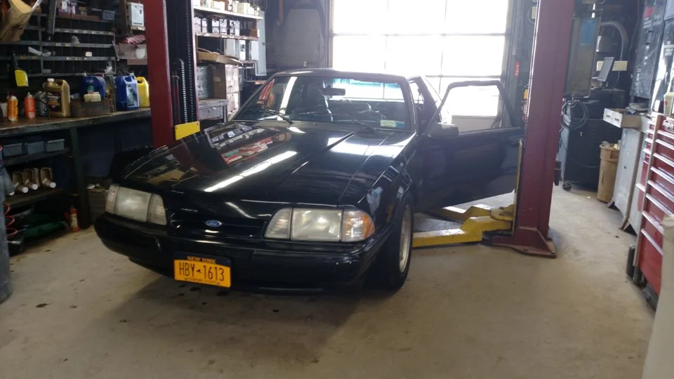

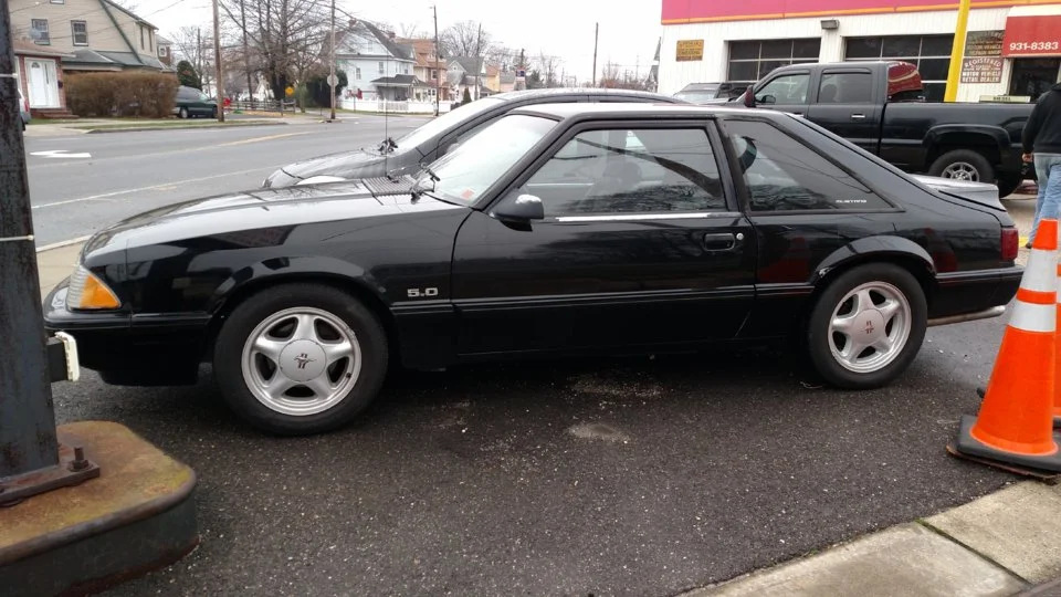

Hey guys, I figured I would start a progress thread in order to get some advice/photo documentation/etc. I picked up the car at the end of December, 2015. This will be a build that progresses as money, time, and craigslist findings allow. Here it is on the first day I got it home:
it needed a little TLC and some trim paint but I think I got it for a decent price. It had shorties, a very hacked up X pipe, cheap mufflers and cheap tails. Broken driver mirror, broken pass door handle, blinkers didn't work, radio didn't work, the SPOUT was missing, and it needed new rear tires. Also had (and still has) lowering springs, MSD coil, BBK CAI, BBK 70mm TB and spacer, a yellow top that wasn't strapped down, and some underdrive pullies and that's about it for the mods. It even had the smog pump still. Pulled it in the shop a few days later:

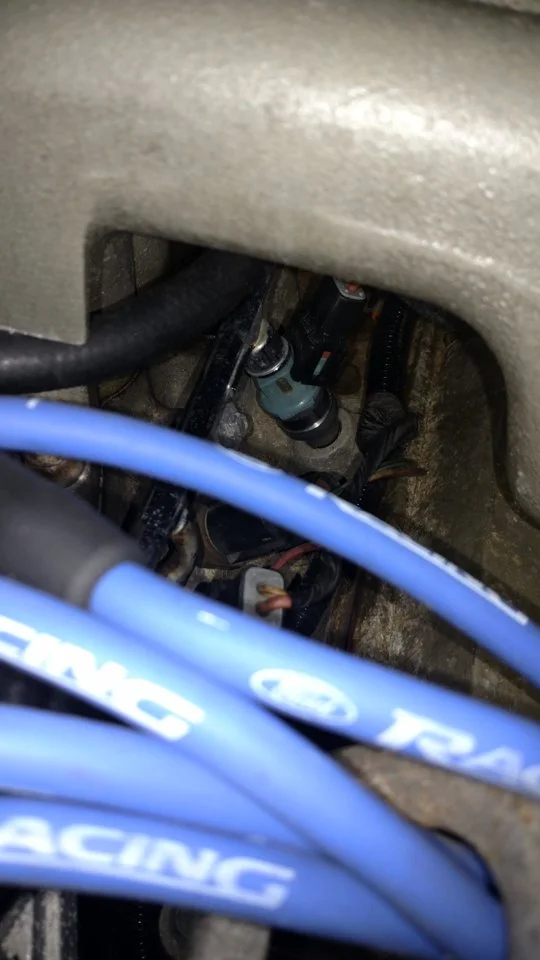

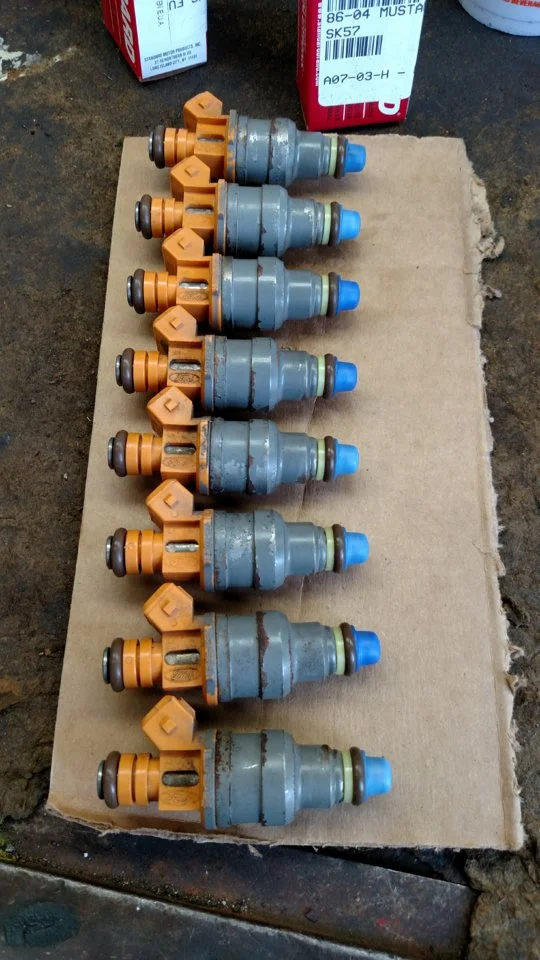

Remember that off-idle bog from before? This was why:
I'm not sure how 24 lb injectors ended up in there, and I probably don't want to know lol. Used stockers from a local guy for $40 and new caps, orings etc:

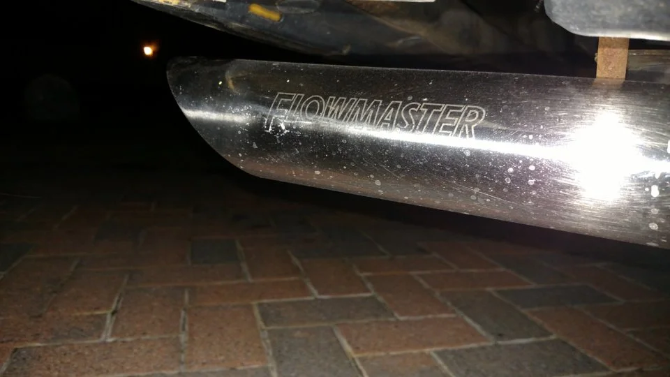

Runs WAY better now, obviously. I also added a SN95 MAF while i was at it. I picked up a nice 2.5 OR H-pipe and a flowmaster catback with stainless tails from craigslist. Crappy night pic, but I love the etching:

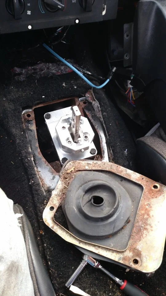

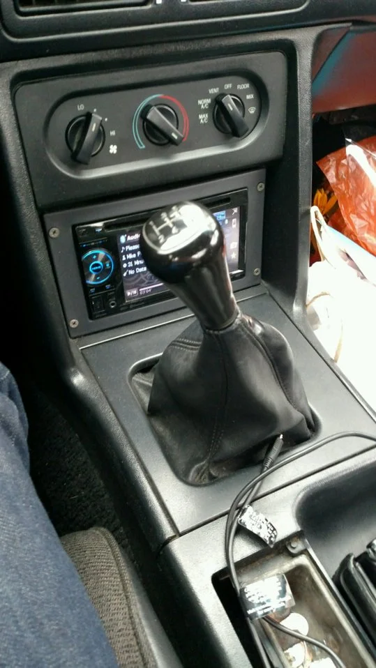

It also got an e-bay find Down's shifter. I don't have a pic of it, but I fixed the boot with LMR stuff later on.
And a Pioneer radio I had laying around from my old pickup. The stock premium radio wasn't putting out any sound. The screen is useless but bluetooth audio is nice.

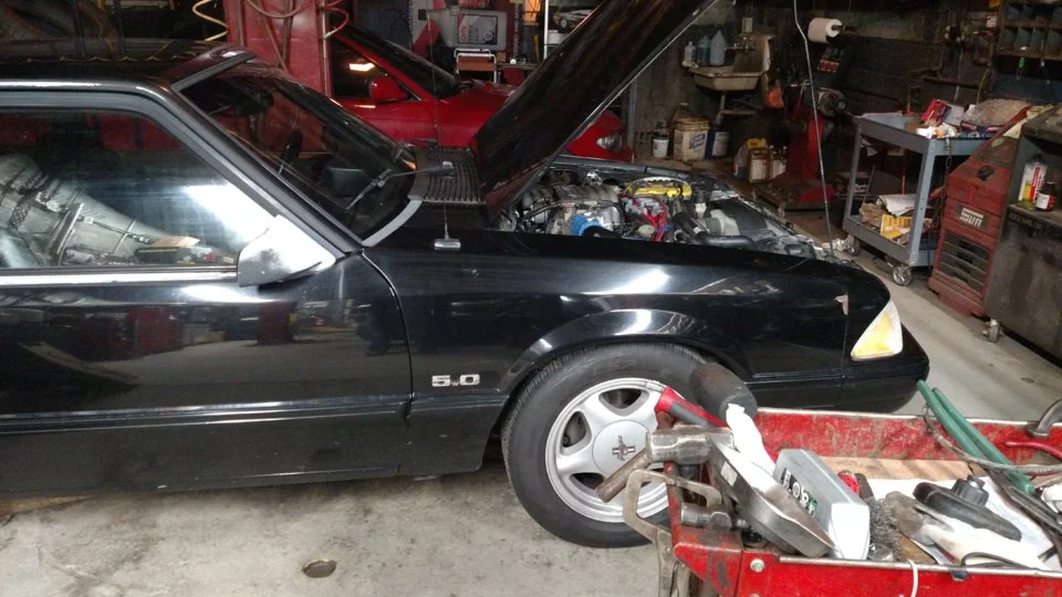

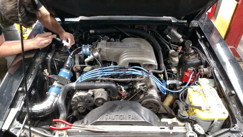

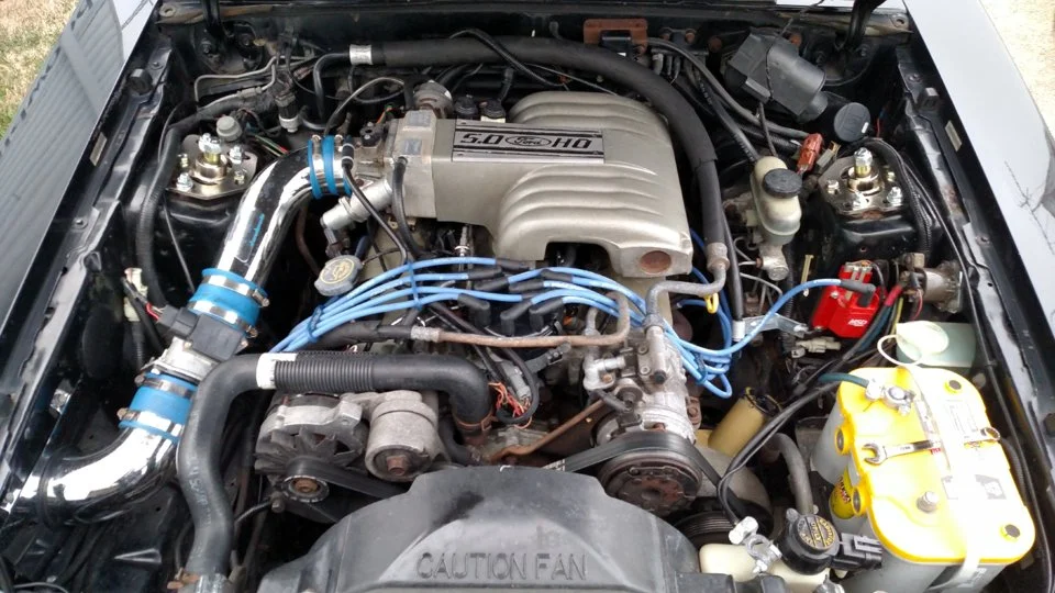

To skip forward a bit, the struts and shocks were, I think, original OEM pieces. I picked up some KYB stuff for pretty cheap. I only got the struts installed with Steeda CC plates, and all aligned. Here is the engine bay as it sits now:

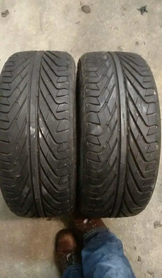

These Michelin pilots were listed on CL as 255/50r16 so i figured they were perfect for the rear. My friend grabbed them for me and they turned out to be 225/50r16, so on the front they went.

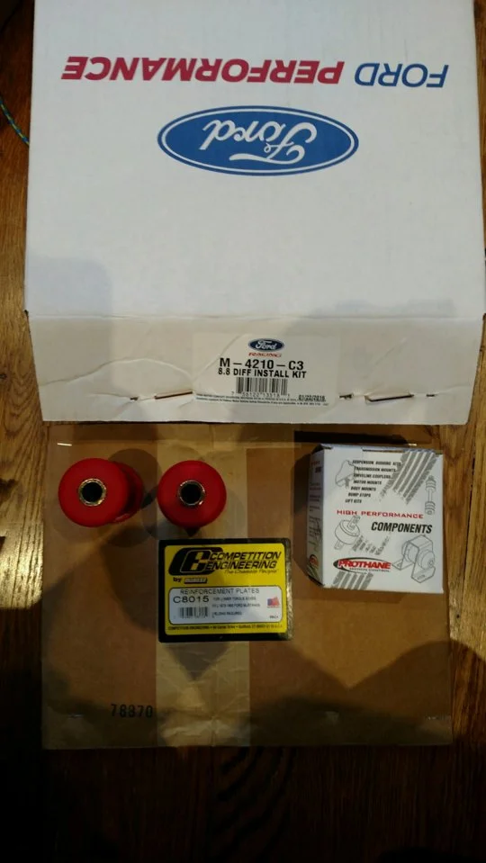

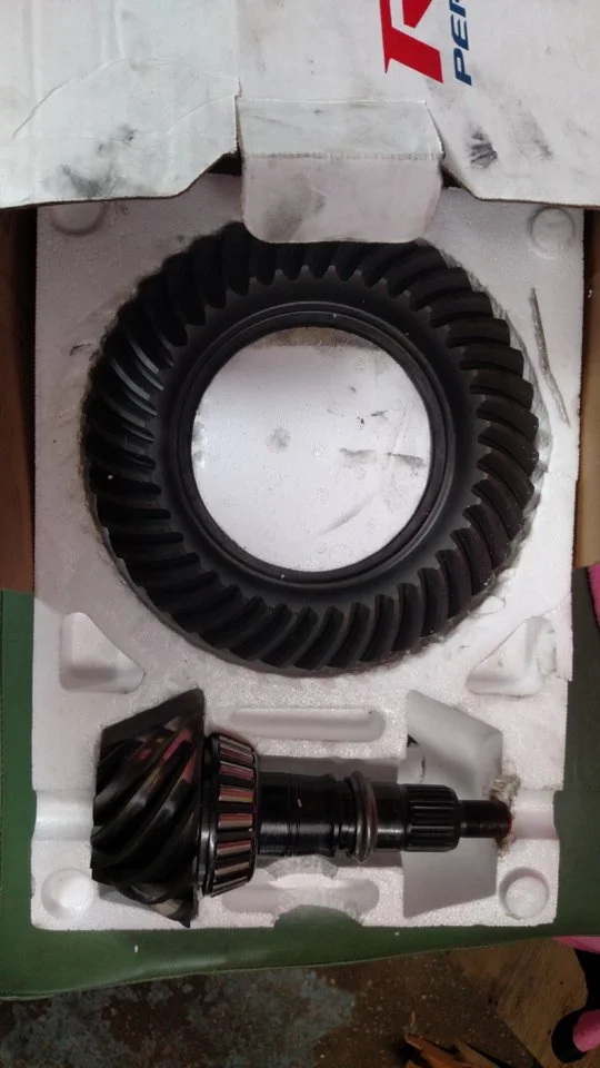

I also scored a lightly used set of FRPP 3.73s from CL. Picked up a gear install kit from LMR and my buddy had a new set of standard traclok clutches that he gave me. I haven't had the chance to install it all yet but it's on the list. Also have some weld in subframe connectors and torque box plates that will go in when time allows

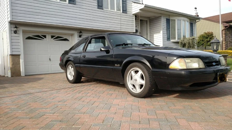

Current pic! i had picked up some belt and drip molding from a local guy that parts Fox's. Also grabbed a driver mirror. Painted it all up with some flat black. I also have new headlights from LMR that are waiting to be installed as well.
last weekend I did both door lock actuators, both sides window bushings, and did the passenger door pins. those were a b*tch and I ran out of time to do the drivers side. Also slapped on some new door latch bushings. All of that really tightened up the door rattling
