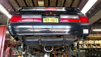

In case anyone didn't see it on the other thread, here's a pic: FB_IMG_1474884410443.webp

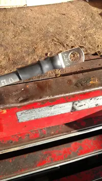

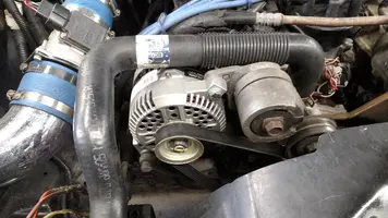

I also picked up a 3G alternator and all the parts to make it work.

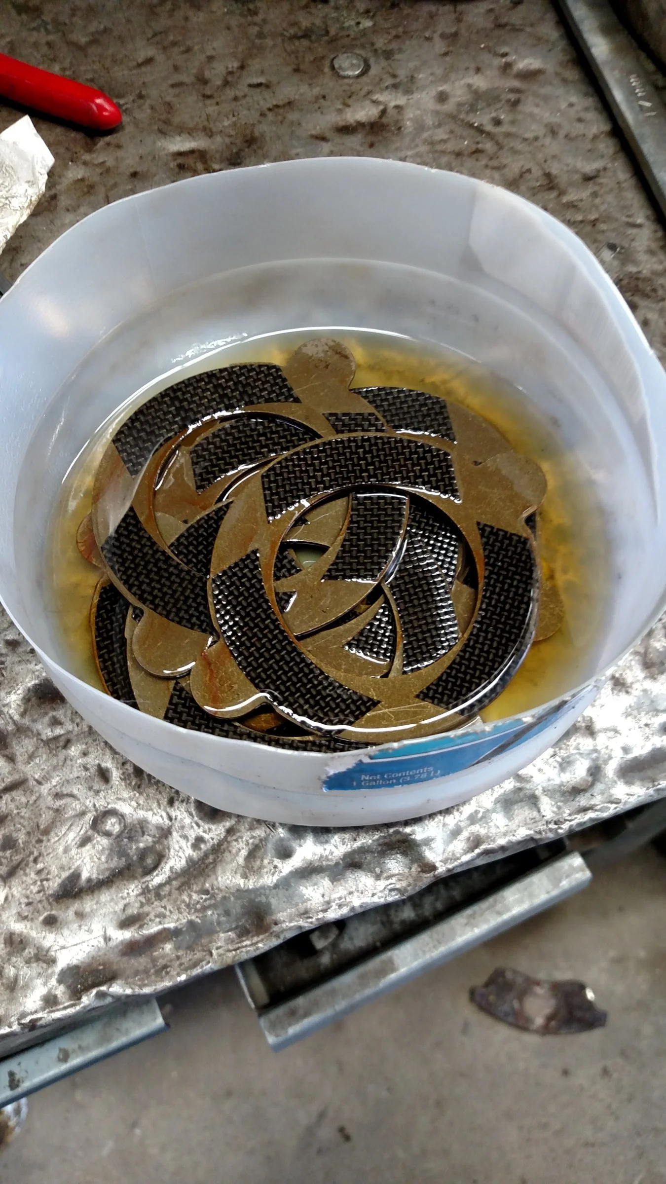

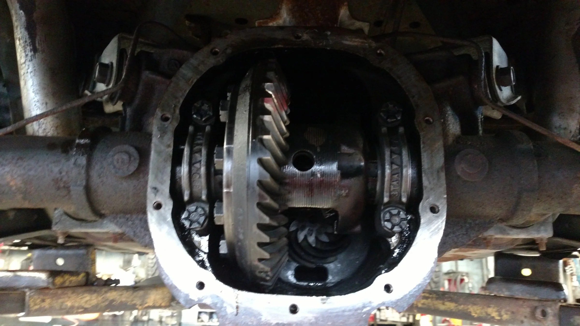

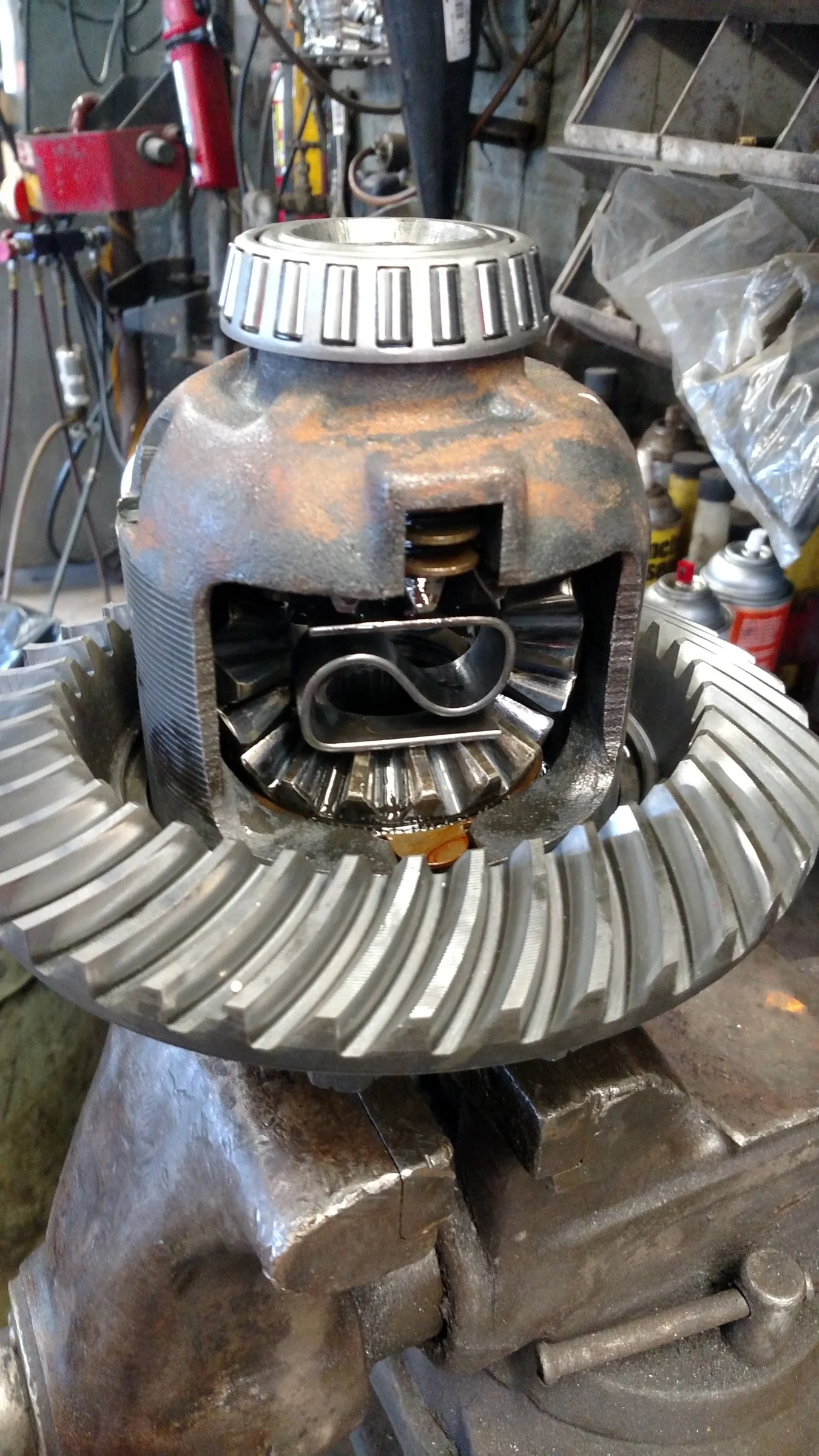

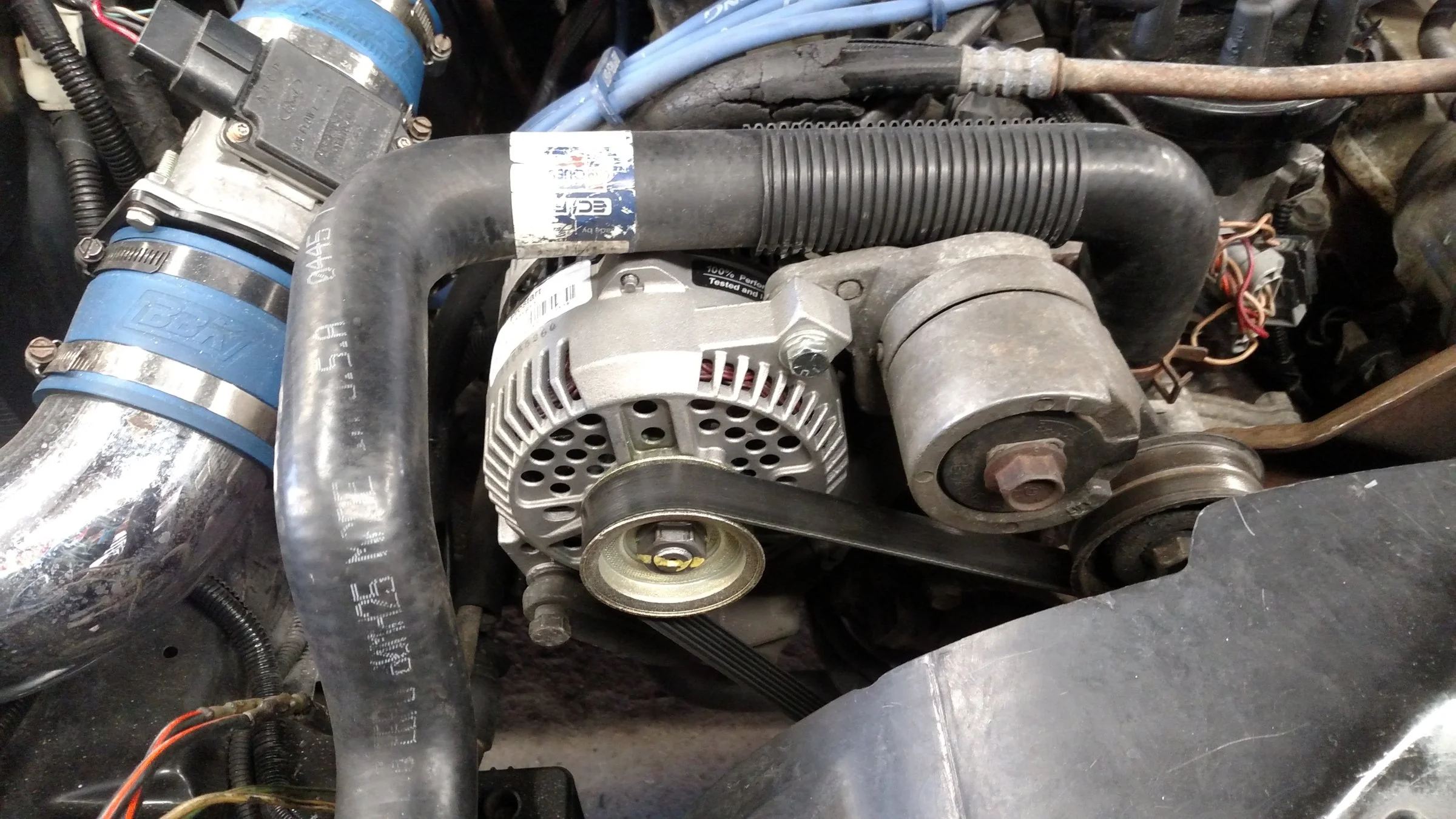

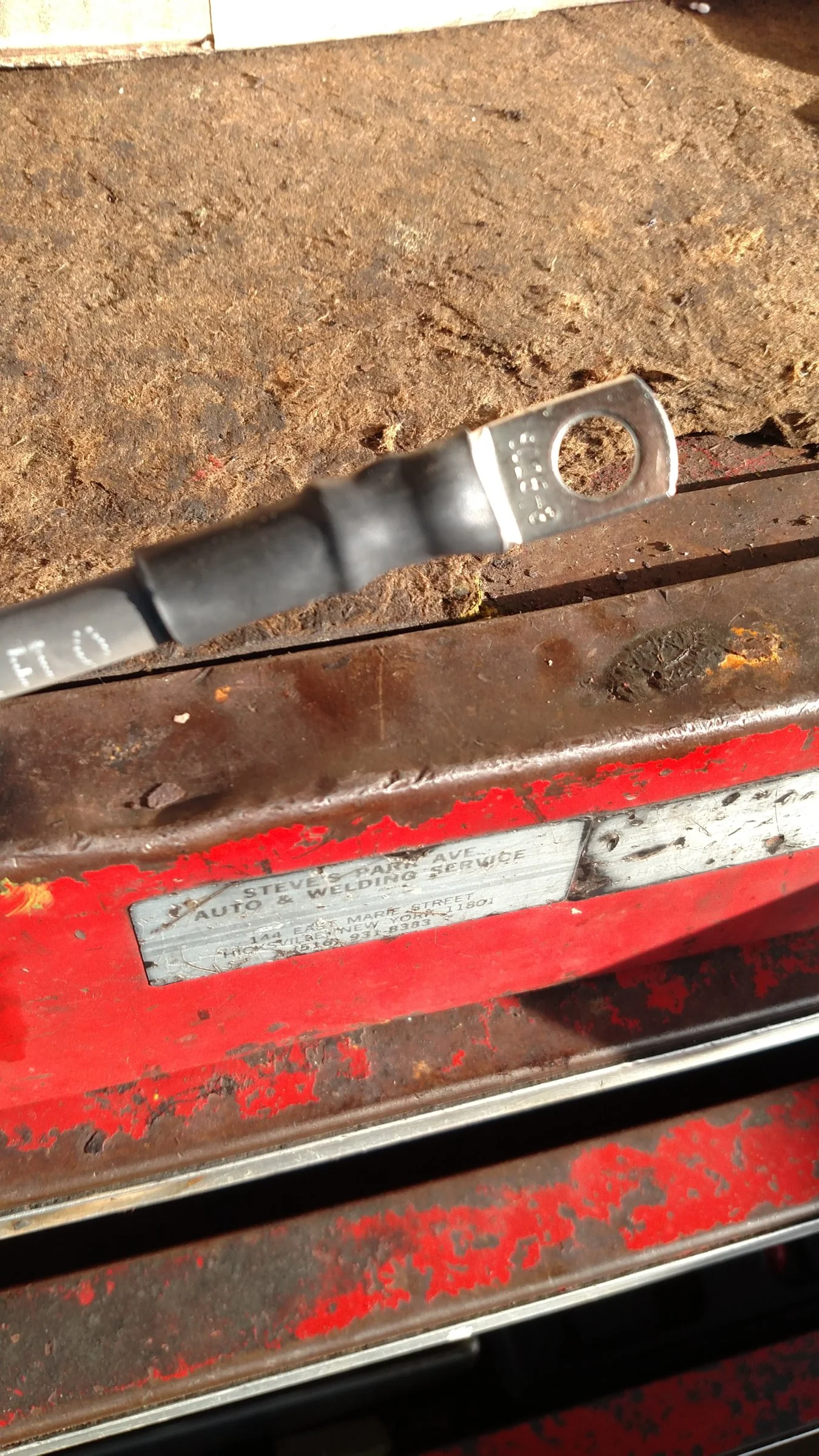

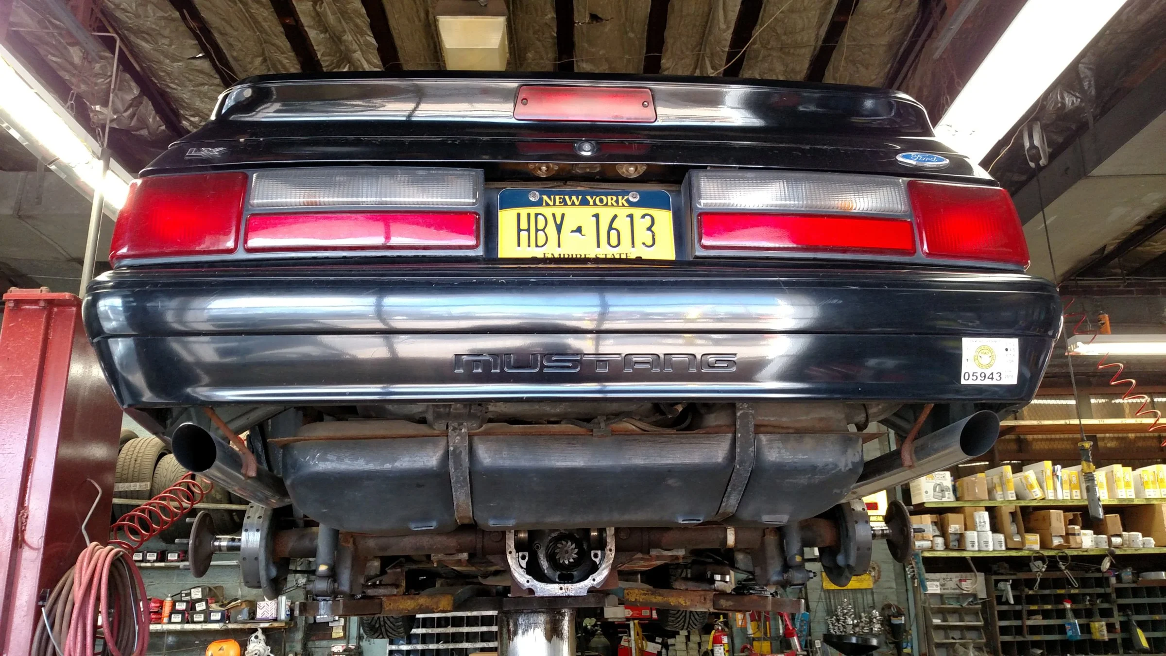

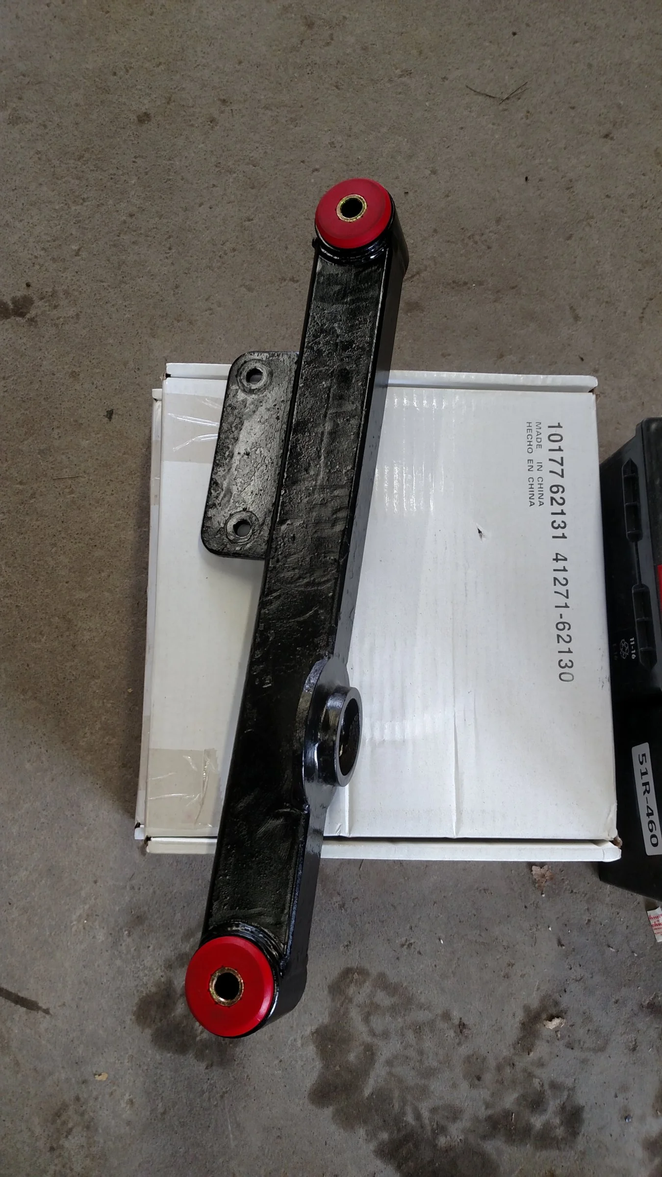

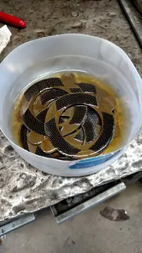

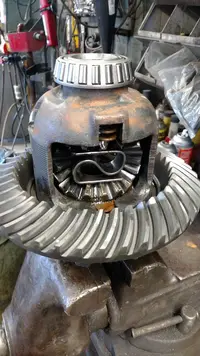

The Mustang got some love this weekend, finally! Full rear end rebuild including new bearings, seals, 3.73 gears and carbon trac lock disks. I also did the 3G upgrade with a 4ga power wire. I started doing the rear control arms but only got the lowers done. Older Hotchkis arms that were given to me by the previous owner, but resprayed and fresh bushings. The driveshaft front u-joint was pretty shot so I swapped that out too, but the vibration I had at highway speed before is still there, and much worse now. I'm thinking a new aluminum driveshaft will be on order in the spring.
The gears help a ton though! It feels like a new car. I can also have the headlights on and the hvac fan on high at idle, and no charging issues.
The car is going into storage in a week or two for the winter, so I won't have it out until mid march or so. At that point I'll finish up the control arms, put in the subframe connectors, and fix a few odds and ends on the interior (mainly ash tray door fix and bypass the stock amp). If I'm still feeling adventurous after that I'll look into a head and intake setup, or maybe a vortech if one pops up on CL :)

Also, the S spring that came with the trac lok rebuild kit was HUGE, much larger than the original one. I ended up reusing the original one because I didn't think the big one would fit. Did I just not try hard enough?
In order to get the new s-spring in, I used a bench vise to compress it and then held it closed with some vise grip pliers. Someone here might have a better method, though. The downside to doing it that way is the pliers will leave some scratches on it.
That's a good idea! I used long needle nose and stuck it through the carrier and squeezed the spring and pulled it through, while pushing through the back. The new spring was too tight to use that method though. I did use the old shims that were in there (.045) instead of the new shims that came with the carbon disk kit (.030). The spiders went in nicely though.
A lot of guys use a truck S spring as it is beefier than the Mustang one. Old skool trick. I use a hose clamp to tighten down the S spring and then just cut the hose clamp after installed.
Thanks for the responses guys. I was searching on American Muscle and ran across this on the description of the FRPP carbon disk kit:
Complete Kit For 31-Spline. This complete kit includes the clutch pack, shims, s-spring (31-spline), and an instruction sheet so you'll have everything you need.
Technical Note: 28 spline Mustangs will require use of a 28 spline S-spring (not included).
i read the same thing in the instructions when i did mine not long ago. i also re-used the old S-spring. mine has been fine and it locks up better than it ever has.

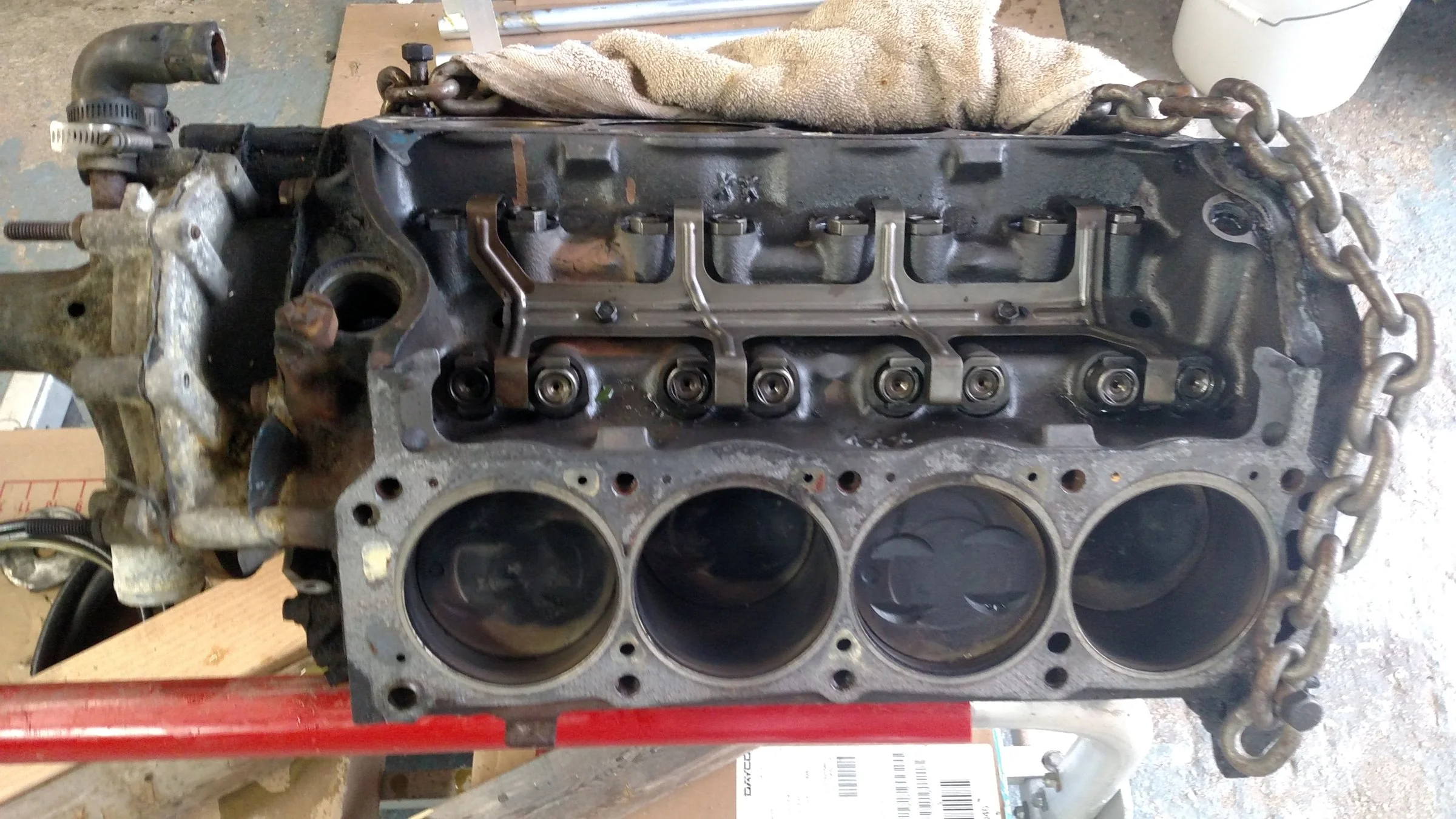

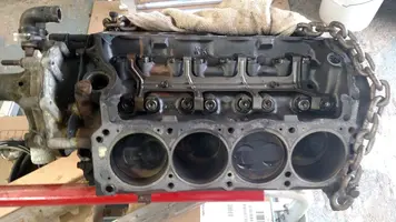

Ok keeping this thread alive! Parts have been slowly trickling in as budget comes available and LMR sales pop up...new BBK headers, TFS spring kit, bunch of gaskets. Still need to order a few things but the big one is I'm going to look at a shortblock out of a 1990. It's one town over and supposed to be in good, runnable shape and he only wants $250. I can build that up and then swap it into my car over a weekend. Depending on how the cross hatching looks ill decide if i want to go through the effort to do rings, etc. Pics to come!
Not much to look at but here it is. It's in pretty good shape. The guy told me about 100k miles and it still has cross hatch on the cylinders. It has a B cam as well. I'm almost tempted to run the B cam and save my TFS1 for a future motor but...probably won't.
