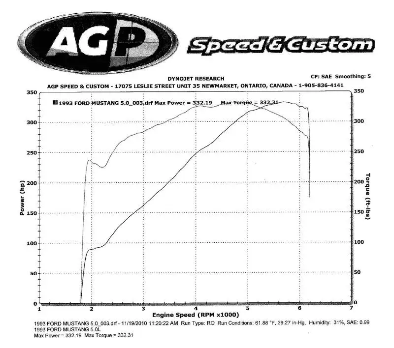

It doesn't take an overly complicated setup to make power, just the right combination of parts and some good tuning. This is an example...
This a 9:1 306
TFS heads (out of the box)
F303 cam
Holley intake
75mm TB
85mm MAF
24lbers
1 5/8 LT's
3" x-pipe w/cats
spintech mufflers
YouTube - AGP Dyno Engine Bay
