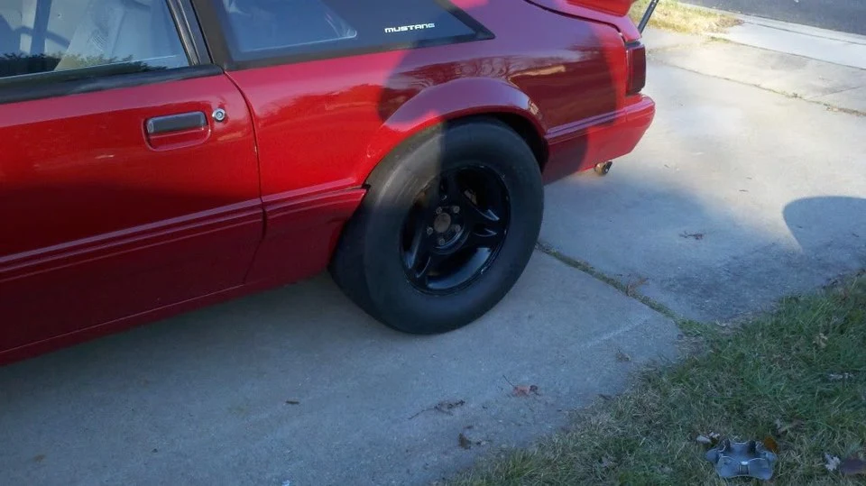

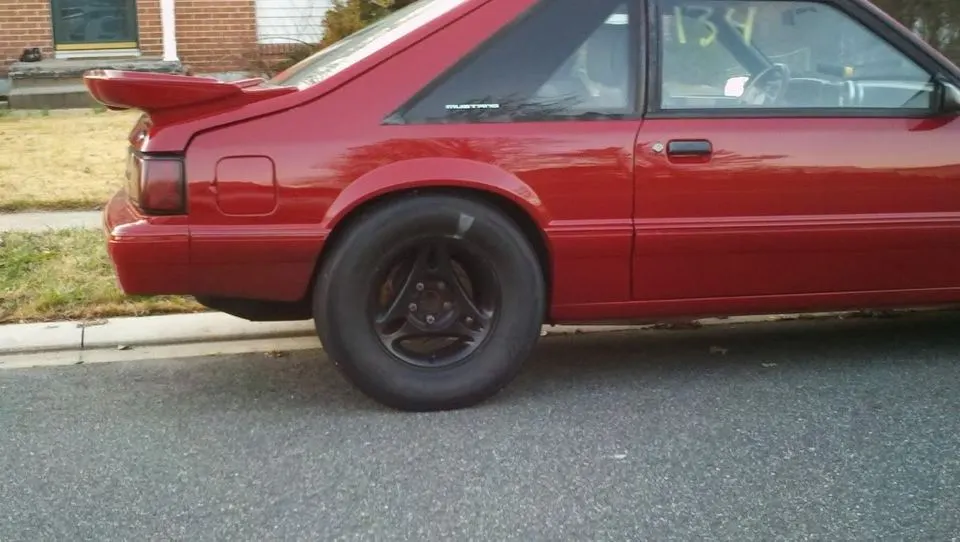

If you cut the ground effects, a 28 will fit.
If you hammer the wheelwells, and roll the fender lip a 10.5 wide tire will fit.
If you do both, you could run a 28x10.5 slick or a 275/60 drag radial

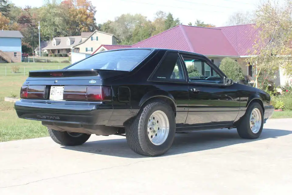

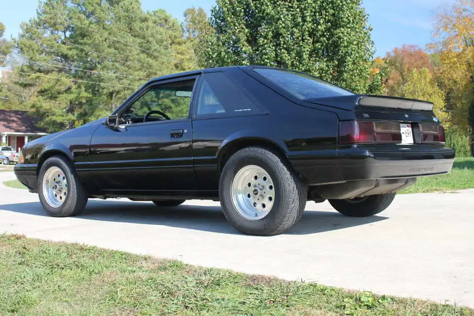

im running a 275/60 with no mods. other then no quad shocks.

After measuring the wheel well, I couldn't get a tire that size in there without the rear ground effects rubbing. How did you get around this?
Im running a 275/60R15 on mine, with no quads and fender lips rolled...The passenger side will scrub on hard bumps.
