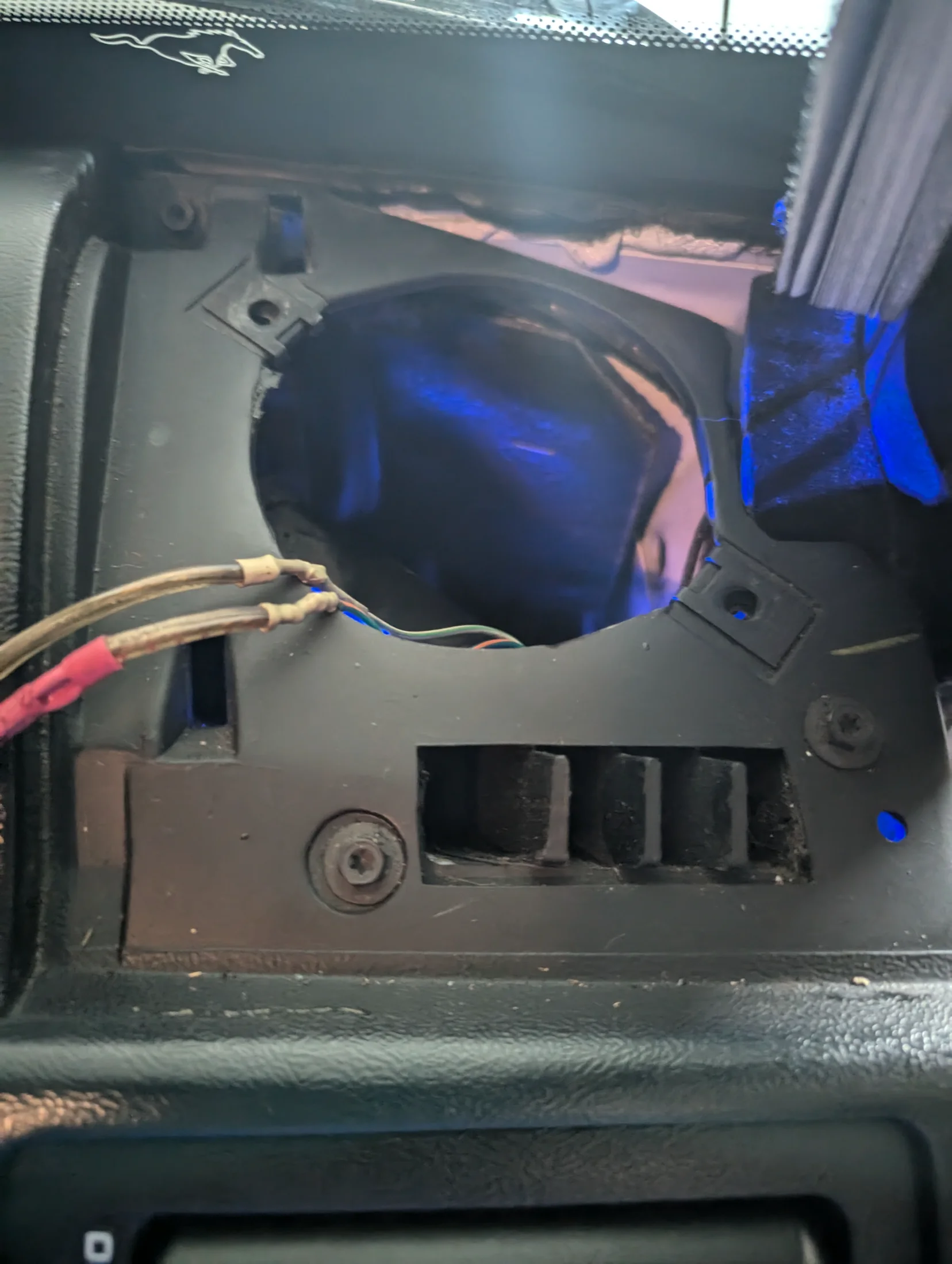

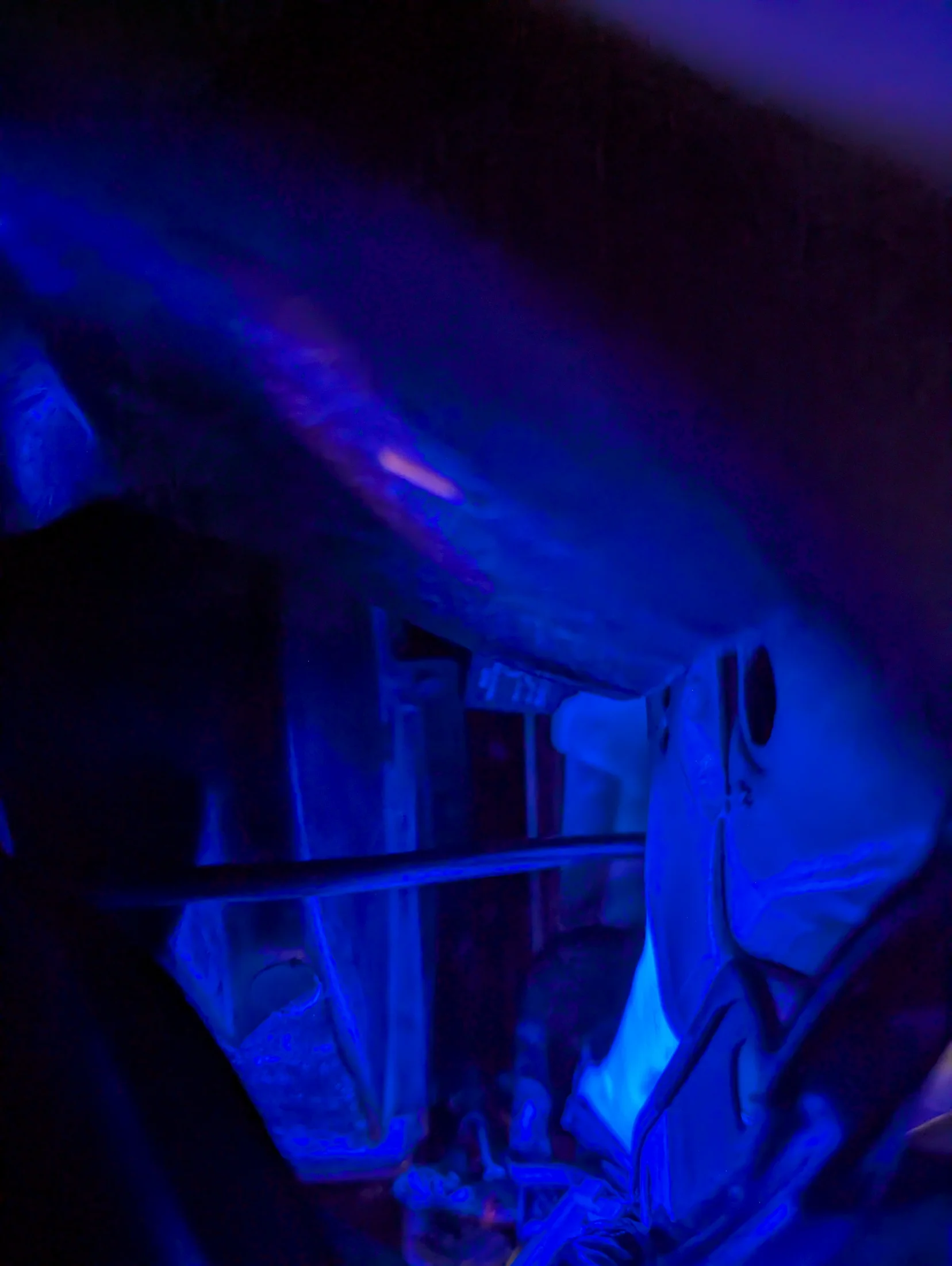

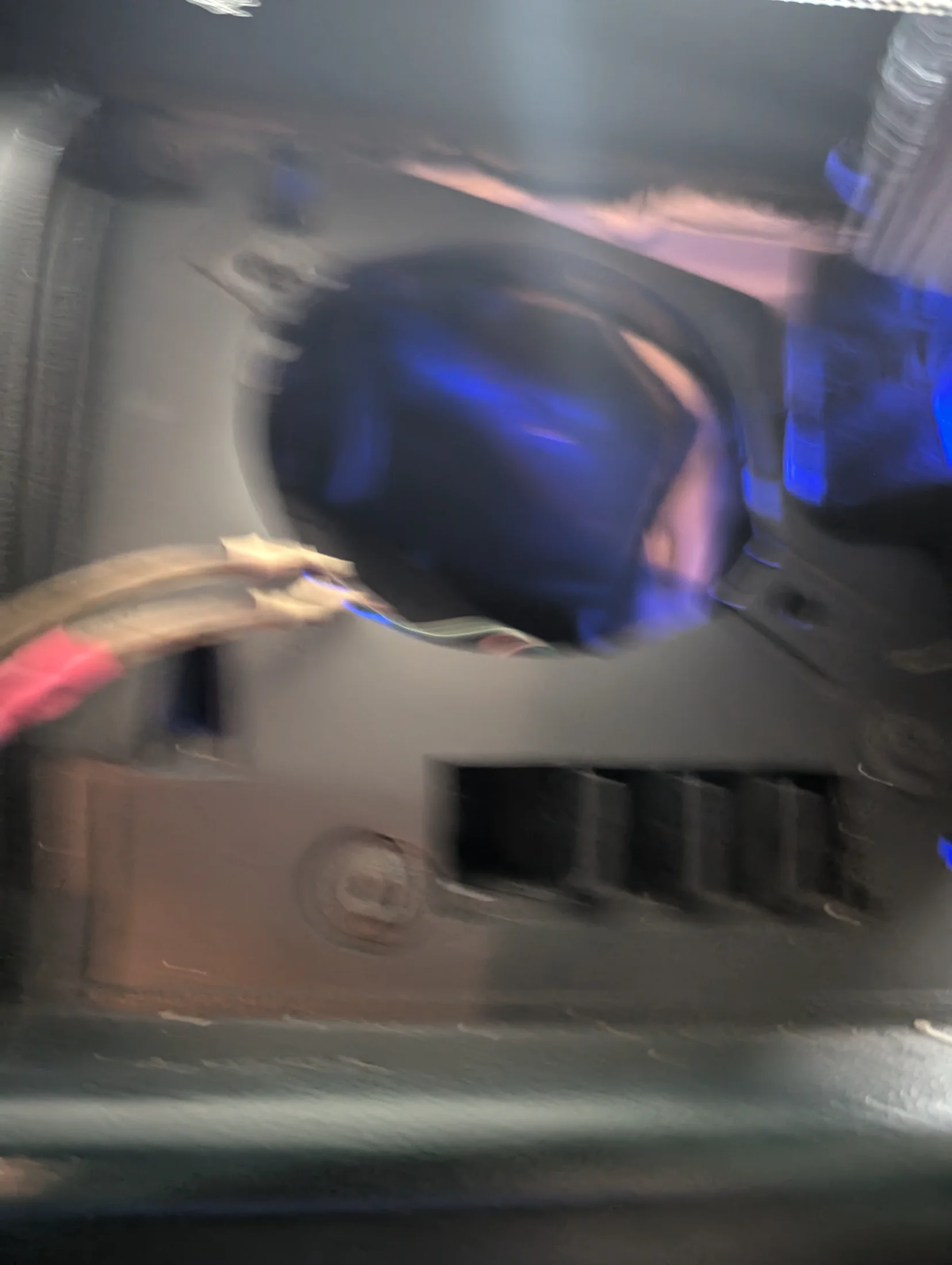

Got home late. I got relay plugged in and left it hanging there for now( getting that awful white plastic plugged back in will be fun).
She started right up and idled till warmed up and fan cycled twice. Too dam tired to put it all back tonight. After work tomorrow ill put some mileage on her and report back, maybe even take pics of the relay location.

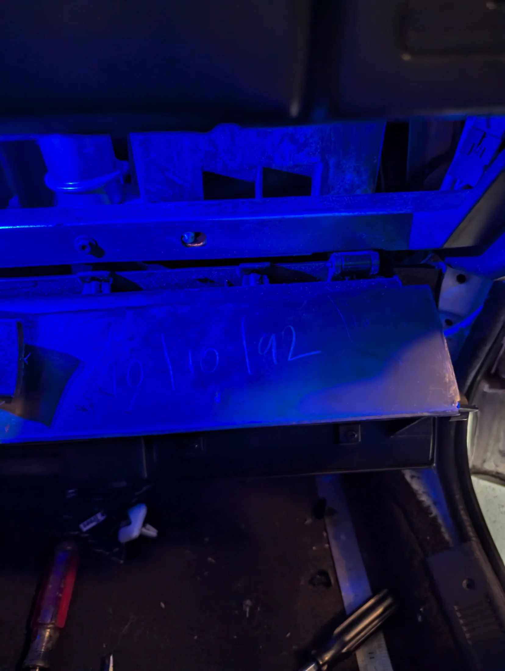

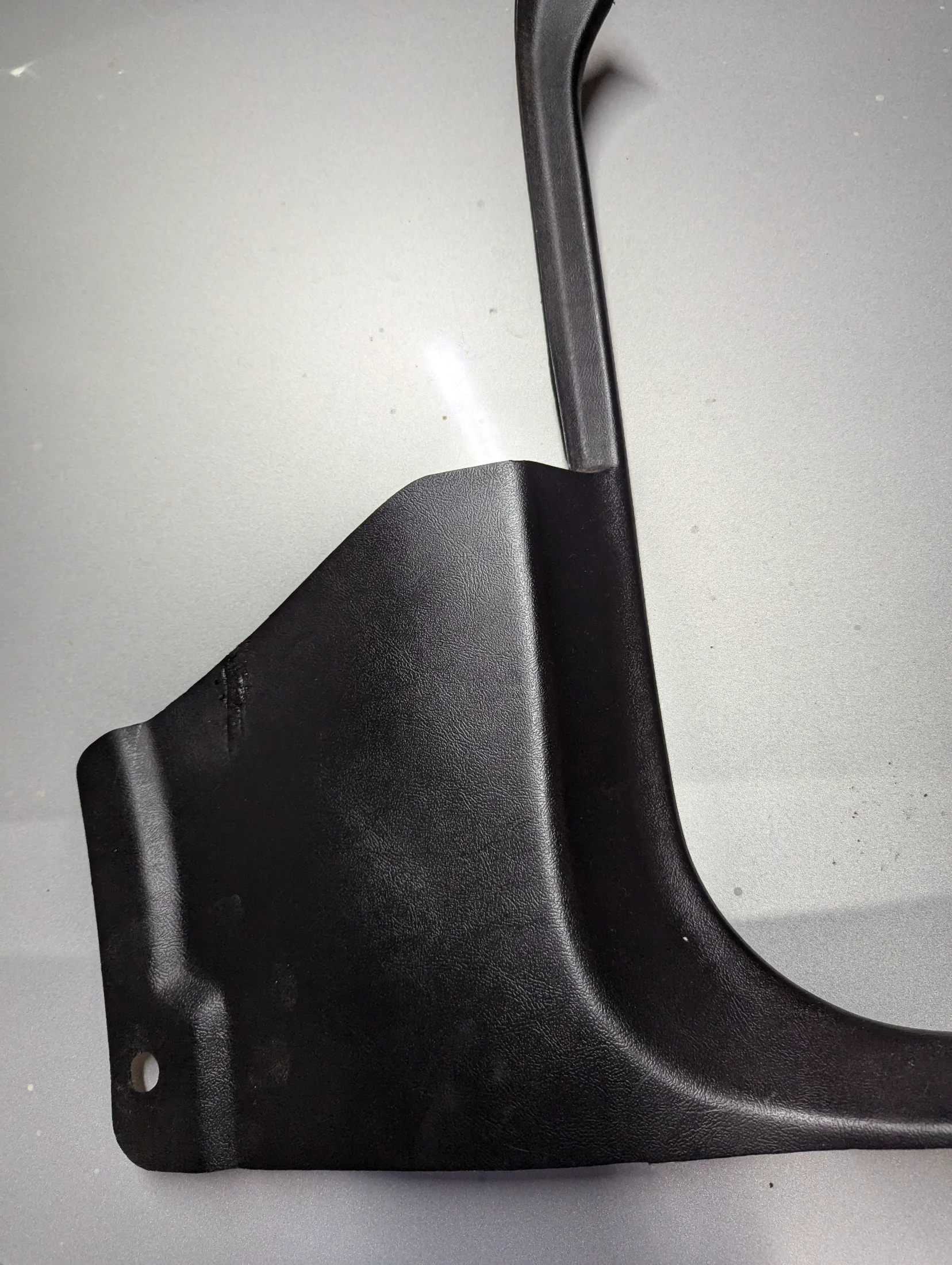

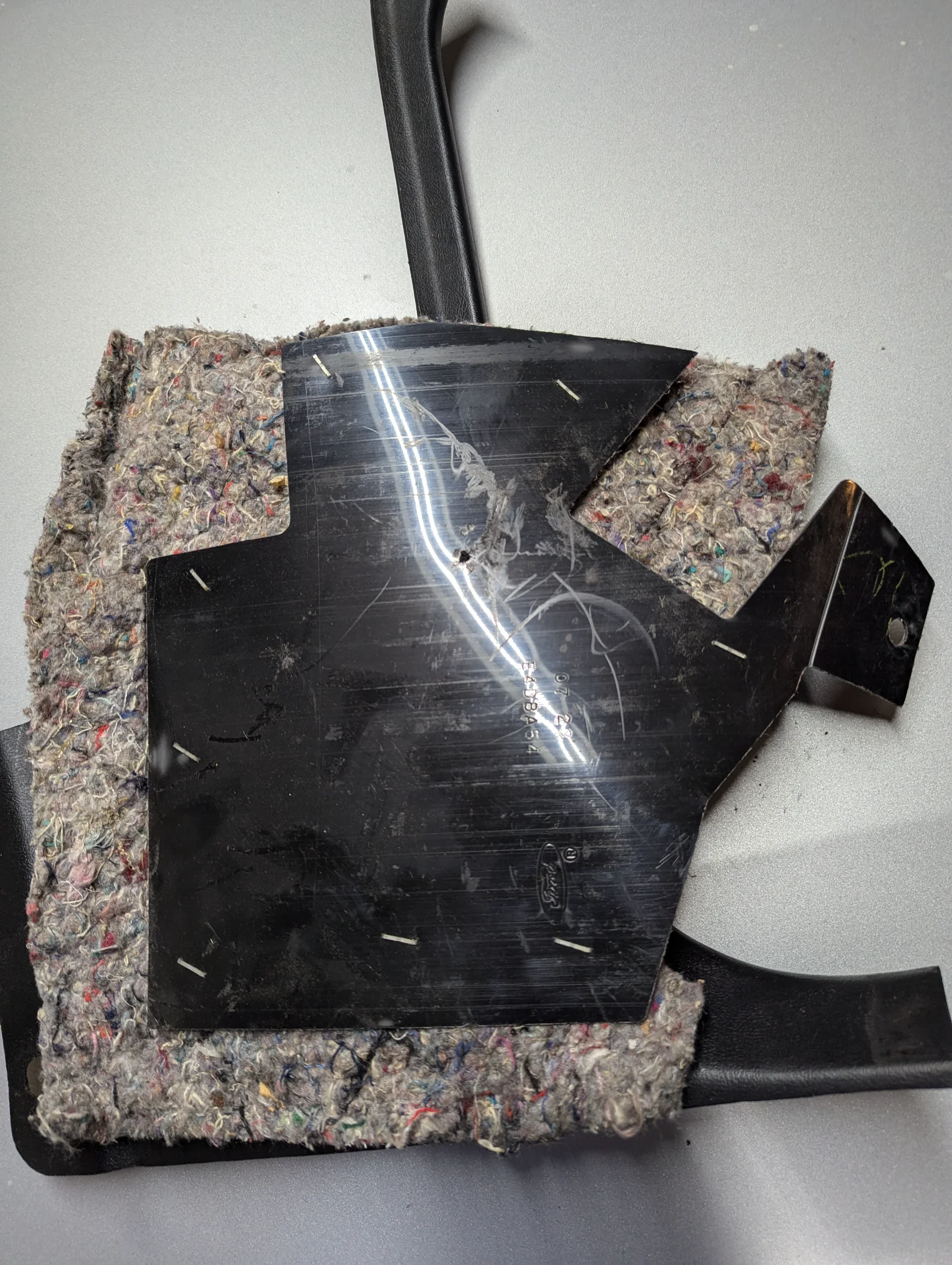

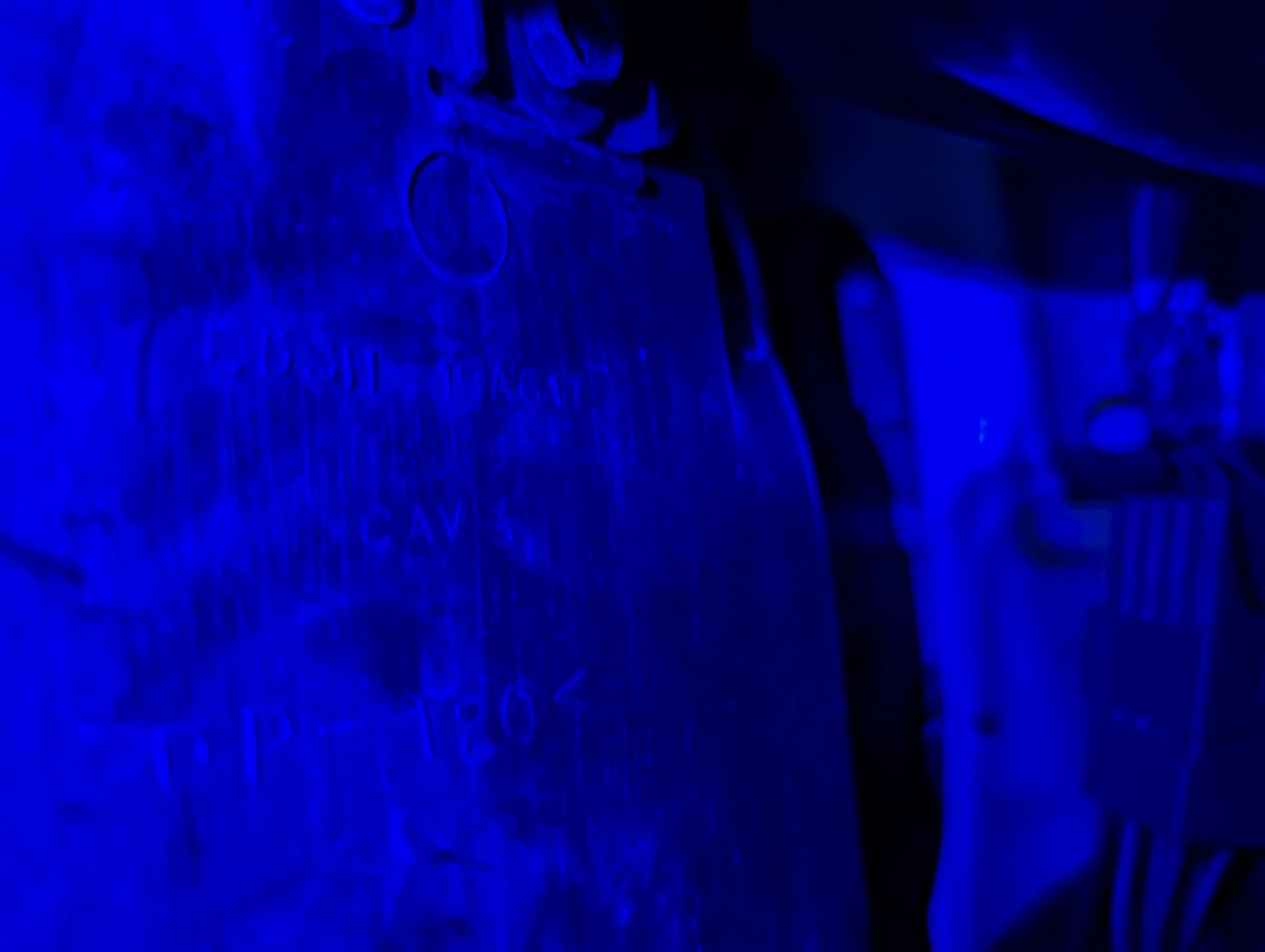

After removeing all that stuff I see my glove box was installed on 10/10/92, and in the last pic you can just see the writing on the new relay(upper right)
She started right up but on the drive up the block she did a stumble on second gear. I checked the ECU going by battery it looks fine but I didn't remove the battery. So I had a known good maf meter so I swapped it out. Drove up the road and no stubles, but back in the garage she idled and had a hiccup, rpm was 800 dipped to 600 and back up to 800.
