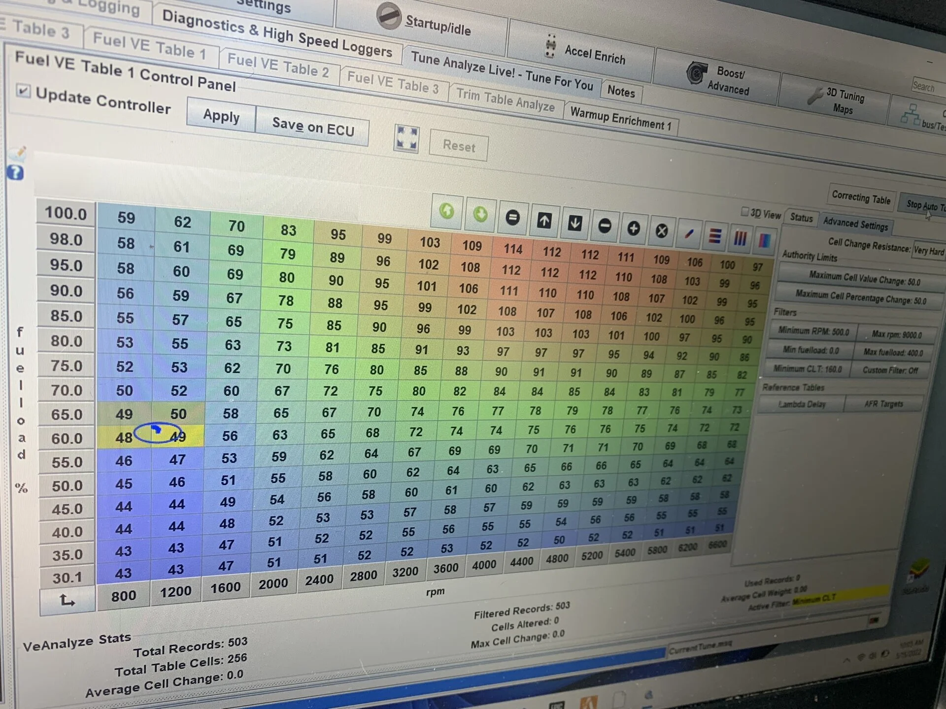

Does this fuel table look perfect?
Please HELP I’m running I’m running pnp2 on a Sr20det Nissan and having some issues…
Car won’t stay in timing ( digitally ) called mega squirt and they said wiring or grounds
Called wire specialties and the said maybe a ground but car is grounded
Checked all the grounds and cleaned and remounted them same issues
Thoughts please !! My tuner can figure it out it’s only his 3rd mega squirt tune
this can be many issues... including having an incorrect edge trigger causing timing drift with rpm.
