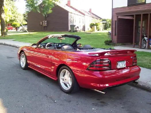

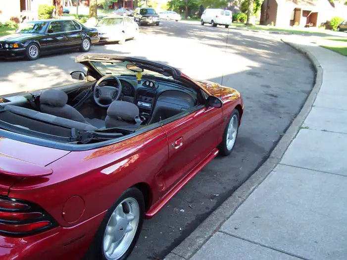

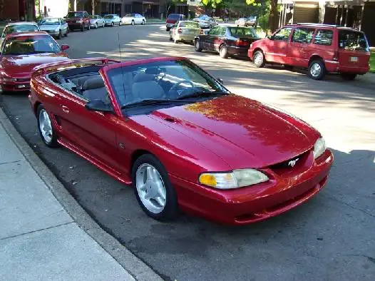

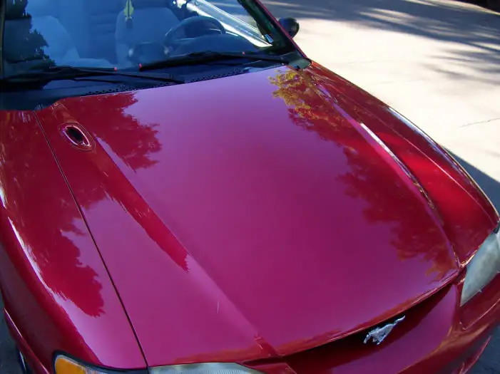

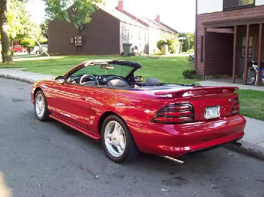

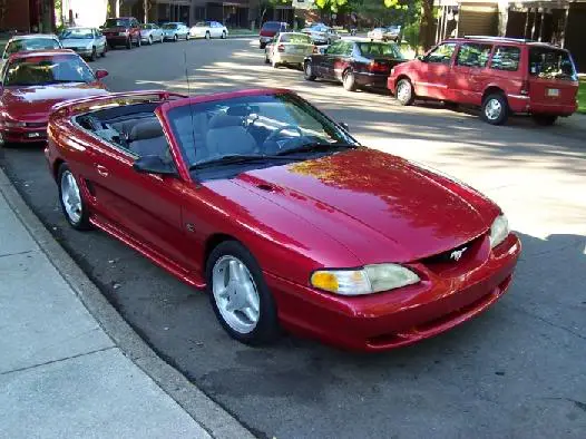

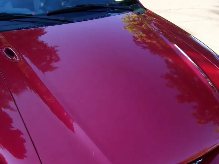

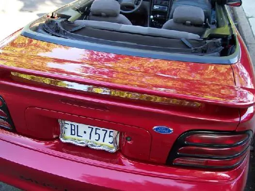

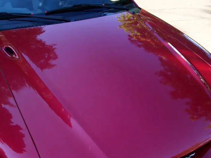

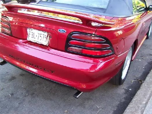

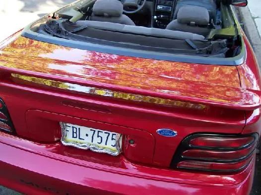

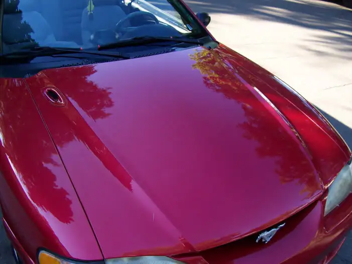

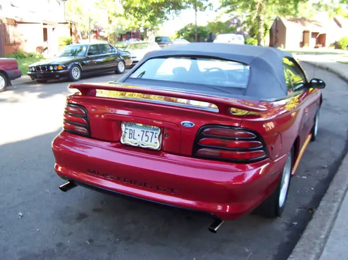

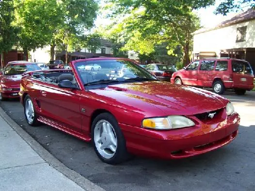

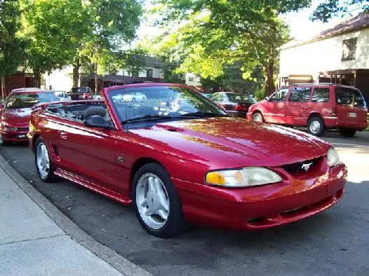

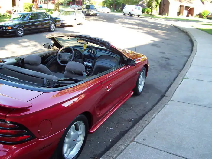

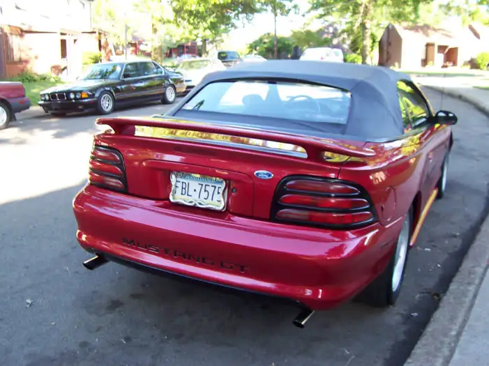

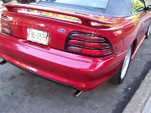

In past I use every wax and polish and last one was Mothers , but I decide to buy Meguiars in 3 Step and guess what , its works better than any other stuff I use in mine life

your talking about the 3 step system? Step 1 is the paint cleaner, step 2 is the polish, and step 3 is the wax right??....if so yeah that stuff kicks ass!!!....ive got it in the basement....your pics gave me the desire to do it tomorrow lol...only problem is it takes quite some time to do all 3....

That looks so CLEAN!!! I'm definitely going to give it a try as soon as I get my Stang put back together.
yeah, that comes from step one of the process (the paint cleaner)...
you should buy a clay bar while your getting this stuff...wash with dish soap to get all the old wax off...clay bar the whole car...then use all 3 steps on the whole car...will look like a million bucks!

I've been using the 3 step stuff for 3-4 years now and it does the same job for me.
People at my work can't believe that my car is 10 years old, because it looks better than any of the new or newer cars in our parking lot. Most of them think that paying $50 for a car wash is what "detailing" is all about cause they put on tire shine and charge a lot, lol. I spend an afternoon two times a year and get mine looking about as good as yours. I guess I should do it more often, since the results are that great.
For anyone else who is new to the "multi-step" process, note the importance of using a terry cloth pad to put each coat on. It is also important to use very clean terry cloth towels to rub each coat off (and turn the towel often, meaning you'll need a few towels). This works great for me and I only apply each coat one time. Cover entire car and then towel the whole car off........do that three times.
The cleaner really is the key to the whole process, but the real shine doesn't begin to show until the polish is used.
Great pics!!!
