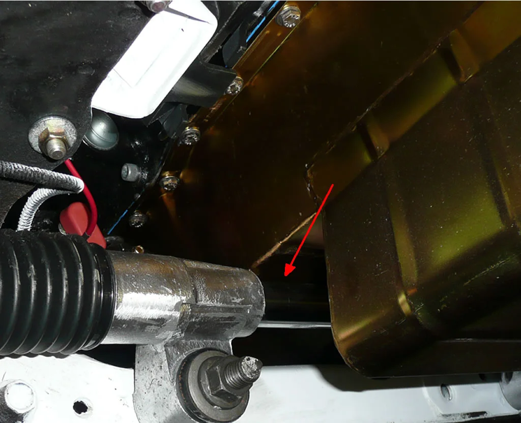

Hi All,
I just got done lowering the new engine and ran into a snag - The oil pan is hitting the manual rack, I can't even slide a piece of paper between. It was really no suprise with such a big pan. Other than that, everything else clears (headers, trans, rest of engine).
Any ideas on how to get a little extra clearence between the two?

I just got done putting 1/2" square nuts between the motor mounts and engine. It worked great, thanks again!
With the extra 1/2" motor height and higher intake, the top of the carb is about level with the top of the fenders. It looks like it's going to need a cutout hood.
