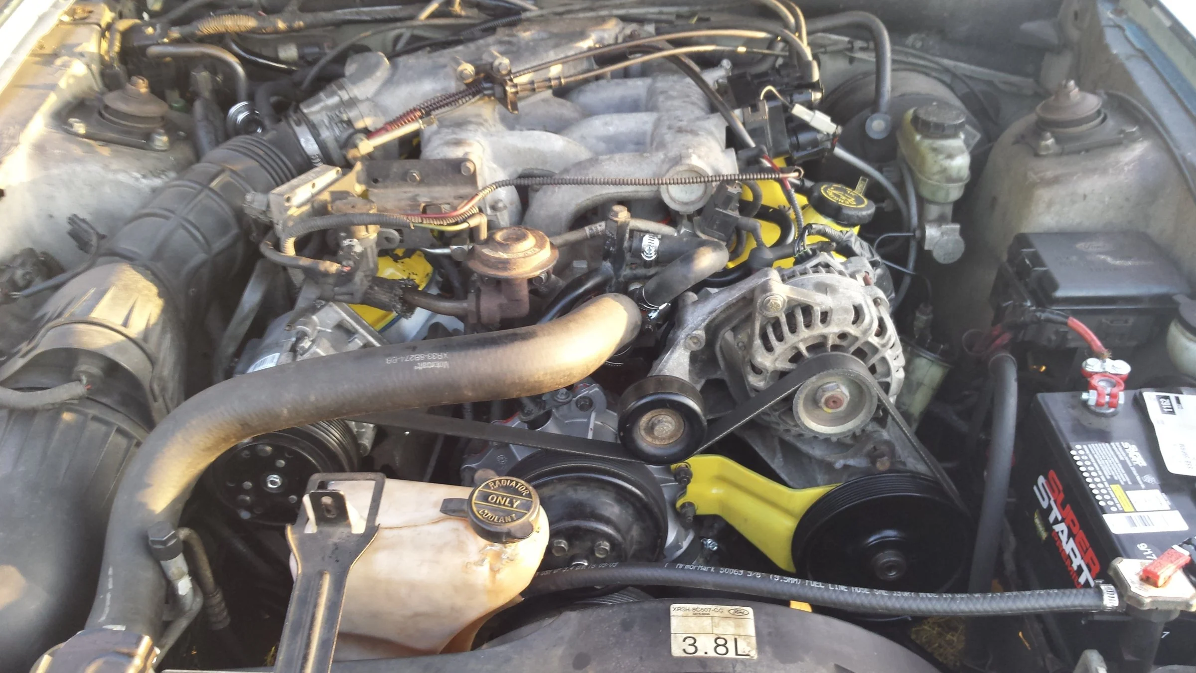

I'll post pictures of the assembly later tonight.
Update!
So everything is put back together. Changed out the battery (which was still under warranty, praise the project car deity) and terminals. So we have a car that turns over, but doesn't crank.

I've been neglecting posting the final picture, but here she is!
