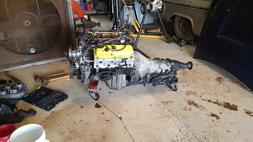

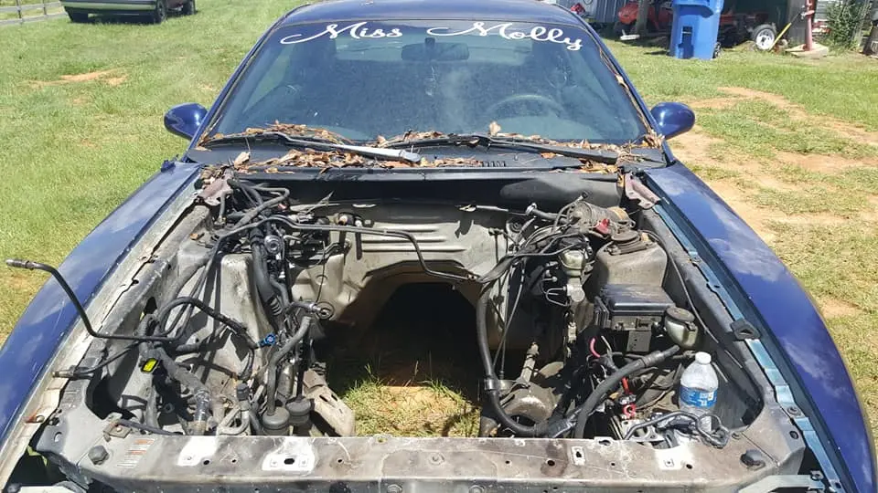

After about 8 hours, a lot of busted knuckles, and a few tears, she's finally out! I decided to take out the transmission as well because I have read from other people that rebuilt similar engines that it is just easier to do it that way. Next weekend (hopefully) is the disassembly.
Looks like you had a fun filled weekend :eek:
You planning on rebuilding the motor or are you tearing it down to try and find the issue?

Honestly, yes to both. This full tear apart will help me figure out what i may or may not have done the first time around. I'm thinking Saturday afternoon I might be able to get in the shop and start taking some things apart. We will see!
I'll keep you guys in the loop.

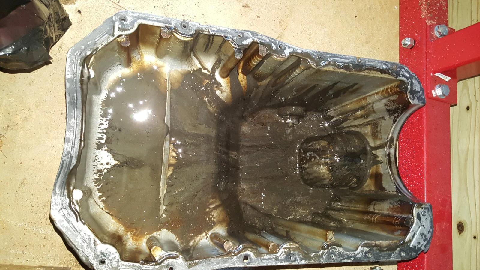

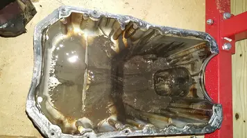

I took the oil pan off and it has been one of the mot disgusting things I have every seen in my life. But that just means I can clean it!

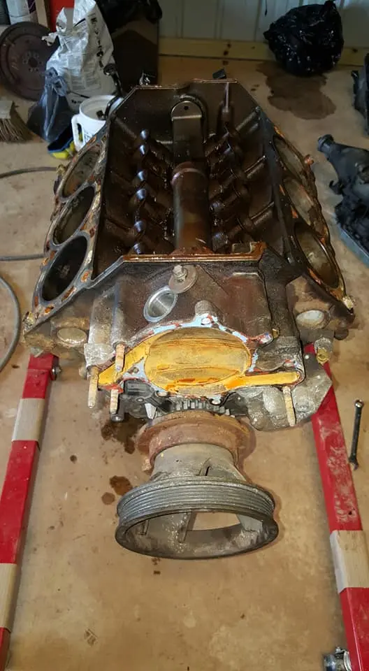

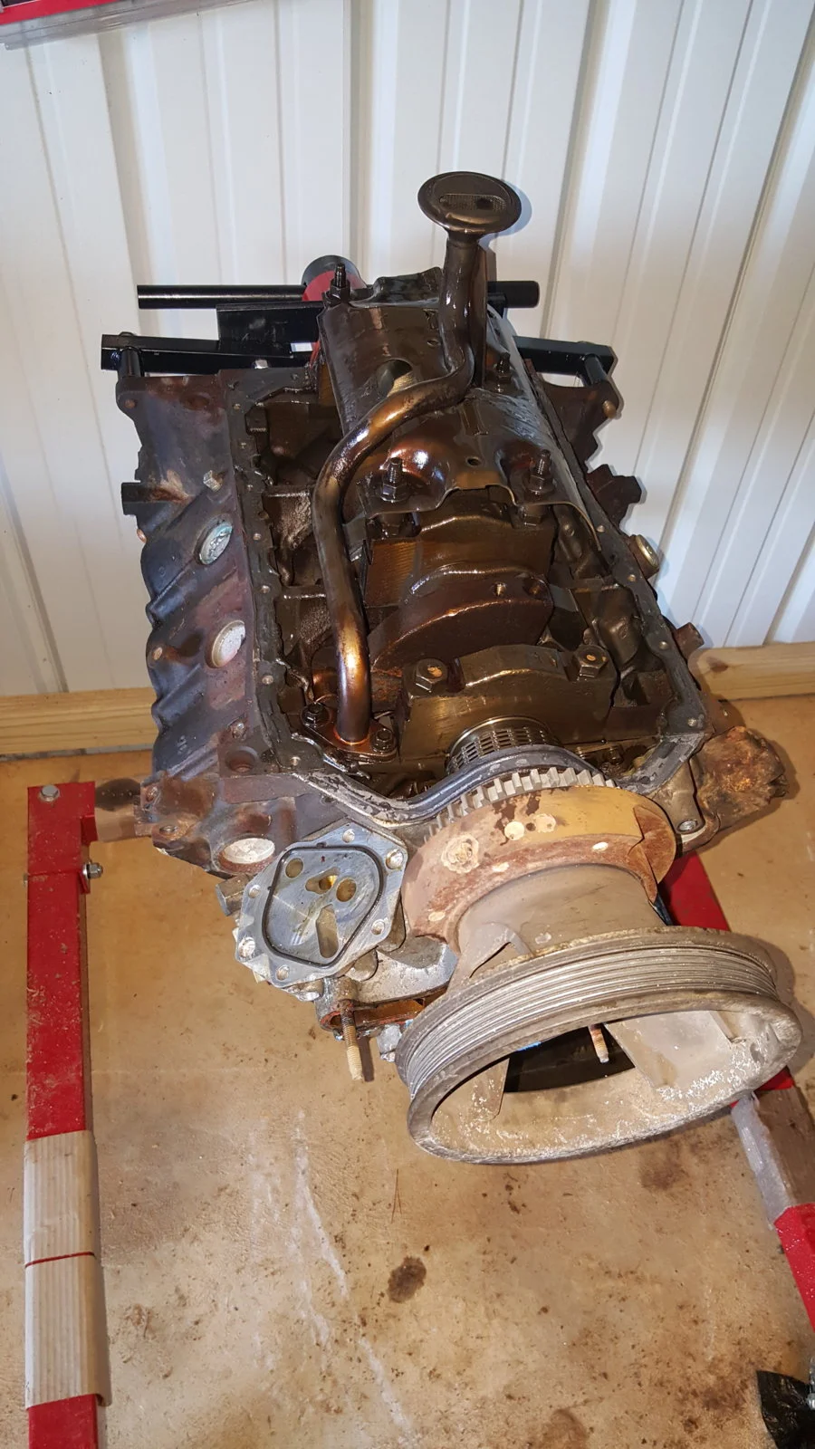

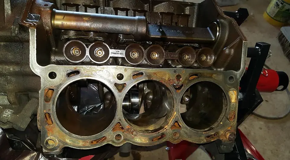

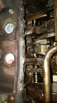

Forgot to post this last weekend but I dropped the pistons out. I should have taken a picture of them... Regardless, I'm just happy to be nearing the end stage of disassembly. Only thing I have left is the crankshaft. I need a special puller of the pulley but then I should be good to go. I ordered my rings, gaskets, plugs, and wires already so they'll be coming in all through the next week (only ***$300***). I also snagged myself a new coil pack because one I've been eyeballing went on clearance. My wallet has already punched me in the throat 4 or 5 times now.
As per the moment, the rebuild may POSSIBLY commence on Wednesday.
Yes, I already have quite a few gallons of Purple Power ready to clean this thing to make it start off nice and shiny.

You going to paint her up before re-assembly? Your about to get to the fun part btw.
I have considered painting the block a dark purple, for a "purple heart" because this girl has put up one hell of a fight for me. I know I'm changing the valve cover paint from yellow for sure! Also, it makes me thing the fun part you're talking about will not be so fun lol

Are you going to drop the block off for a good cleaning and check the tolerances? I would really recommend doing that.
Show us a picture of the cylinder walls and what they look like.
After time running, a block tends to develop an out of round oval shape you won't be able to detect visually, but will shorten the life span of your new parts you put in.
I would hesitate ordering new pistons and rings till I had that spec'd out. There's a chance it might need a slight overbore (.020~) to bring it back to be round.
It also doesn't hurt to have the lifter bores checked and have it decked, if it needs it.
