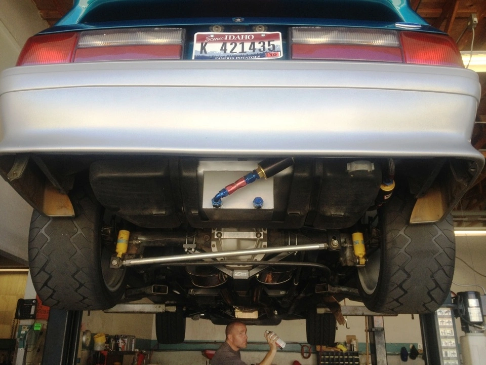

I just picked up a mm torque arm and it's a lot beefier than I thought it would be. Makes me wonder if there is room to run tails. Anyone have this piece installed and running tail pipes? It's already tight with my 315 tires in the back. There is ZERO room for adjustment.

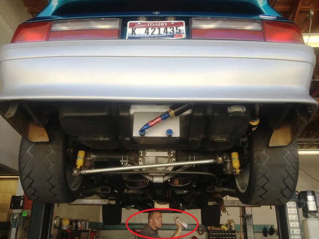

Is it just me or does grover look guilty in that pic?!!?
I picked this up from another guy and I dont have the PH bar although it is on my list.

For me... What you come up with will determine if I ever try the torque arm. I think I can make a pretty damned good 4-link... at least good to the point where I "know" that the tails become WAY more important. hehe

From what I've read, you're better off fabbing one... The crossover to accommodate that torque arm, I mean.
This is one of those mods that everyone wants and shies away from. Groverdill is one of the few people I have seen do this. Shaolin was the other, in fact he sold me the unit. Neither of them ran tails since they had GTs. You can only bolt on so many parts. I guess its time to roll up the sleeves and get dirty. It's going to be fab o'clock in this bitch. I was planning on resurrecting my AC but will likely do this instead. As per my last thread my car handles like chit and the arm came with H&R springs which is why I jumped on it. Time to kill two birds with one stone. If worse comes to worse from what I have read an IRS cat back "should" work. that may be the direction I take.
