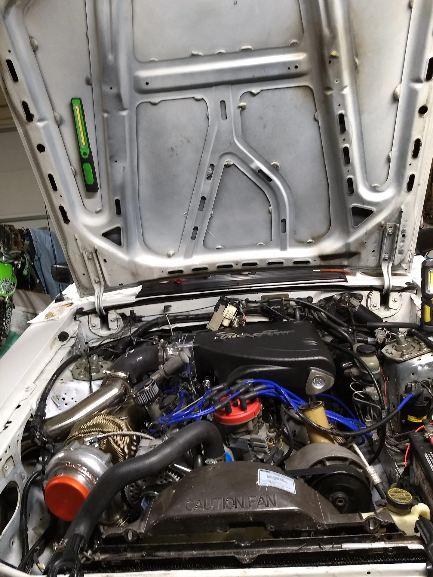

Well,its done. But...I can't find my usb to serial port adapter Best buy has ONE left so headed there bright and early tomorrow morning.
Do you have the jumper harness? With the size of the Trick Flow and the additional harness,it's a real pain to tuck it anywhere.I took the bracket off of mine and tucked it behind the intake. Can't see it with the hood popped.
I believe I can jumper the red and white wires and make it work for now. Ordered the harness from LMR earlier.Jumper it so it thinks it's in neutral

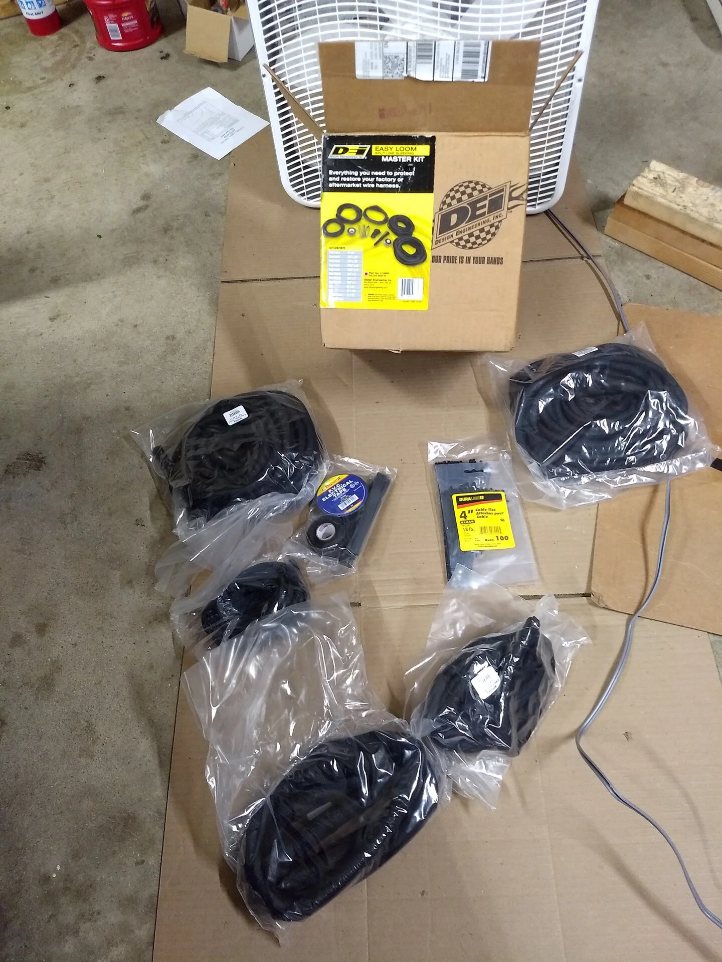

I just want it to idle so I can set the timing, Steve can do the rest. Getting ready to tear into this loom nowThat's my new favorite stuff. I used scissors to cut it and a lighter to burn the ends. Keeps them from fraying. The tape is great but will roll up on the wrap side. I used regular UL listed electrical vinyl tape on most of it.
