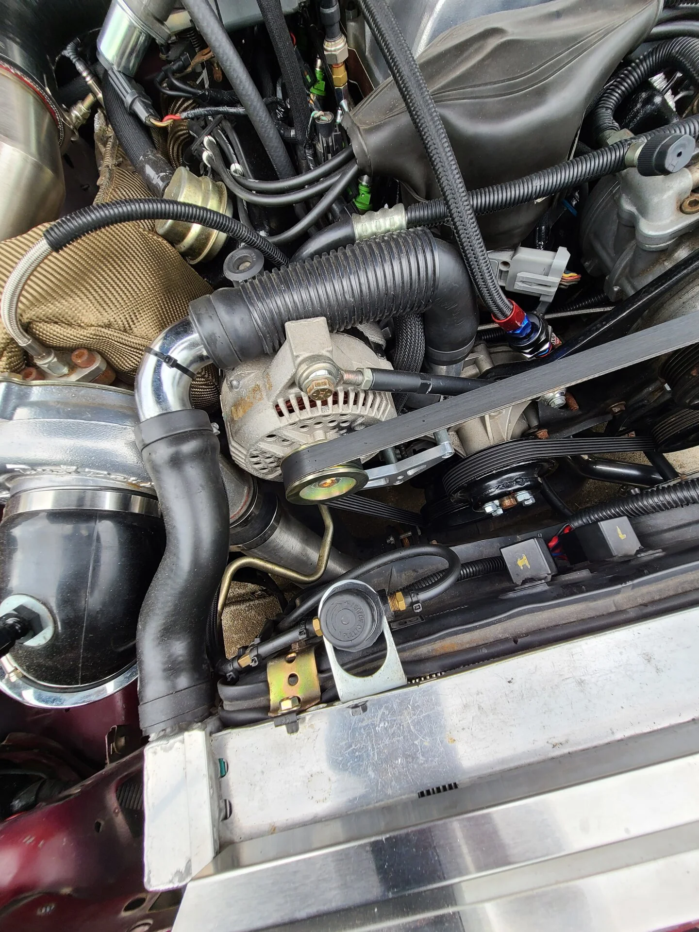

Ugh,fella. I came across the Explorer graphite gasket sets with the blue rubber rail gaskets at Rockauto for $12.47ea. I ordered 2 sets. I'm determined to make these work. I'm thinking thin bead on top and bottom of gasket,let skin then torque down. Also,we run a similiar engine combo (331,turbo,etc). Do you run a pcv or what's your setup? I'm currently running 2 a/n fittings (10a/n) on the valve covers to a vented catch can. But then you research it,it's never a clear answer. There's talk of one way check valves,but no real clear way how to install.
I run the factory PCV, a sealed catch can, a -6an check valve, to the intake. I also run a mid 90s dodge truck breather ( sealed ) with 5/8 hose running to a breather tank. A -6an line also runs from that to my turbo inlet.
When not in boost system works normal ( air flows from breather tank, into valve cover and out PCV )...when in boost the access vapors are sucked through the breather tank and into the turbo behind my air filter.
If I was running MAF I'd have to seal off the breather tank and put the MAF in front of the turbo and the vapor inlet....or get Steve to tune around it.

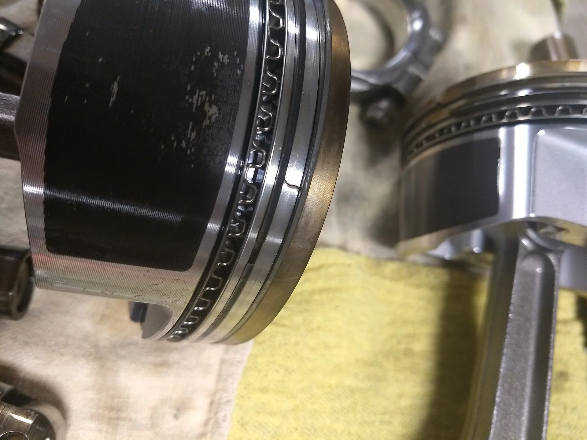

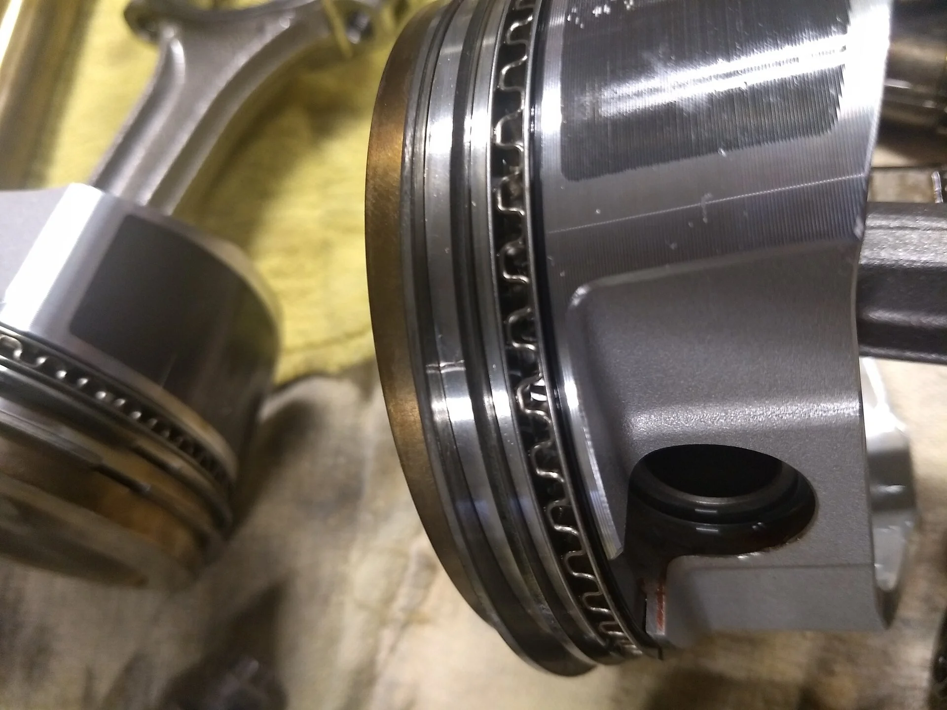

Got some free time this morning to go down to the shop and tear down the shortblock. Initial teardown didn't reveal much,so we went ahead with piston removal and found......cracked ring lands on 5 and 7. Looking for causes here. Detonation? Low octane fuel? Insufficient ring gap? Thoughts @a91what ?

I’m gonna have to say insufficient ring end gap.
The PN on the piston is from Wiseco. It’s a 4032 alloy forging..typically ran with very tight tolerances in the bore, because it doesn’t expand very much ( comparably) when it gets hot.
But the rings do...
The wrong end gap will cause them to butt when exposed to heat from too much of a power adder, and not enough timing removed. Certain alloys expand at different rates than the ring, and a “too tight” ring will basically cut the ring land right off the piston.
Thats what that looks like was starting to happen to me.
But the rings do...
I believe you are correct. Probably just gonna order a whole new set.
