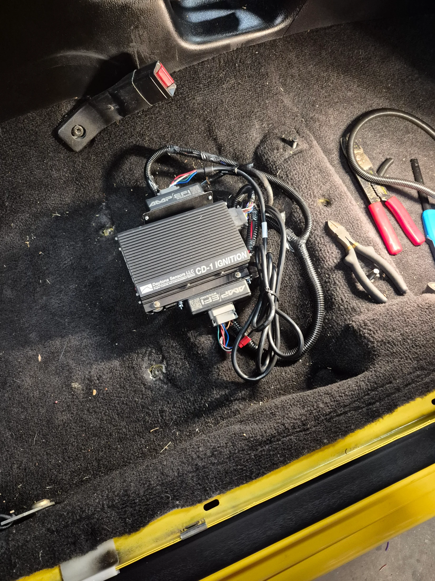

I think we talked about it already. I yanked my O2 harness, and ran it all via can bus. When ever the instructions had (recommended), that's the way I went.
