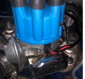

  • After-market ‘bosch-style’ Distributor is an electronic distributor red and black wire (no amplifier)

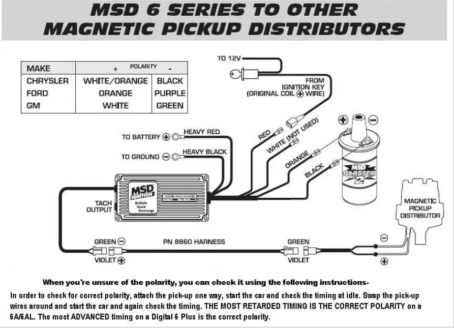

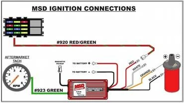

I’ve wired in the distributor as per the MSD 6a diagram for an aftermarket magnetic pickup distributor
I’ve completed the spark test by shorting the green and violet wires and confirmed spark.
I changed the magnetic pick-up in the distributor to a brand new one and confirmed it works.

You can check if the MSD6a is working by disconnecting the red/green wire going to the distributor and then (with the key on) use a jumper across the red wire/green wire. Each time that you jumper it it should make a spark at the coil wire (it will only spark once for each time that you make the connection. The output of the coil wire should be located just above (1/8") a grounded source, such as a valve cover. Of course the MSD unit needs to have both voltage and ground available to function.
The exact instructions for doing the above test are in the MSD manual.
