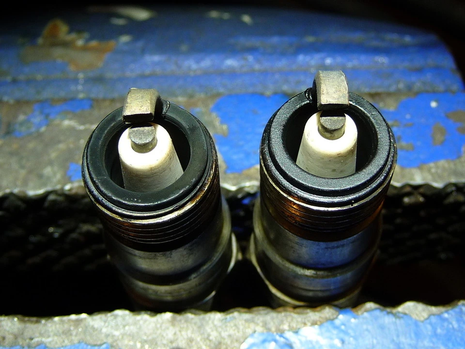

Pulled the plugs and there is a story on them. Look at the picture. #'s 3 and 4 and partially #2 look like the one on the right. All five others look like the one on the left. Normal dry carbon deposits on the rim of the left one - wetter cleaner look on the right. I'm heading out now to get a combustion in coolant checker.
Does this picture positively convince you of something specific? If so, what?
