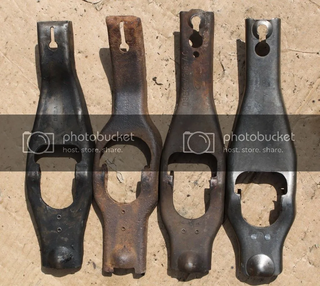

A quick google search of that part number comes up with evidence that it might be a 2.3 fork from a Pinto. I haven't found anything else to back that up, just this from foureyedpride....
2.3t clutch fork question
Hello, I have a bell housing off a pace car with a 2.3t and one off of a 86tbird turbo coupe. My question is which fork would be used on the pace car's bell housing. Are they the same off a 5.0? I know the Tbird ones are different. I have 2 NOS for the Tbird' but I'm trying to not have to use...
vb.foureyedpride.com
Reactions: 2Blue2

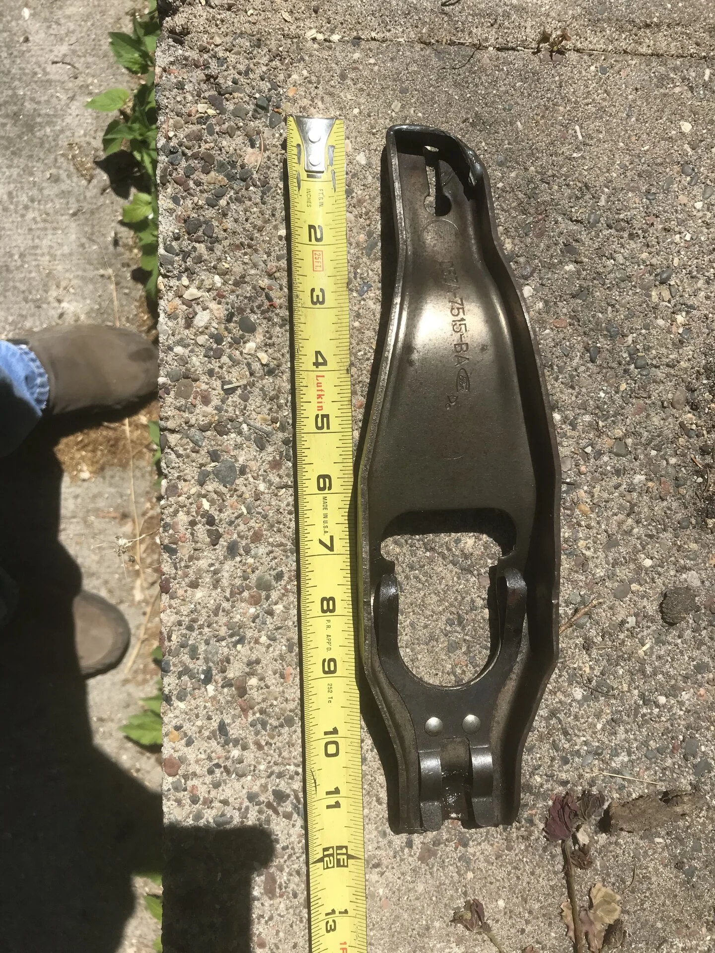

Well Heck. Let me go pull mine out and measure it. Yes! you have the right one.
Reactions: 2Blue2

mine was 11-1/2" stock from the factory.
Reactions: 2Blue2

The quote talking about 2.3s
D52A-7515-AC left, D4ZA-7515-B8 2nd from left, D8BC-7515-AC third from left, but only the Fox 5.0 fork , the forth from the left, will work

Enzio said:
mine was 11-1/2"
I bet I have the longest...
clutch fork in a Mustang II. I use the sn95 94-95 5.0 fork.
Reactions: 2Blue2 and LILCBRA

The foxbody clutch fork looks like it could work. They are still in production:
https://www.rockauto.com/en/catalog...,1134076,transmission-manual,clutch+fork,1992
This could work, but no one is completely sure.
