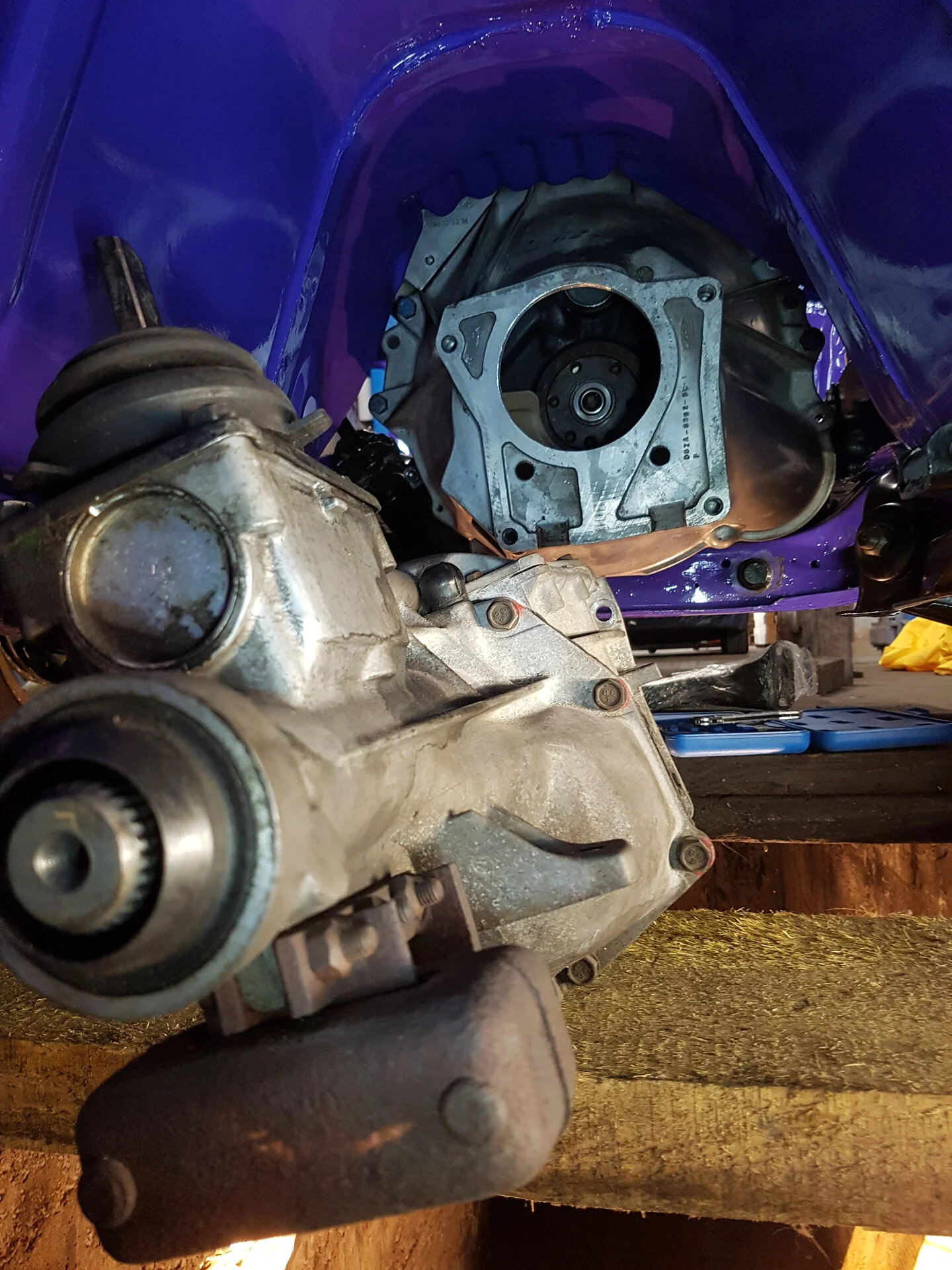

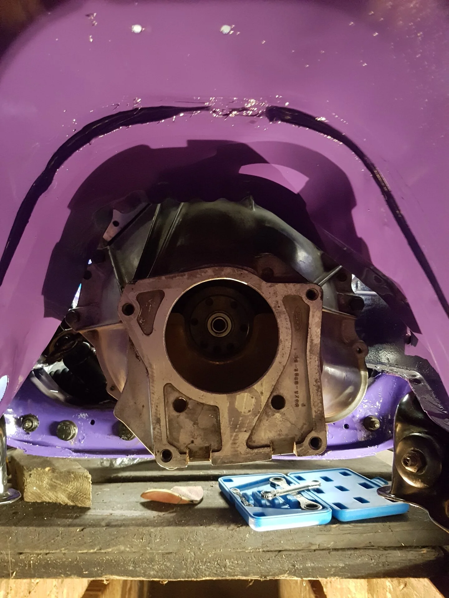

Hi Guys.
I am looking for a clutch fork / clutch lever for my v8!
I have the bellhous series and the T5 transmission.
Does anyone have one to sell or an idea for an alternative !?
Thank you very much and stay healthy

LILCBRA has posted info about the T5 swap with the original bell housing some weeks ago. The first thing which I see, is that you have put already a pilot bearing into the crank shaft. From what I read in this forum, you need an adapter that the pilot bearing comes more backwards.

The front bearing retainer needs trimmed to fit the bell. You can trim the bell but I didn't want to modify it. I used the Pro5.0 shifter. I trimmed an inch of the floor. The shifter is at the front of the opening but my handle has an S curve and with a decorative shift boot will be in the right place. I also used a 1979 shift boot to seal the floor. Driveshaft may need shortened. My v6 shaft fit but I wanted the v8 shaft and it needed shortened.

yes I have the clutch from classic auto. and I also have the right flywheel .... only the fork is missing ... or an alternative from another model!?

yes I know what I have to cut out to be able to switch .... but it is not bad ... I have to build something.
what i'm looking for is the original clutch fork or from another car which is so similar and has to be modified
pictures still come on the documentation

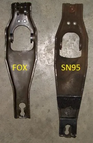

I read through the guides I've saved over the years and cannot find the reference to the shift fork. Looking at pictures the fox fork looks close except the slot for the cable is different. If you don't have luck with better information it may be worth getting one and trying it out. I am almost certain I read they work with minor changes to the pivot area. My faulty memory is they had to use an adjustable pivot and clearance a tiny bit near the pivot.

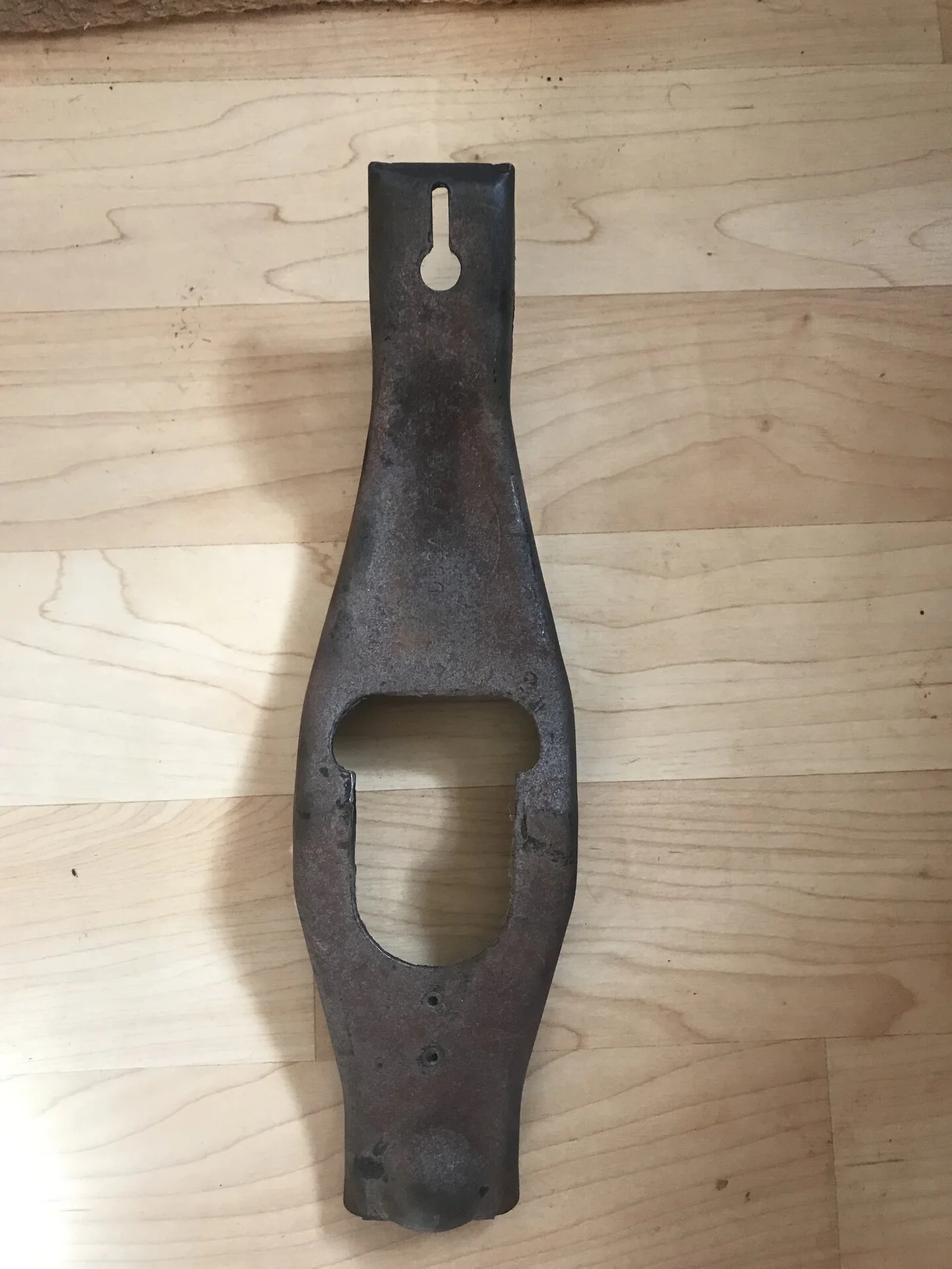

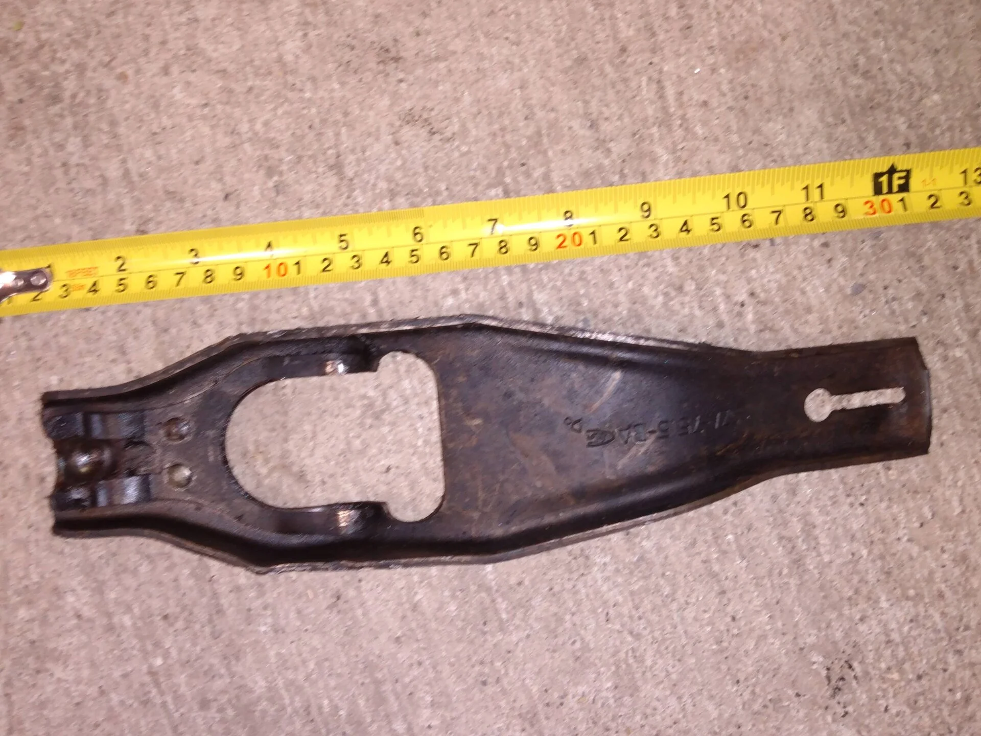

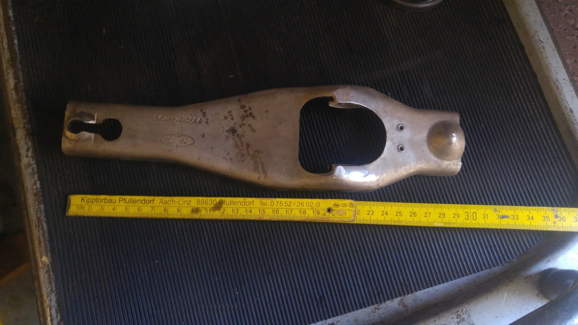

Can we even get some one to put up a decent picture of the mustang II V8 clutch fork?

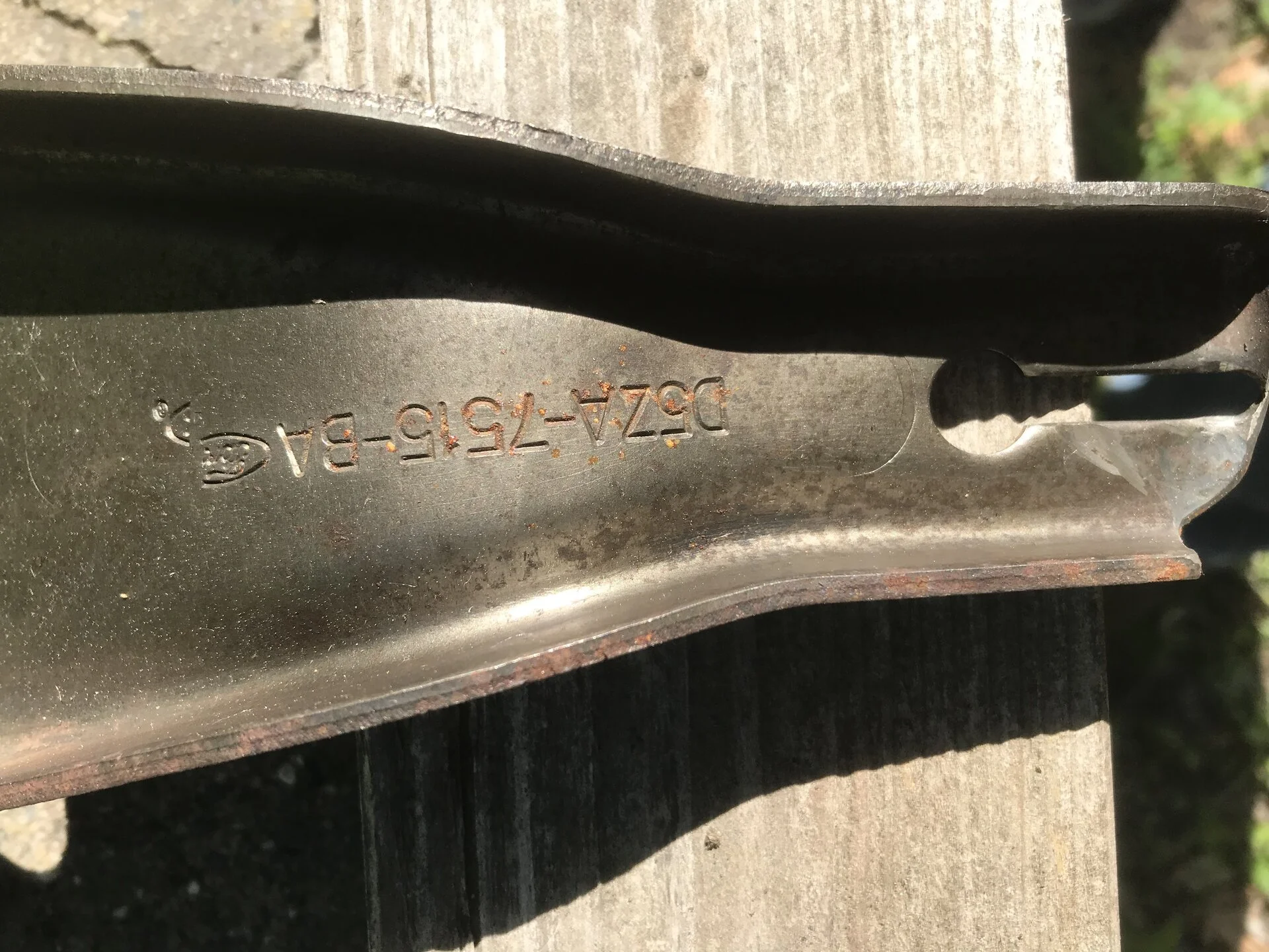

Part number?

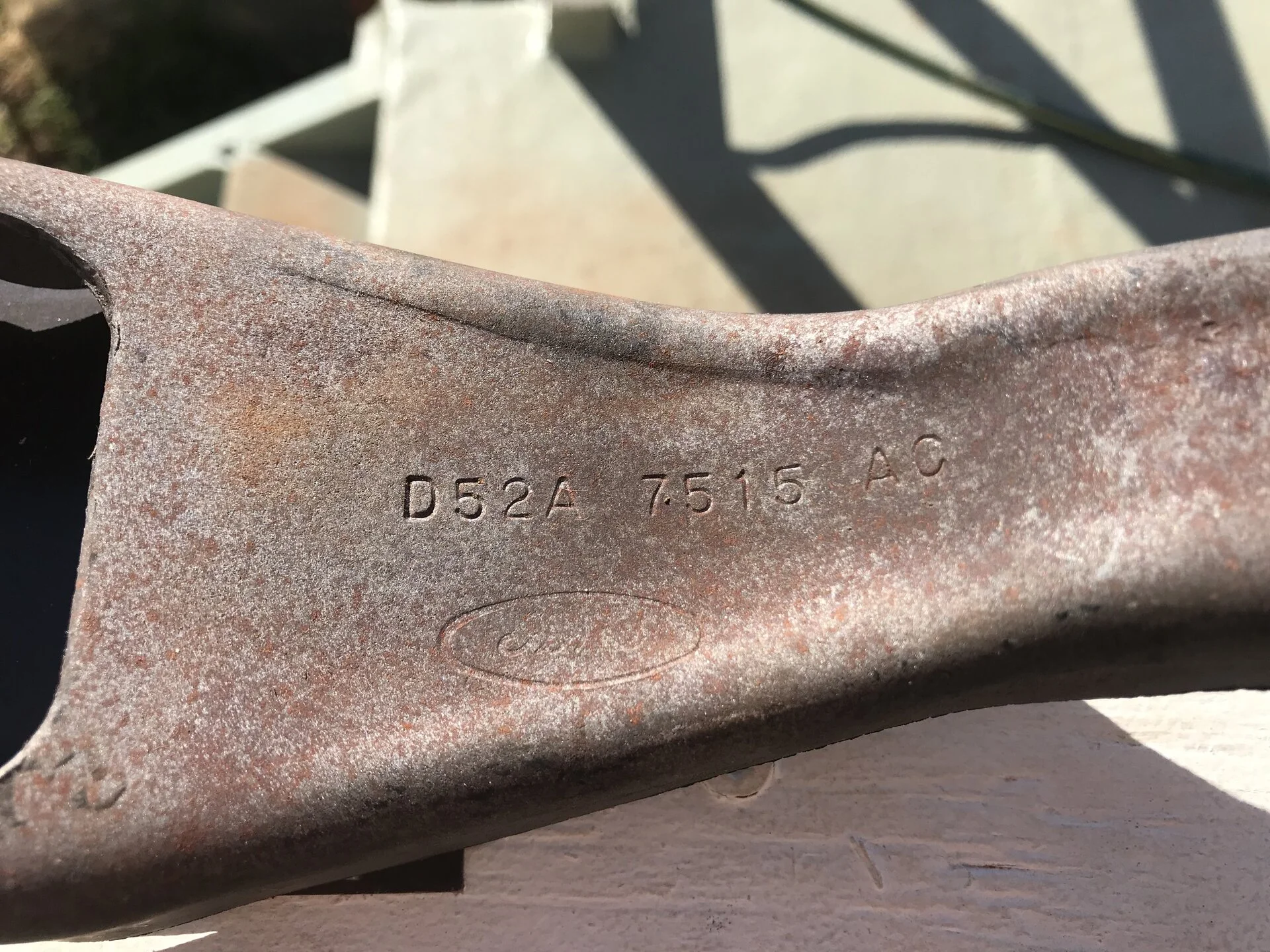

I have this one. Part Number D52A-7515-AC.
I don't know what it came out of but had 1975 part number
and was short and stubby so I snagged it up for my pending Mutt2 manual trans conversion
Hopefully it is correct.

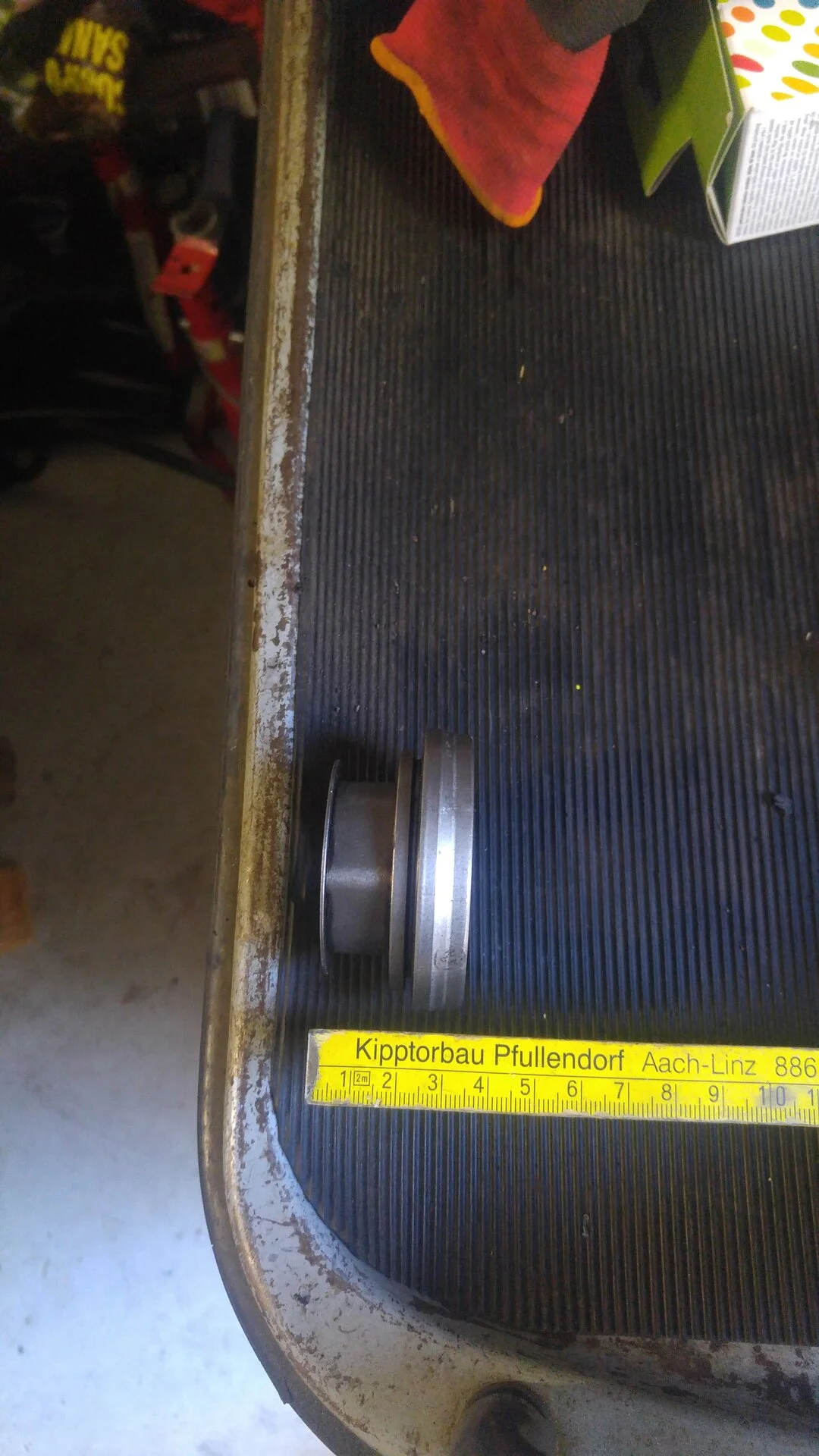

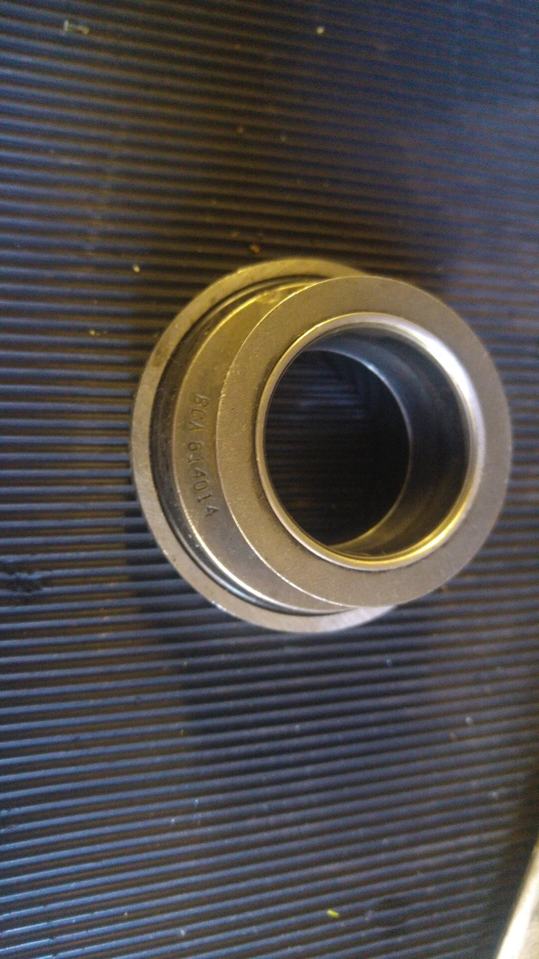

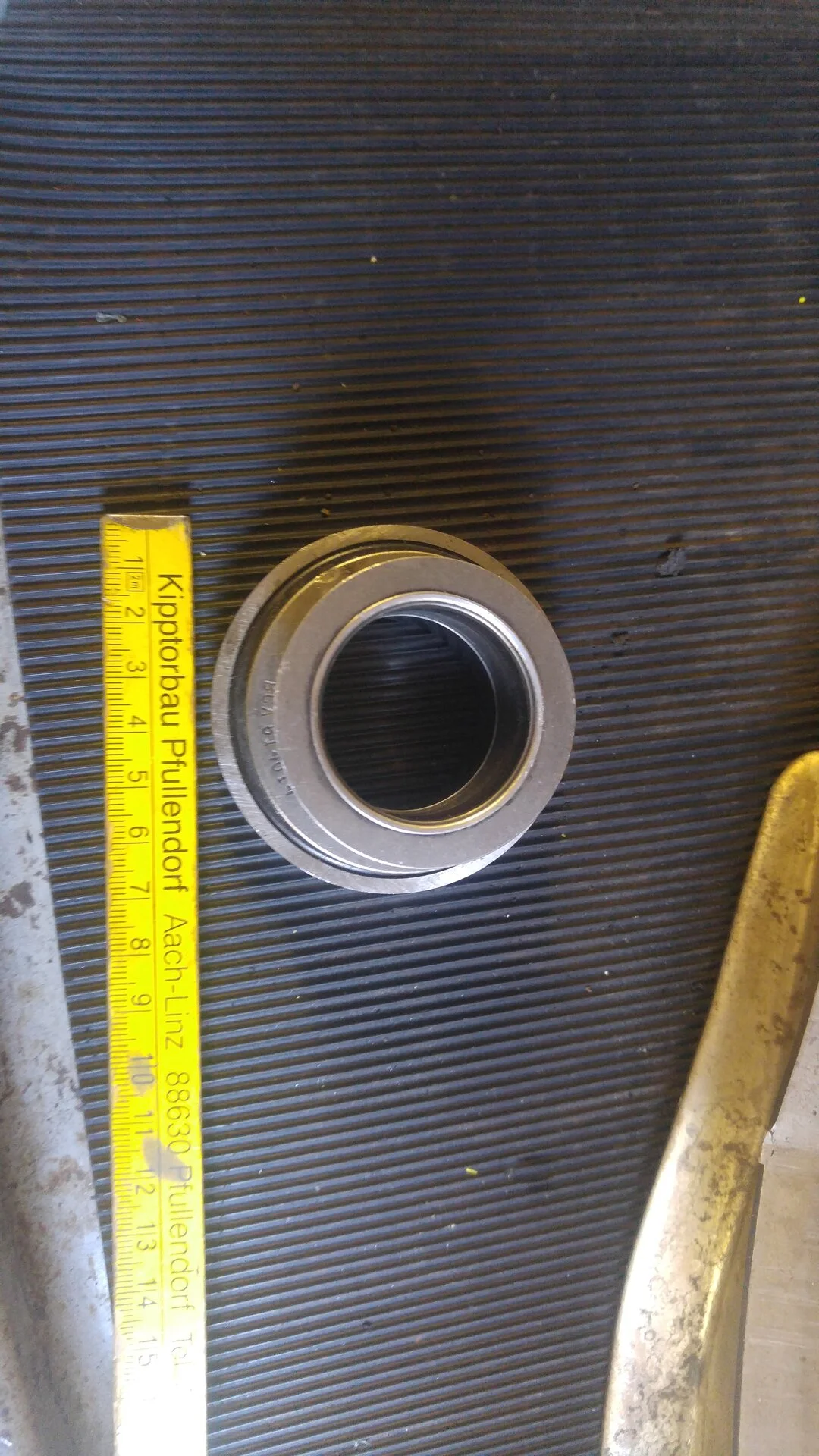

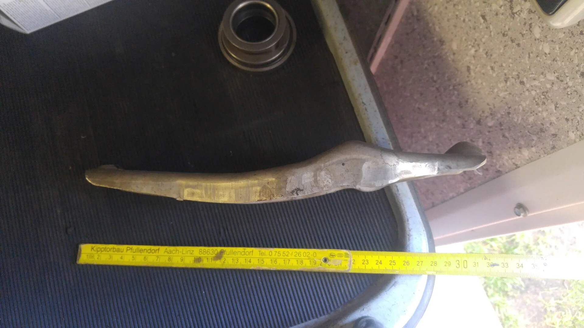

Here are the pictures... Do you have a troughout bearing with you clutch kit?

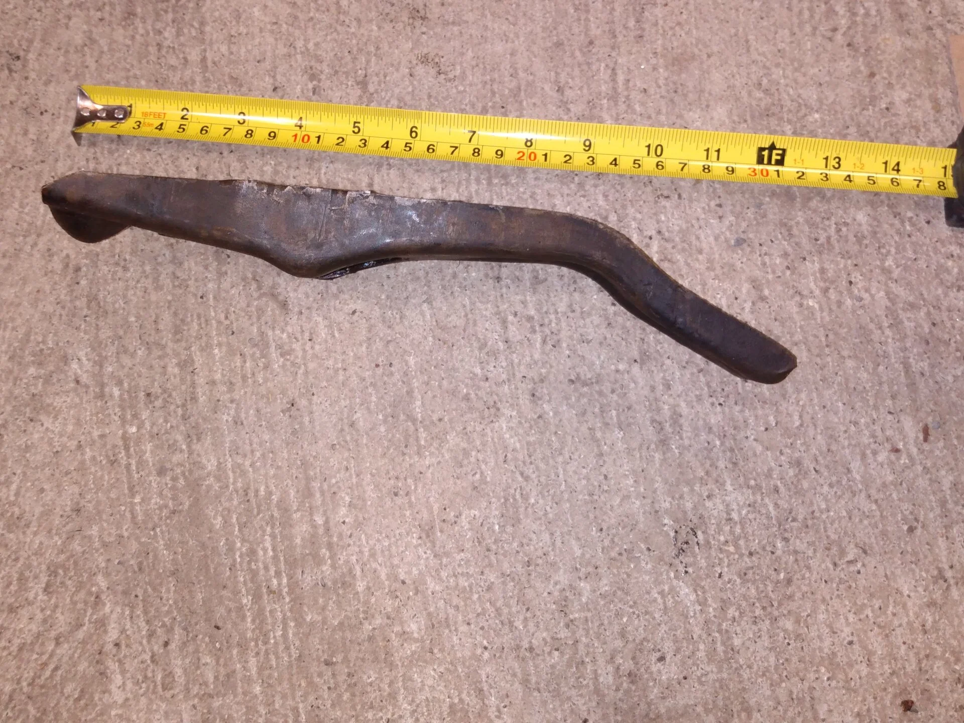

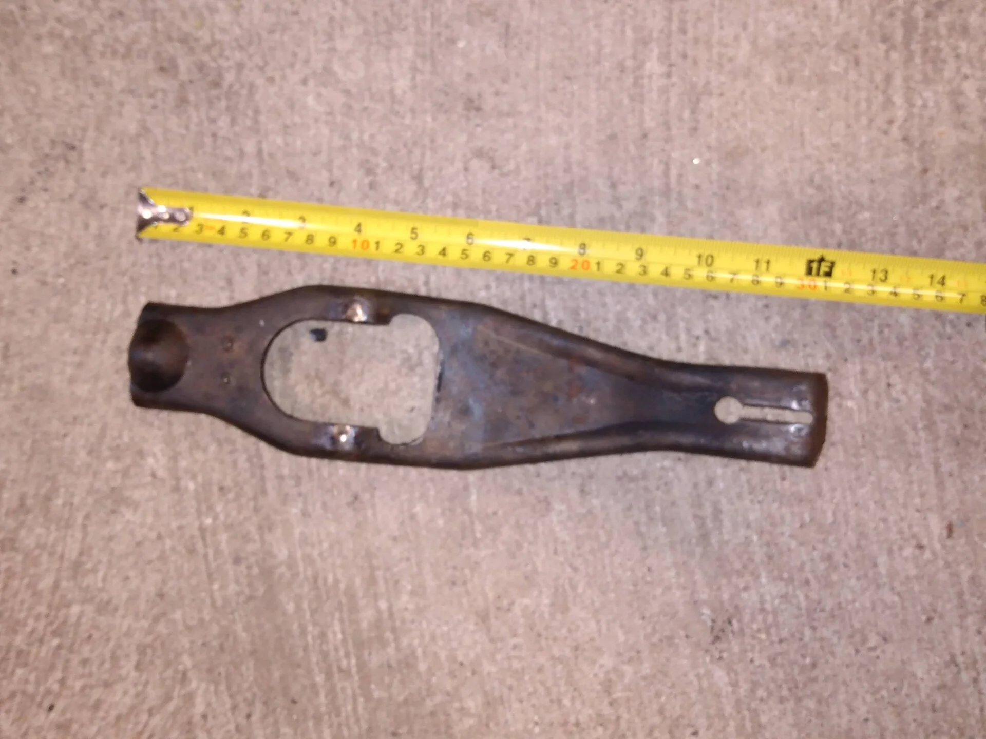

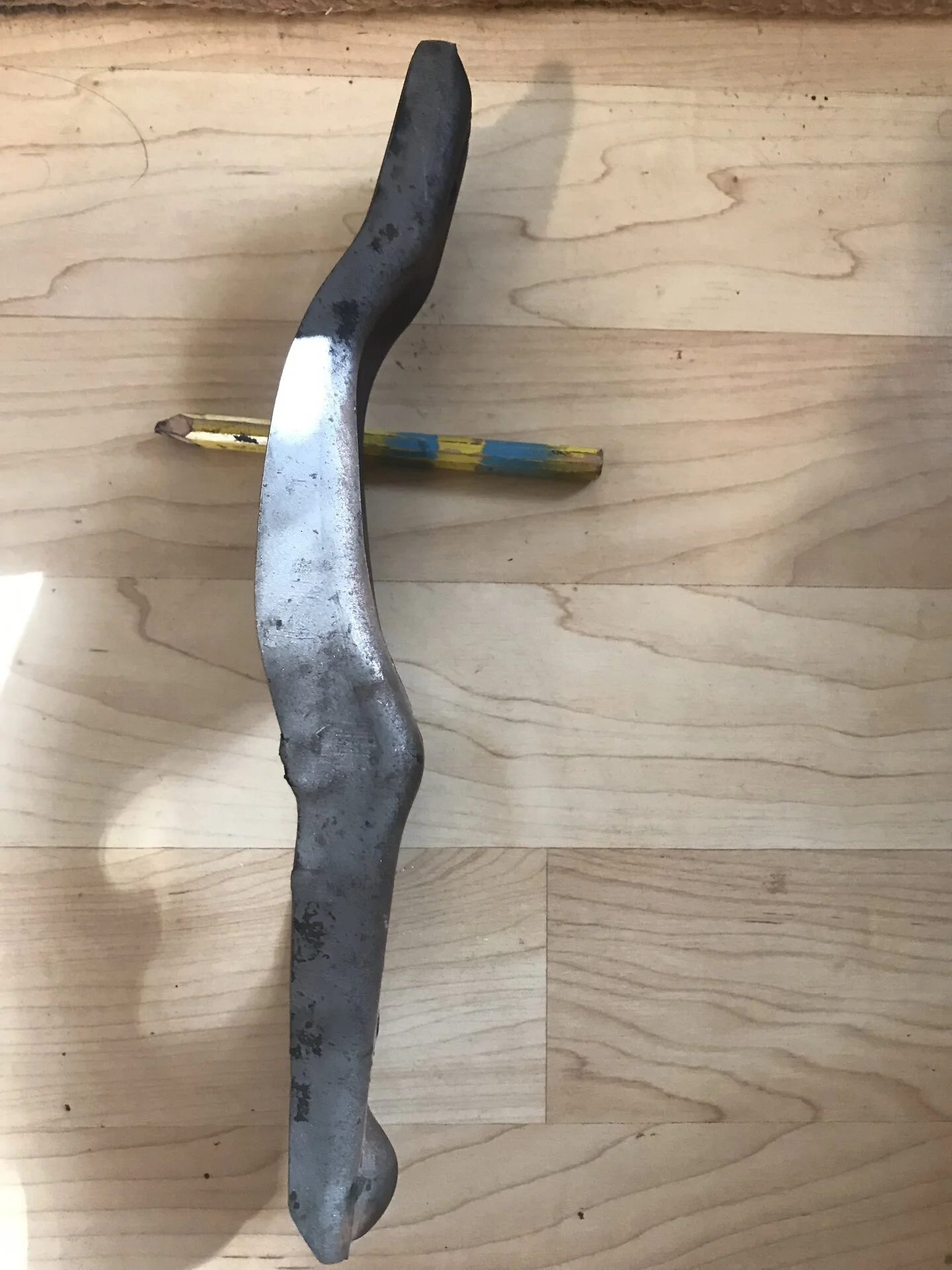

I bet a fox works.With the way the fox is made it looks like it would sit further back on the bell opening. The II is bent more but on my setup the II fork sits 3/4 way forward in the bell opening. It works fine but the throw is only 25% of the opening. A new clutch cable doesnt work on my setup without cutting 2/3 of the spring off. I bet I could use the stock cable without cutting the spring on a fox fork. The only concern is interference at the pivot area and attaching our clutch cable in my mind.
Reactions: 2Blue2
Do you all think mine is correct but just mis-stamped with its D52A- number? Enzio's is D5ZA
IICrew your picture makes me think mine is right except yours is 12 and 1/4 and mine is 11and 1/2 inches
D52"A "would be a full size ford I think (LTD, Custom500, Galaxie, ) part numbers are confusing.
I think they made a manual trans Galaxie in 75
Thanks guys
They had new cars through out the Ford line up in 75.
but guessing its a typo. Ford part numbers are famous for this very thing .
I'm looking at "A" in the wrong slot to boot
