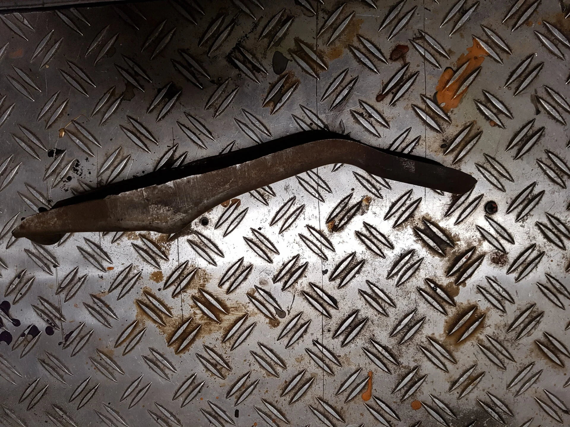

Mine is from a 75 II with v8. A friend of mine put close to 50k on this fork back in the 80's. When he blew the engine I snatched his trans. I have it working in my setup today. Try to locate one of these.
Mine sits 2/3 forward in the opening so mine may have been bent over the years. This tells me a fox one isn't too far off.

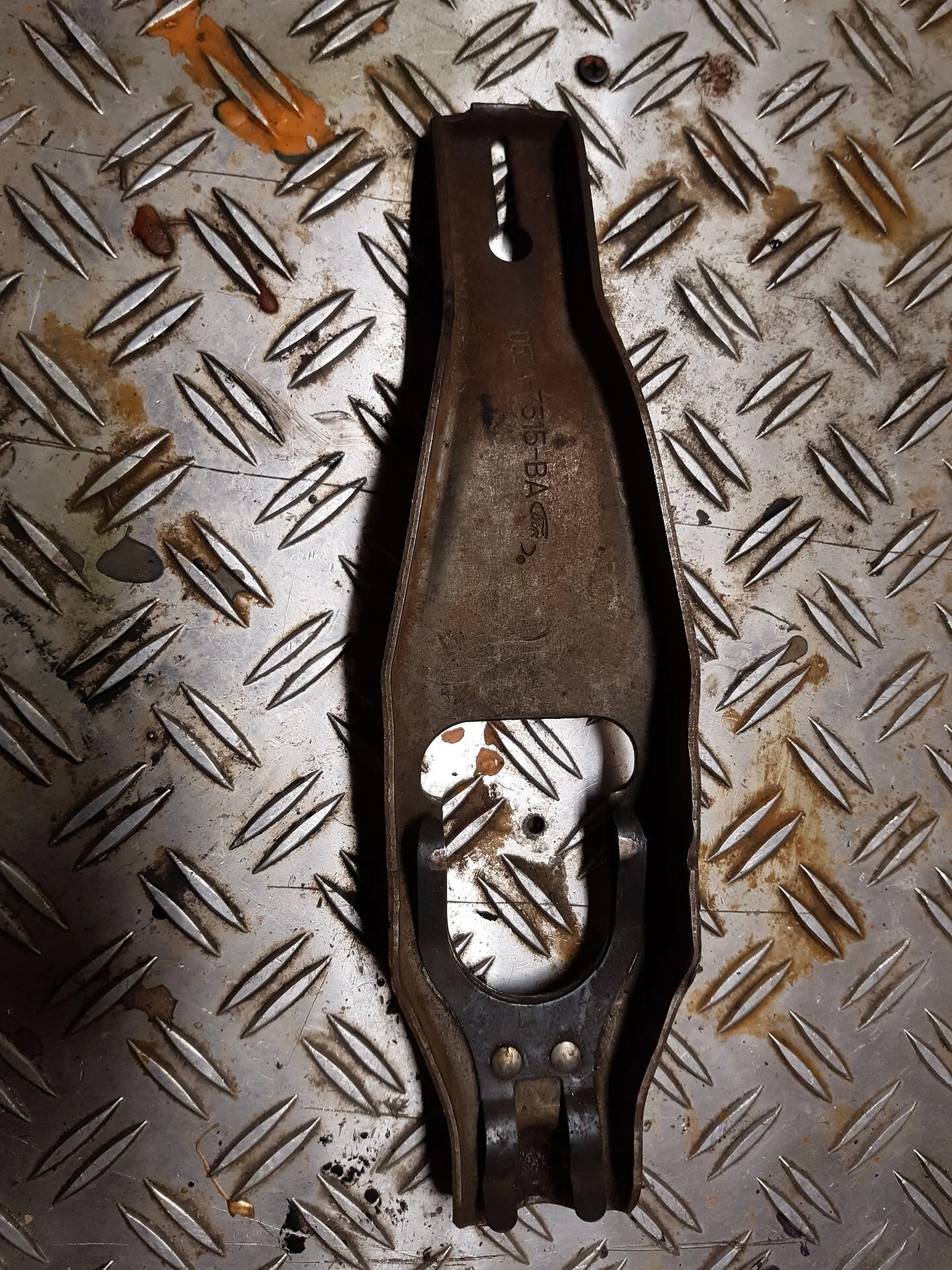

mine is for a 2.3 so not 'correct'
probably would still work though depending on how different the 2.3 and the small mutt2 302bell housings are

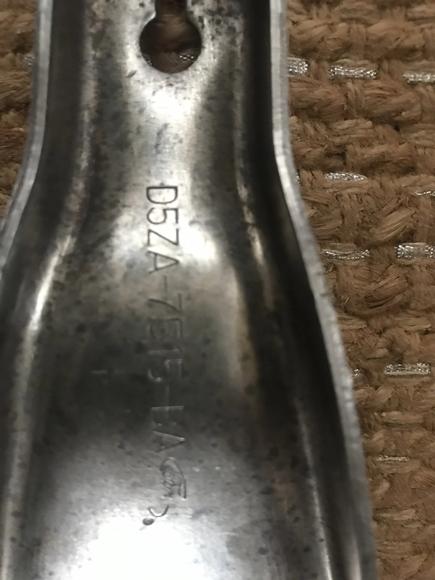

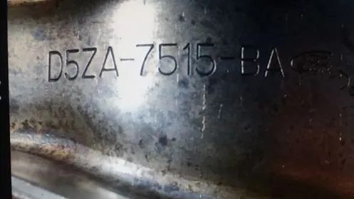

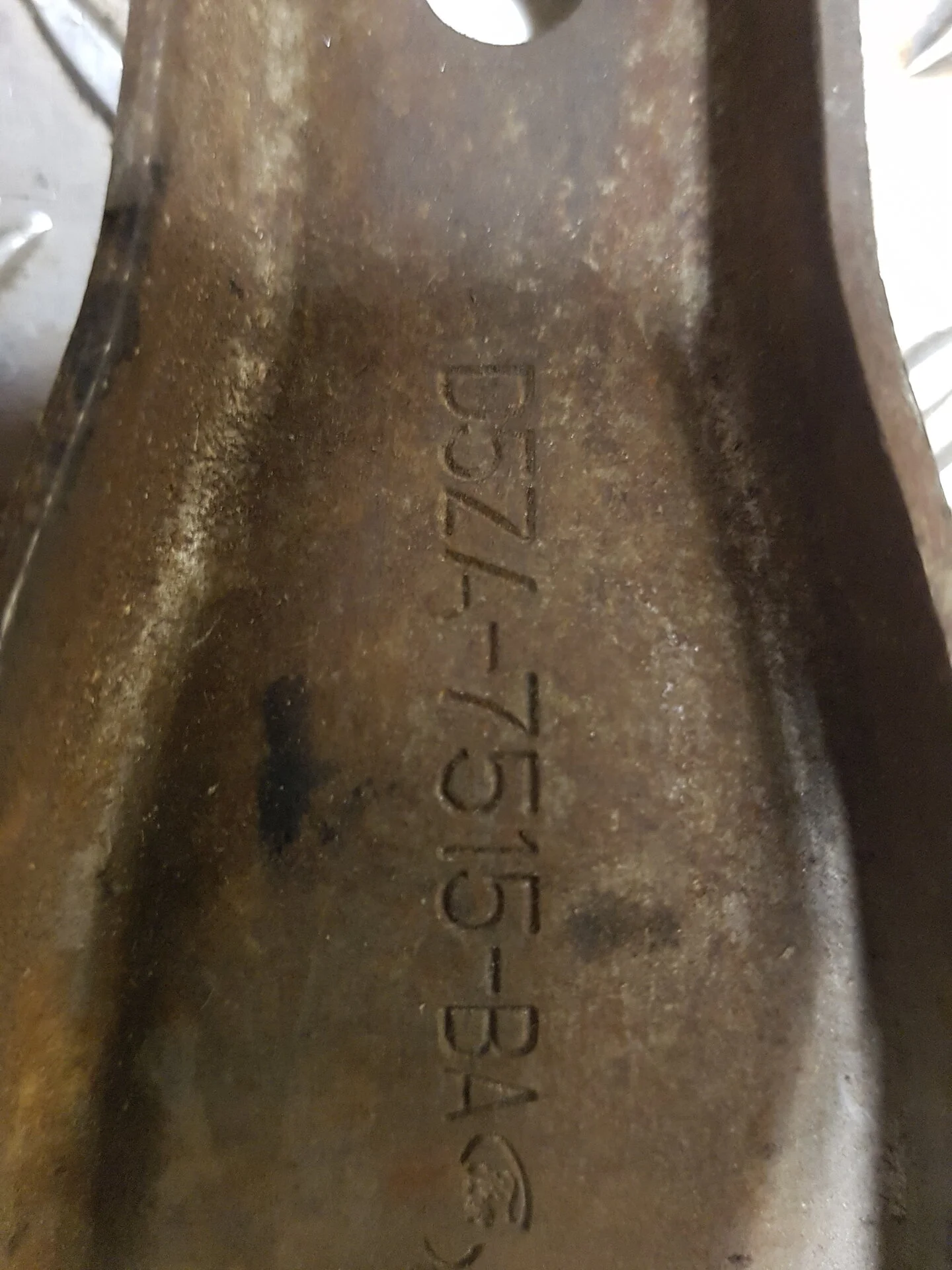

My friend actually had one with the D5Z on it!

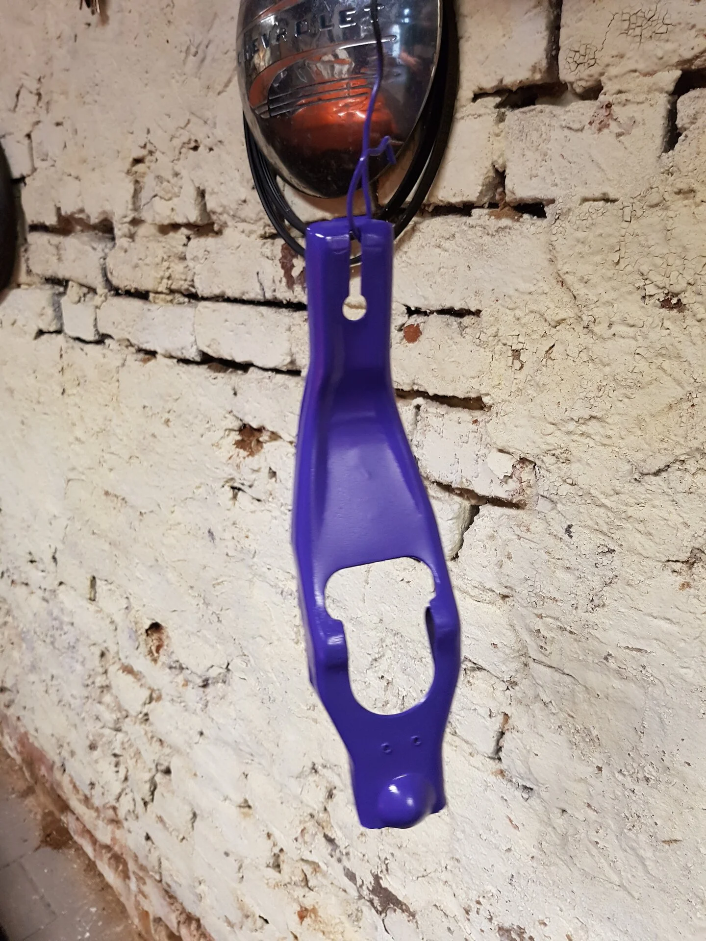

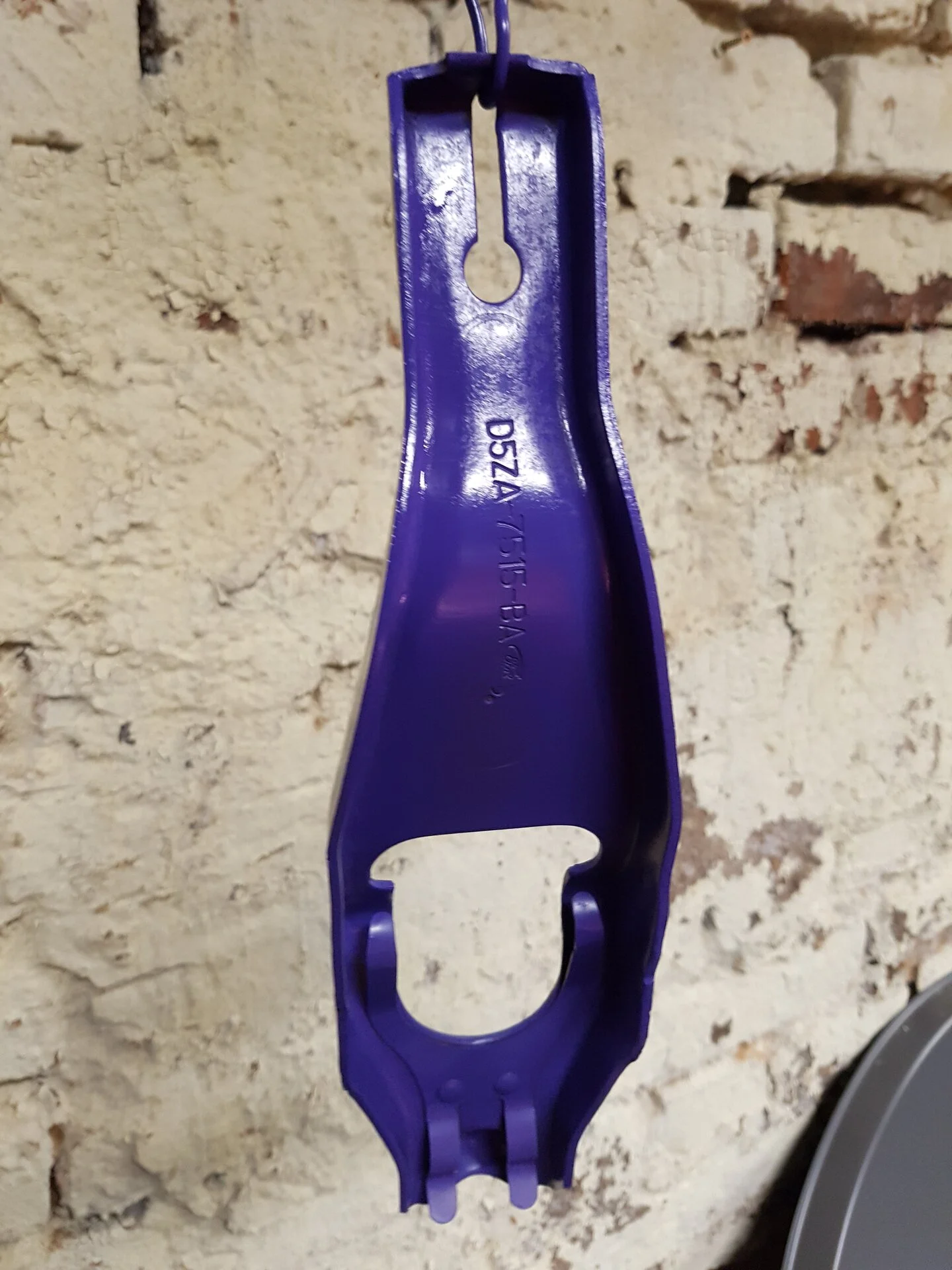

I cleaned her protective layer of crud off for her photo shoot.

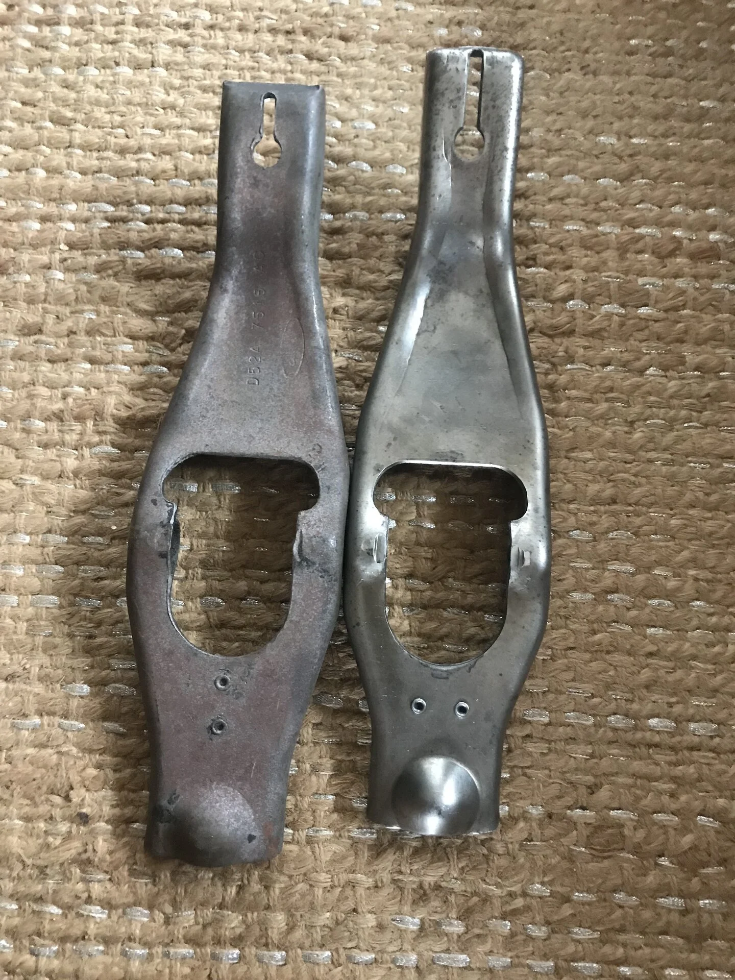

D52A 7515 AC (2.3) vs D5ZA-7515-BA (V8)
There are the same length over all, but V8 definitely has pivot point closer to trans centerline
thus the change in rivet direction
