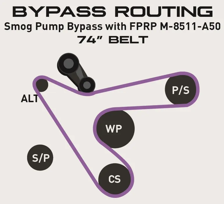

The control unit cover and the corresponding water pump are installed.
Can you see water flowing with the radiator cap open? I can't see anything. The radiator might not be completely hot yet, but the top was already quite warm, while the bottom was still fairly cool. Unfortunately, I couldn't detect any water flow.

One thing I thought of that may have an impact - you mentioned timing covers and an electric pump earlier in this thread. I would also like to mention, even though I'm sure you have already done so, is to make sure your pump is flowing in the right direction.
It may sound simple, but I think we've all been fooled into thinking that we had something right which proved to not be.
greenflash79
Mar 21, 2025
52
24
18
Deutschland
Jan 28, 2026
#29
  • Jan 28, 2026
  • #29
I completely agree with you.
I replaced the ECU cover and initially left my old pump installed.
After that, my lower radiator hose started bulging.
I have to admit, I wasn't sure if my original pump would fit the ECU cover.
I got the correct pump and installed it.
The old pump wasn't the problem, though; I had routed the serpentine belt incorrectly, so the pump was running backward (stupid of me!).
I have an '85 HO engine, which has a counter-rotating pump.
The radiator is new, the pump is a more powerful one and also new, and the channels are aligned.
Perhaps the thermostat isn't opening properly; I'll check it and then replace it. I already have two new ones.

Mein Riemen ist jetzt richtig montiert.

My thermostat opened yesterday shortly after 89°C, and the new pump did a great job. ;-)
Now I can build the electric fan.
