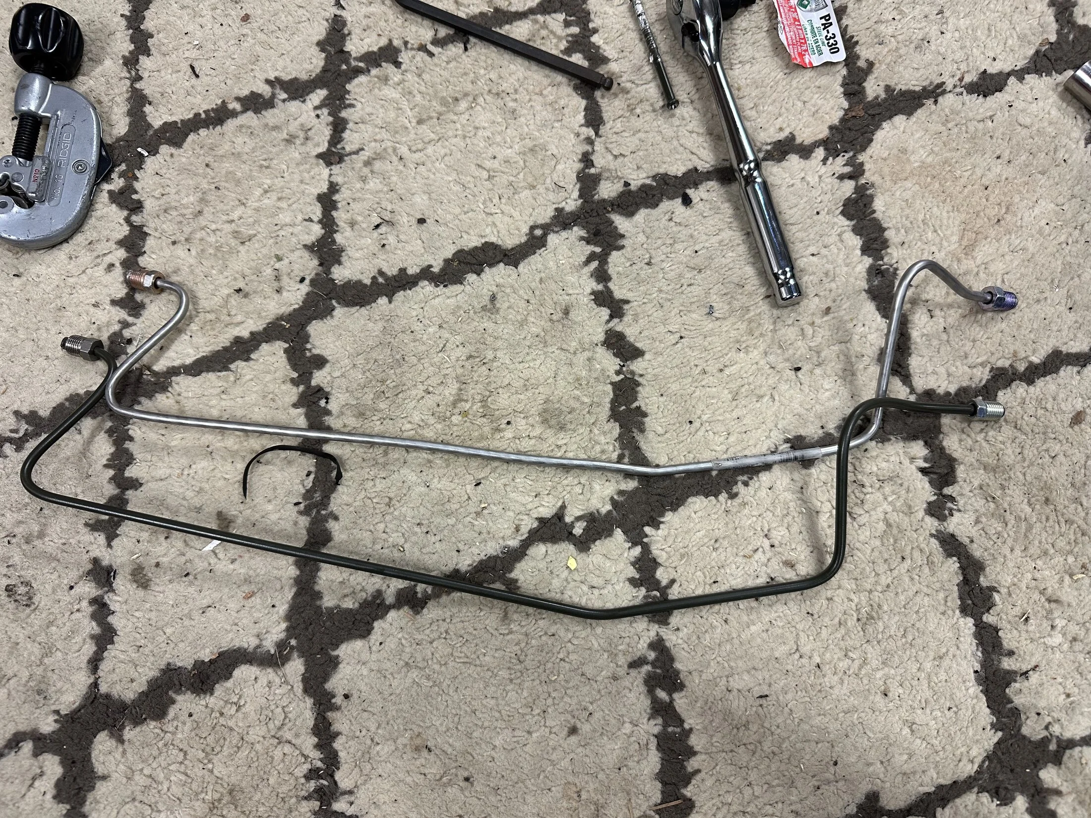

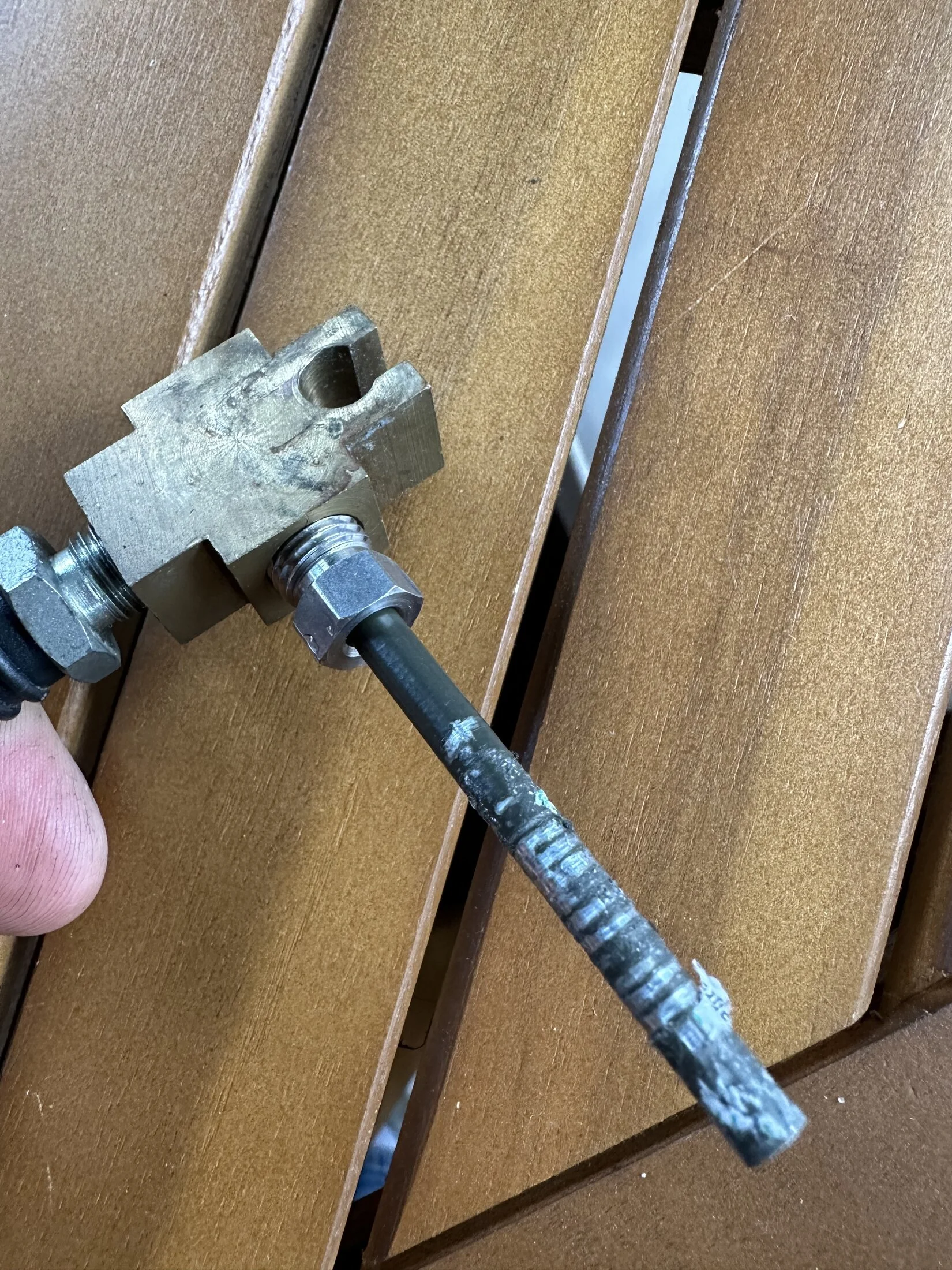

Managed to get the caliper end to seal up with the SS line. But was still leaking at center junction.
Got frustrated with it so Took the parts store coated steel line, bent it up. Cut and flared one end with the correct size fitting. Came out pretty nice for $7
Installed it and my flared end sealed nicely, and the factory end at the center junction leaked!!
At this point three lines have leaked. Gotta be an issue with the center block. Removing it tomorrow to inspect.

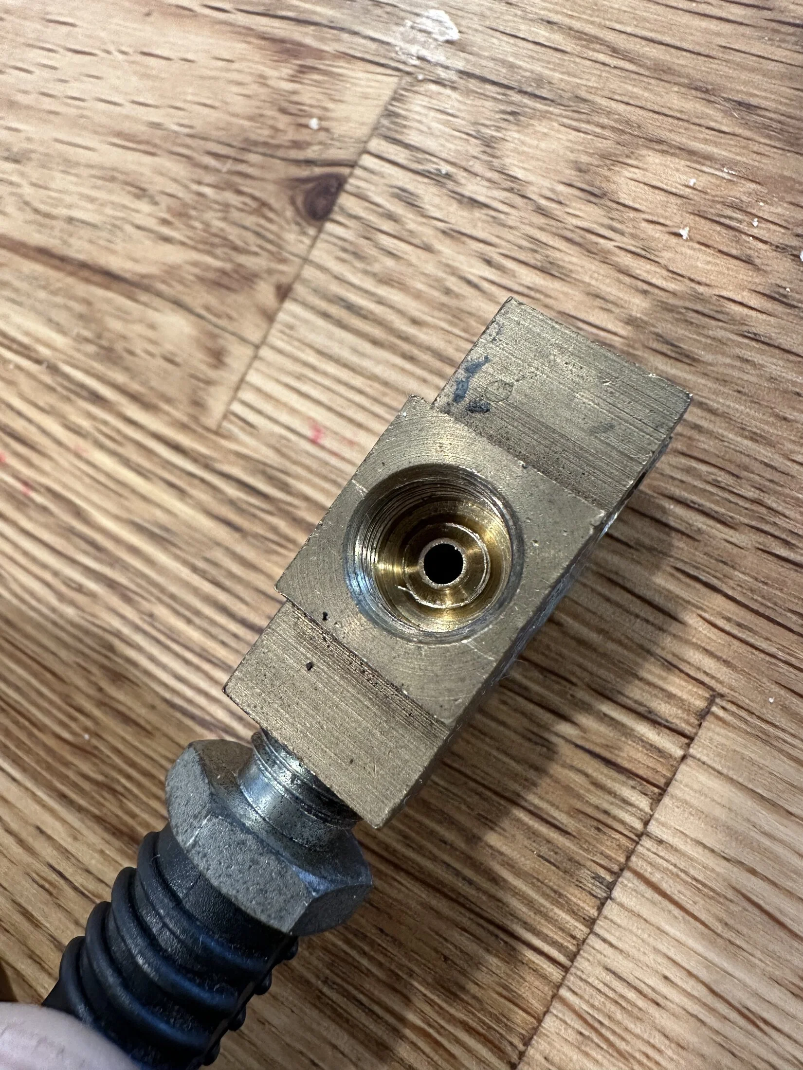

Pulled it off, which is a PiTA with the axle in the car.
Looks fine, and my junk line and fitting thread in fine.
But three different lines did not seal on this side. I might send MM an email tomorrow asking them about this and see what they say. I’ll also see if they will sell me just the block.
The entire line is $70 plus shipping but if the block costs me $40 plug shipping I might as well get a new line.
I also feel like I’ve seen those types of blocks before and it’s an off-the shelf part. I need to hit up Lord google.

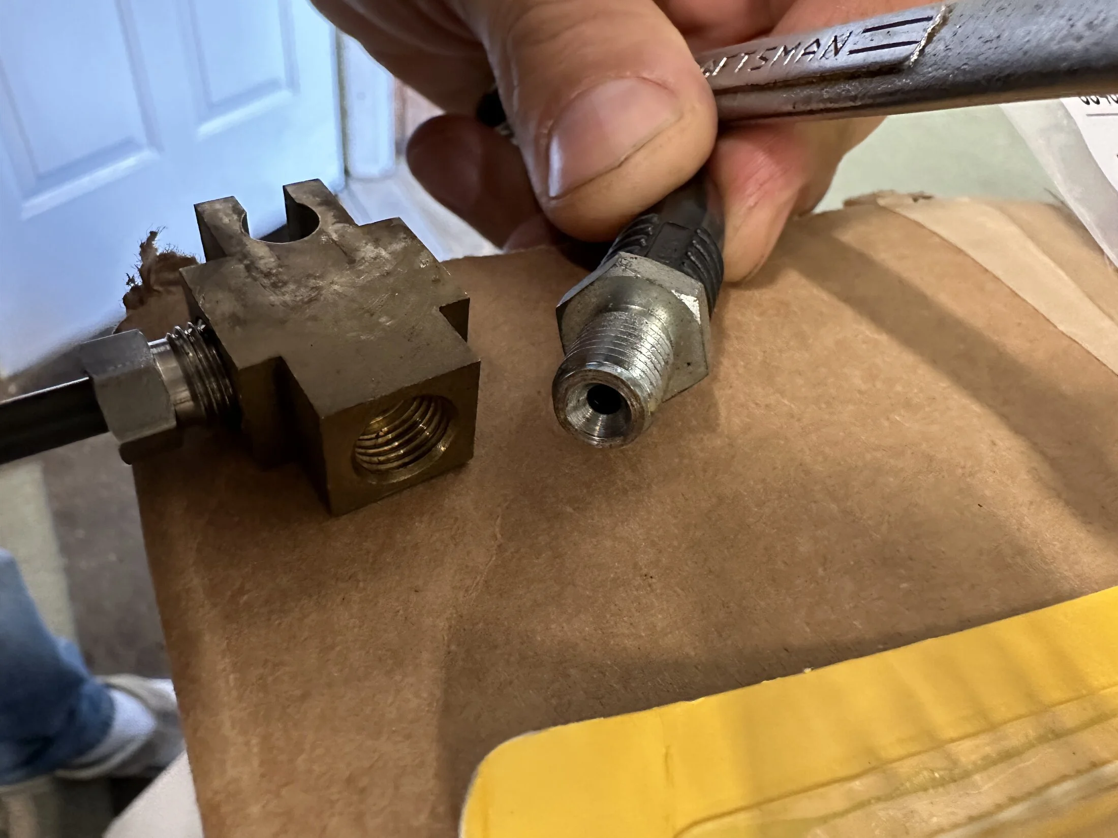

This might be it. Need to pull the SS line off to confirm what size fitting that is
Earl's 972050ERL Brake Adapter https://a.co/d/6H8cDGN
Here’s a cheaper one but I trust the Earls brand
Crown Auto-J0637432 Brake Tee https://a.co/d/5YWVAOo
Looks like right here the threads are getting stripped. Maybe one just didn’t go in right, and now none of them seal.
Reactions: General karthief and 02 281 GT

I was thinking that it doesn't look right to me. The sealing surface has been damaged and likely won't ever seal correctly again.

I agree. On closer look, it looks damaged. You can clearly see it when you compare the side that had the SS line on it. The two outlet connections look like the old lines seated and crushed and the new lines aren’t matching up.
Pulled the SS line off and it’s just another inverted flare. Should be easy to find.
Ended up ordering the Eaton fitting. Should work nicely.

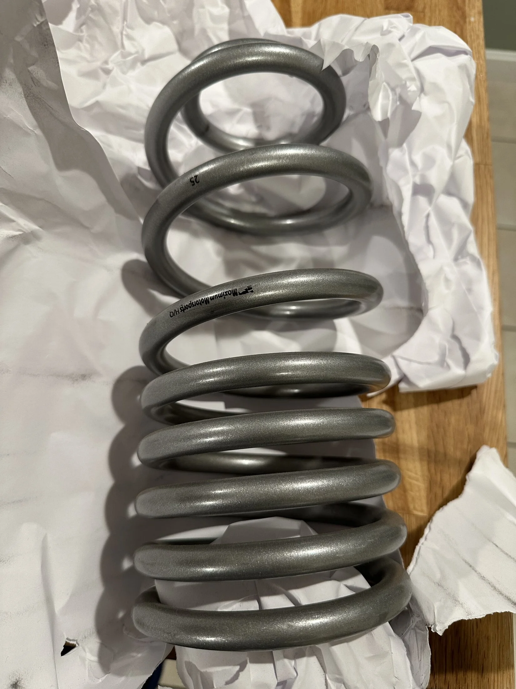

Also. Torque Arm specific springs arrived.
Will set those on my parts shelf along with the panhard bar link. I’ll prob wait until later this summer to order the TA.

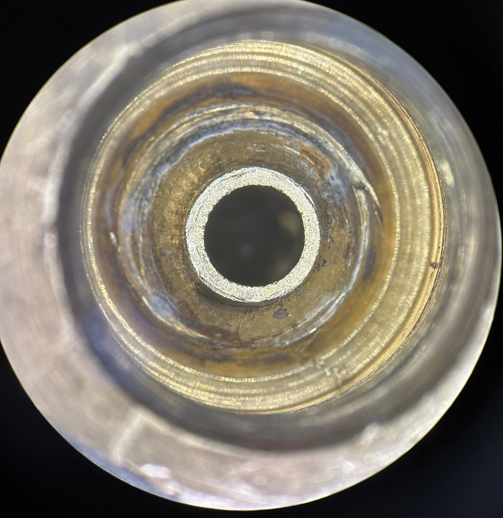

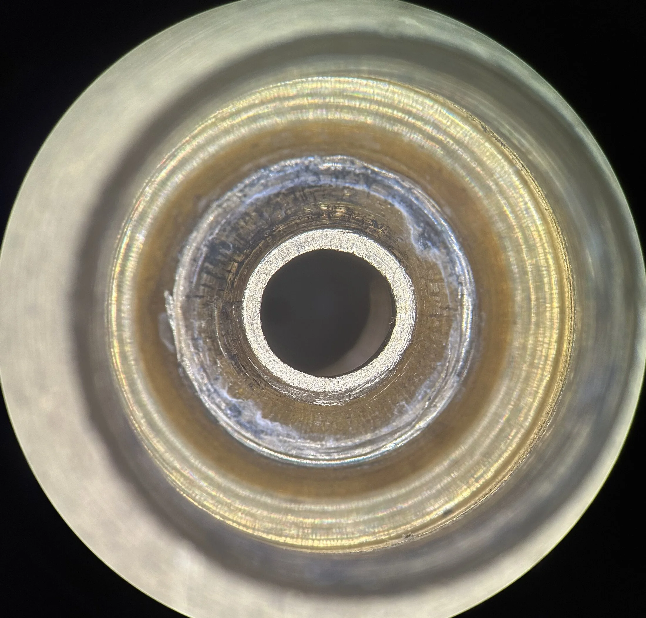

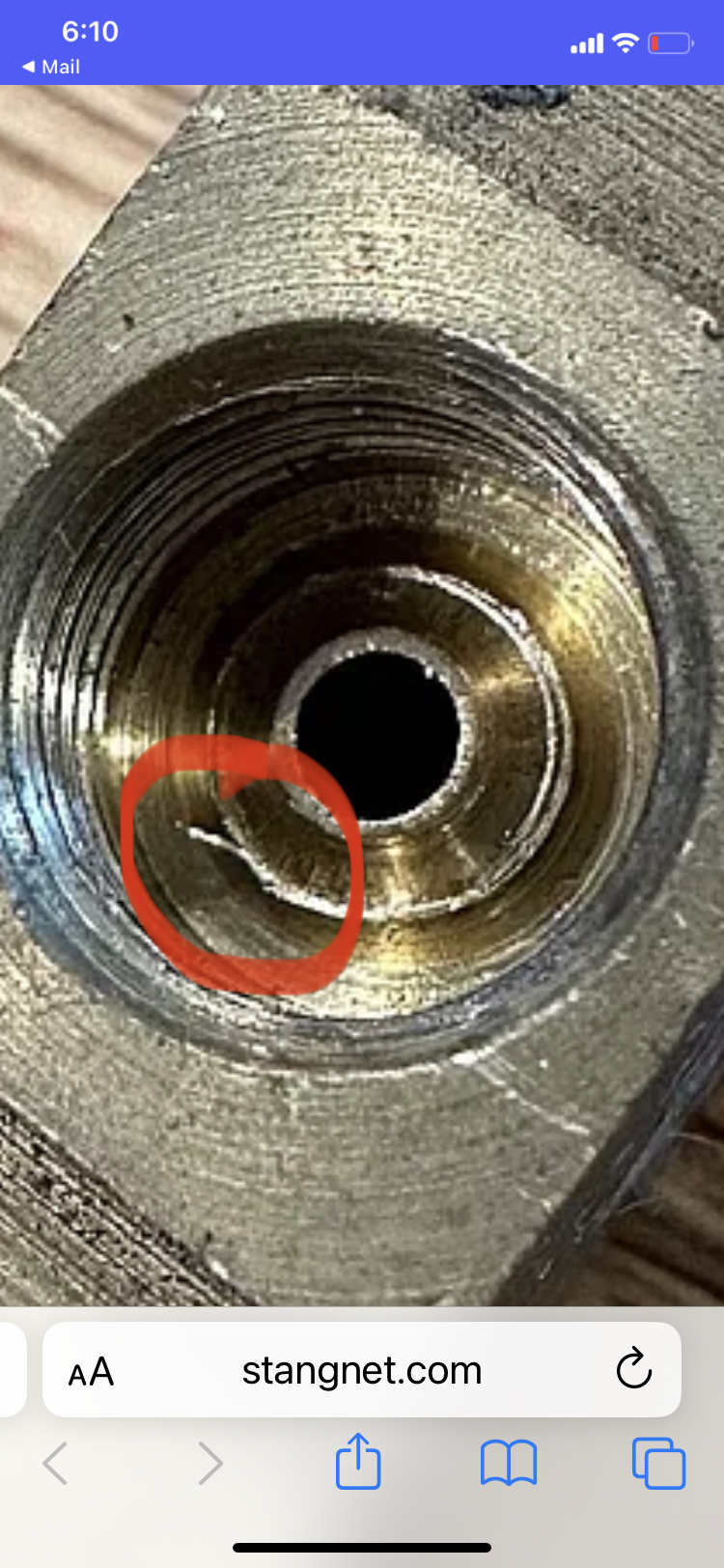

So i wanted to confirm that this fitting was the culprit, so i took it to work to look under magnification.
Using a Stereo microscope, I can see on the good side that there is a 360* witness mark of where the brake flare crused into the copper cone.
Good side
On the bad side, it looks like i might have tightened the fitting down slightly offset. When i crushed it down, it created an offset witness mark. You can see there is no sealing at the 6 oclock position. Once this deformation occured, there was no going back. This fitting is junk.
New one on the way. Kudos to LMR for sending me a second set of lines no questions asked, but it looks like the fault was on my end. I need to be very careful when i install the lines to make sure the brake lines are straight and centered before tightening them up.

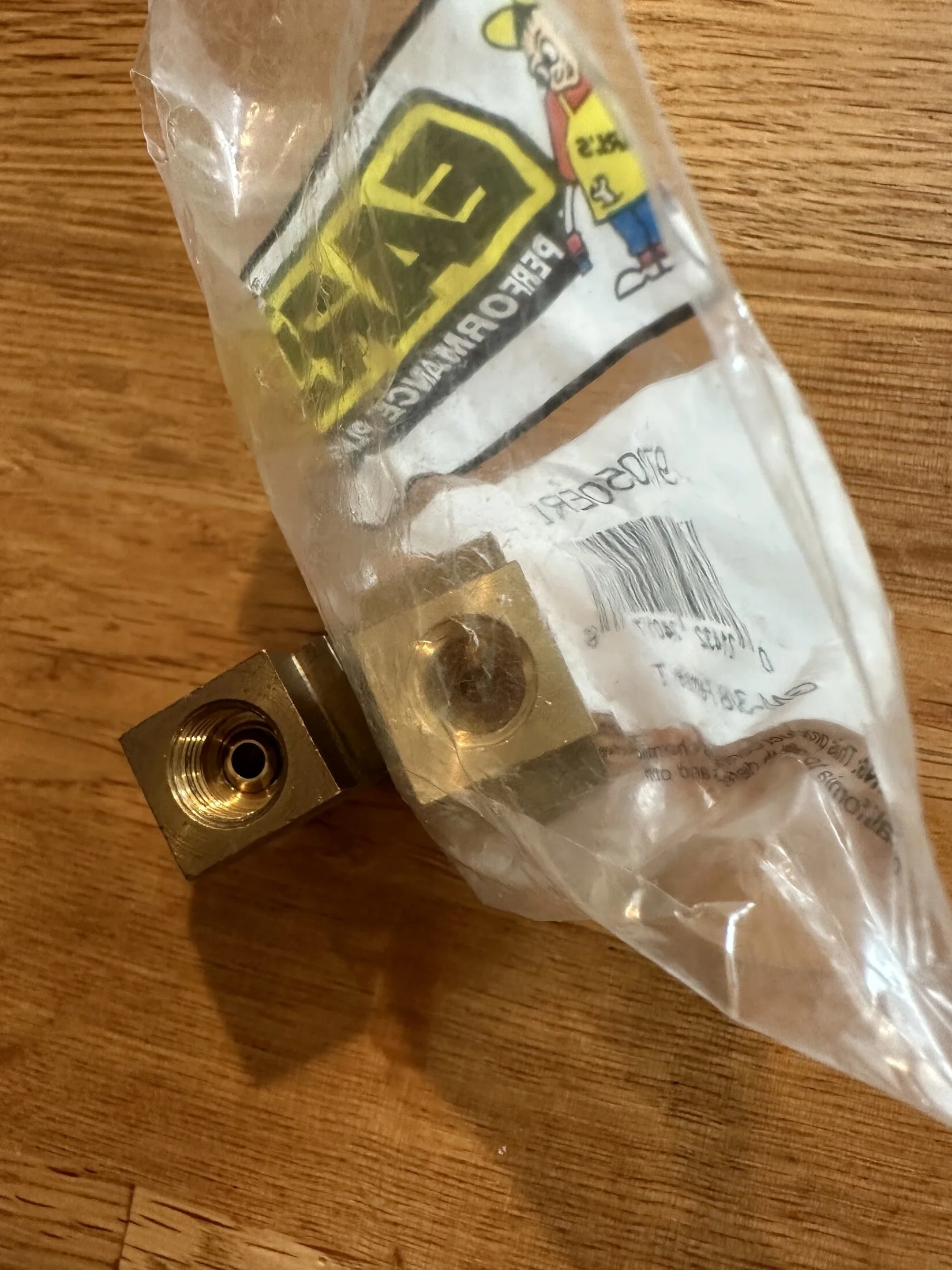

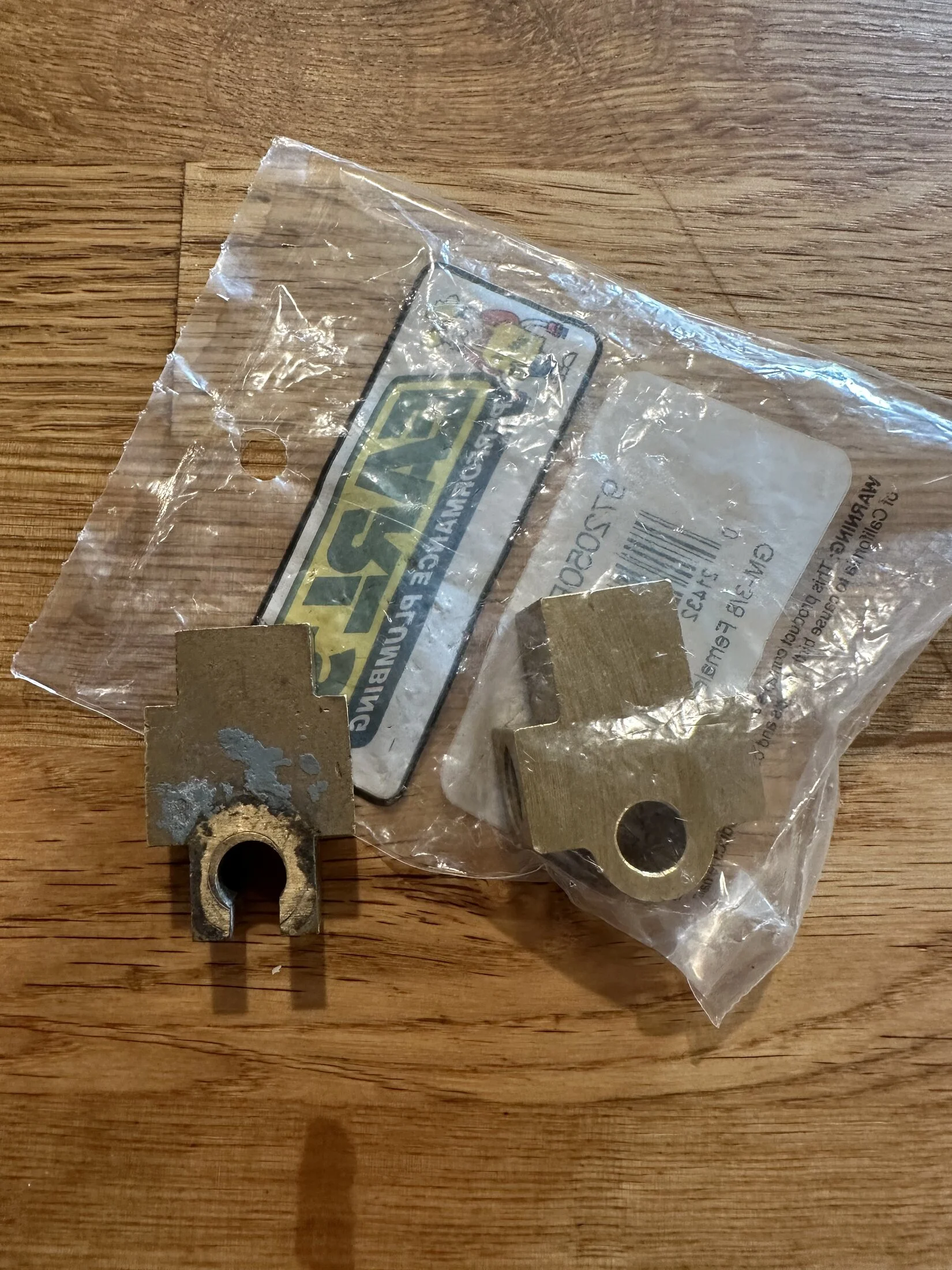

Waited over a week fgor this fitting...
and it's the wrong one.
Looks like it's only 3/8-24 IF on two sides, not three. One side is straight thread.
Back to the drawing board. Guess i'll dig around a bit more

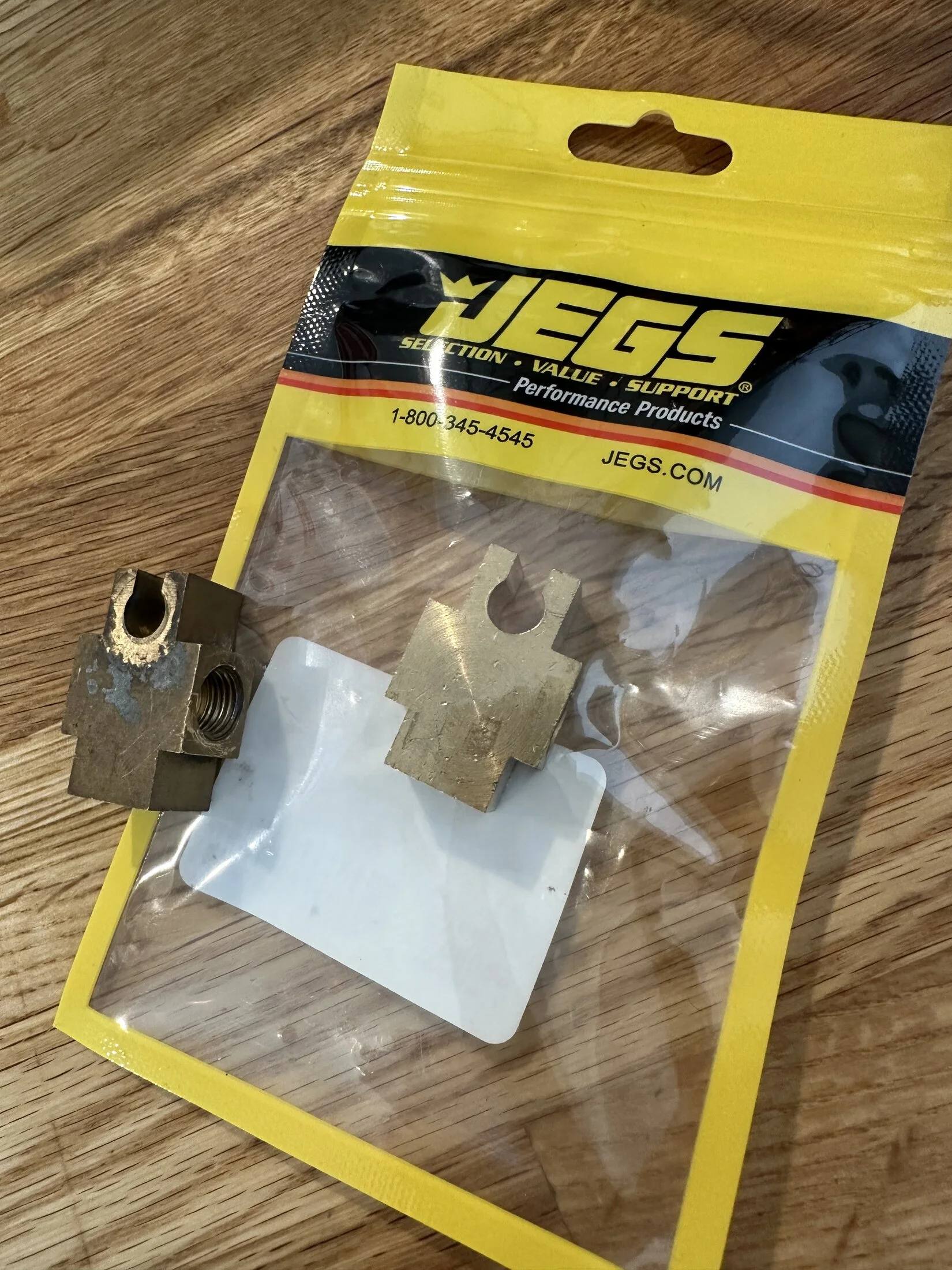

Found it! Same part as original.
Crossing fingers it’s in my hands before the weekend so I can get the car off the jackstands
https://www.jegs.com/i/JEGS/555/63080/10002/-1

Finally…the correct fitting.
Took a personal day for Friday. Need to get the brake lines on and bled and the car down so I can hear those Borlas
