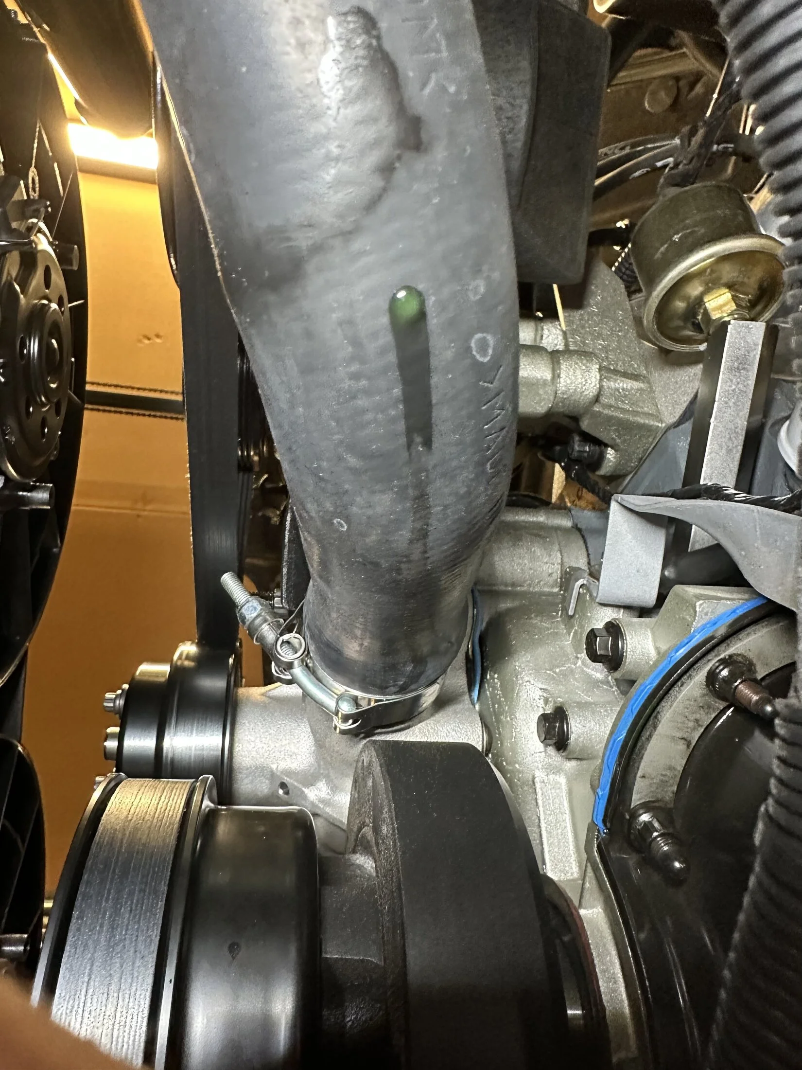

I think you just have the wrong type of clamp on that hose. That looks like a band clamp with a clasp and hinge.
A regular ole hose clamp will probably seal it up.
Yeah. This style just looks nicer, but as we can see, probably not the same amount of clamping force.
Will probably swap to the regular ole style as I don't want to keep dealing with this sort of leak.
Yup, those are what I have. Definitely need to get thinner ones for a bit more clamping Force.
Got the bike running. Just needed some starter fluid to get the flow going through the carbs. It doesn’t run well (struggled to climb in rpm) but I drove it around the block.
Now to fix this coolant leak

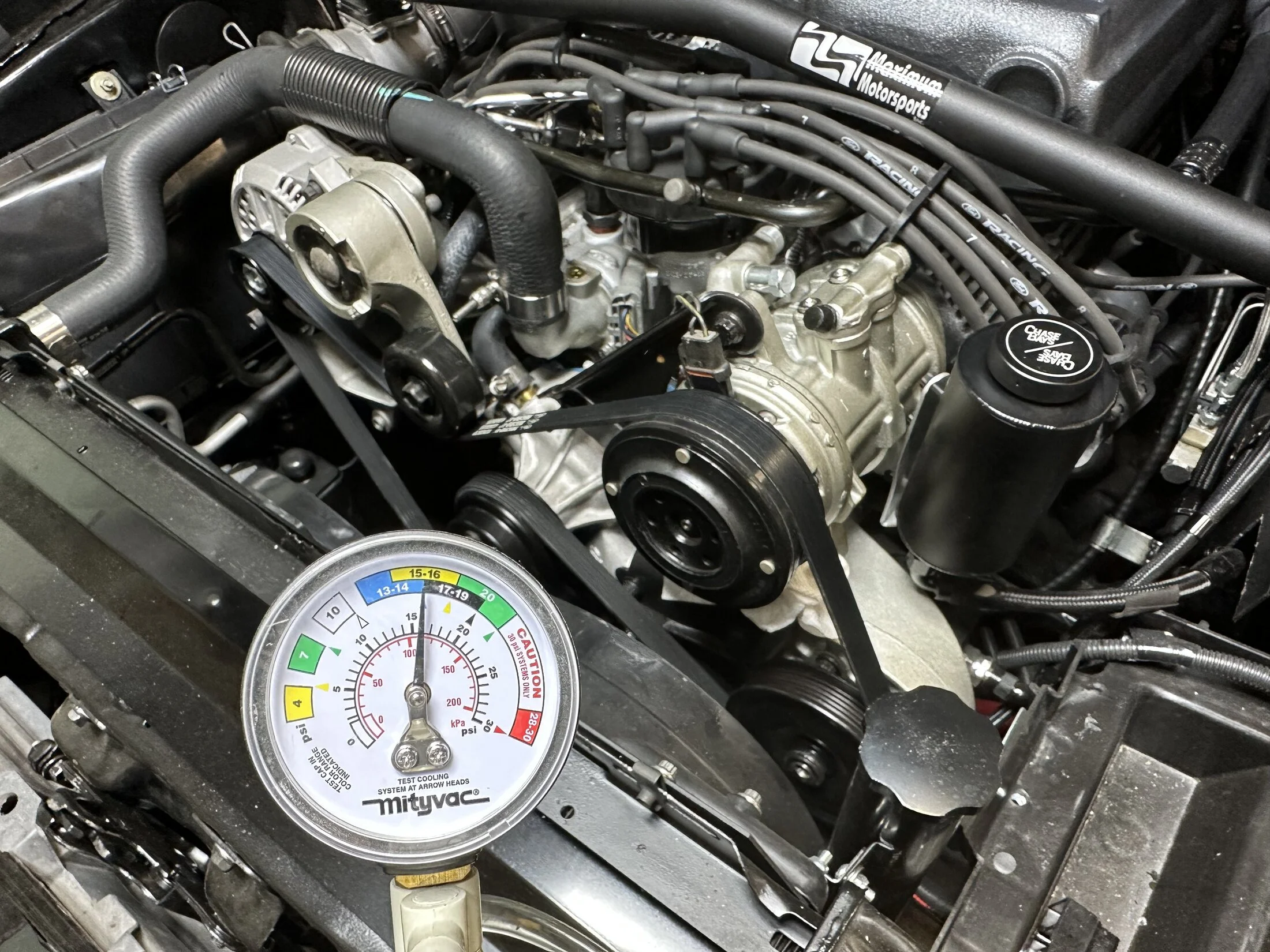

Tightened up the hose clamps a bit. I repositioned the leaking one and went pretty darn tight. Hooked up the pressure tester and it held for a while.
Put a heat cycle into the engine so got an idle clip.
I’ll retest in a few days. I’ll probably track down narrower clamps and replace them. These ones are 3/4” wide. I don’t want to deal with nuisance leaks down the road.
Edit: looks like the diameters are stamped on them.
Tstat : 2.125”
Top radiator: 1.50”
Bottom radiator: 1.50”
Lower water pump: can’t see it

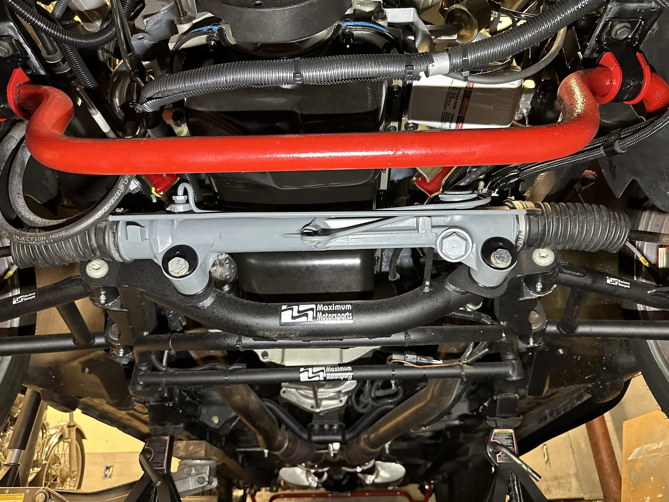

Under the car today. Pass side brake hose was the one that was rubbing. Tweak on the bracket and that was all set.
I also made a toe adjustment to center the steering wheel. I have a method of setting toe and centering it on this car, so today made a small tweak.
Inspected the underside. My oil sensor block off plug was leaking a tad. Ironic I know. It was a tiny bit loose so I wiped it clean and tightened it up. Will check later. I should do an oil change. It’s been over a year despite the 10 miles or so traveled. If anything, I like seeing what comes out.
Checked for coolant leaks. I did find this drop on the lower hose. Unsure if it was there before I tightened the clamps up. I snugged it up more, so will need to check again. I should really just replace these clamps…at least the bottom two. Nobody will see them.
Overall no surprised. Everything seems clean. Did not drive the car today. Just too much to get done around the house so was surprised I got this done. However, closer to being fully Road worthy. I admit, I got distracted by the motorcycle. However that is back to being turn-key. Just need tires and that will also be Road worthy. It runs well (although needs valve seals)
All you get is this underside shot

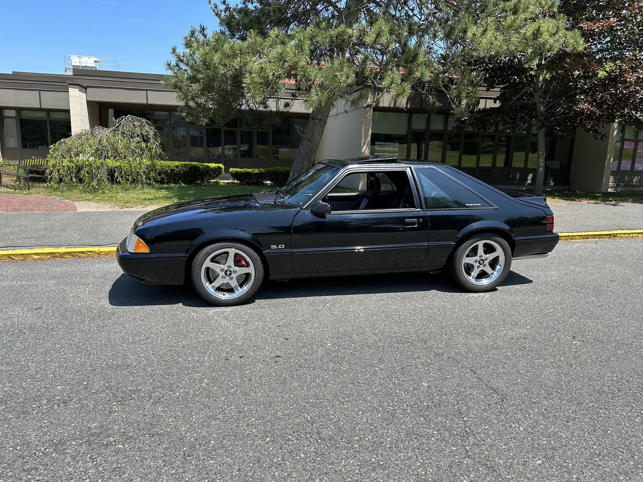

I did a solo drive and finally got on it and let the TfS170s breathe. It was quite fast. Much faster than it ever was stock that’s for sure. Obviously that’s what should happen but it was nice to get validation that I put everything together correctly.
A/C still working nice. Such a game changer cruising around on an 80+ degree day with cold air in the face. Car really didn’t feel any slower with the ac on vs off.
