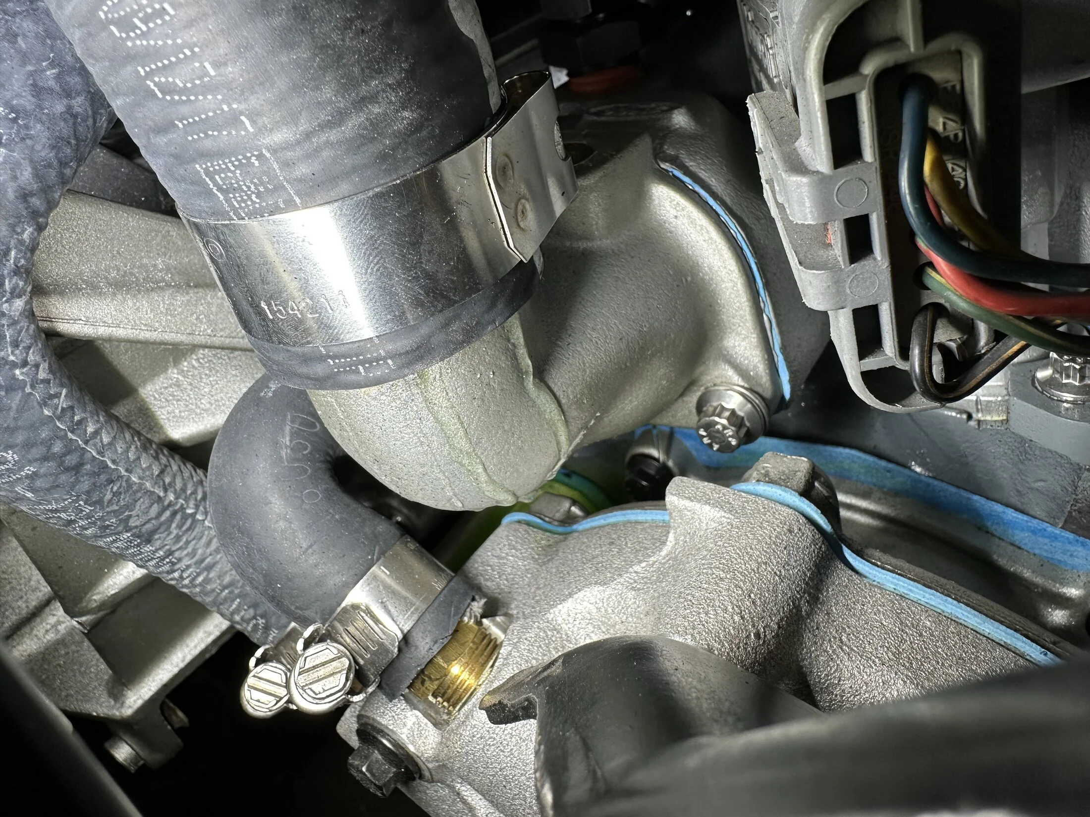

Coolant leak. Looks like front corner of the lower intake. Noticed I was a tad low on coolant and after moving the car from the garage for the first time since fall, seemed like there was a small puddle on the ground.
I don’t want to pull the lower, so I retorqued both front corners. Hope that holds….

I found out after resealing the top end on my Grand Marquis that the lower intake bolts definitely back out a bit and need a retorque after a couple heat cycles. A few of them needed several turns to get tight again.

I should pull the upper off and go through them all. I just did the front ones, but they needed a little extra snug.

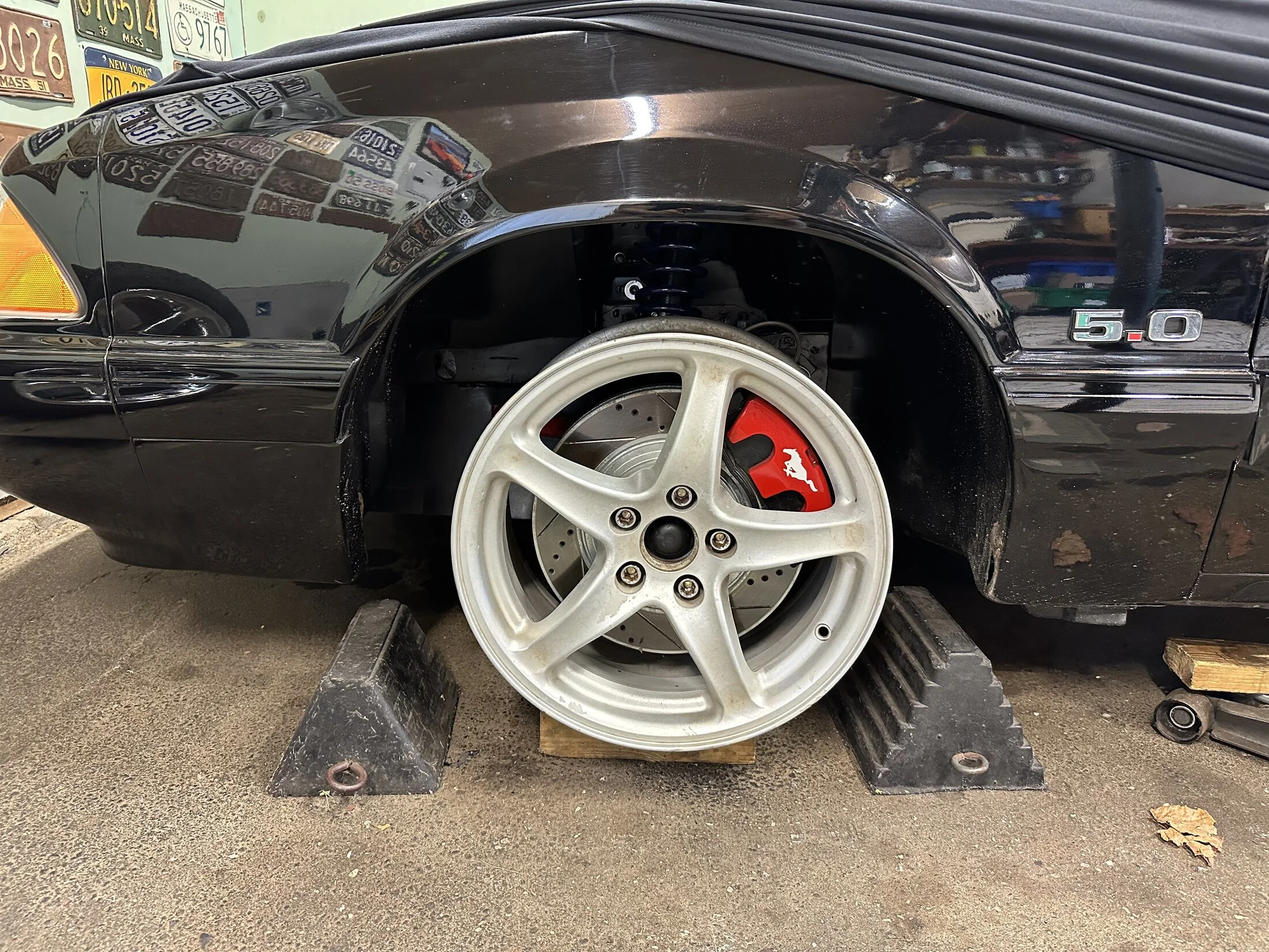

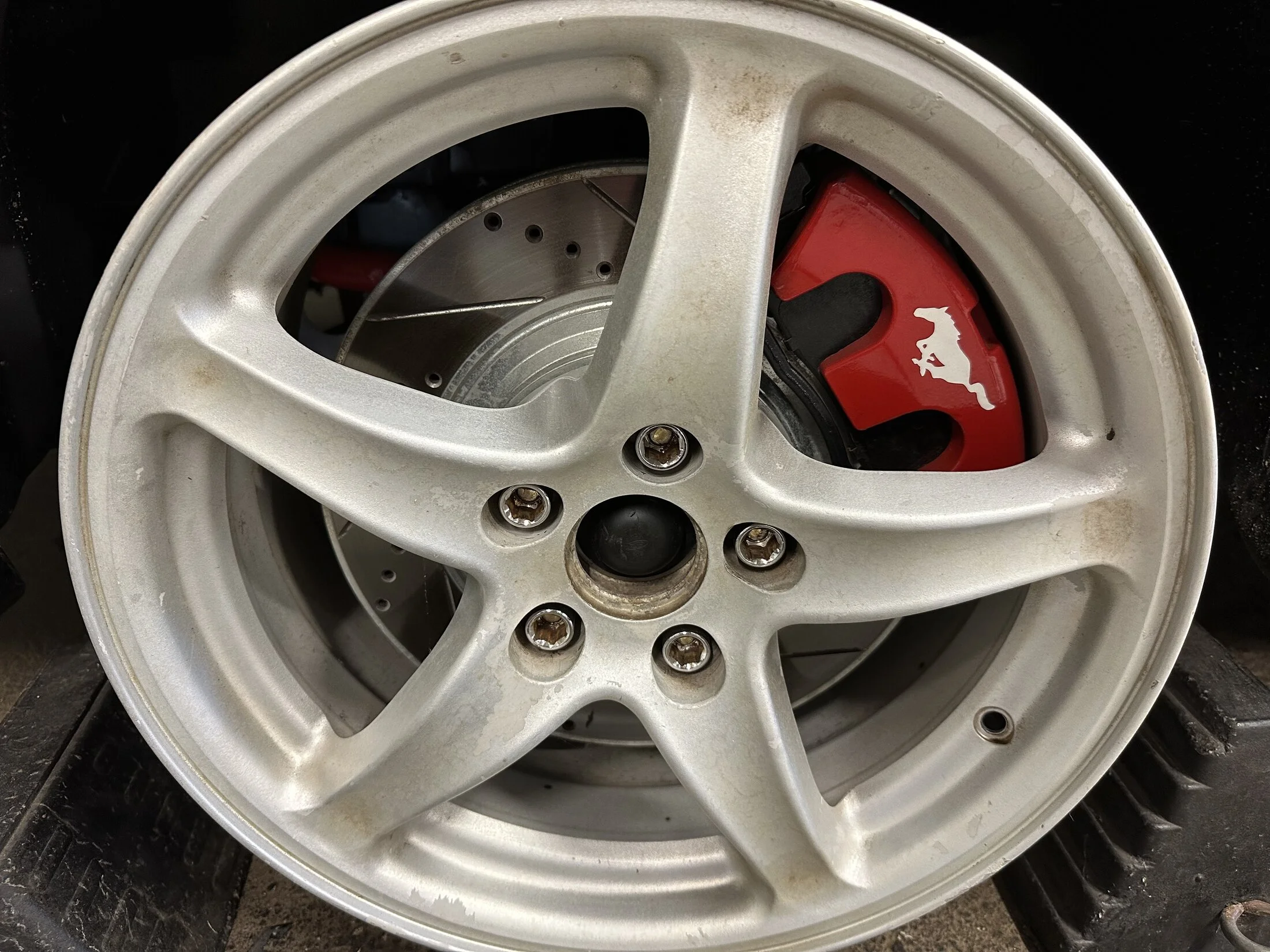

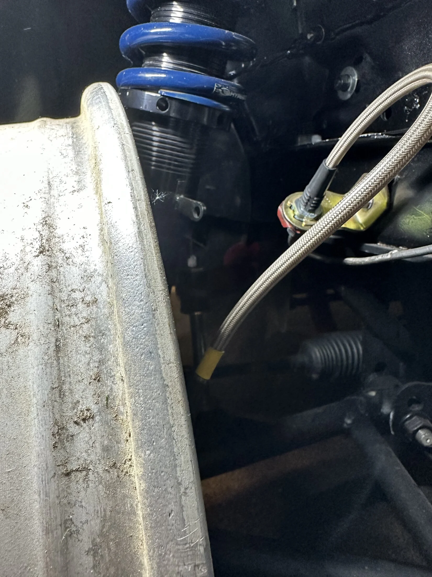

Wanted to check off a few boxes for things that were preventing me from cruising…mainly the front brake line rubbing on the wheel. Thing is, I forgot what side it was.
Pull the drivers side wheel on since garage parking allows easy access. Nope. Wrong side.
Plenty of clearance on this side brake line. The wheel clears the coil-over with plenty of room. My 9” wheels will have more clearance. Gotta check the other side a different day now.
This 98 cobra wheel is my junk wheel. Needs refinishing and the rim has a small crack on the backside. I was actually going to have weldcraft cut this down to 5” and make a spare tire out of it, but my other solution was cheaper

On a more serious note, still dropping coolant. I started the engine up a few times since and let car warm up (and went around block)
The lower intake is now dry. No leaks there, but I’m still loosing coolant somewhere. There’s a wet spot under the car and level is low. This is a new development as all summer long last year this level held.
Might have to pressure test and put the front on jackstands and poke around.

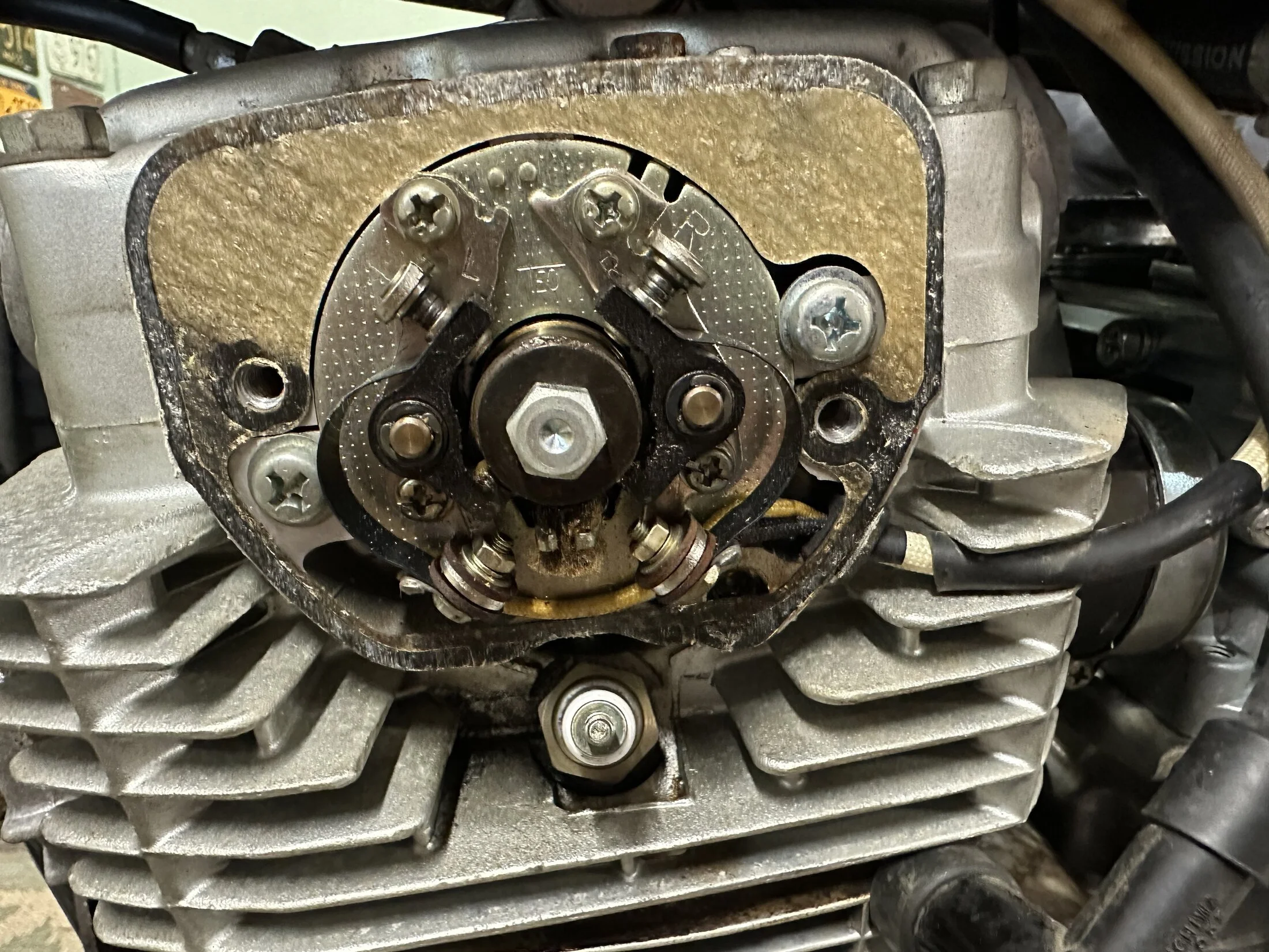

In other bad news…

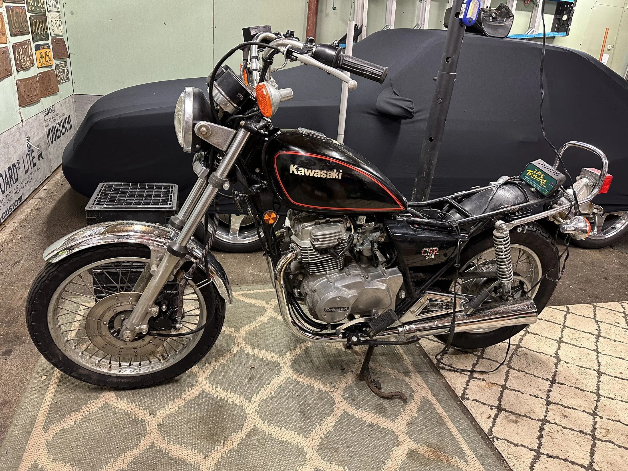

Cleaned this up. Trying to get it fired up and won’t start. Have fuel air and compression. Spark seems weak. It will spark from boot to screwdriver to head, but when I plug in the spark plug I get a weak spark. Non-existent.
New plugs on order but everything is sloooooww.
It does clean up nicely though
limp

Mustang5L5 said:
In other bad news…
I would check if the mag has points in it, if so clean them..... I also had some rust develop on the inside of the flywheel once and the magnets would not develop a "strong" spark until I cleaned up the flywheel.... I chased that one for a while as it had spark, but it was a weak spark too.....

Already tried to chase that done. Cleaned up the points real well. I can see sparks jumping. I did order a new set so I can try replacing them.
I’ve got new plugs, points and condensers on the way. The coils ohmed out ok. I’m throwing parts at the problem which I hate doing, but my usual checks aren’t giving me any leads.
I’ve got fuel as I can smell the gas in the cylinder and the plugs are getting wet. I have air, and compression is 140psi cold which is well above spec. Spark just seem iffy. I haven’t gotten it to fire once at all.

Left you the same message " Elsewhere " but new plugs is where I would go... Fouled motorcycle plugs never seem to fire again...
Kawa 500 Ieft the choke on too long when cold starting.. Fouled the plug and never even popped again... New plug and it fired right up

Not spark. It’s gotta be fuel then. I’ll have to go through the carbs again.
New plugs give a nice fat spark now. Can clearly see it. No fire.

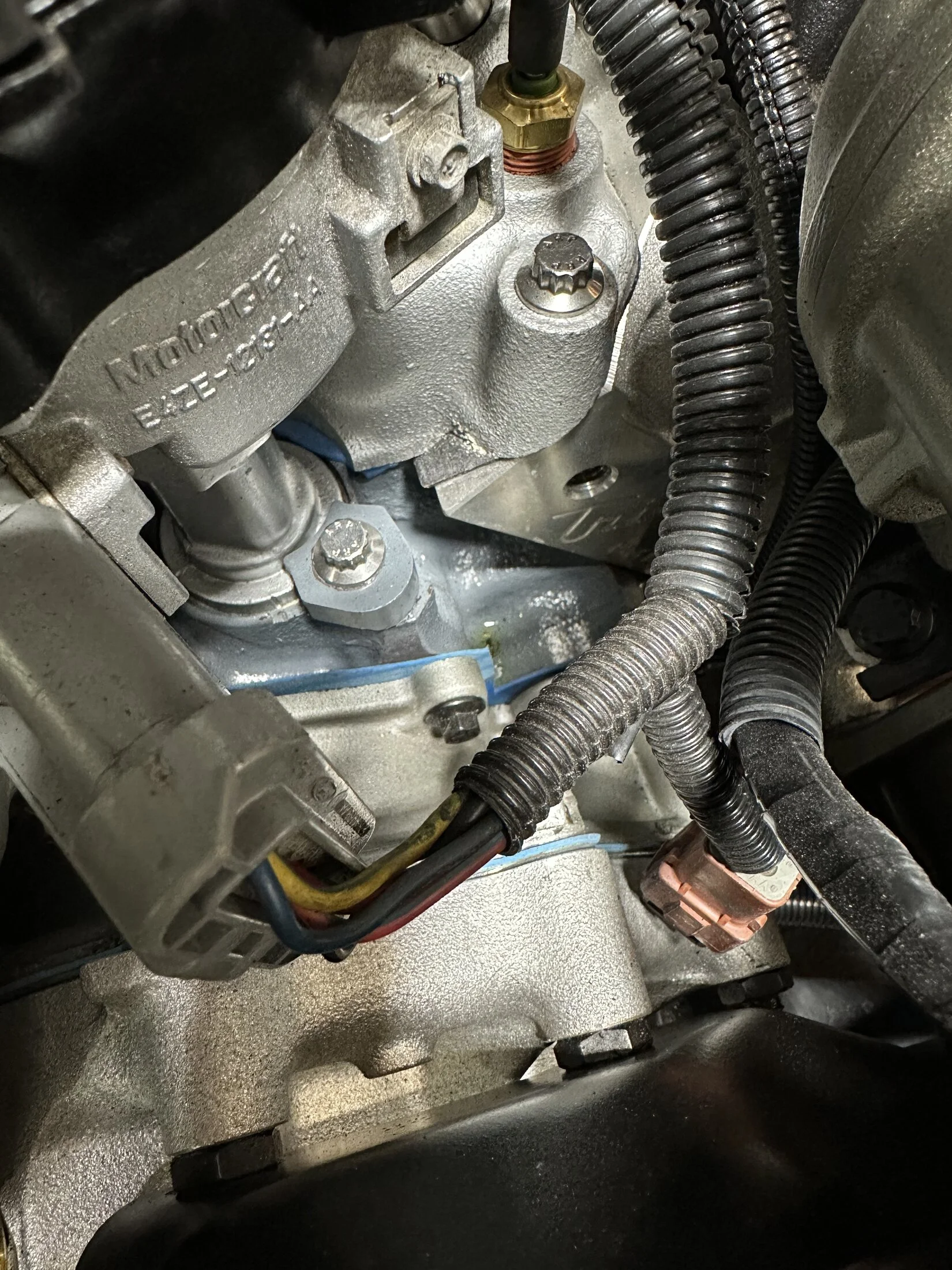

borrowed a friends coolant pressure system. Started pumping up.
At 11psi, I heard a nose and heard bubbling.
At 16 psi I heard the coolant hitting the ground and found it.
Coming from the radiator hose on the t/stat housing. Had to hop on a work call, but need to clean this up, tighten up the clamp, and retest. This clamp might be too wide, and I might have to get something a little skinnier that will clamp down a bit tighter. Hopefully it’s easy.
