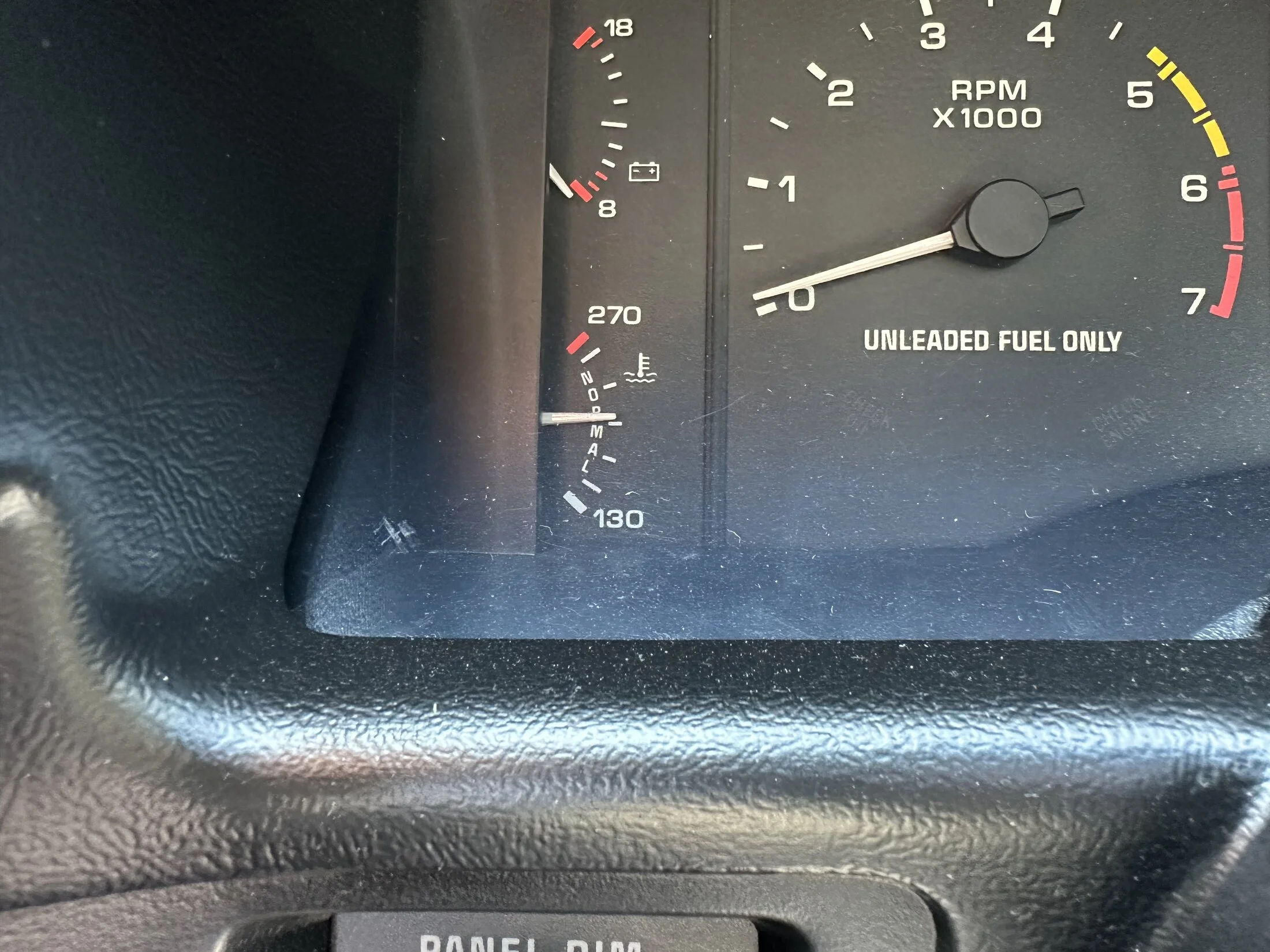

I am also going to change the thermostat. I’m not likening this stock temp Motorcraft. It’s slow to open so I always get a high spike, and then the temp drops. I verified with the mechanical temp guage I’m hitting 200 degrees before dropping, but this just drives me crazy.
Temp climbs to cover the R when it initially warms up. When tstat fully opens, it drops to A. However it’s like a seesaw. Then it climbs back to R and then down to A. Very slow to respond.
I still have my old 180. I’m going to put it back in. It warmed up to A and then stopped. Was a constant 185-188 degrees on mechanical temp guage. Was fast to respond and stable.

200* just isn't a problem, man. Let it rock. My all aluminum C5 corvette motor didn't turn on the fans until over 220*.
I know, but after years of seeing it down by the A and running at 190 degrees, I just prefer to go back.

I have a stock Motorcraft thermostat in my 89 and it does the same thing on the colder days. Warm days I do not notice the up and down as much.

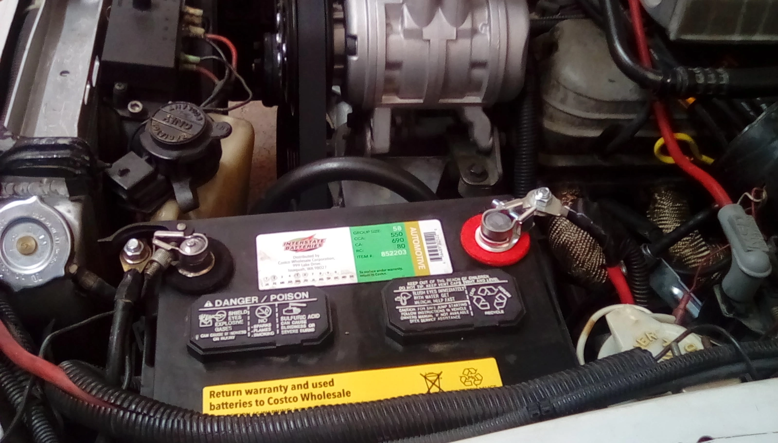

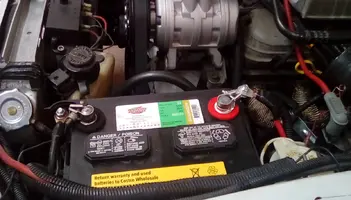

As for batteries, I am running an Interstate from Costco in the 89 that I got last summer. I had to replace the battery in my Saleen on Monday after 5 years. Costco does not carry the group 56 so I went to the local Bi-mart and got an Exide. Not sure if Bi-mart is a chain past the Pacific Northwest or not. 3 year warranty. I want to say Costco has the better warranty but I don't remember what that is off the top of my head. Costco definitely had a better price for the battery in the 89 that anyone else did. It was like $85 after the core. Paid $124 for the Saleen battery on Monday, after the core.

81.99 (todays price) at Costco for Interstate group size 58.
I’ve had mine since Dec ‘17.
Just threw a meter on it and it’s 12.4V. A hair low, but still cranks the car over with no problem after 5 1/2 years.
