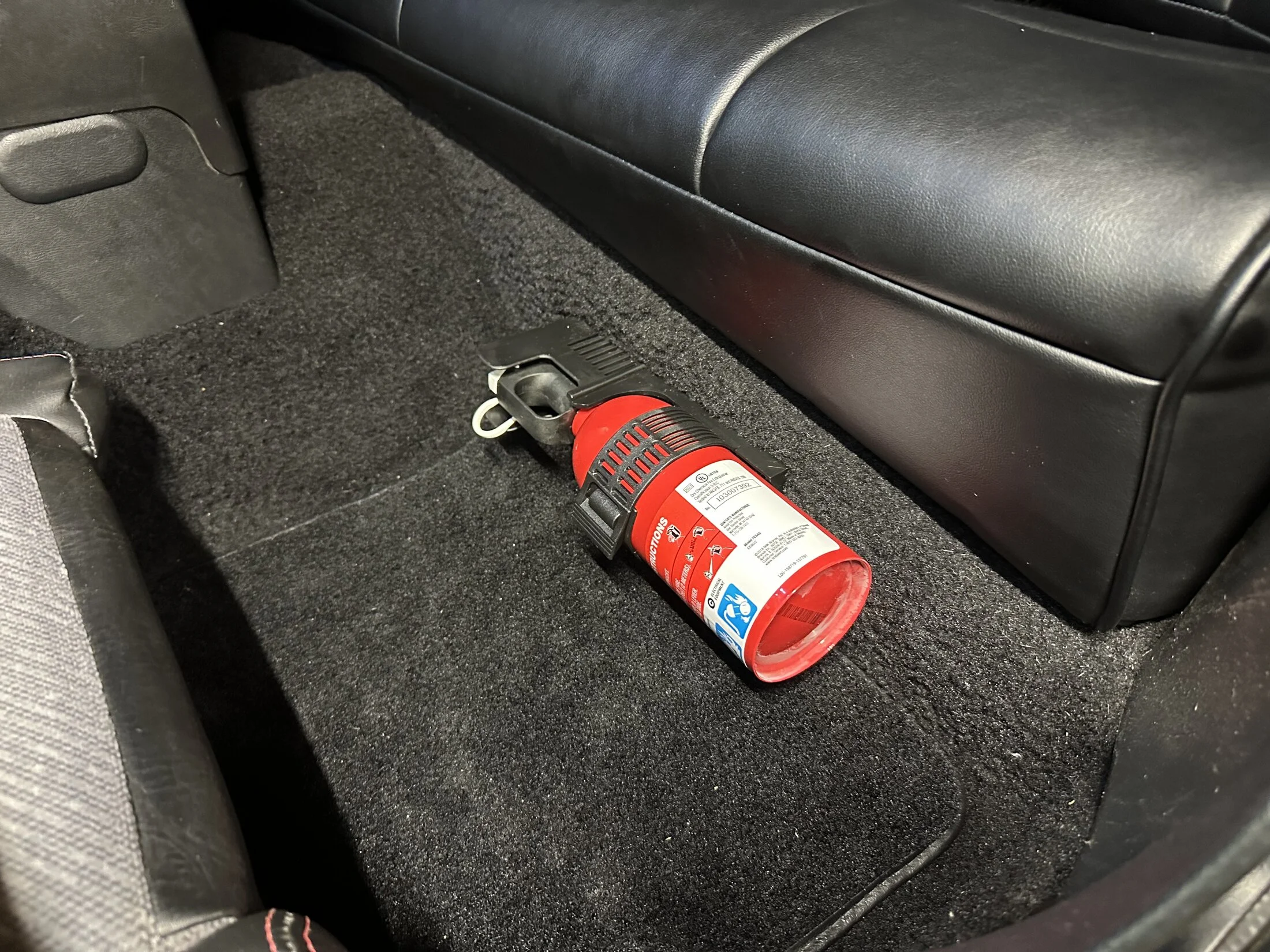

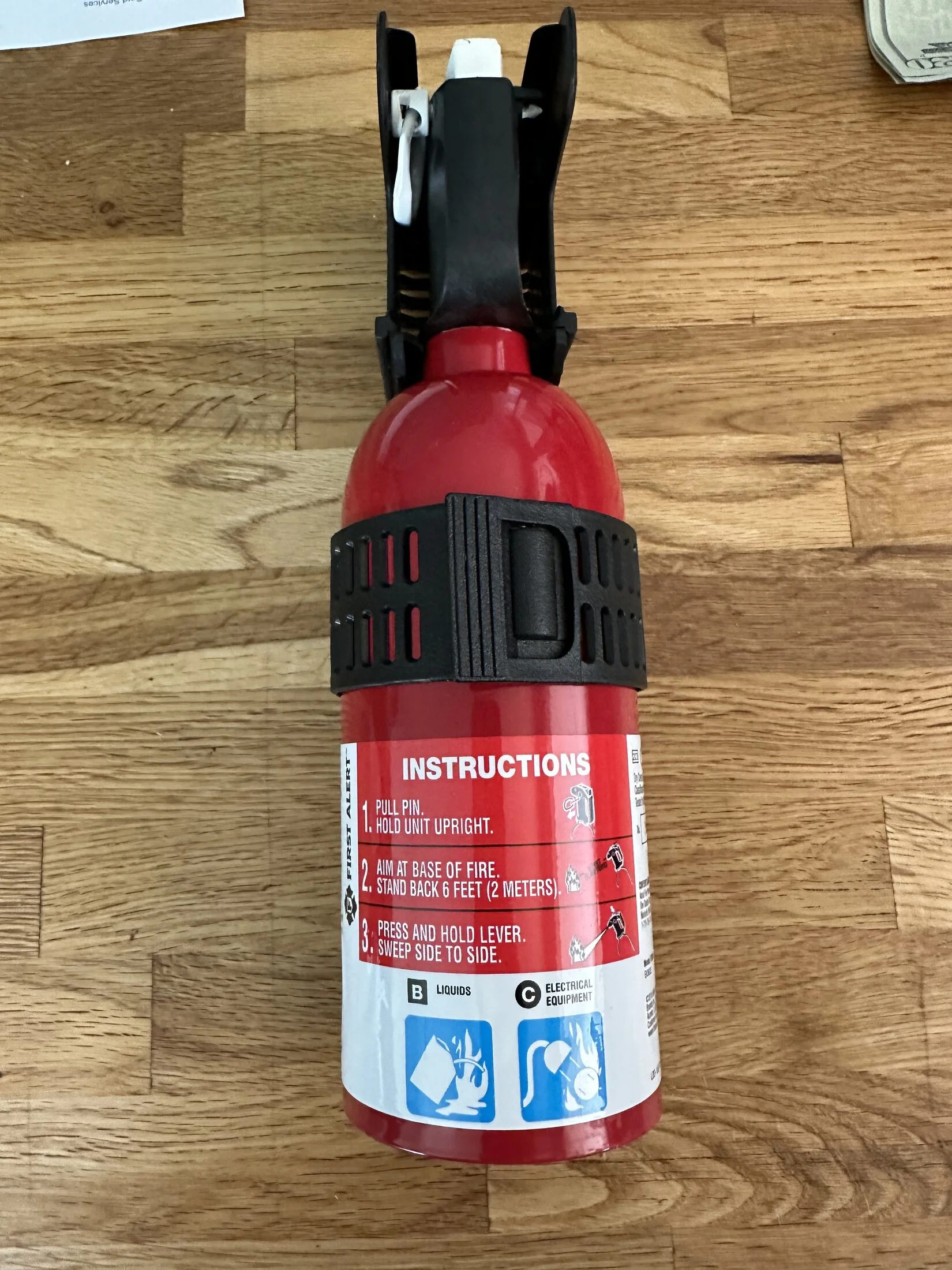

Picked up a key accessory for driving. Got it off Amazon for $25 or so
I mounted it here. Hated the idea of mounting something in the interior but it’s a necessary evil.

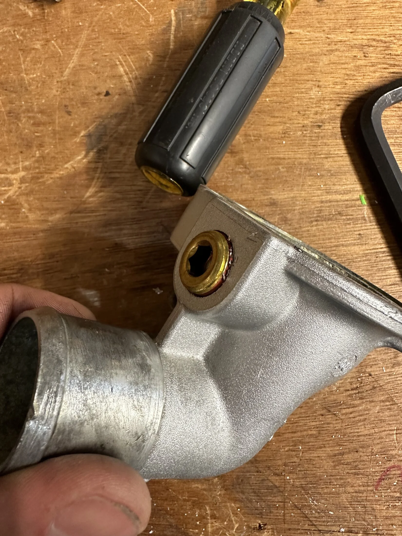

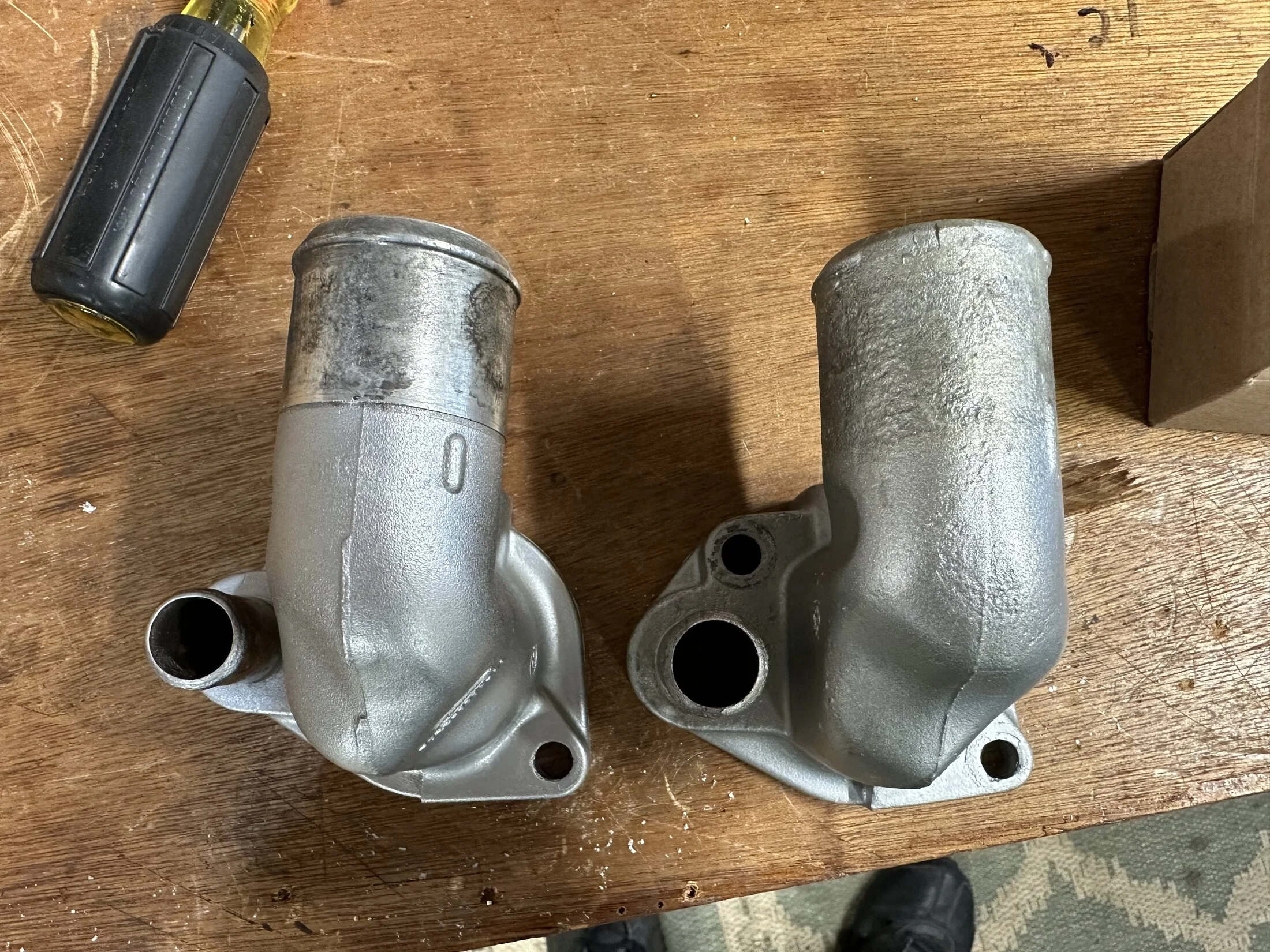

Arrived. Cleaned up, painted and tapped for a 3/8” not in case of future need. Now to get it on the car and fill with coolant.
90+ on left. You can see the subtle difference with the one on right that came on my car….other than the pitting
