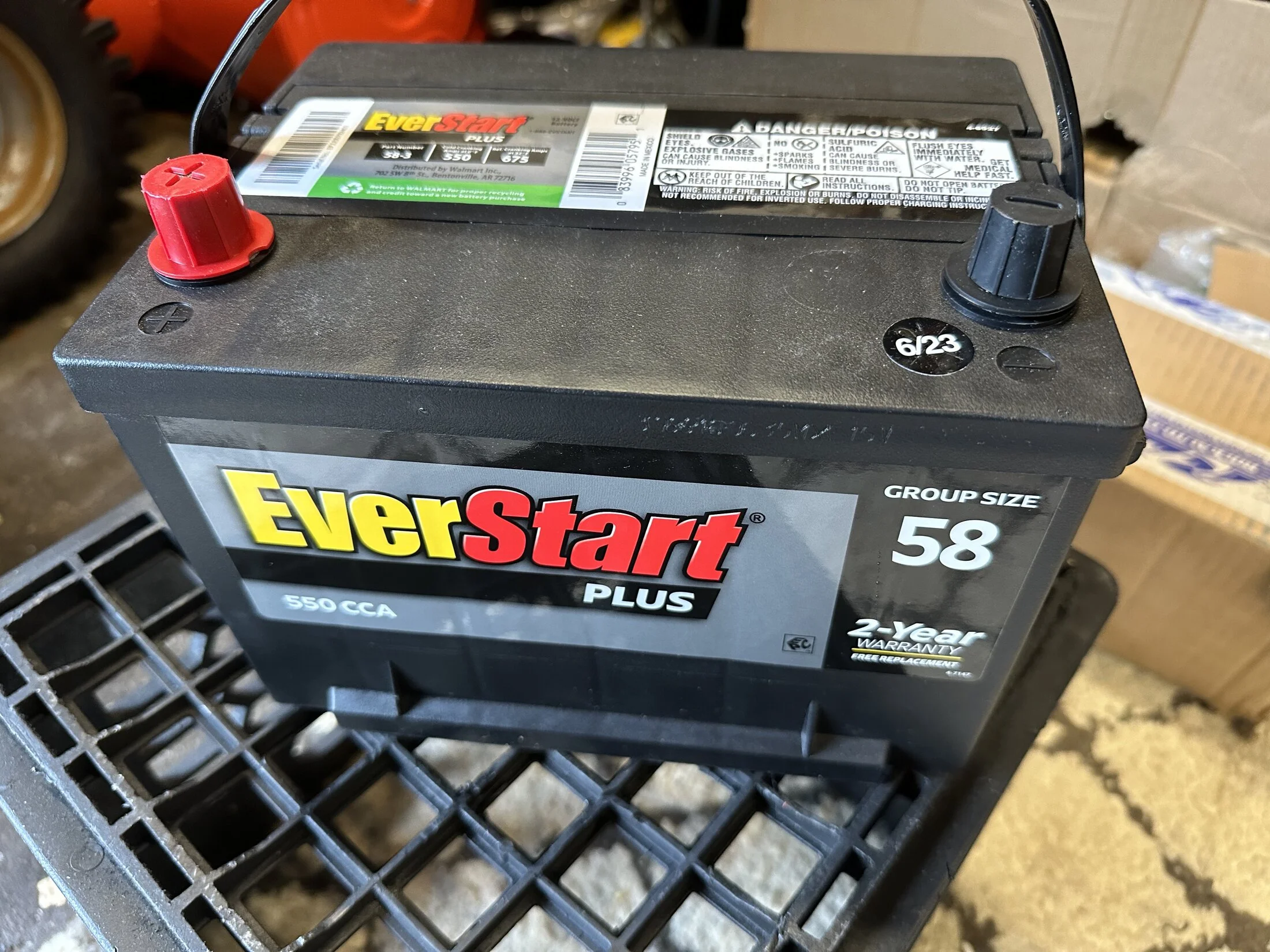

Swung by Wally world on the way home. Picked up a fresh 58-3 battery for $110. Now i can ditch the 10-year old battery which is failing (evident by the terminals turning black)

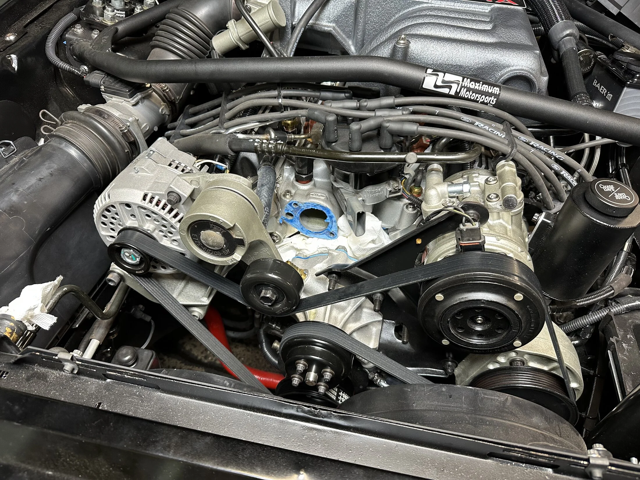

Oil change. It’s been over a year plus I just want to keep tabs on what comes out.

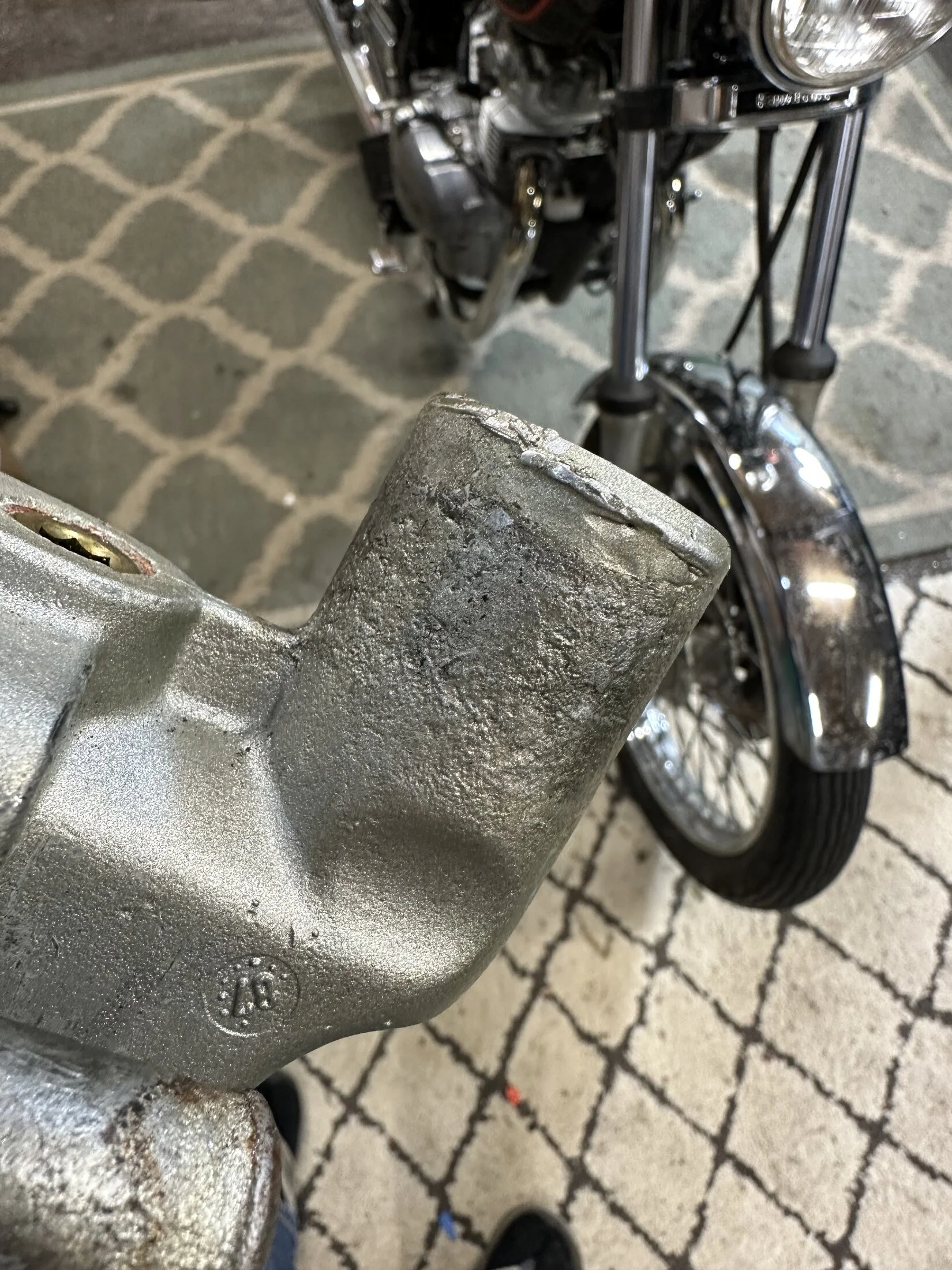

Then I dug into the tstat change. Going back to the 180*
This might be why my rad hose leaked a tad here. I should see if I can find a replacement or repair this by smoothing that all out with JB weld
Edit: after searching around, looks like this is an outer D9 housing that ran to 1989. The F0ZE 1990+ neck looks like it has a revised hose “barb” so I’m gonna pick up a clean one.
My original to the car looked like that and I remember fighting bad t stat housings throughout the years... I coughed up and purchased this one from LMR.. Not running yet but its a very nice piece....
