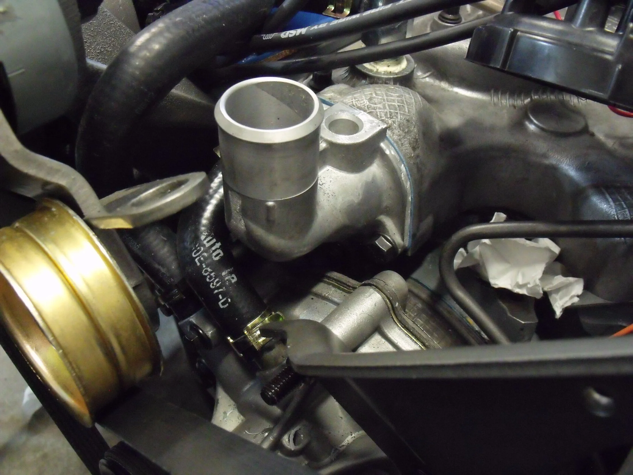

Here's the same RH37 housing at NPD.... only $290!
https://www.npdlink.com/product/hou...mber-fozz-8592-a-fozz-8592-b-rh-37/165174[/UR
http://I should be able to sell a crusty old used one for a $100 :nice:

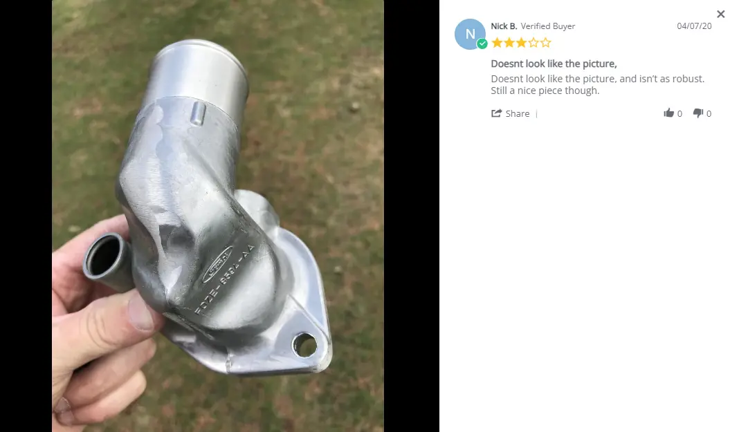

Here is a pic of the $109 dollar one from LMR installed... I believe I paid less than that before Janet Yellen was put in charge....
After years of fighting on some past cars leaking, warping, warped to start with, "Chrome" ( Run Forest) T stats paying this for a really good one is OK in my book...
Again, the only difference in this one over the $200 one ( according to LMR) is paying ford to have the ford part # on it.....

Went through the reviews on that to find a pic. This pic doesn't match what's in the product description. The PD photo looks like my OEM unit, but this one...looks fake? Has the part number on it, but it's much larger that what was on my OE part.
Regardless, i'm happy with my $20 used part. We can move on from this.

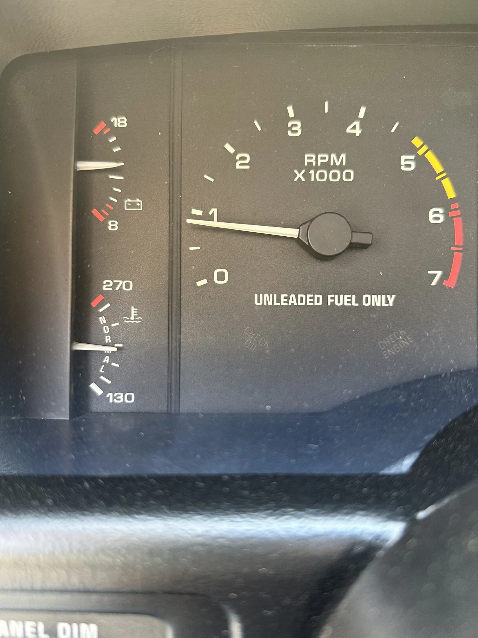

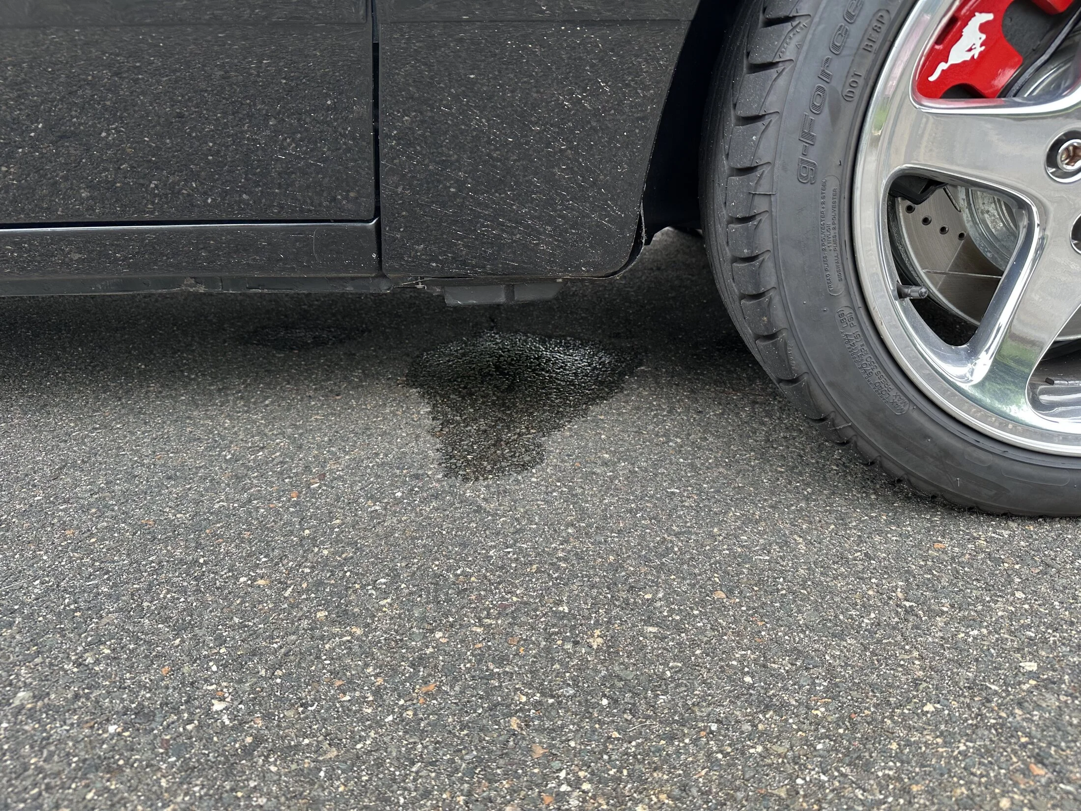

Took the car out to get lunch. Another hot/cold cycle purging air out of the system. Car ran well. Putting more miles on and getting a feel for things. Did a few low RPM 2nd gear off a stop light starts and no bucking. Was about to cruise around at 1500 or so in 2nd. I could probably manage 3.55's in this thing, but lets put a summer of driving on the car first and decide.
The headliner trim on the pass side has an annoying squeak. I'll need to pull that down and see what's up there. I thought I lined it all in felt, but it sounds like the clip is squeaking where it pressed into the roof. I know i know...fox bodies aren't going to be quiet.
I do think I will need to revisit the cooling overflow. This generic bottle just doesn't have enough capacity to cover the expansion that I'm seeing in my system. It's always between empty and spilling over into the overflow tube, which always spills coolant on the garage floor which is annoying me. I might have to find a tank with slightly more diameter for more capacity so the rise/fall of the coolant level isn't so dramatic.

Mustang5L5 said:
filled the coolant and started the car. Let it idle a bit to purge the air and went for a drive. Temp maxed out right here, which is lower that it was with the 192 stat. Looks to be about right where I want to be with the 180 stat. Didn’t hook up a mechanical gauge this time, but with the 192 in between the R and M was about 195-200 degrees.
Later in the evening I pressure test the system and it was good to go.
I drove around a bit afterwards. Still feeling the car out, but it’s stout. It was a warm humid day, so AC was on the entire time.
Parked and was happy to see a nice “leak” under the car in the form of water condensation pouring out of the drain. You have no idea how happy I am to see this. Out of all the stuff I did to the car getting the ac working again was my favorite
Nothing more fun that piddling around town in a 30+ year-old vehicle with functioning air conditioning.

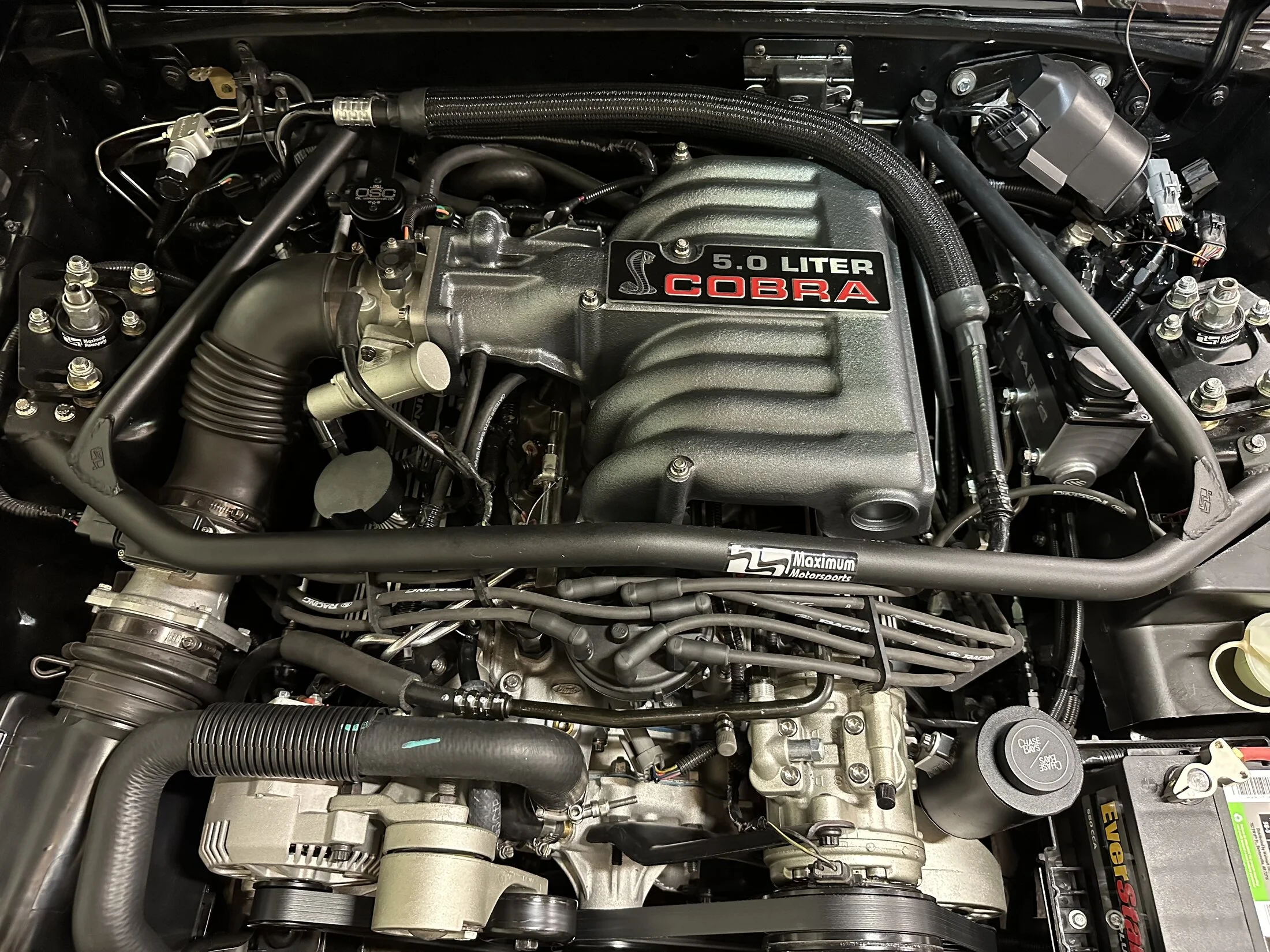

Wish I did more engine parts in this intake color…
Like what?
It is a cool color.
Reactions: limp

All of the silver aluminum accessories up front. Belt tensioner, ac compressor, water pump, alt. Etc.
I know what you’re saying….. but I’d be willing to bet that the engine compartment looks awesome in person……. I don’t think this picture is doing it justice.
Gives you something to do over the winter.

I'd have to pull the A/C compressor apart to P/C it. Not doing that. Most i'll do is repaint the tensioner because that Eastwoon ALuminum paint yellows VERY easily and I hate it.

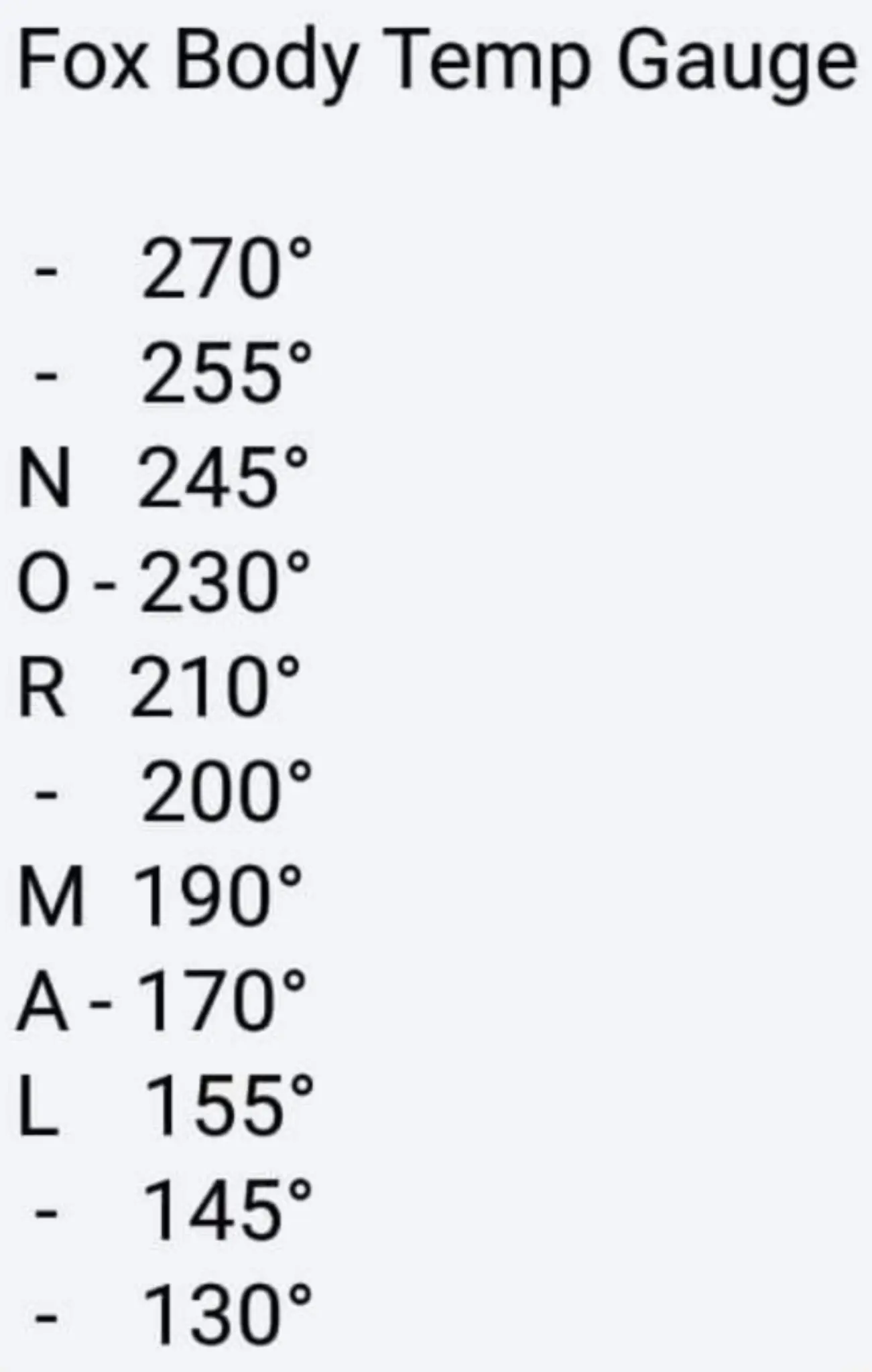

Boostedpimp said:
Little late to the party but figured someone could use it
Seems to fall in line then where I was expecting to be.

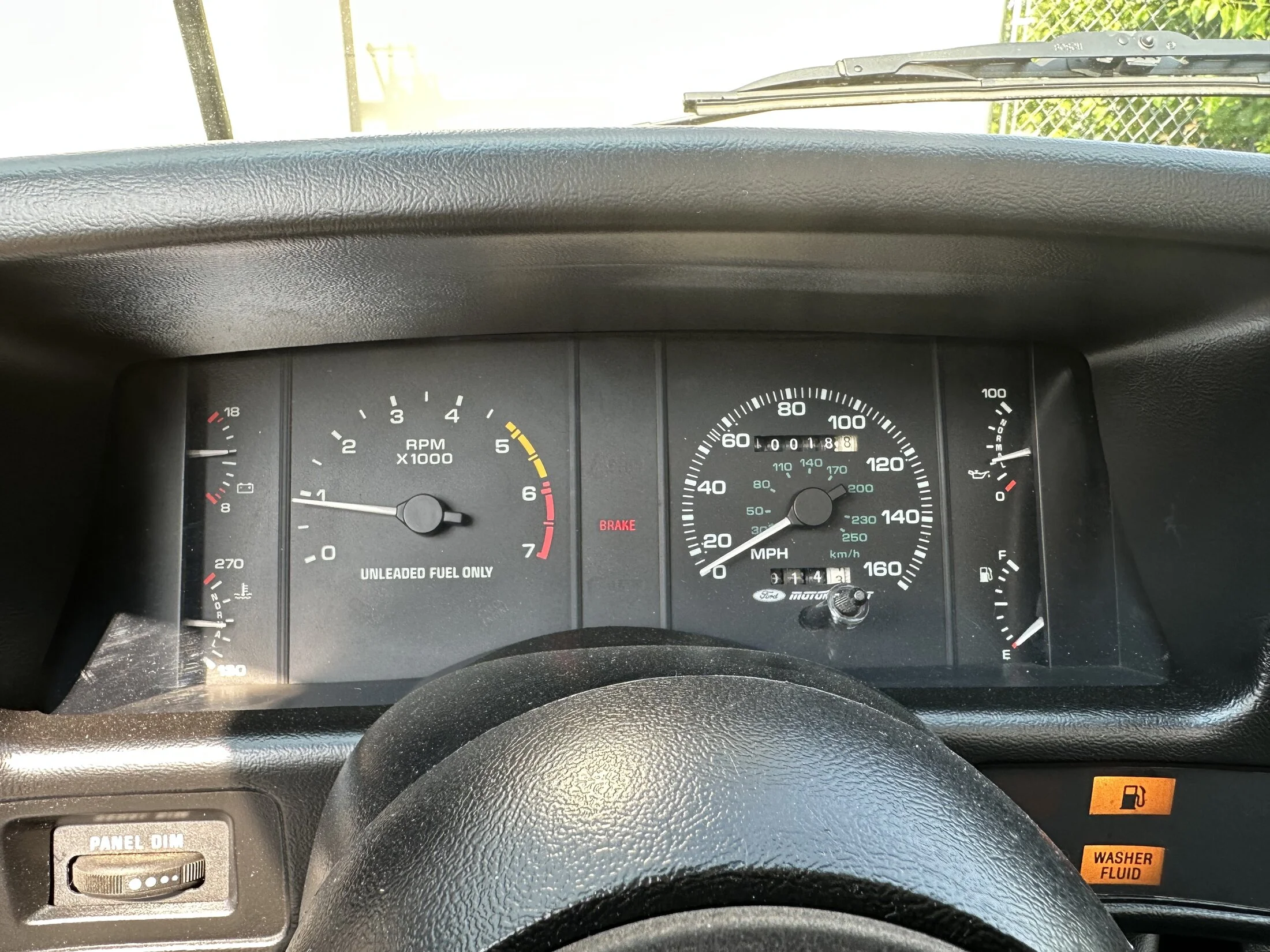

I took the car out this AM to grab a coffee. Cooling system now seems to hold it nice and stable right here. Before it would swing from here up to the OR and back down. Made me nervious to see it swinging up and down like that. I like the stability i see now.

Looks like you're low on a couple fluids.
