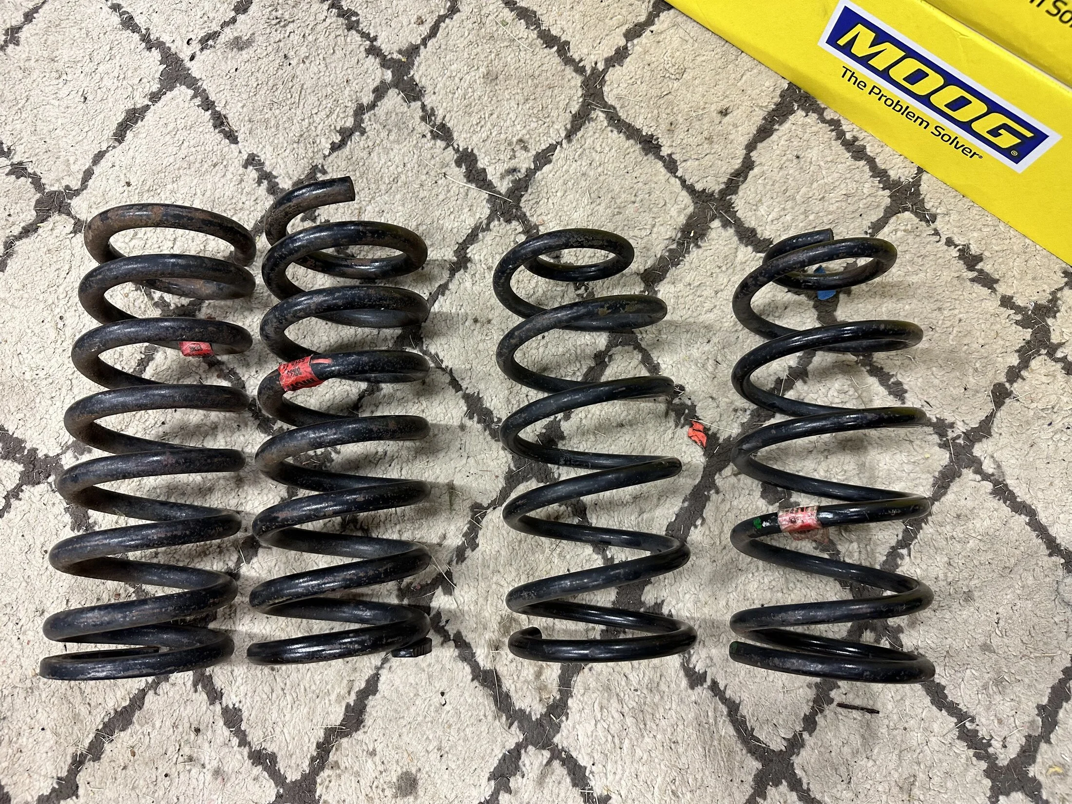

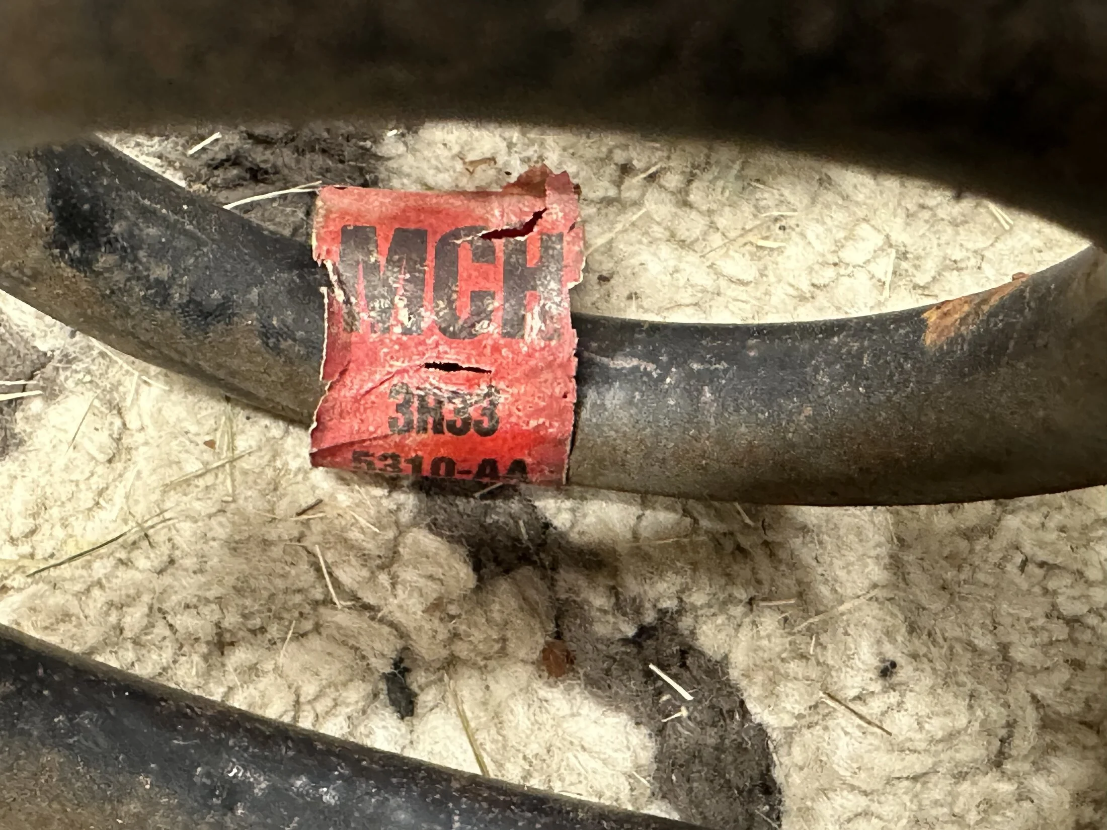

Ok dug em out. I was mistaken. These are Mach 1 springs. The difference being the ride height changed in 2003 and ford lifted all the models up about 1/4”.
So I may cut 1/8 coil off the front. I think the rear springs are the same, but with a heavier convertible I think I need the front to be lower.
I had these on my fox and really liked them. Need to give a quick coat of paint.

From MM...
"The H&R Super Sport springs are probably some of the worst riding and handling springs available. When installed on 1994-04 vehicles they drop the vehicle close to 2", severely limiting suspension travel and allowing the car to contact the bumpstops on a regular basis"
That only leaves the Race for the SN95 convertibles. Again, this car is a cruiser so I just didn't want to go that firm.
Stock GT:
450 front
210 rear
Pro-kit/Ford G spring (convertible specific)
500-570 front
170-310 rear
Bullitt/Mach (coupe)
600 front
250 rear
H&R Race
750-850 front
250-280 rear
Really, i'd like to just get rid of some of this fender gap. Nothing crazy. On paper, the pro-kit/G spring looks to be idea for a cruise, but i do already have the bullitt/mach springs.
I loved the Bullitt/Mach springs when i ran them in the Fox.

I just noticed, but the Bullitt/Mach 1 springs have almost an identical rate to the Motorsport C springs.
Mustang5L5
Mod Dude
Feb 18, 2001
43,347
18,082
224
Massachusetts
Sep 8, 2023
#2,754
  • Sep 8, 2023
  • #2,754
They do. I had C springs and swapped them out for the bullitt/Mach springs. Ride quality improved because the car was higher and wasn’t bottoming out all the time. Another 3/4” or so of height made a big difference. With the C springs it always felt like the front end was slamming over bunps.

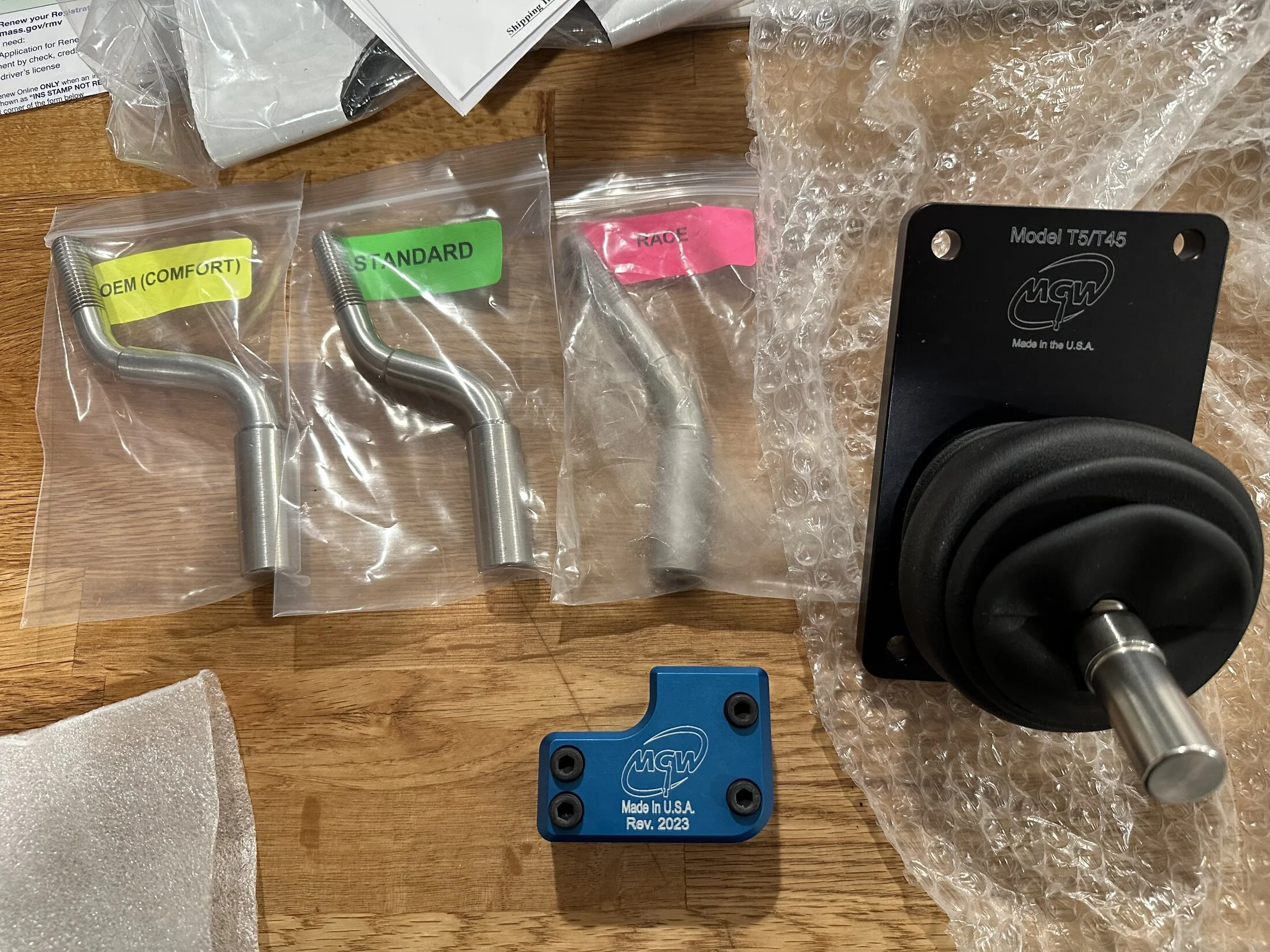

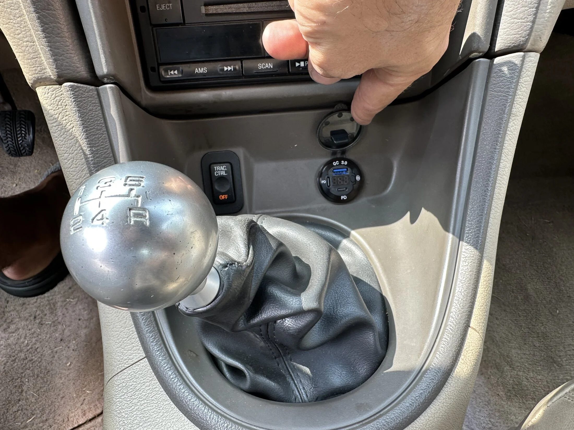

Drove around this AM after installing the shifter. I love MGW shifters. So tight and precise.
Original 03-04 Mach 1 knob in use as well. I used the standard handle for now, but for s and grins I might throw the race handle in.
Also, I suspect an issue with the brakes now. Maybe the front calipers are sticking? They just don’t grab at all. I need to get my parts together for the 13” front brakes.
I should pull them apart and inspect, but if I do that id rather spend the energy removing them and replacing with cobra stuff.
Because you know….just cleaning the car up

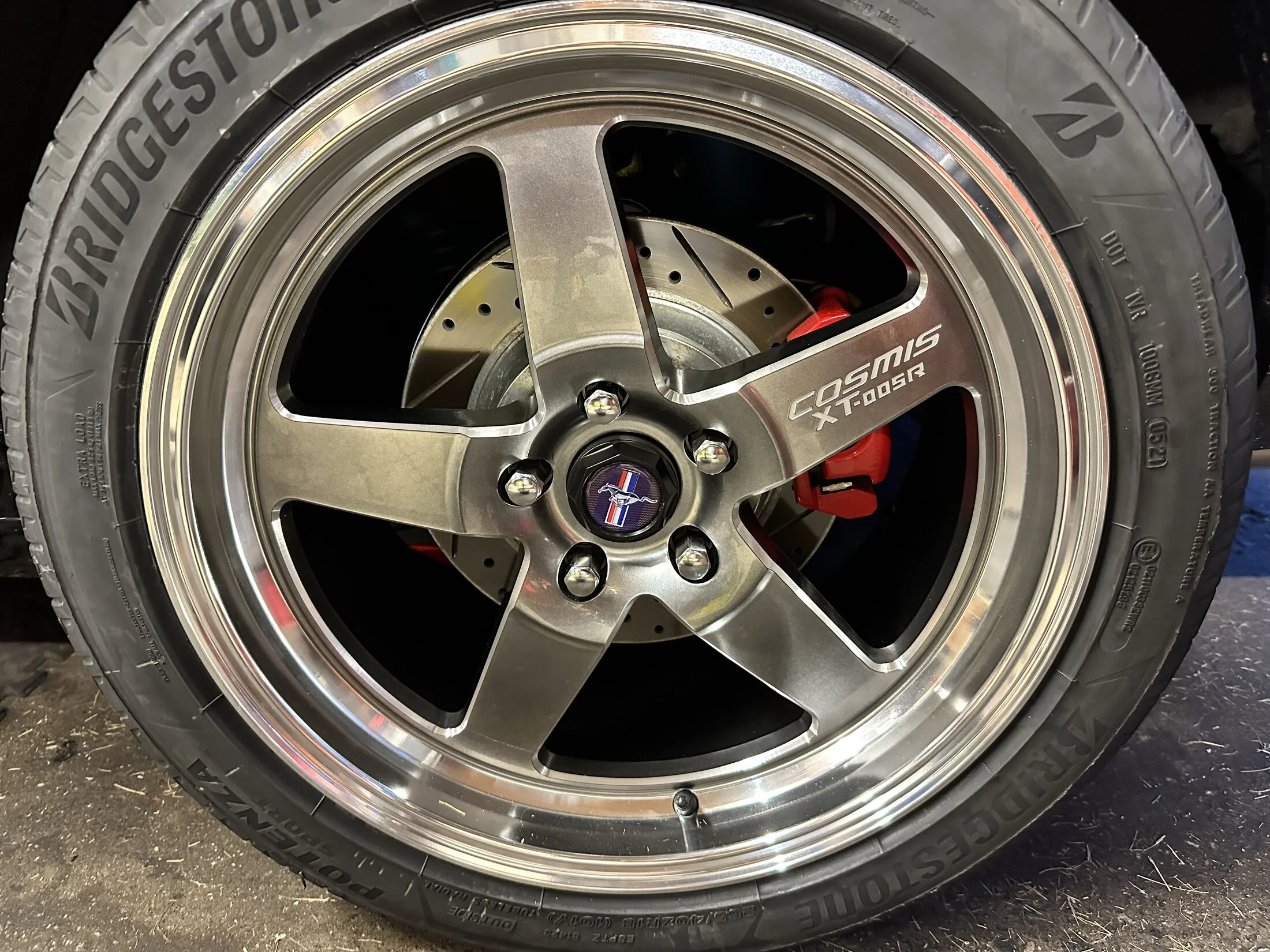

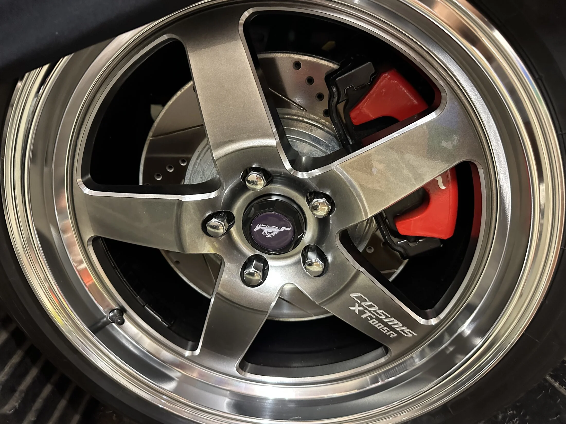

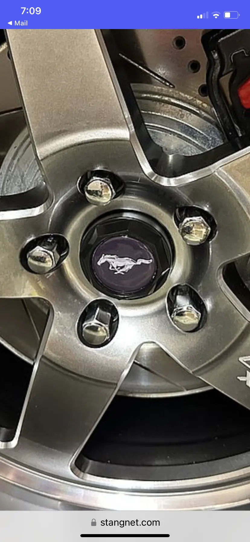

Tossed the decals on….guess which one I’m gonna run?

This One

You got it.
The other one looks….purple. There is a blue stripe in the background, but on the wheel it just all looks purple.

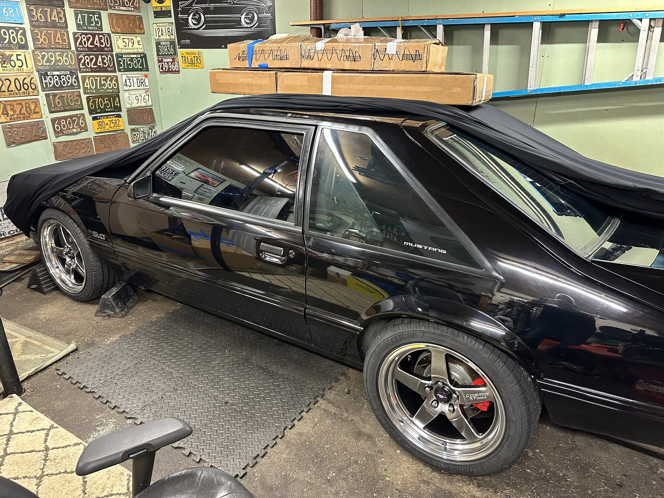

Rain this weekend, so no chance to drive the fox. I just take the ‘00 for a drive and that kinda cures the itch I guess.
So here she sits in the garage with parts for the SN95 sitting on top.
Here’s my total for the season. 28.5 miles. I’m already starting to clean up the other side of the garage so I can roll the fox in and park it for the winter and get the SN95 in the garage so I can pull it apart and really go through it.
But not yet. Hopefully a nice fall day coming up where I can get some cool foliage pics with it. I just want to replace that one hydroboost hose before end of year
