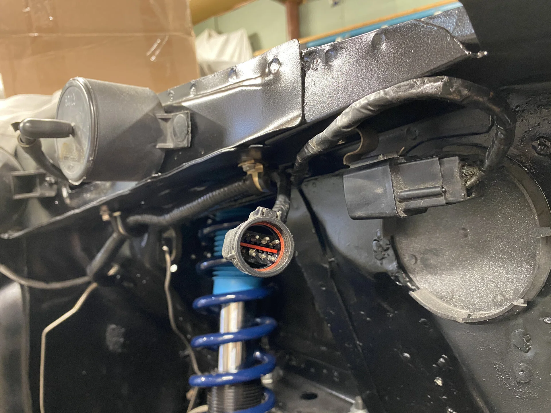

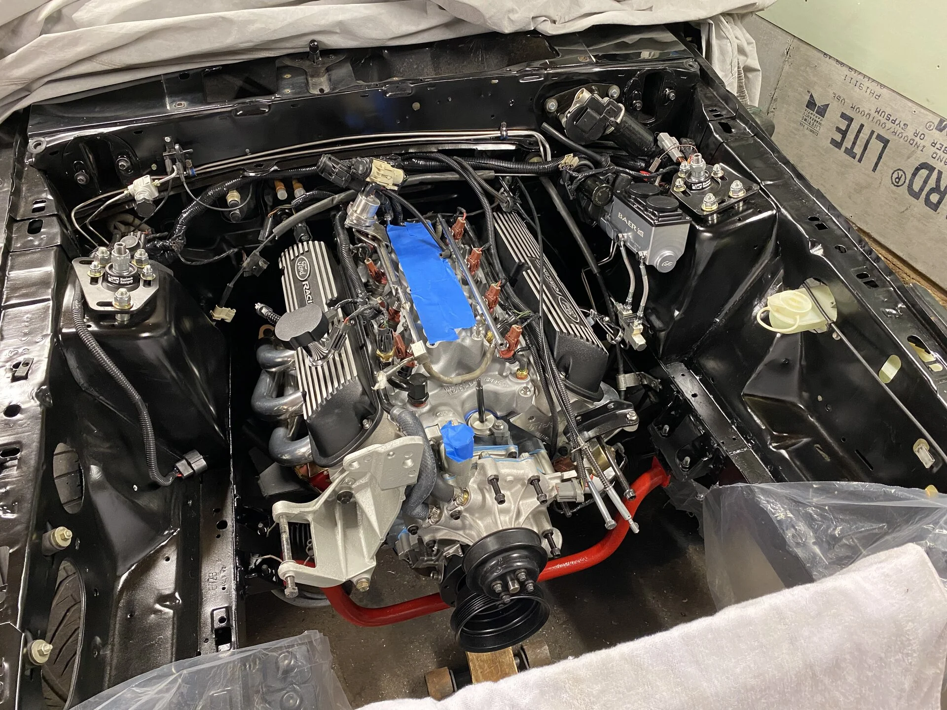

speaking of which, I spent an hour tucking the wires. Pass side was easy. Drivers side will need a little more work.
On the pre-airbag cars the pass side is one harness. I left my MAF wiring in the bay however since I had no clear way to run it.
Drivers side a little trickier getting it all in. Now to mount the distribution block and start hooking it up. I need to decide how to run the wire for the coil. I’ll need to extend it but I need a route.
but here it is with the two main harnesses in the fenders.
No sneak peeks of the intake yet. Dying to see what it looks like

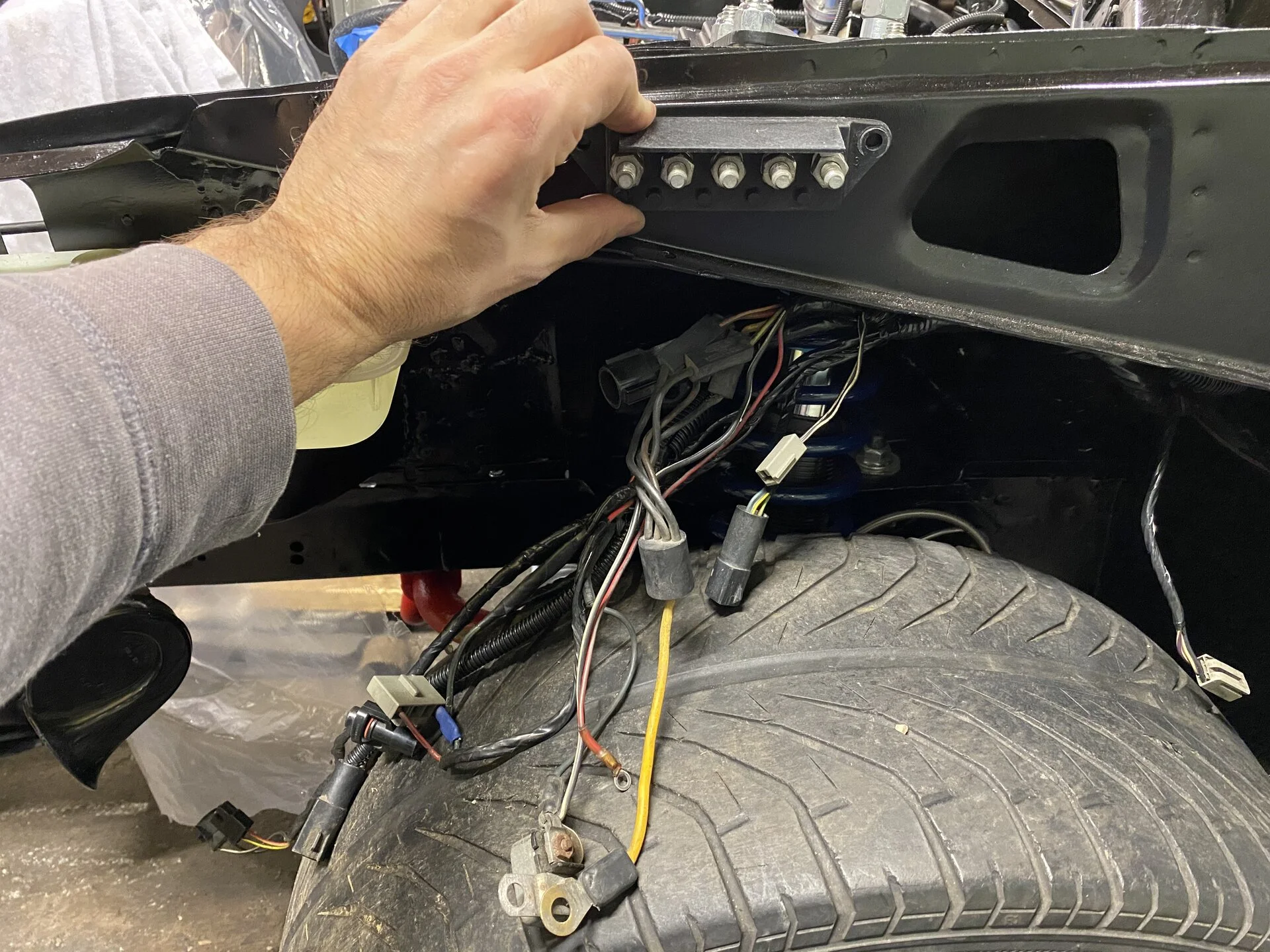

I ditched the washer fluid reservoir....because why not. That allowed me to mount my distribution block right above the access hole. The thought was that this will allow me to add circuits in the future without having to wrestle with the fender liner. All of my wires were just barely long enough to reach. I routed all of mine with the exception of the hood latch cable through the rear-most hole on the fender apron behind the strut tower. If you mount your block anywhere to the rear of the washer fluid reservoir, you should have plenty of wire. I did have to extend the wires to the master cylinder as well as the coil. I moved my coil from the strut tower to the fender apron area to the rear of the battery.
The passenger side was straightforward. Surprisingly, my MAF wiring was just long enough to be tucked. I did have to extend the O2 harness wiring a bit to get it tucked up the way I wanted it. YMMV on that one, however. I also went ahead and tucked my TFI relocation while I was at it and mounted it along with the 2 factory relays to where they could be accessed via the passenger fender apron access hole.

My coil is I'm the factory location. I used a hole that is pointing straight into the engine bay from behind the strut in the strut tower. I had to de - pin the factory connector and reinstall after feeding the wires through a small grommet placed in the factory hole in the tower.

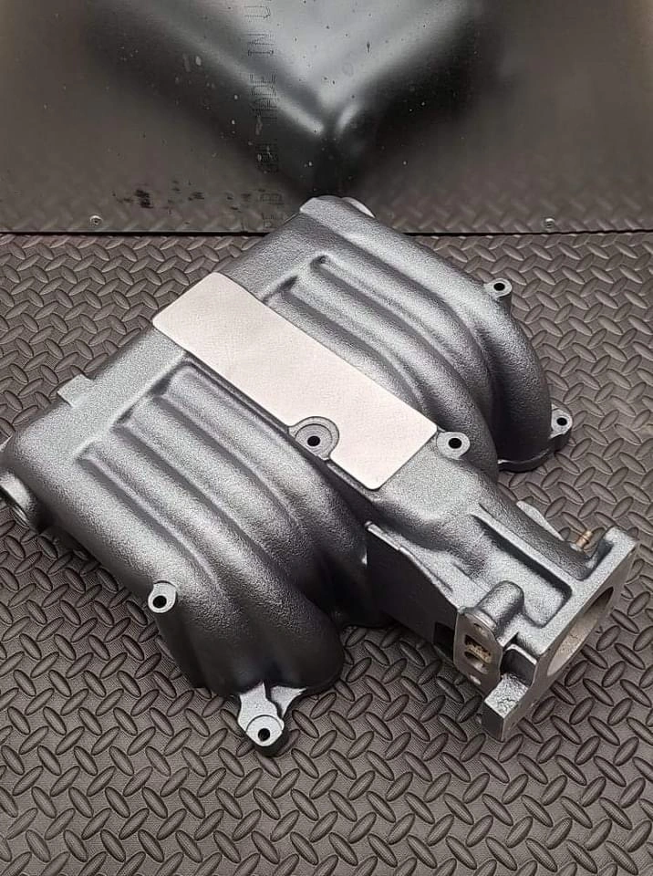

Ok, I have a teaser of the intake done.
I’m debating showing it now or waiting til I get the intake plate on and installed.
remind me to flush the internal cavities for sandblast media and powder. Critical I check that. I had a friend who fubared their engine due to media inside the manifold.
I’ll likely do that. I need to repair the coil plug with a new connector so I’ll likely extend the wires.

My wires come out right above where the brake proportioning valve was and goes straight forward to the coil. With the factory connector rubber boot you don't even notice the wires there.

Those holes are filled, so I either need to drill a small hole out of sight or take a different route.

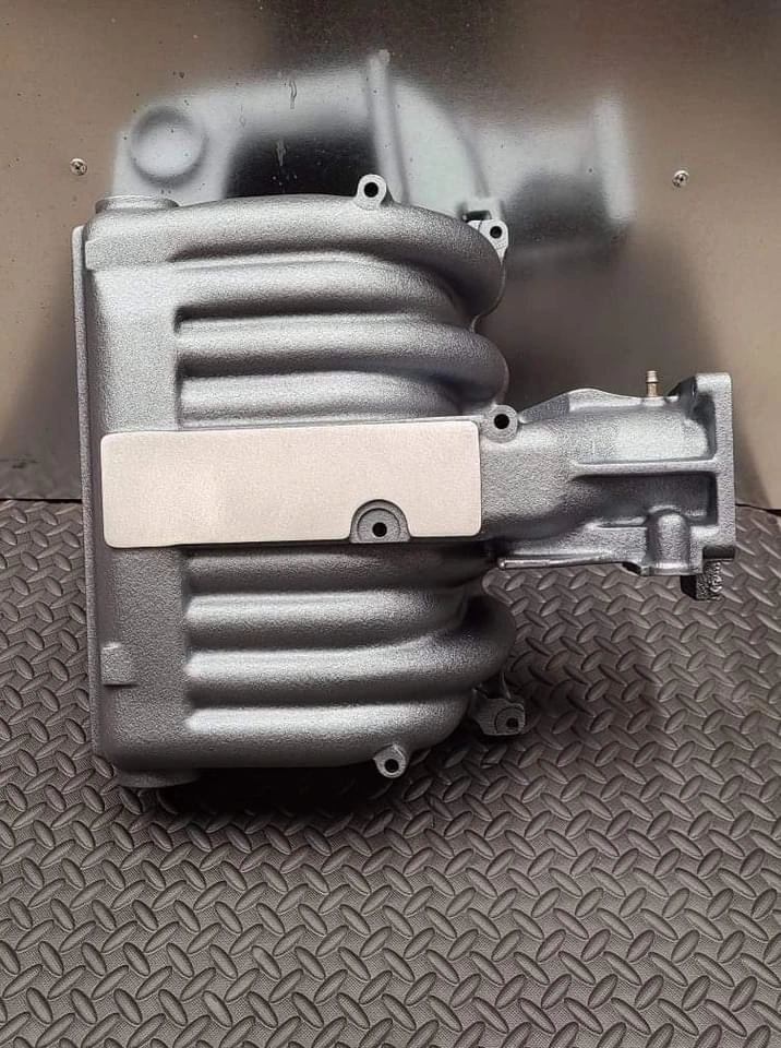

Teaser shots from the powdercoater. I pick it up Sun
needless to say, the hunt for nice hardware is on.

Are you going to use flat washers under those bolts?

Stainless flanged bolts?

Black bolts with the flange, I got a set of lower intake bolts like that from ARP.

I have stainless ARP for the short bolts. I was thinking studs and stainless arp 12pt nuts for the others. All over stainless washers.
or maybe black. I have some of each so I’ll mock it up and see what looks better

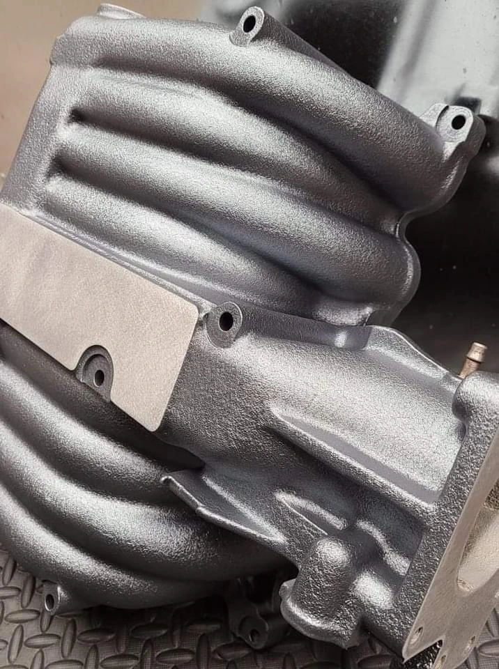

Intake back. I love it. Looks way better in person.
the color is Ironsides II from the Prismatic powders catalog
