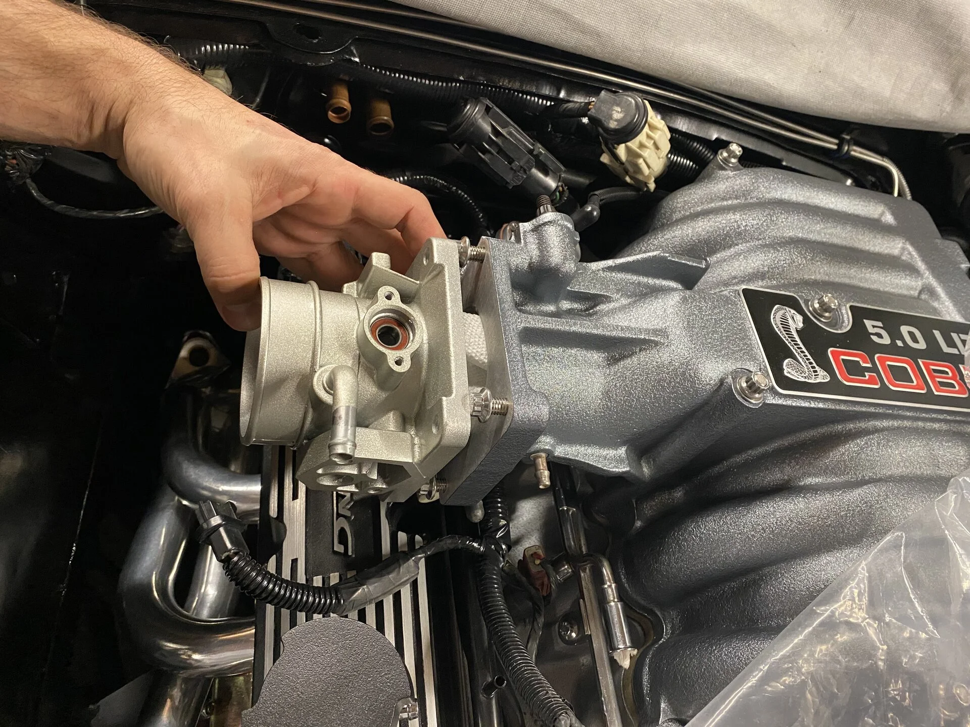

Now I need to decide what to do with the throttle body. It's an explorer 65mm. I have it stripped down to the natural finish. Not sure if I should leave it natural? Paint it a contrasting color? Powedercoat it the same color? Or buy a nice polished 65 or 70mm Accufab?
I also need an IAC solution. Are there any aftermarket Ford IAC's that look more eye appealing?

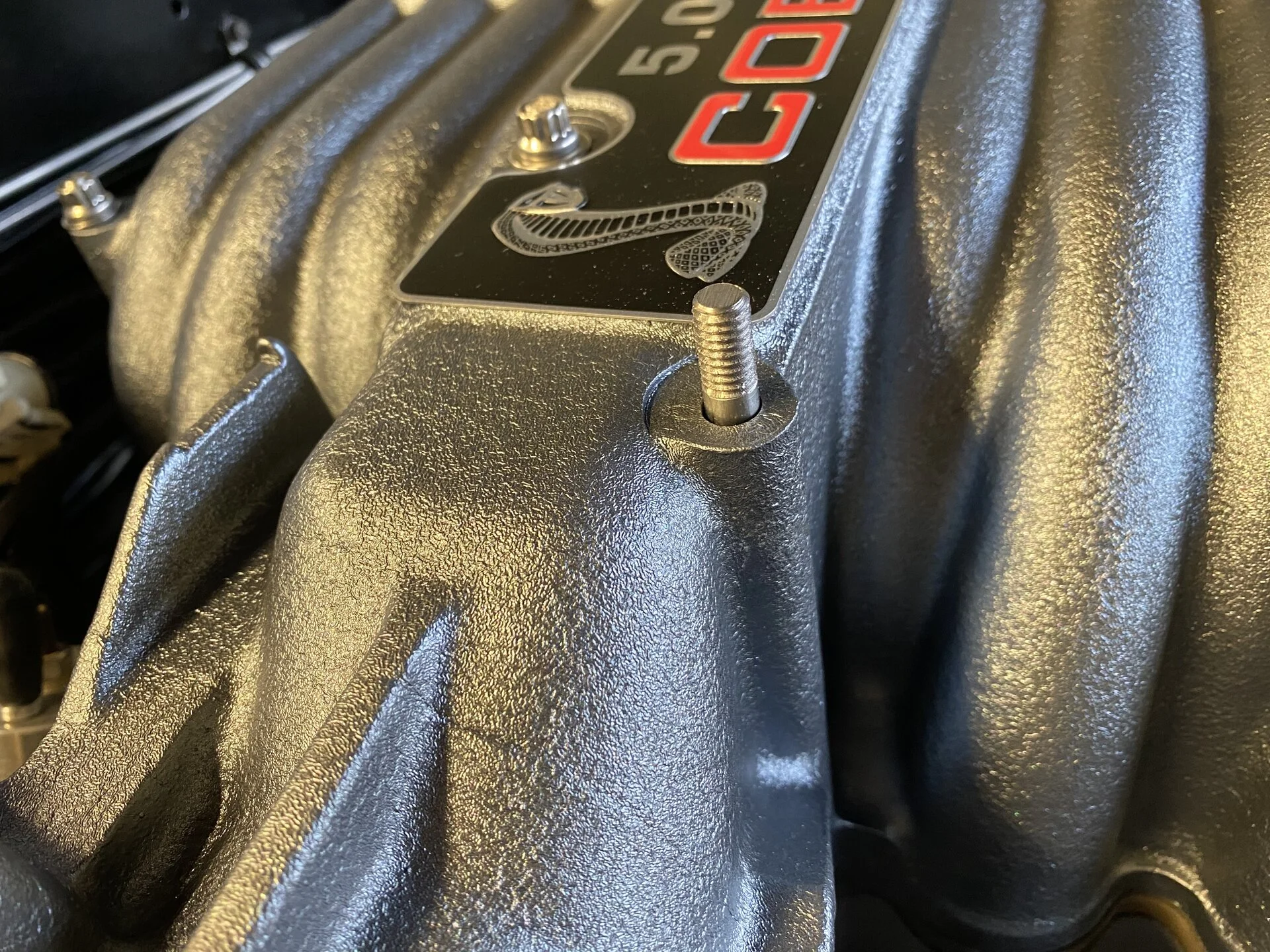

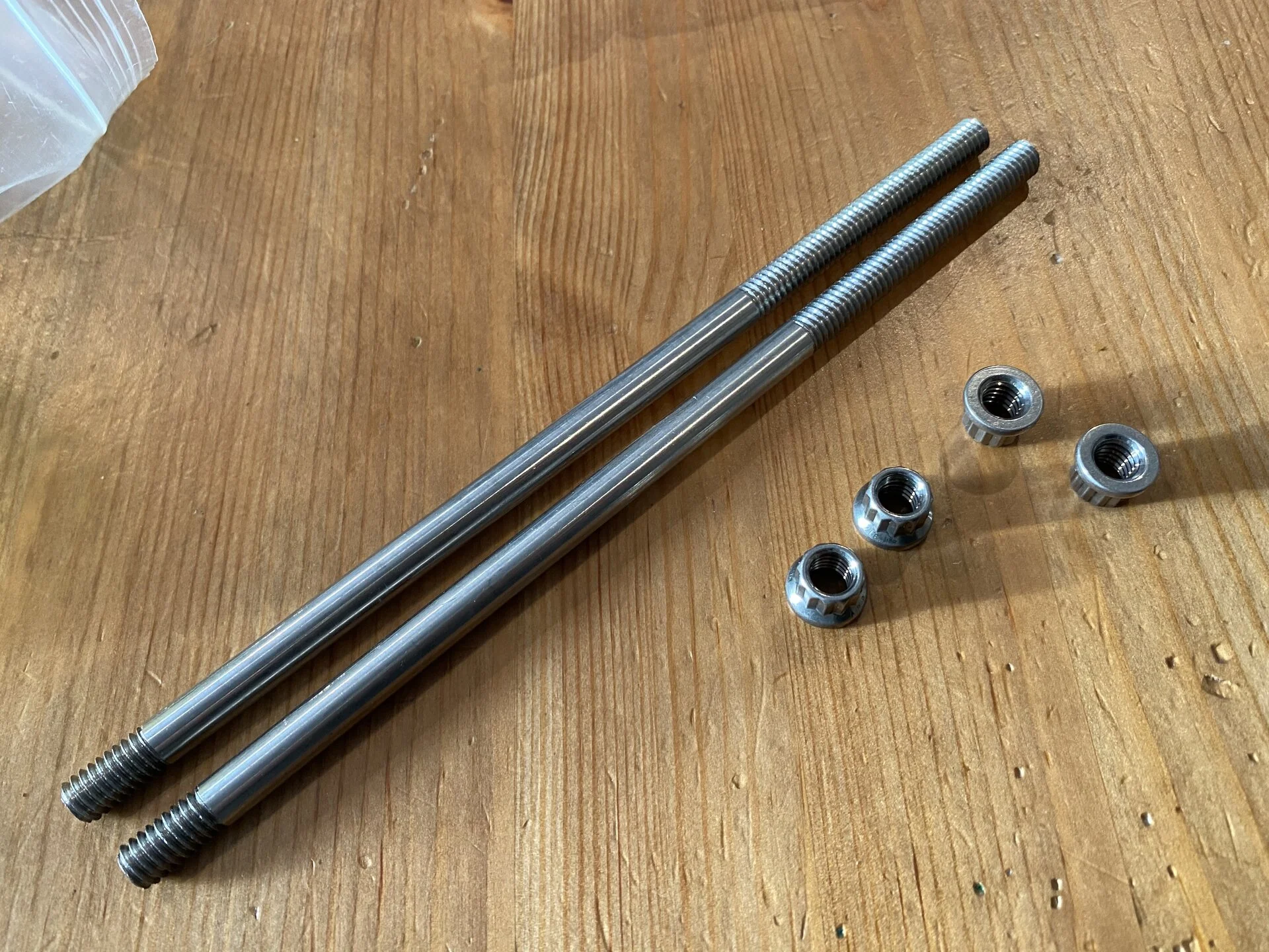

Hardware time (again). I hop back on my favorite hardware site Mcmaster Carr.
bought some SS studs and ARP SS nuts off mcmaster
now, the lenghts aren’t perfect, but I bought a die to rethread the ends after I cut a tiny bit off. This is the uncut look with my 3/8” intake spacer installed
after trimming and running the thread cutting die down them. Nice flush profile in stainless steel

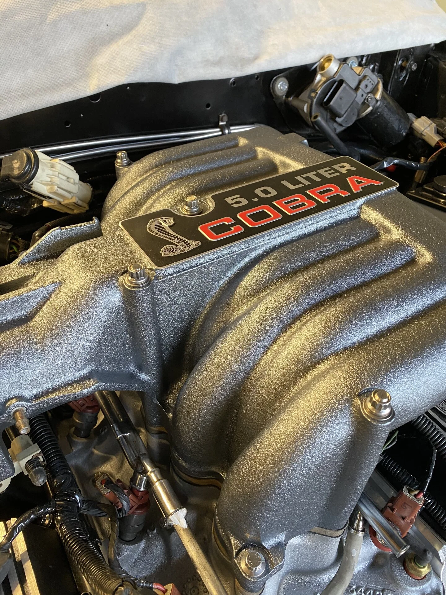

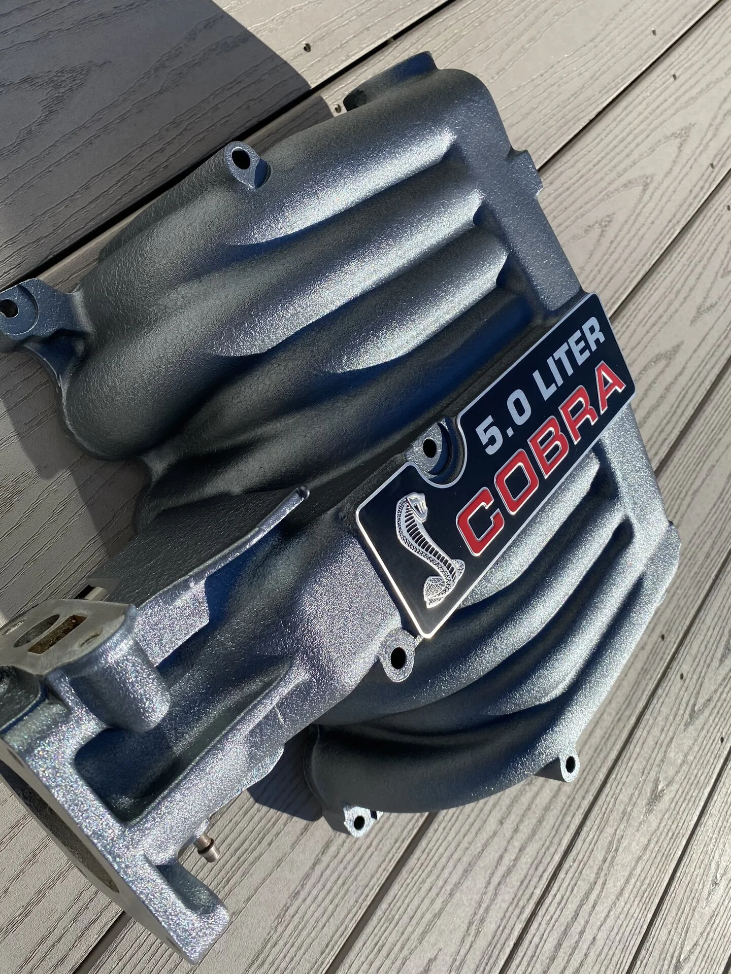

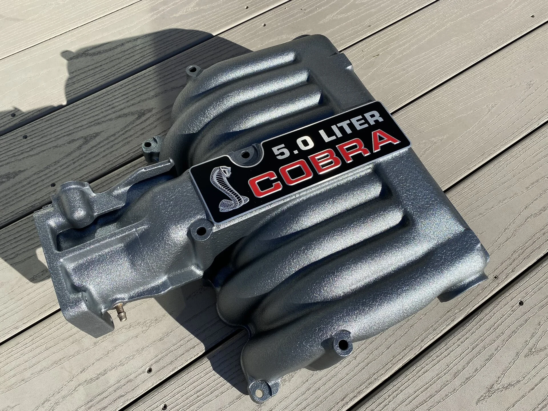

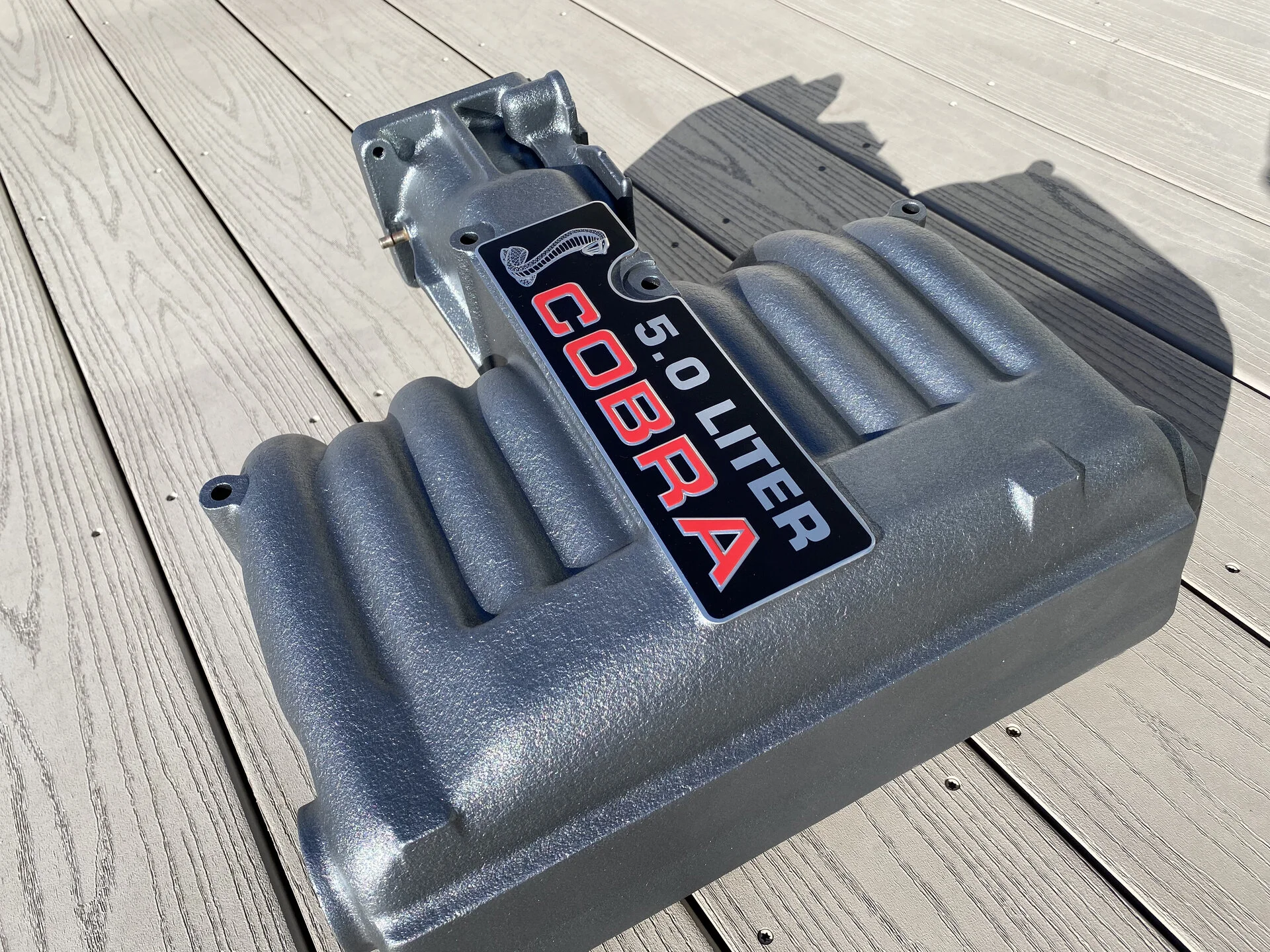

Intake back. I love it. Looks way better in person.
the color is Ironsides II from the Prismatic powders catalog
That is scary close to the color I'm going to powdercoat my coil covers for my 4.6. Looks good!

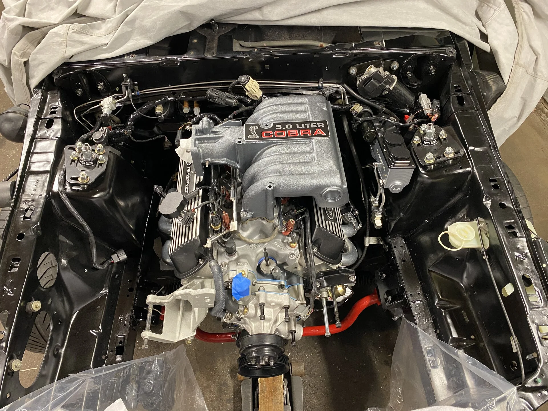

As I get closer and closer to the point where I can crank this over, the butterflies in my stomach are starting to get nervious with regards to this engine running perfectly, and reliably. I have nightmares about messing something up, not torqueing something, a bit of metal shavings somewhere, etc, and screwing this all up.
I'd like to think I paid enough attention to detail to have taken care of all the risks....I hope

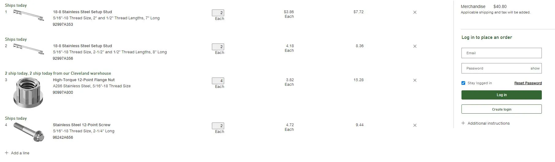

Everything is on Mcmaster carr. I do have the part numbers handy for these intake studs.
5/16-18, and need to measure and grab the lenght you need. I trimmed off about 1/2" to make it fit and then ran a thread die down to clean up the threads. I used the 7" and 8" length for my intake. Other intakes might need other lenghts
5/16-18 SS nuts from ARP are part number 90997A800. The entire selection of 12-pt nuts on this page is ARP harware
Here are the 12-point bolts. The ones sold individually are ARP. The ones in a pack of 50 are not.

Yes, on the studs and nuts. I had to trim about 1/2" off the long threaded portion of the studs to get the length right.
But for the 2 short bolts, i'm using 1 3/4" long bolts. I test fit a 2 1/4" bolt and it was too long. Even 2" might be too long.
Keep in mind, that's for a Cobra intake with a 3/8" intake spacer. Without the spacer, you'll have to compensate. I also don't know what sizes would work for any other intake without test fittings

Painted the 65mm Throttle body. Not sure the color choice is right. I do think I might spring for an Accufab 70mm polished, so I’m hesitant to spend the money to powdercoat this one.
what would you do?

Are there any performance benefits of going to the 70mm?
I think the polished would look great. I’d personally go that route. If keeping the explorer one I’d match it to the intake.
