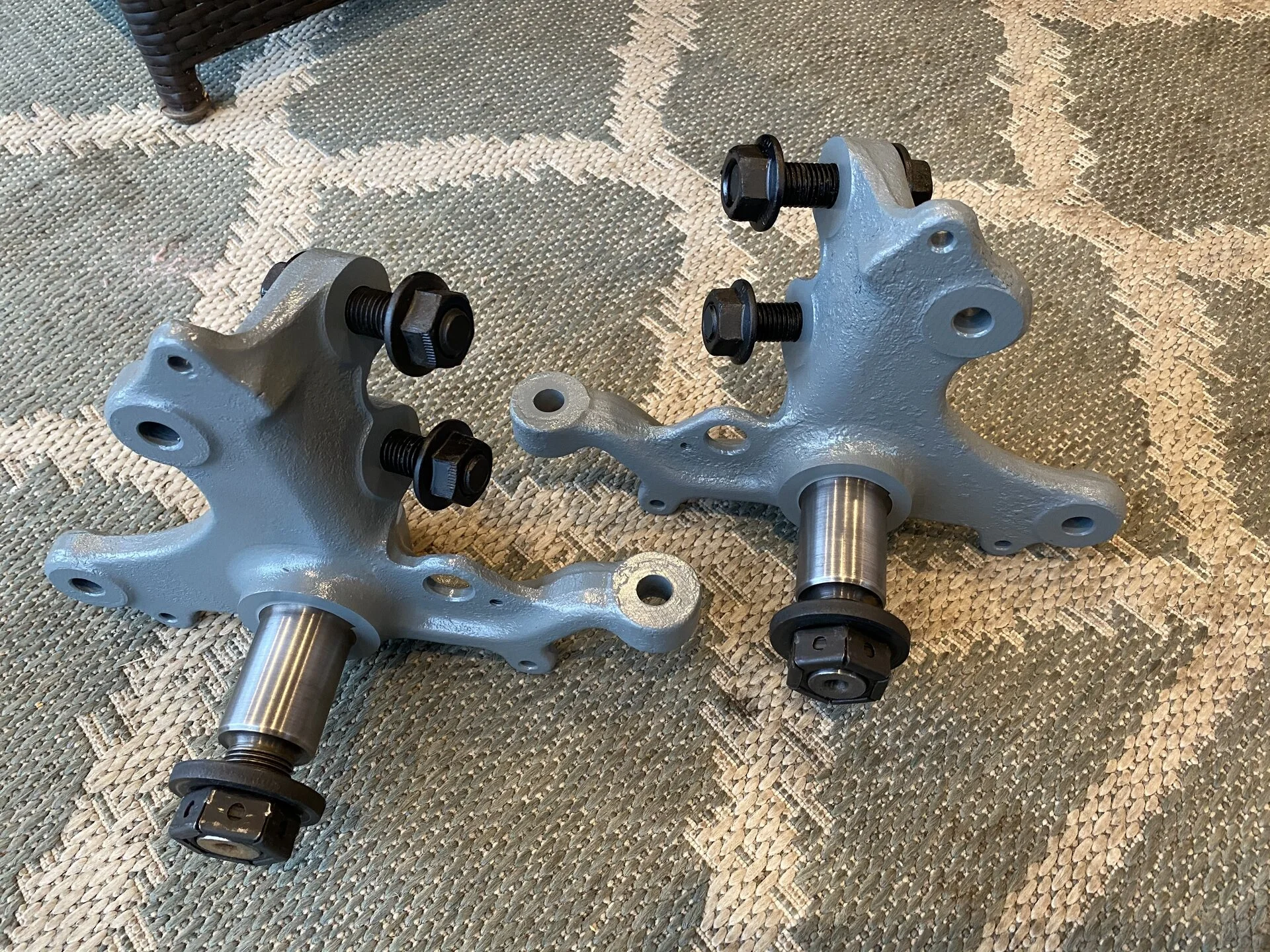

Biden's plan is to hand out big tax breaks for buying one.How could you not get one if they are giving you seven grand on a Tesla. There is supposed to be a twenty grand Tesla coming out, or here now. The only problem is it looks stupid. Almost like a smart car . MIKE whats the grey you painted on your spindles a while back.

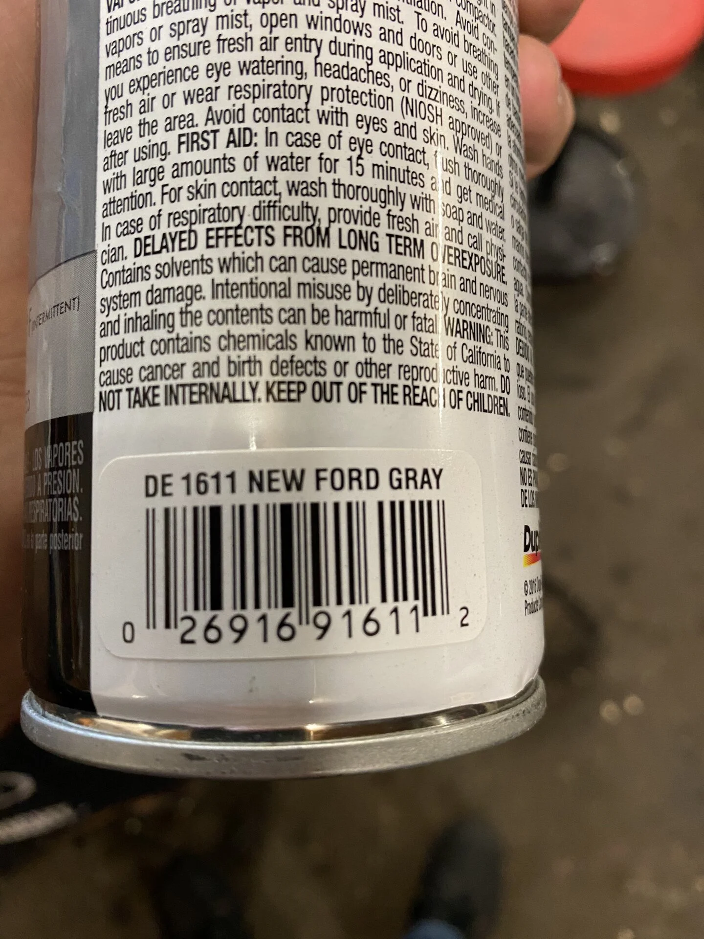

Here you go. New Ford Gray DE1611 by duplicolor. Same color I painted my block

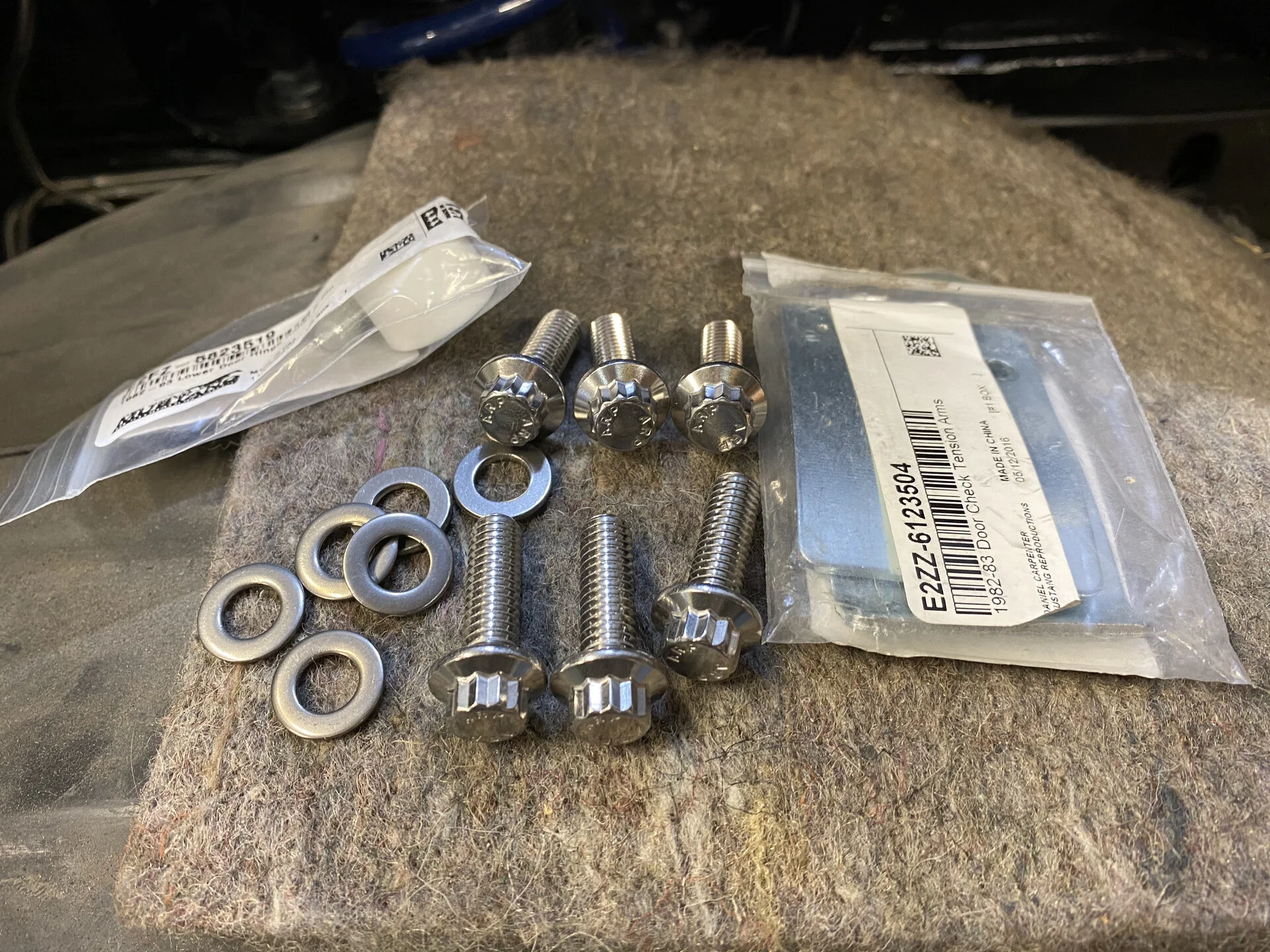

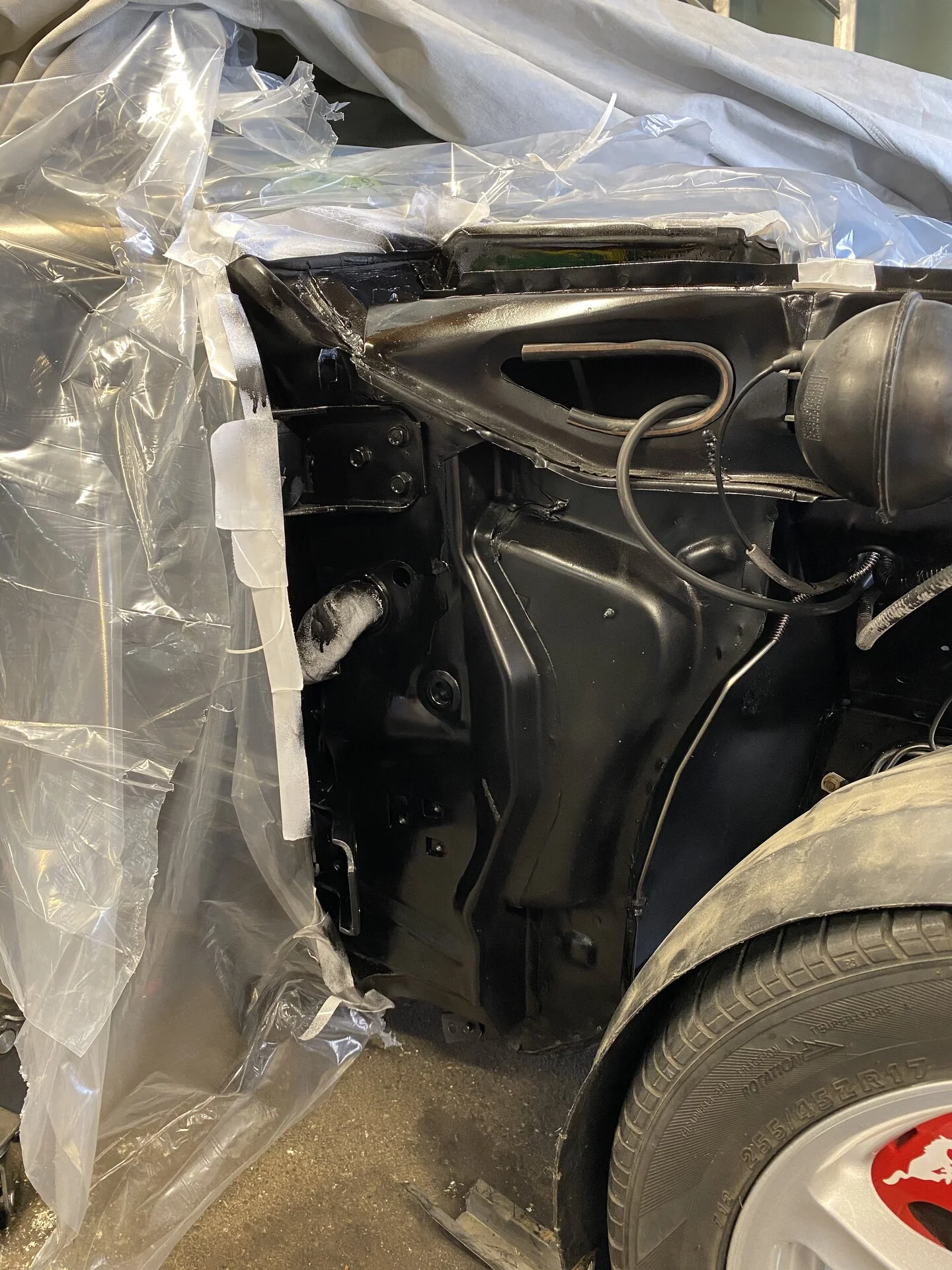

Did some work on the pass door jamb.
some paint. Nothing fancy, just some underhood black.
New hardware. The ARP bolts were for something else, but I didn’t end up using them.

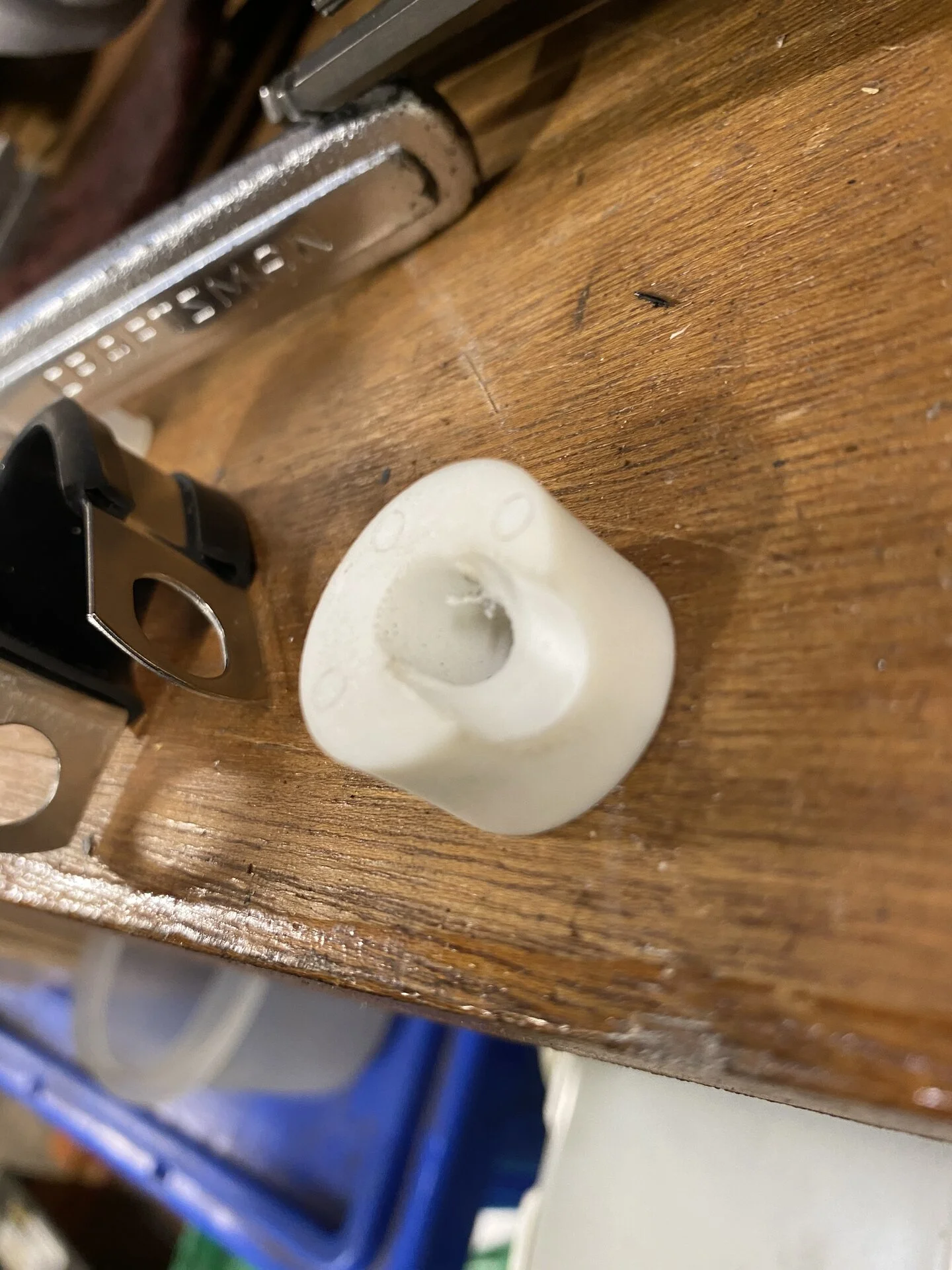

in order to instlll the door roller, you need to cut the door pin out. You can’t drive the roll pin out far enough with with hinge intact. My pins were in fine shape, so I didn’t want to do this. Instead, I slotted the roller.

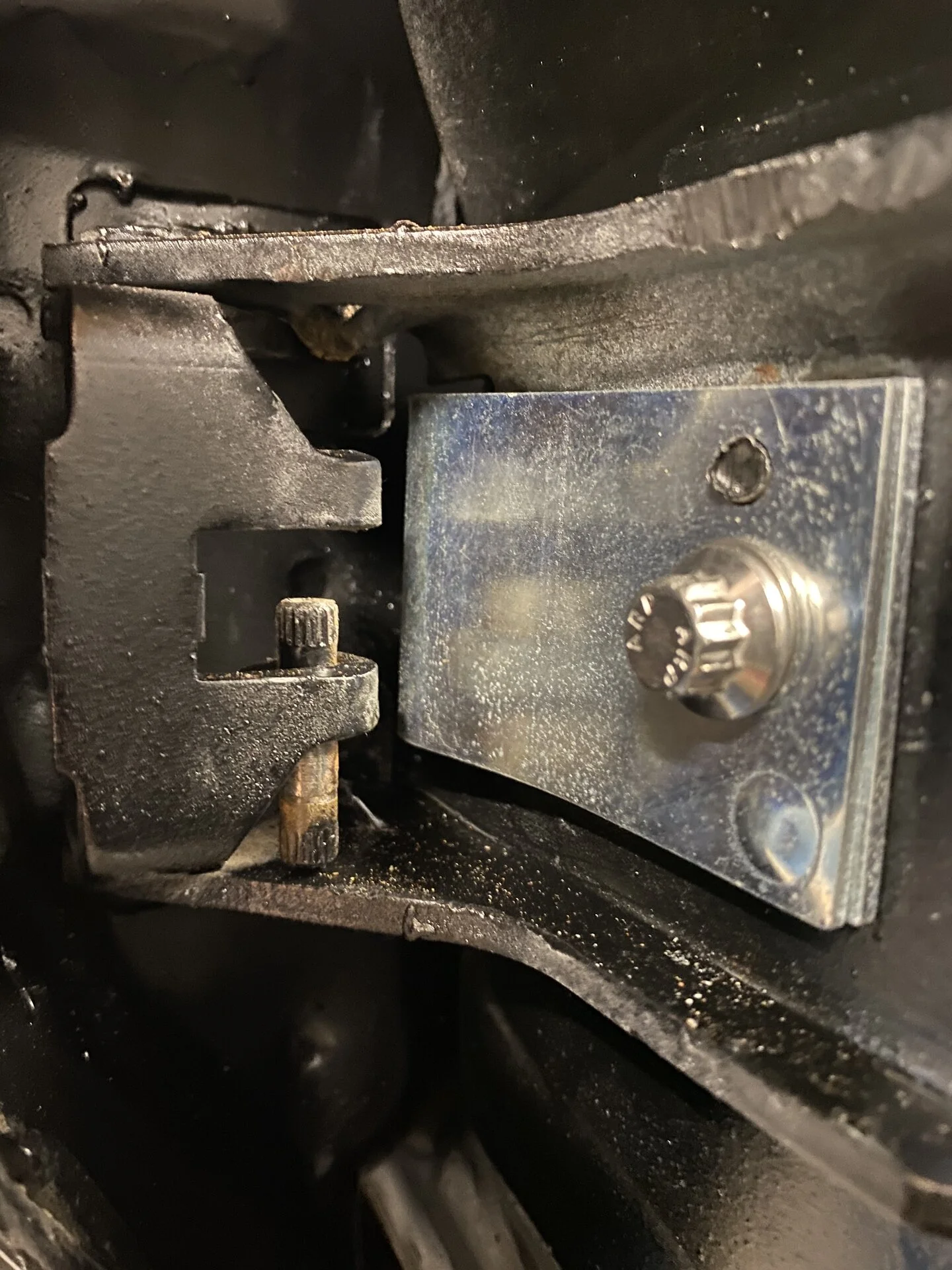

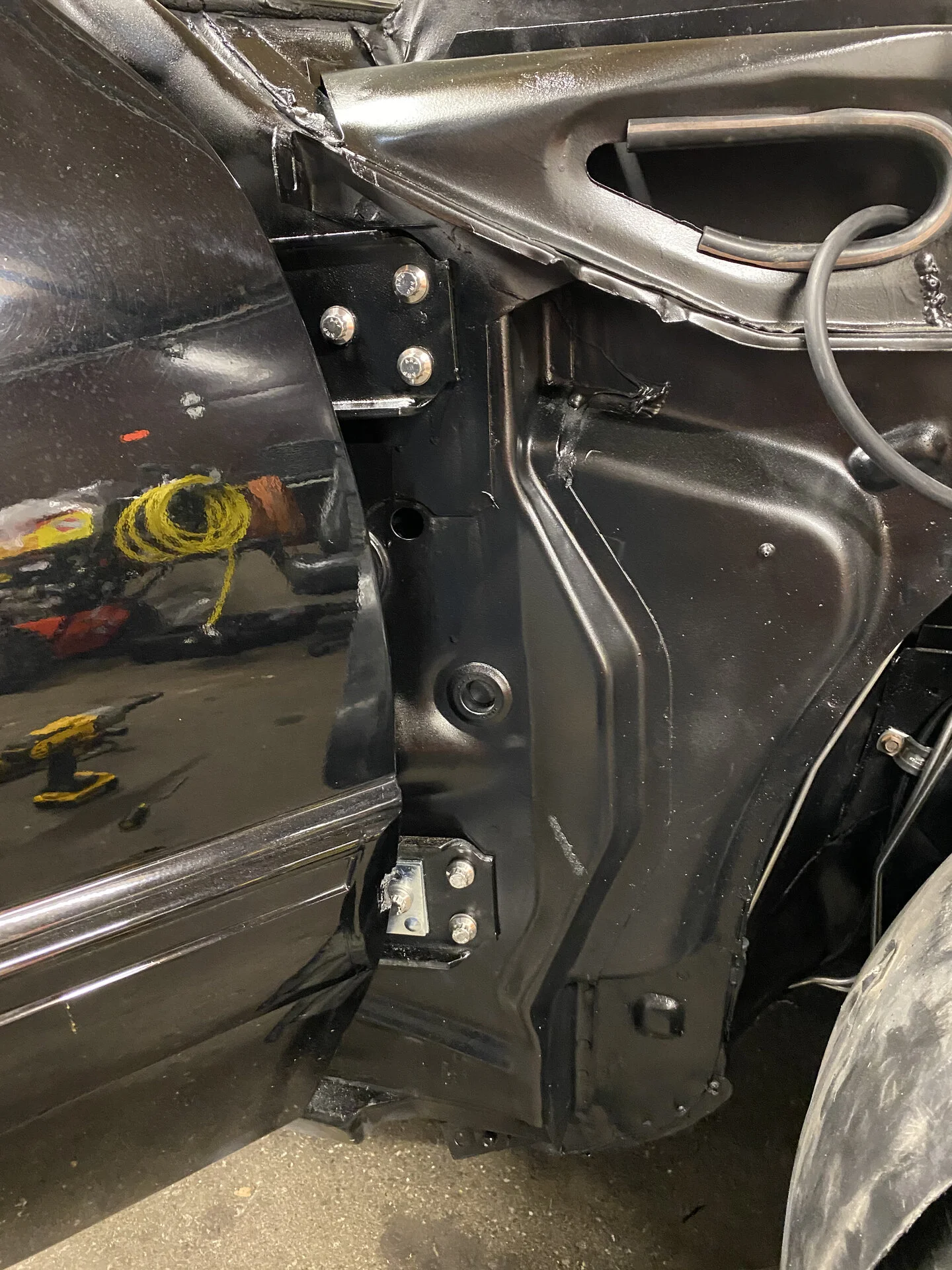

And done. I think you can see the bolts when you open the door, so the stainless 12 points will be a nice touch. Yes I’m crazy
5/16-18 by 1” if anyone is wondering. I do have black 12- point bolts but I’m liking the SS arp hardware
