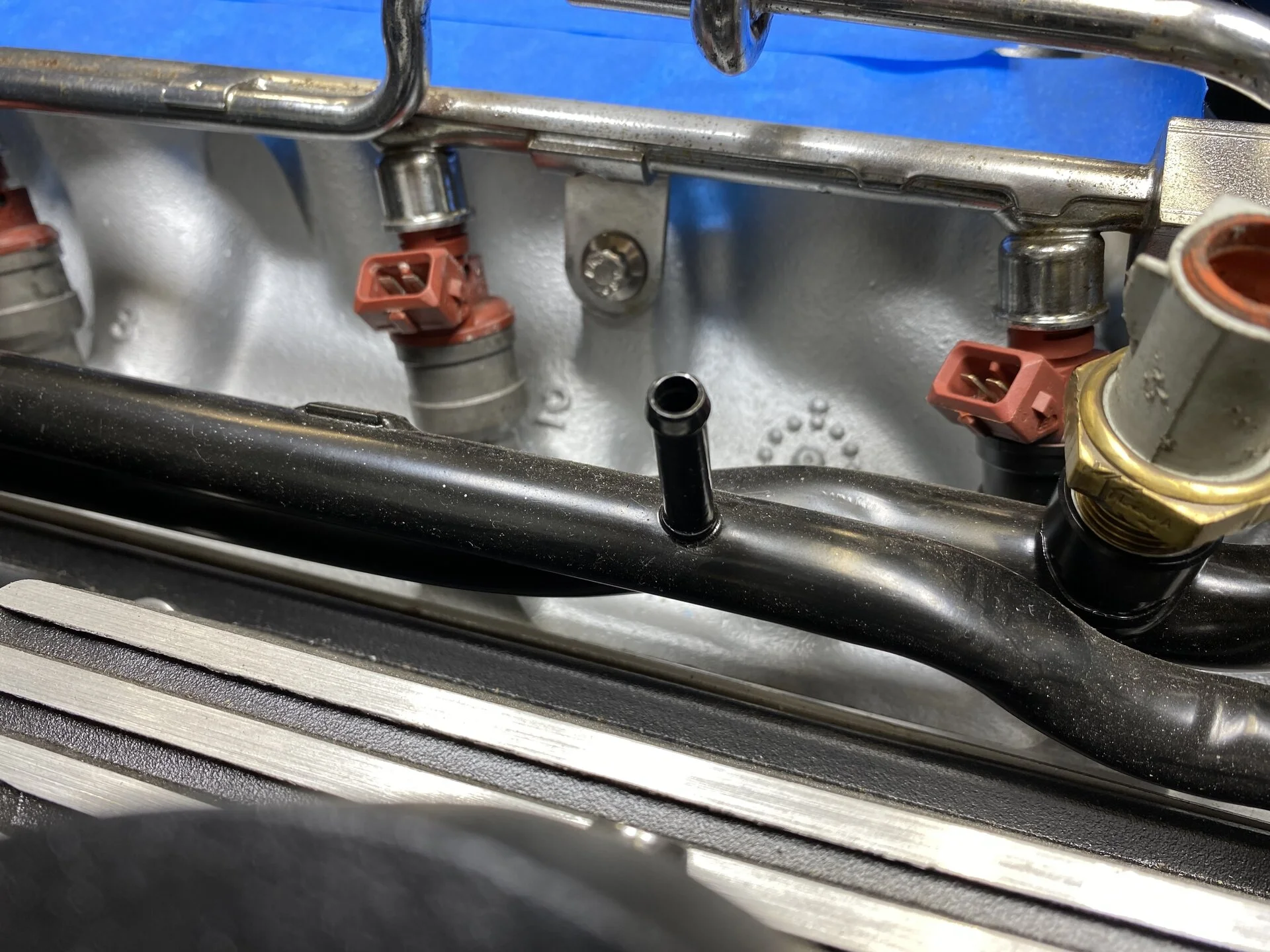

Just remembered this. What to do about it?
I don’t want to remove this pipe. I don’t want a repro without it. Previously I just left a stub hose with a bolt in it. Held for 20 years.
Maybe I’ll do the same but leave it a bit longer so I can tuck it. Could come in handy as a way to bleed out air. :shrug:

vacuum cap and hose clamp
Not sure I'd let straight water sit in the block too long,antifreeze does contain rust inhibitors so a diluted amount may be beneficial.
I've looped a hose from the heater tube to the rear of the lower intake in the past,now I just run the aftermarket heater tube without the barb.

Black vacuum cap and a spring clamp?

I've seen the black vacuum caps fail on that nipple. One split on me while I was street racing years ago in Baltimore. The guy I was racing followed me to a lot where he helped me fix it with a piece of hose and a bolt. Stayed that way for a very long time.
You could probably use some grease and a tap and cut threads on the inside of that thing. Then you could put some Teflon tape on a short bolt and be done with it. An Allen head would look pretty well hidden there. Finding the right size tap and bolt may be a challenge though.
