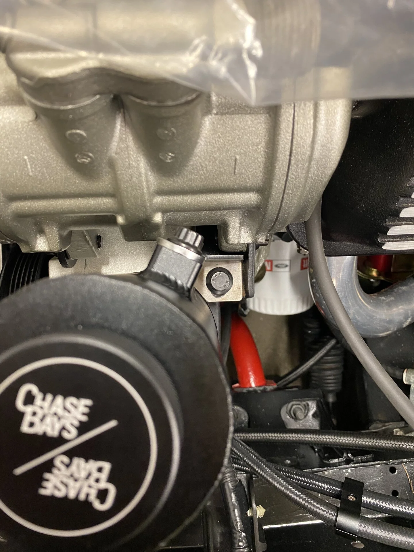

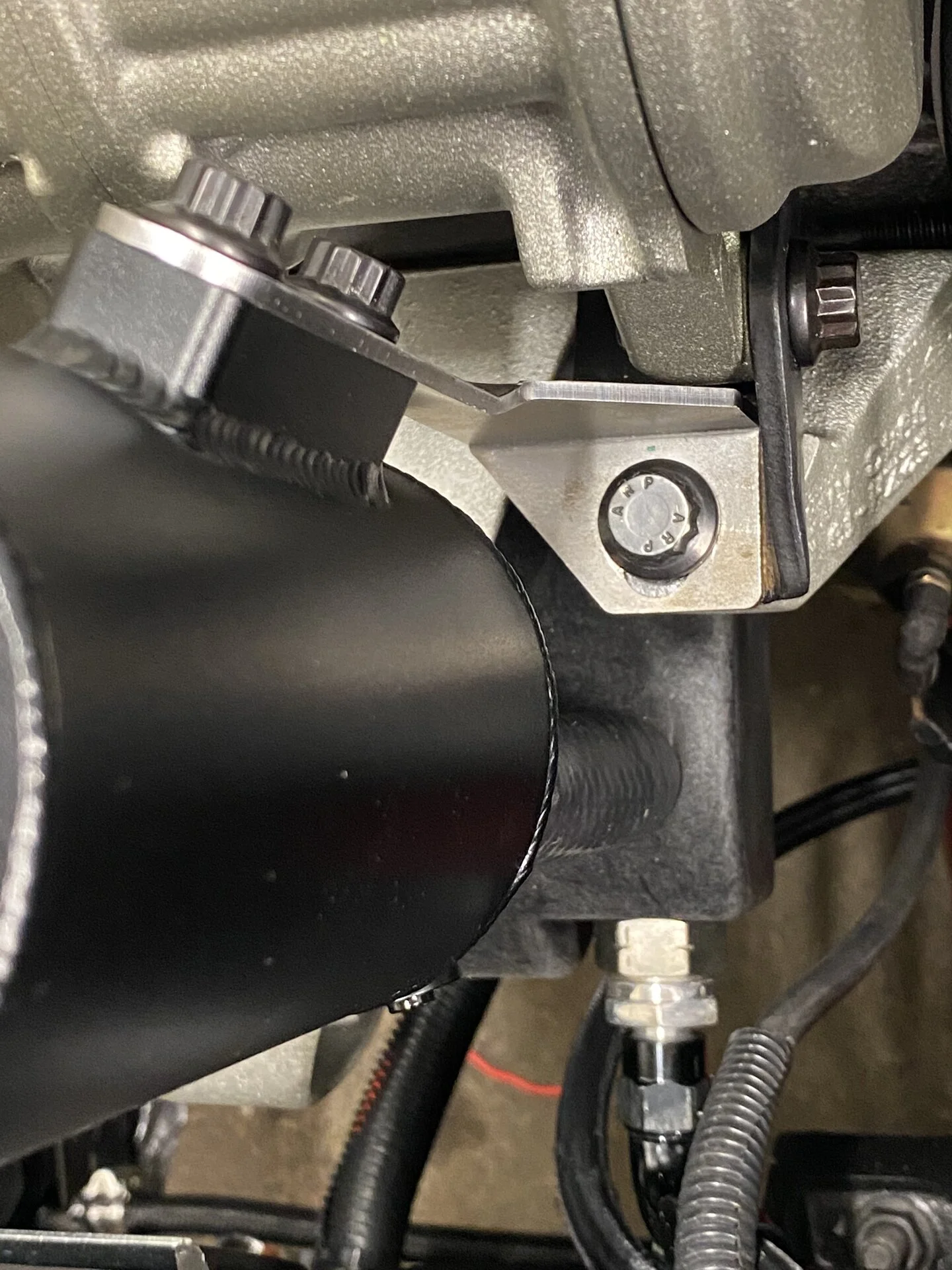

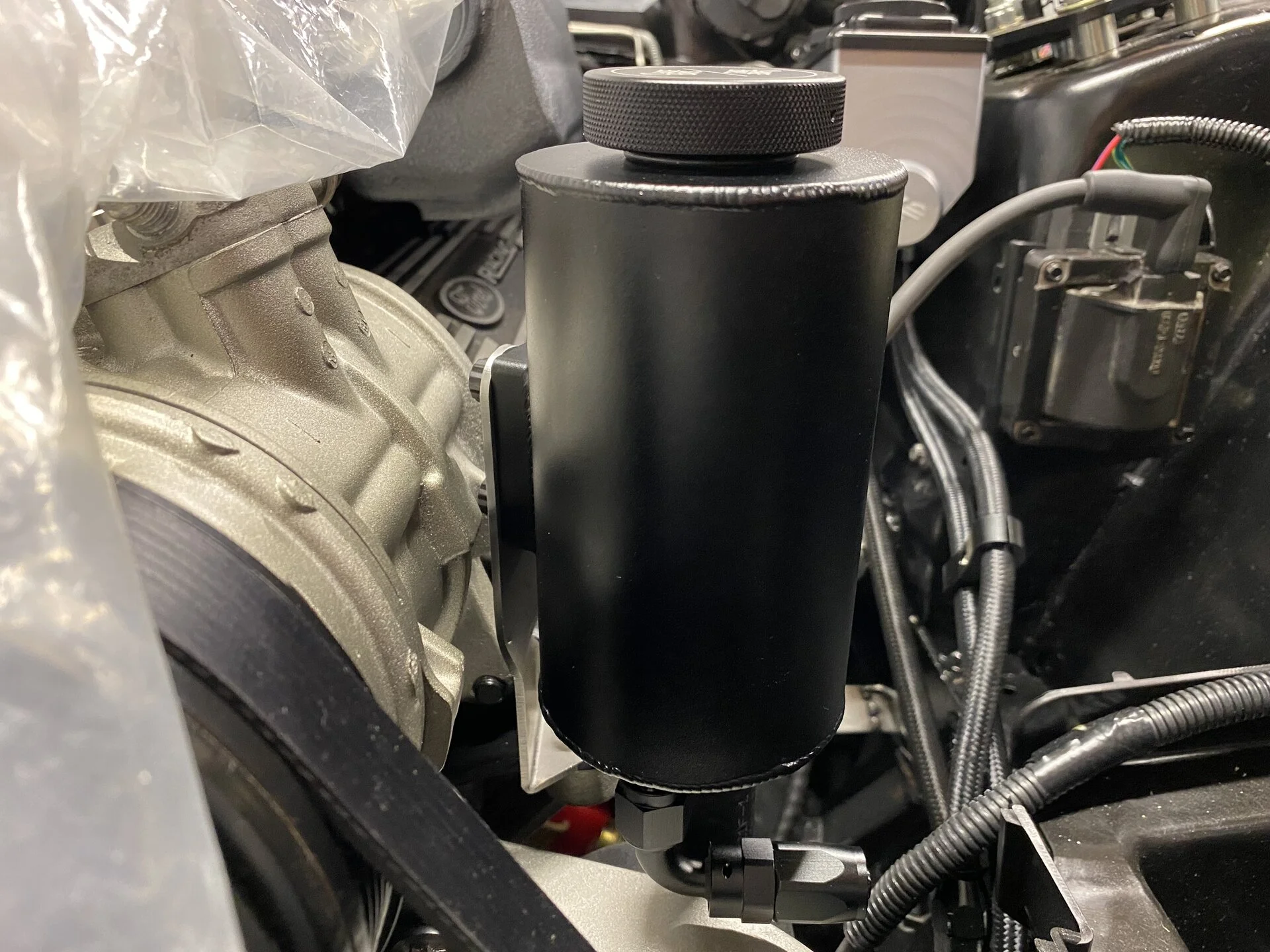

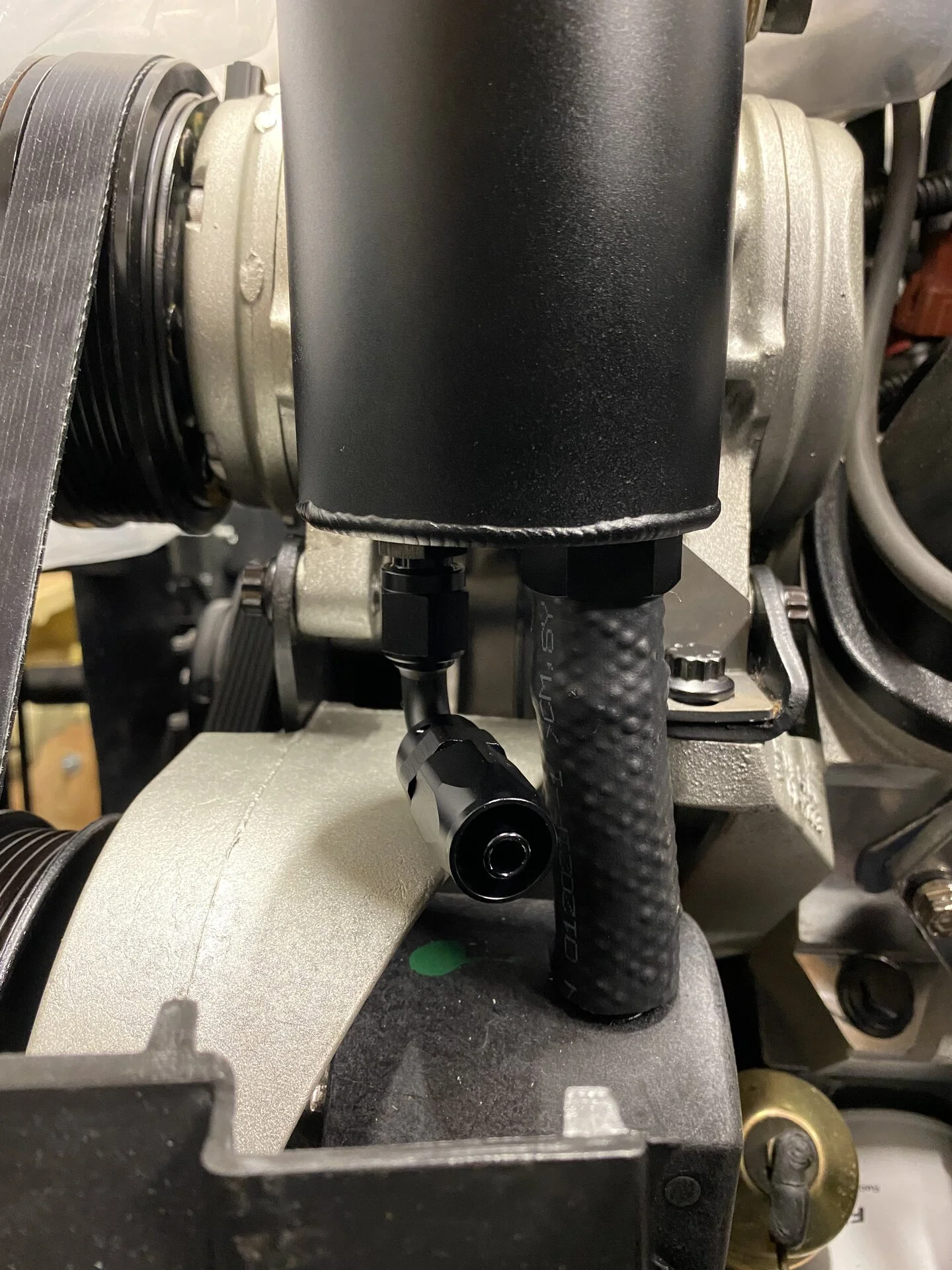

Went to the garage looked at it a bit and decided to chuck the bracket up in a vice and give it a little tweak.

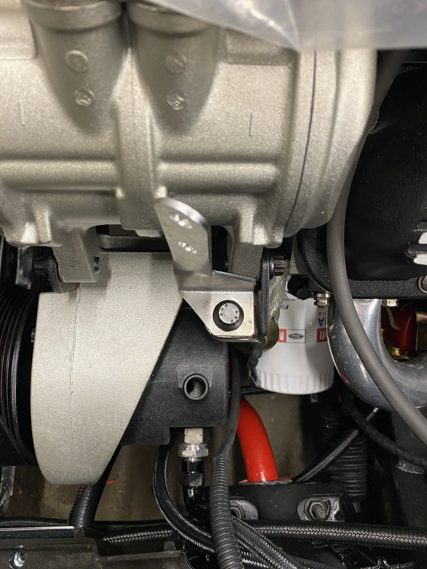

Twisted it maybe 20-30 degrees. This actually worked out great. The ports were almost perfectly aligned, and it rotated the canister a bit tighter to the ac compressor allowing me to access the rear bolts to mount the reservoir. Worked nice

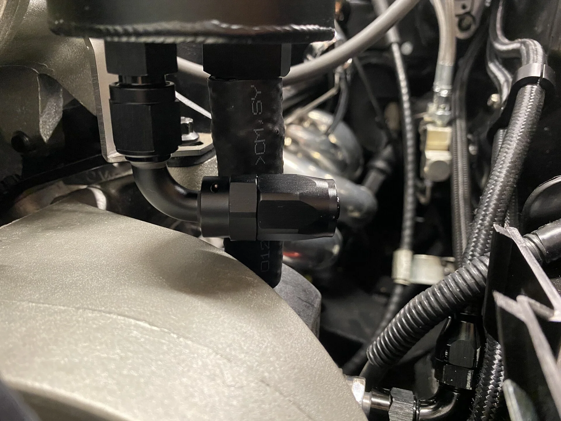

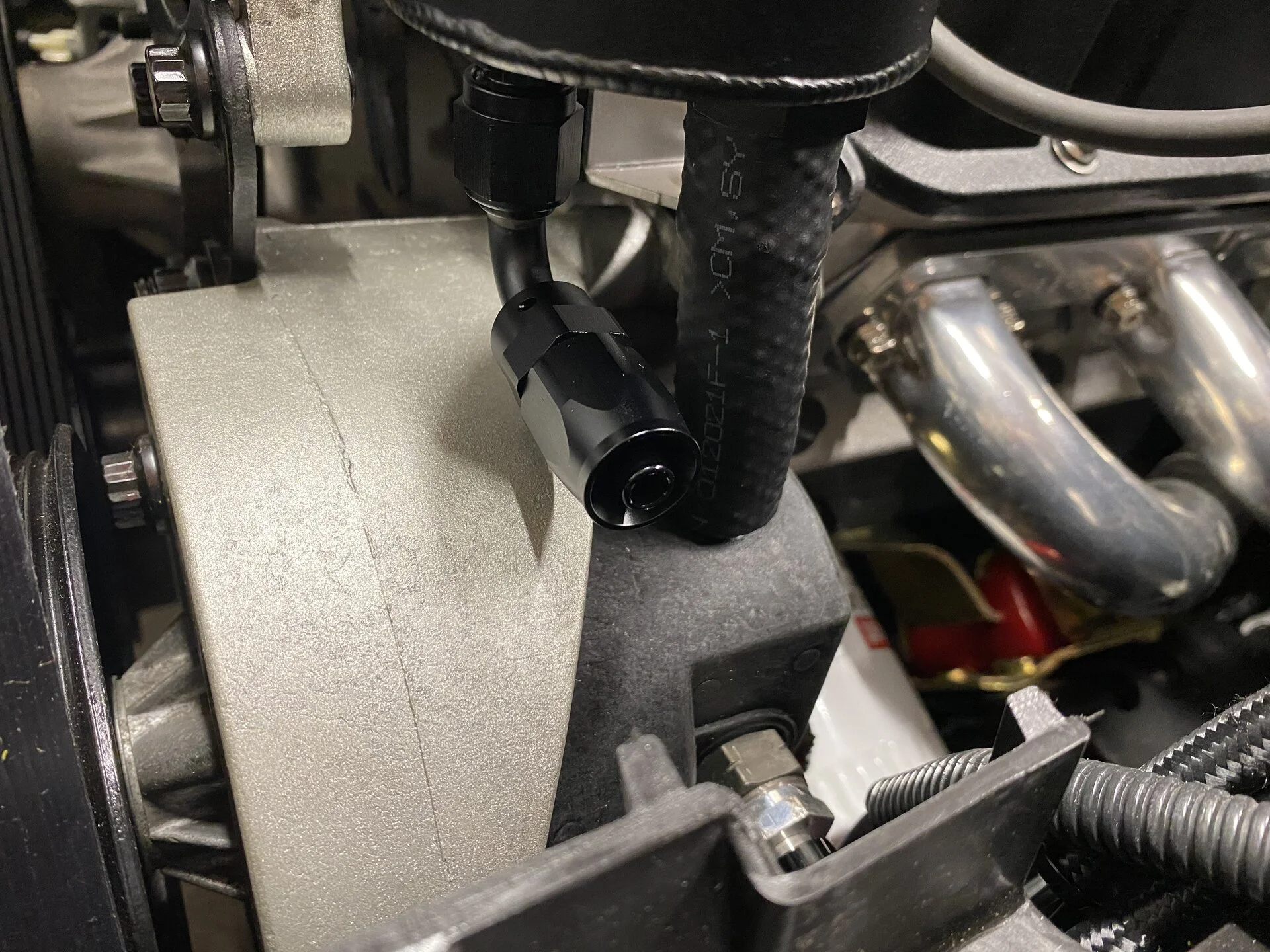

Here’s the downside. Rotating the pump and moving closer to the front closed the distance between the 6AN return line fitting and the pump bracket.
Originally I was going to use a 6AN 45* fitting here which would have dropped the line into the perfect spot. I tried a 60 degree fitting and that didn’t work. Now I have to use a 90 degree fitting and the battery tray is close.
I have some misc fittings. I will play around with this a bit tomorrow to come up with the most ideal way to run these lines
Since the hose will be so visible, I’m not going to run worm style clamps. I’m going to try those pinch type bands we all hate to remove on CV boots.
I’ll bend up the other two brackets to match tomorrow. I’ll rattle can black one for now, and powdercoat the other two later
Looks real good with that modification! I like how it's pulled the canister away a touch oppositional the valve cover's space.
Everything looks much more proportional with that tweak! In my mind anyway.. depends where a folk's eye take em.
Bent the other two brackets up. Picked the best one to get powdercoated and rattle canned the other two.

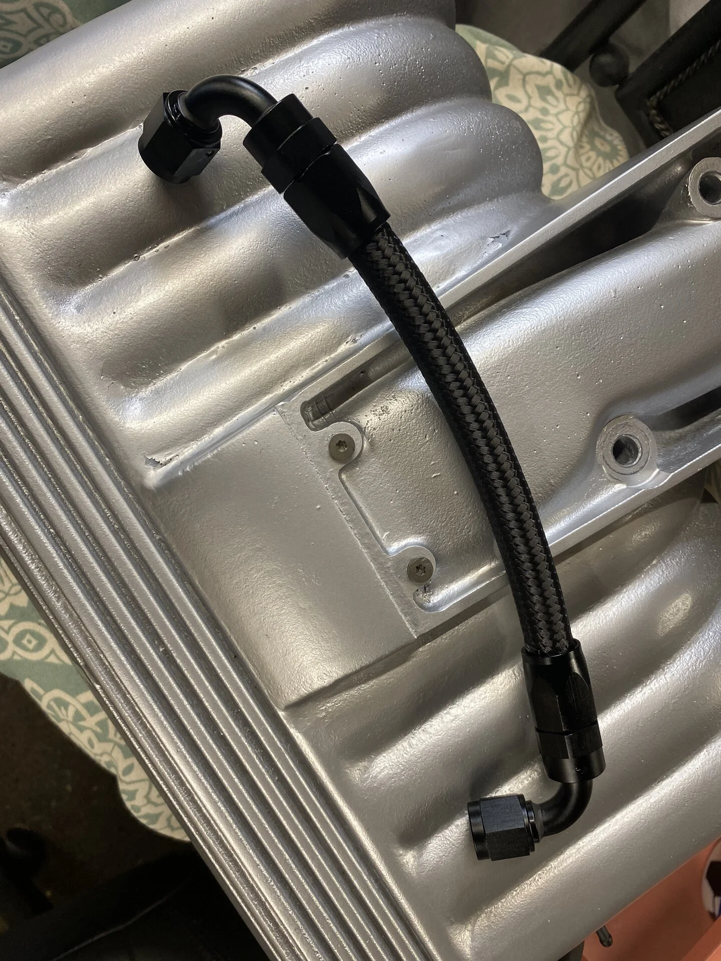

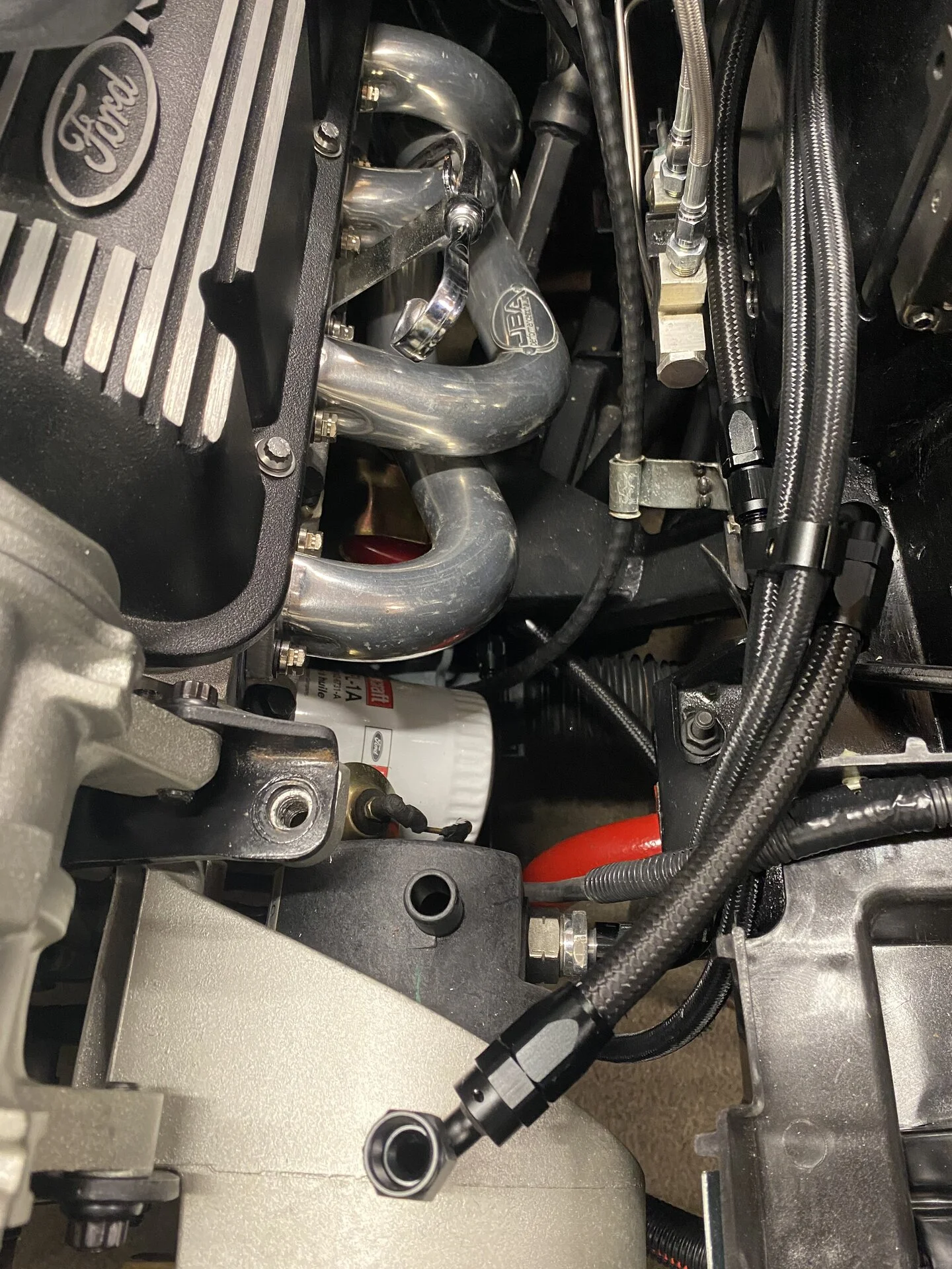

Made up the rest of my hoses
Need to pick up my two clamps for the big 16mm return line to the pump. Also, if you remember correctly the high pressure line to the rack got a bit cross threaded on the fitting. I got it to go on. After thinking about it, it did feel a little funny and I’m questioning it. So I bought a new fitting and am going to redo that line.
Almost there and then I can fill with power steering fluid and prime it.

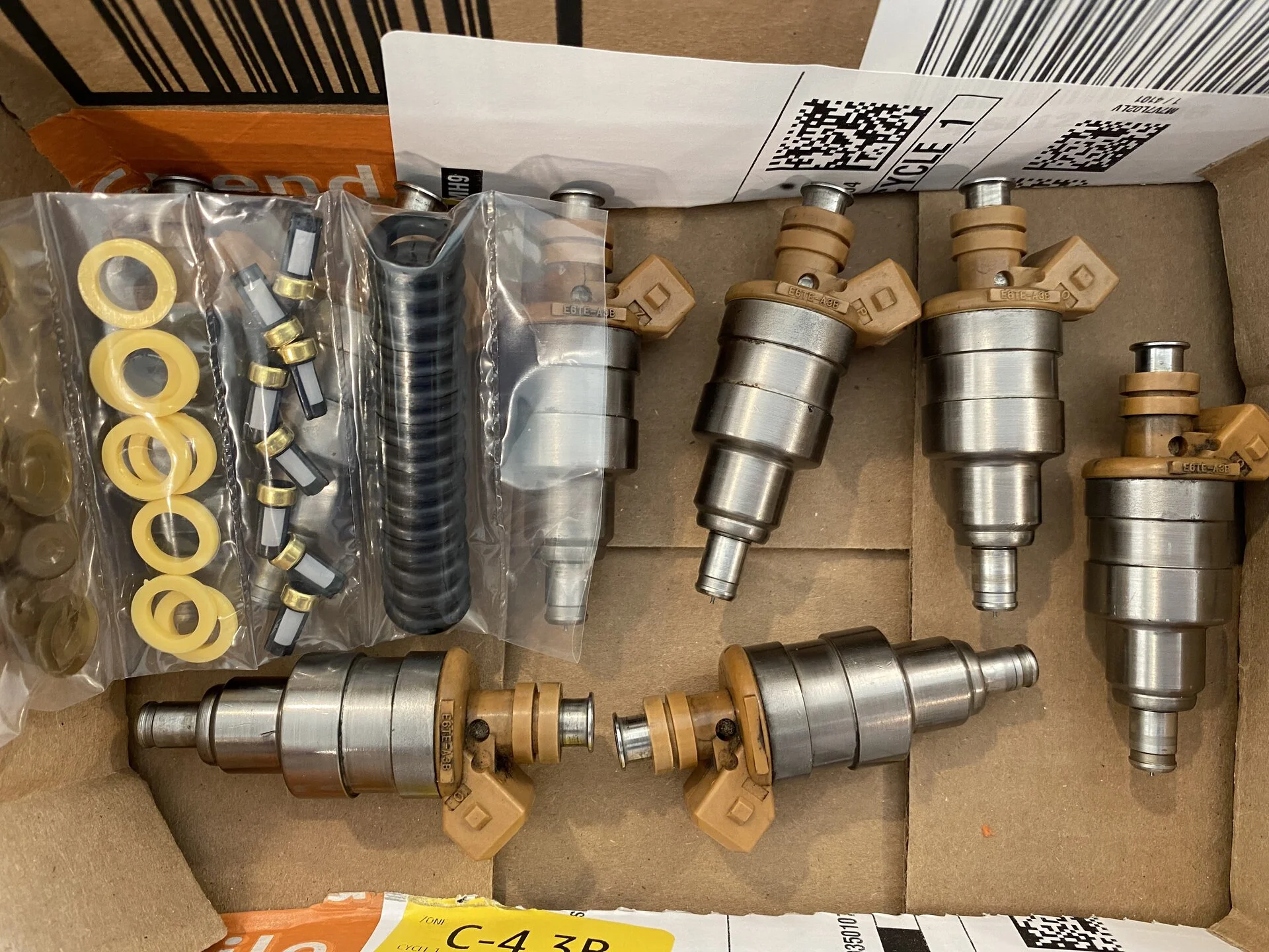

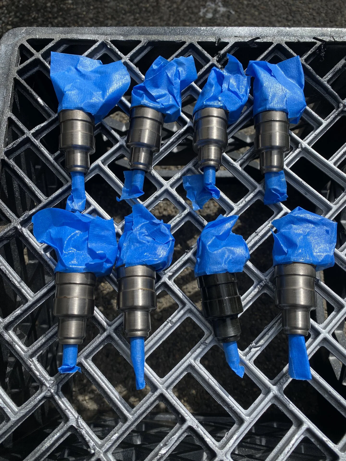

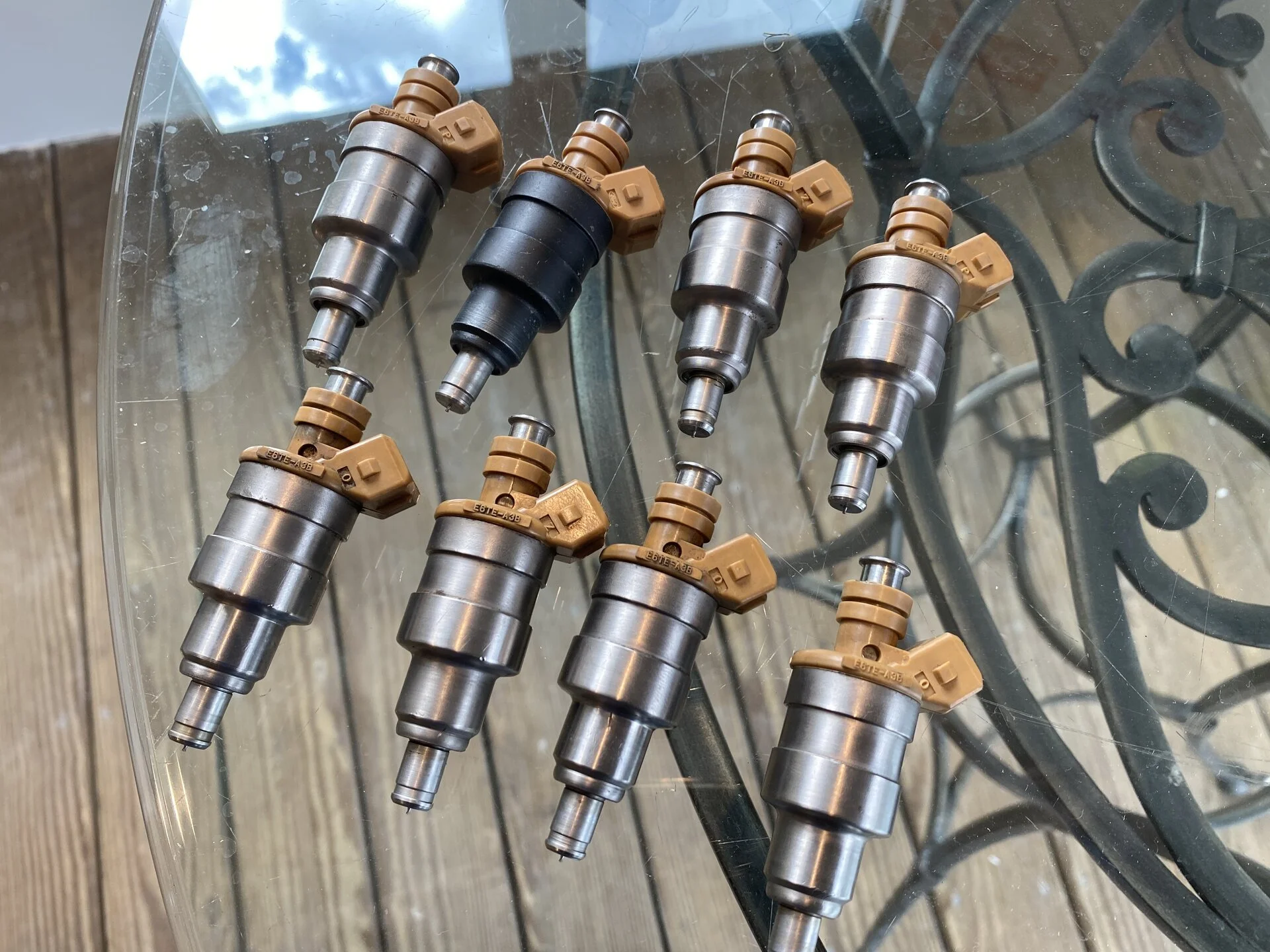

Going to reinstall my 19# injectors just to get the engine running. Even though this is temporary, I can’t put dirty crap on my engine. Decided to clean them up a bit.
First took a bit of scotch brite and cleaned the bodies up a bit. My original injectors are uncoated which I think changed in 1989? The reason one is black is because one injector was dead when I brought the car back on the road after 6-7 year back in 2009ish. Drove on 7 cylinder for almost a year. Funny story.
Decided to clearcoat the bodies to prevent them from flash rusting

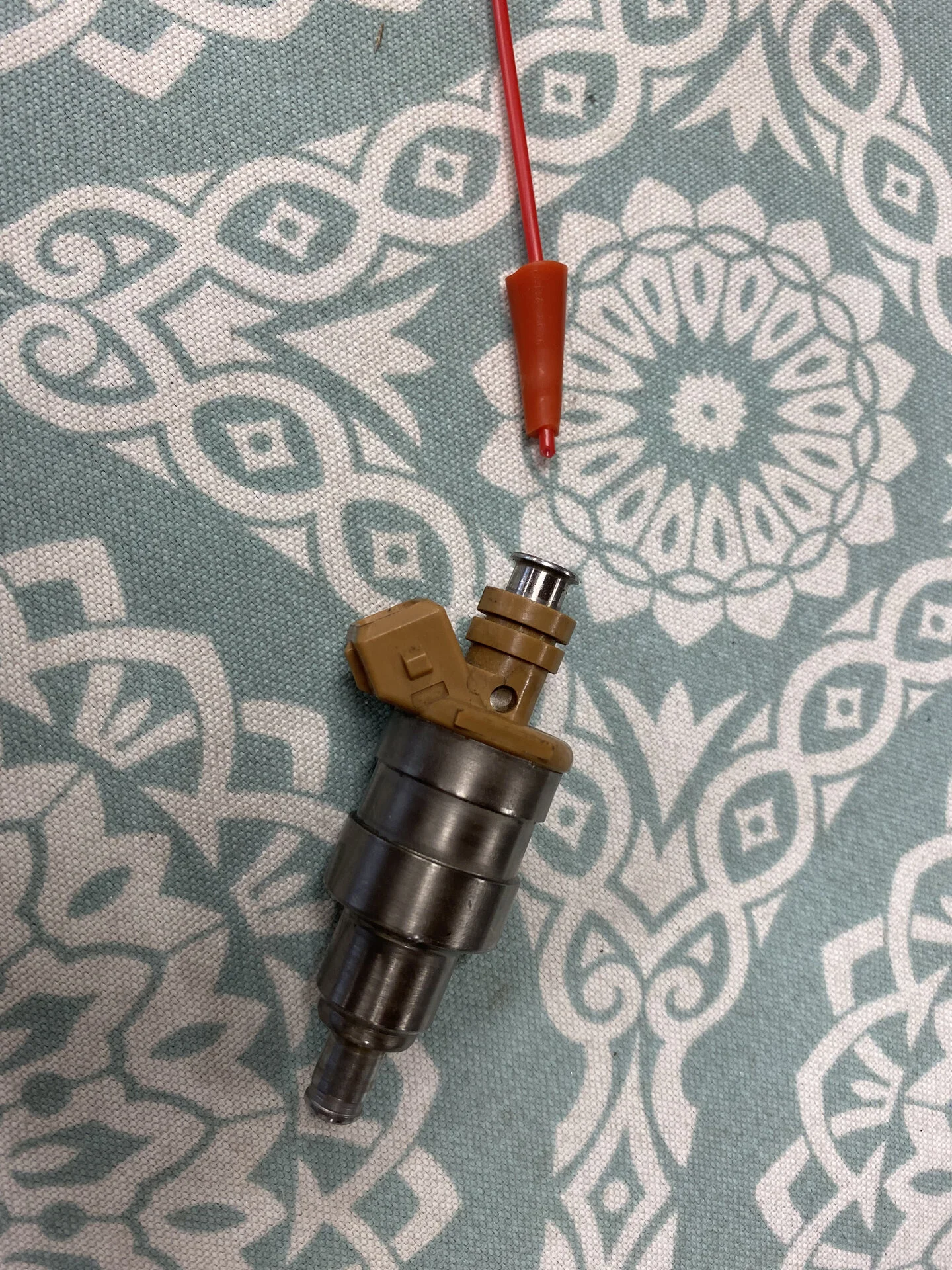

To flush them, I used a taper plug and drilled a hole for the areosol straw. Press it into the end and attach some carb cleaner. A 9v battery activated the injector. Believe it or not, original 100k injectors were not clogged at all. They sprayed quite well
Where I stopped for now. Will wait til I have a quiet night to finish these up. Then I can swap them out real quick and pressure test the fuel system

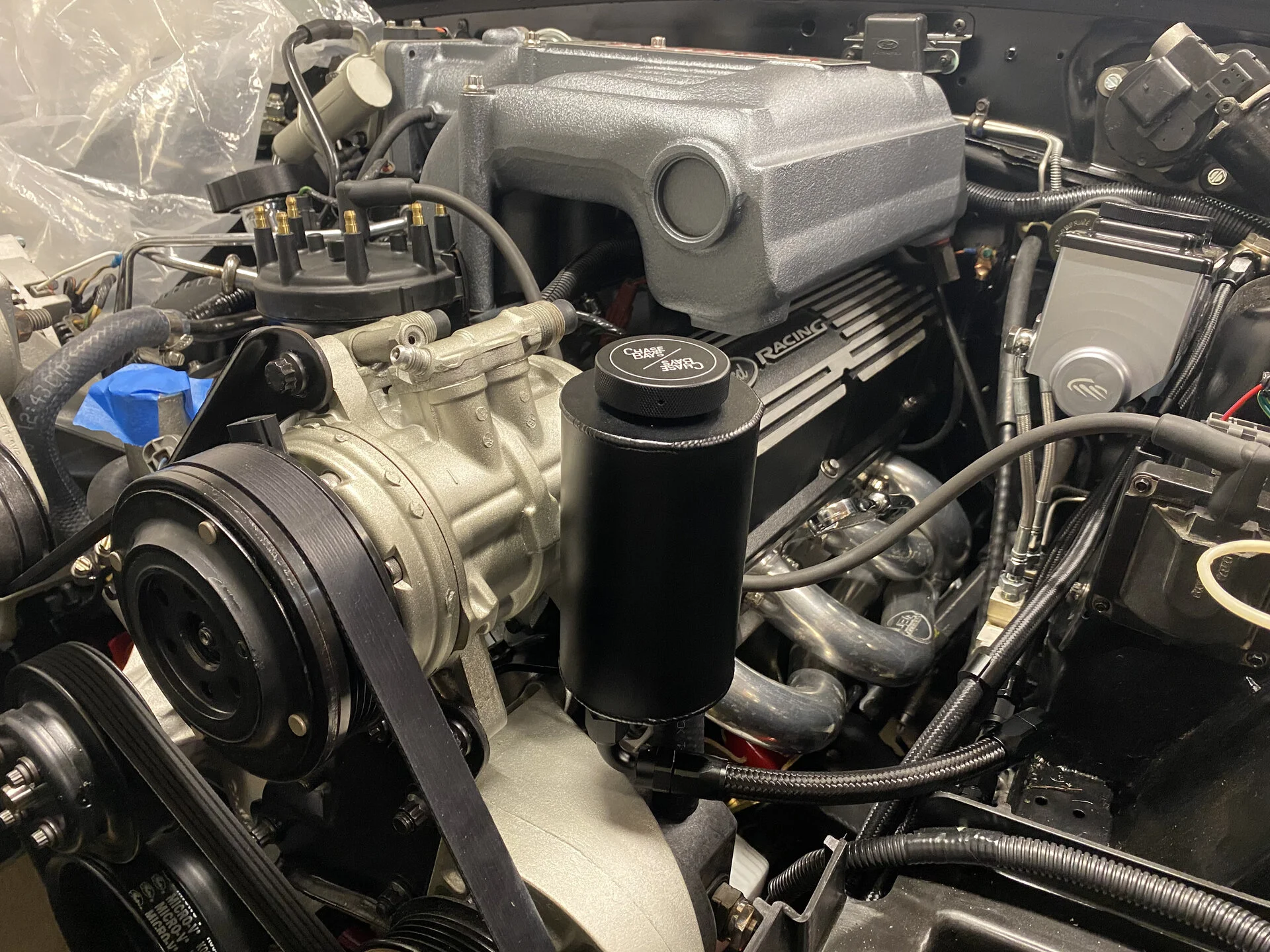

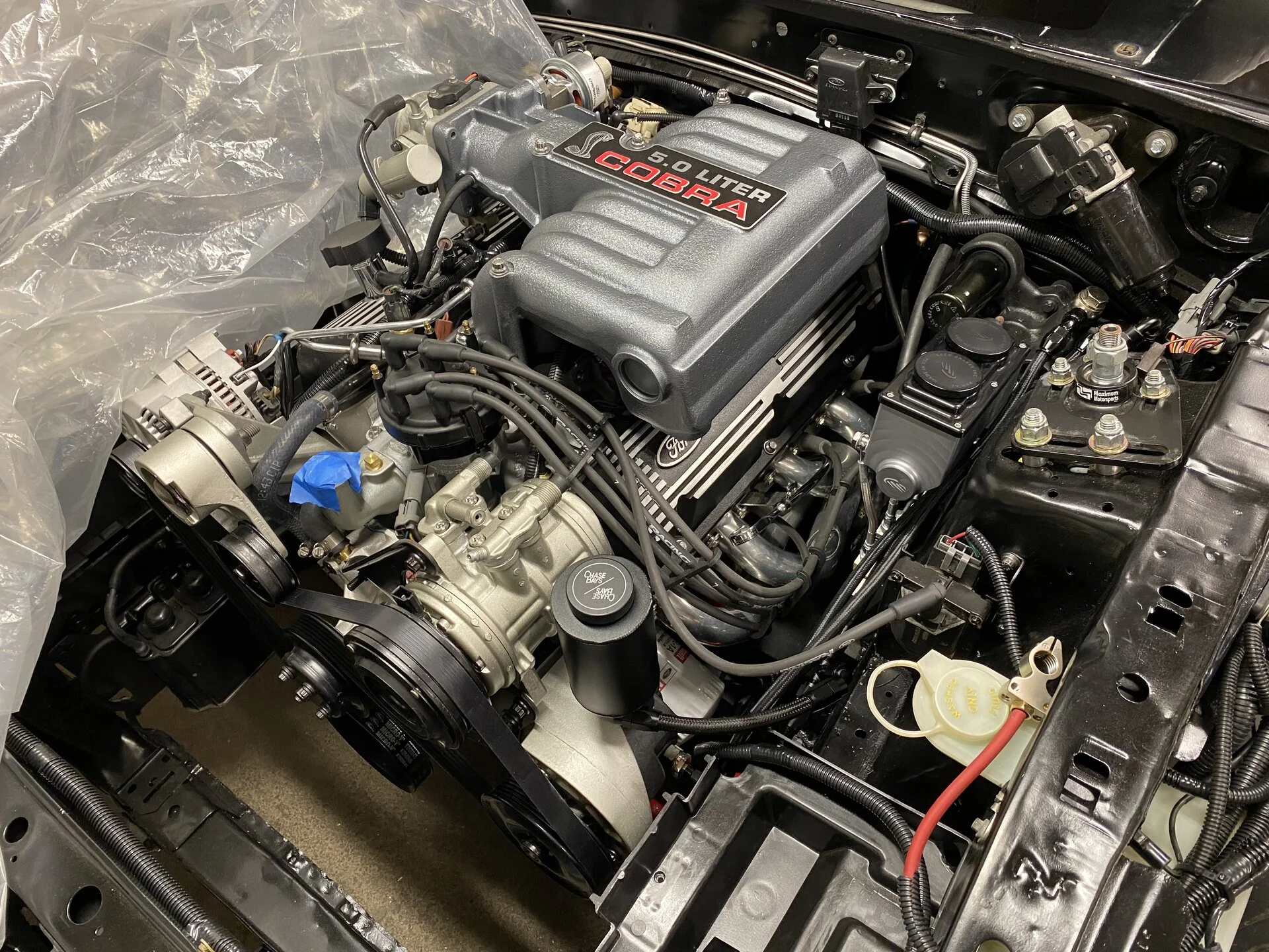

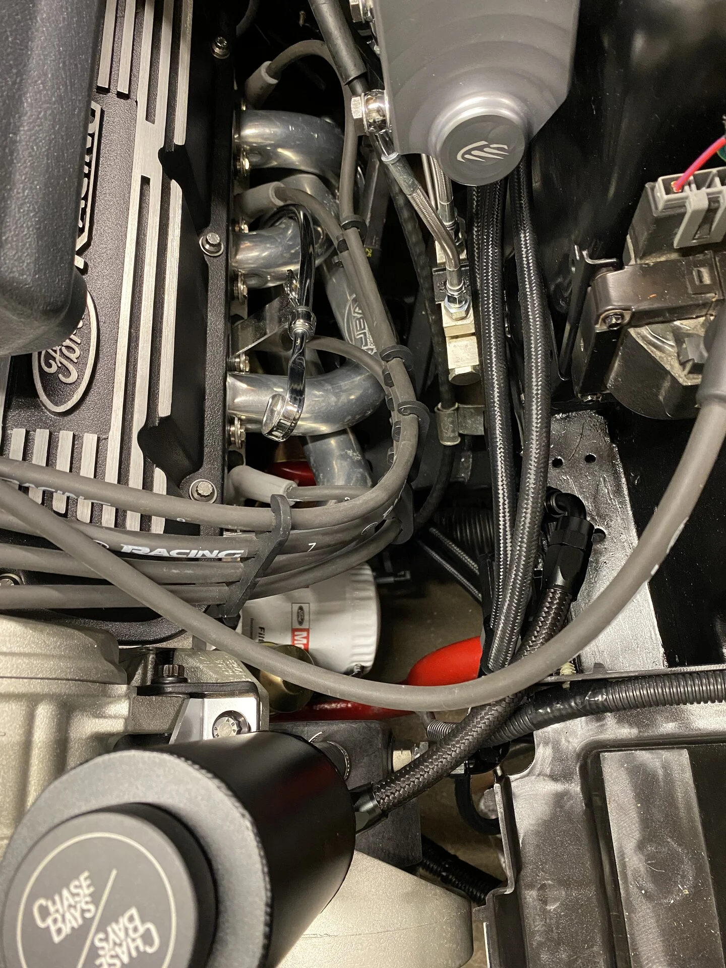

Ok, power steering done. Filled with fluid and purged of air best I can do before starting the engine.
Tightened up all the header bolts on the drivers side, the spark plugs and ran the drivers side wires.
Gotta do the other side next, and then swap the injectors
Lines all run
I really like the look that is coming together
