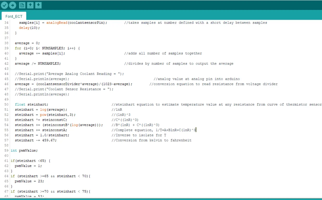

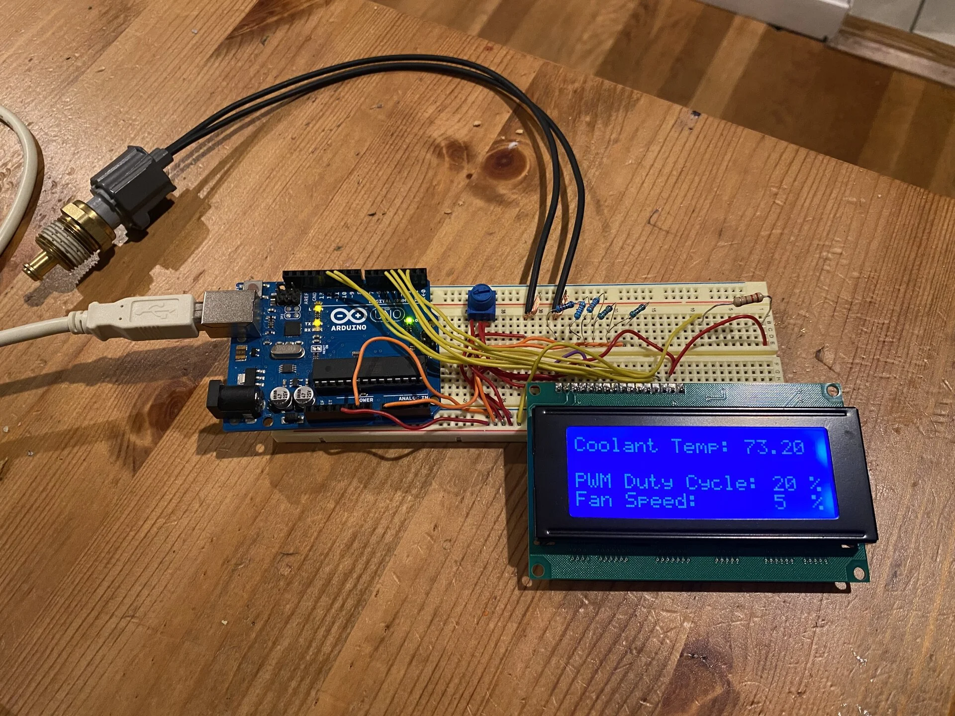

A few more lines of code and done. Just need to actually test it with the sensor in boiling water and verify the accuracy. I can tweak a few things to get it spot on in the 180-200 range where I want it the most accurate.
Was a fun project and the kiddo learned a few things
Ignore the values for now. Was just messing around. The fan controller operates on 20-100% PWM. So when duty cycle is at 20% fan speed will really be at 1% (i know it says 5%...ignore it). I’ll tweak these values when I actually input my desired fan speeds at specific coolant temps.
And if you are curious, here's a snip of my coding. I didn't write it 100%. Maybe 50% was "borrowed from the internet" and then i tweaked it a bit here and there to do what I needed it to do. 139 lines total.
Very nice coding - need to get into the Anduino stuff

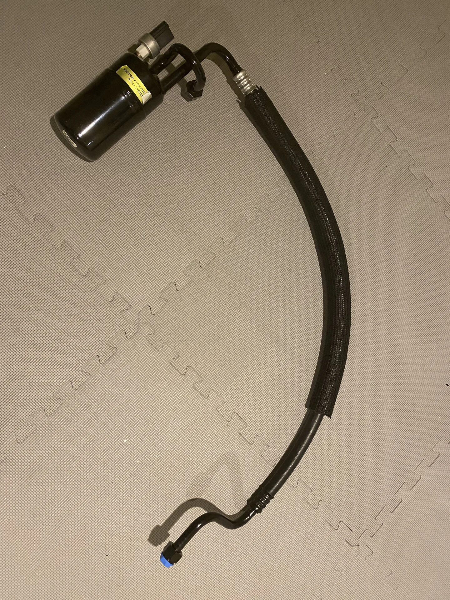

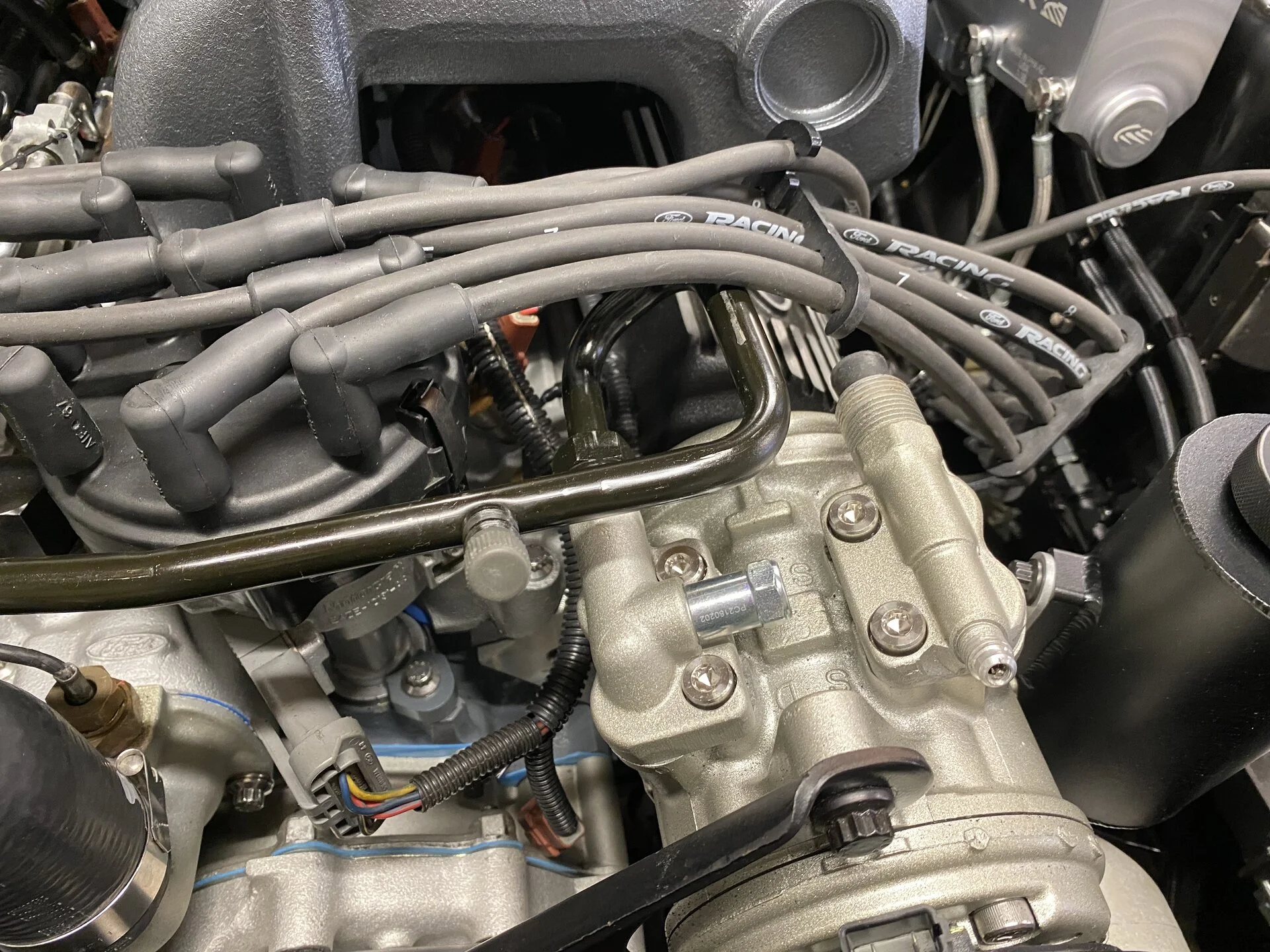

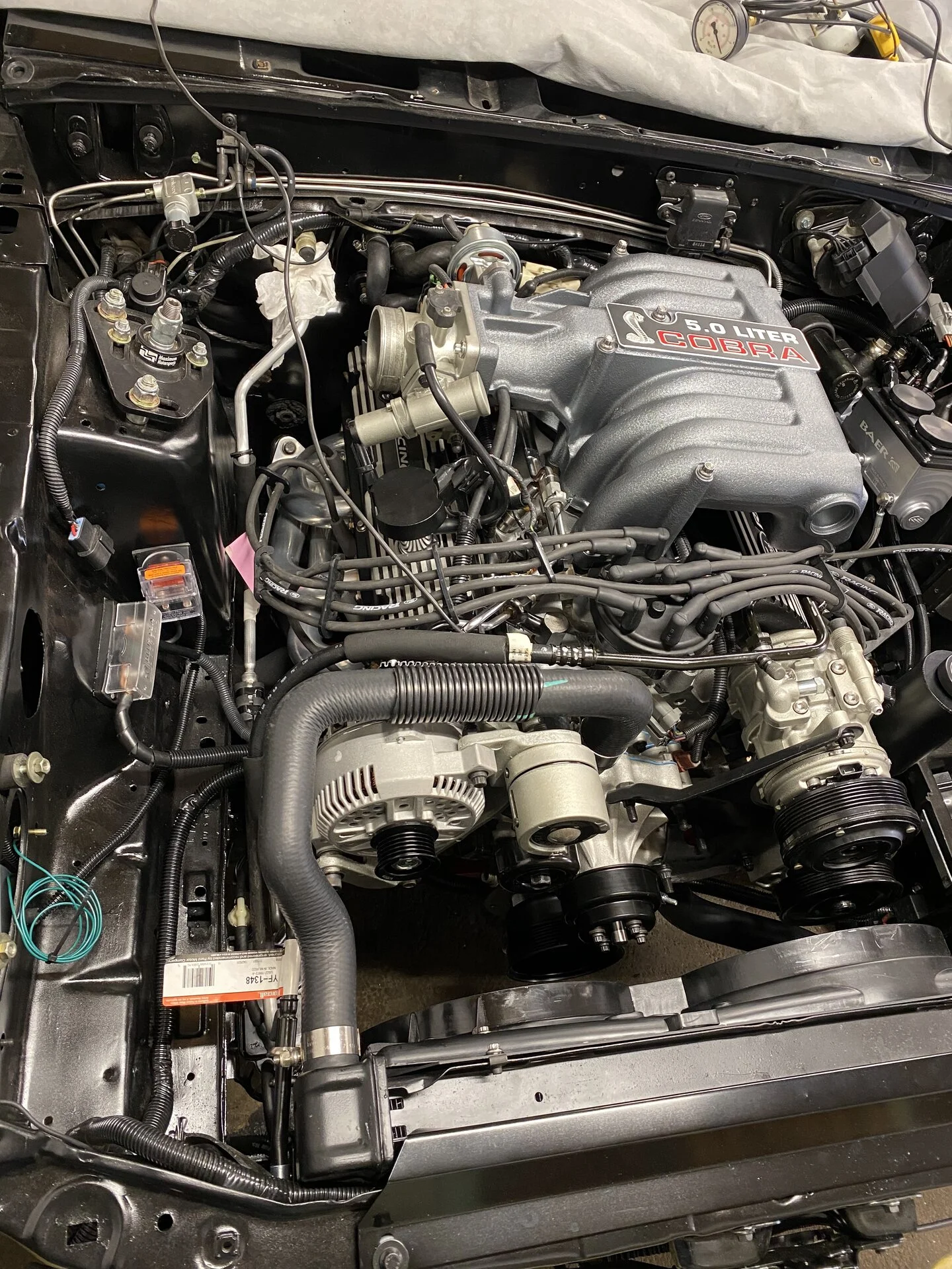

2 lines installed.

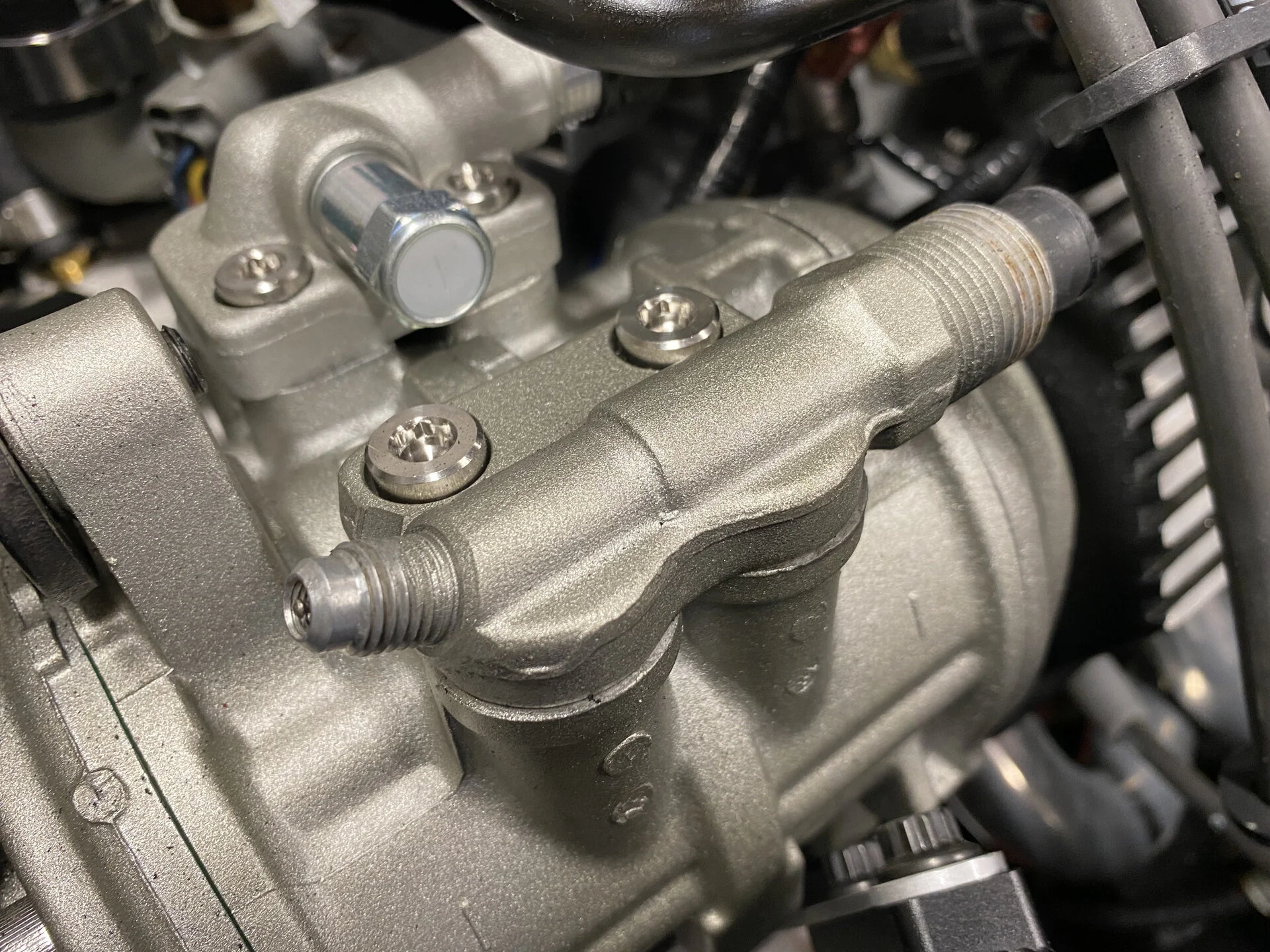

Ran into a snag on the manifold. Inside the mating portion of the manifold for the line is a half-moon shaped clocking feature. It clocks the line and prevents rotation. My compressor is off an ‘88. My lines have F3ZZ part numbers (1993). Going to assume that at some point Ford removed the clocking feature.
I attempted to remove it from my factory manifold but ended up damaging the sealing face. So I bought a repop off LMR. It doesn’t have the clocking feature. The o-rings they supplied seemed a little thin so I used the o-rings from my rebuild kit.
I guess I didn’t look too closely at the charge port side because it also has the clocking feature. I didn’t see it the first time I looked so I only ordered one manifold. This one is a tad bit bigger so maybe I can get the spring insert out that clocks the ac line. Worth a shot.
I did send LMR a message to see if their manifold has a R12 compatible fitting under the 134a fitting they supply. If anyone knows, let me know.
https://lmr.com/item/LRS-6888747/Mustang-A-C-Manifold-Service-Attachment-Charging-Port-79-93
Can’t install the accumulator line yet as some of the mesh sleeve I ordered got delayed due to this snowstorm. It can either show up today….or my luck Monday. I want to install the sleeve off the car before installing the line.
After that we can pull a vacuum, and charge with a little Nitrogen and check for leaks

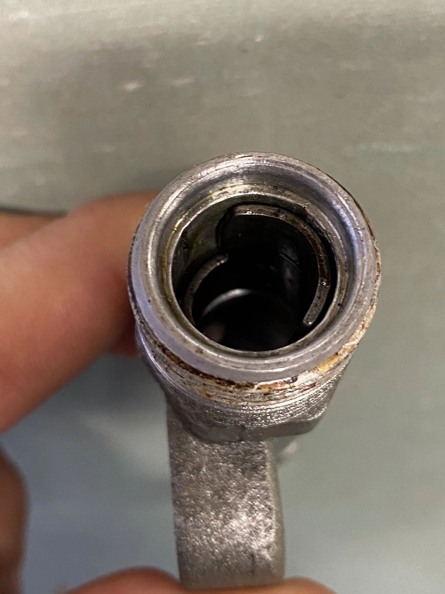

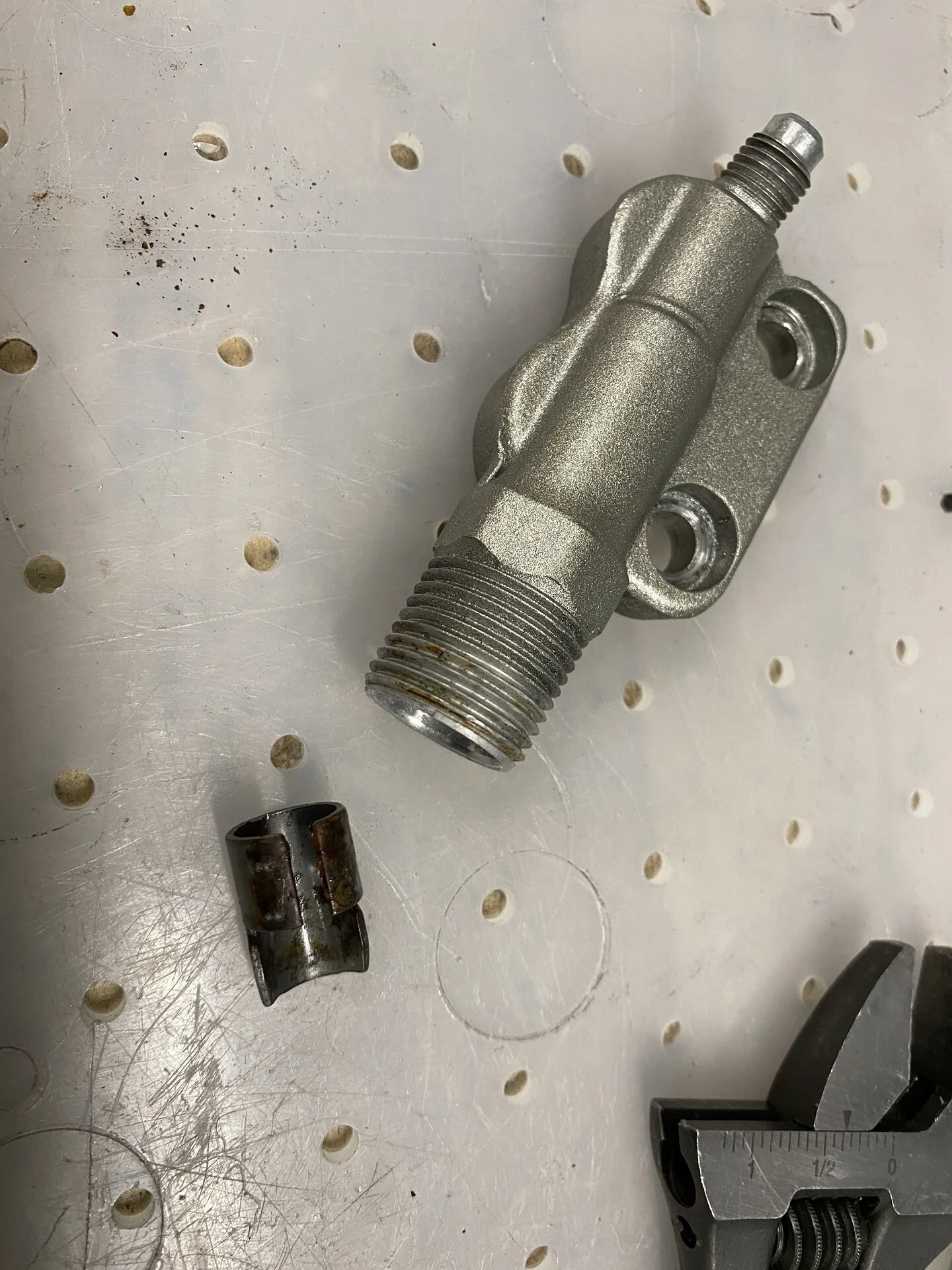

Here’s our problem child. I need to get this clocking retainer out without damaging the sealing surface
Can you use a hose from another year? My ‘86 hose supports the clocking.
Bill
Bill
Most of the aftermarket styles don’t have the notch. I’d prefer to use the Motorcraft line though.
I’ll get it out. I just need to track down an appropriate puller.

I have removed those several times. Pried up and bent them with a screw driver then Yanked out with needle nose pliers. Looks like you are missing the small R-12 cap...

I've removed them also many times. A small screw driver to pry the it towards the center and small needle nose to pull them out.

I tried that method. That’s how I damaged the first one.
Granted my screwdriver wasn’t as small as I’d like. I’ll take it to work tomorrow and see what sort of tools I can use there. I’ll get it out.

I removed it from mine when I redid the AC on my car but immediately put it back. Without it, my tube would rotate up and down fairly easy. With it installed the line is rigid. In my opinion it acts like a strain relief. I notched the tube of the new accumulator to match the original one. It has worked fine for 3 seasons now. The accumulator I used was not motorcraft one. I believe it was a four seasons. Your motorcraft one may fit better.

That did cross my mind as well.
The first line i installed on the other manifold seems to be holding it's position well without the clocking feature. I will have to just try it.
Cutting the line did cross my mind, but i'm more worried about getting metal inside the AC tube and also not cutting it in the correct location. Lets try it without the clocking tab, and if it's an issue i'll put it back.
The Four Seasons one they offer now does seem to have the notch. Not sure i want to shelve the motorcraft part though for aftermarket if i have it available. I likely won't charge with R12 until the summer. My plan was to pull a vaccum and then put 100psi of nitrogen in the system and let it sit until spring/summer and then do my R12 charge. I figure that's enough time for leaks to show up, or any other issues (like a rotating line) to rear it's head

I had my son hold the shop vac close to the tube as I was cutting in order to try and suck in all the shavings. Thanks for letting me know about the updated tubing with the notch, I will keep that in mind the next time I need to change out the accumulator.

Got it out without much fuss. Let’s see if I can get it installed tonight with the line
LMR responded that their manifold only has a 1/4” NPT fitting under the 134a adapter, because I’m the only crazy somnafabitch that wants to stay R-12

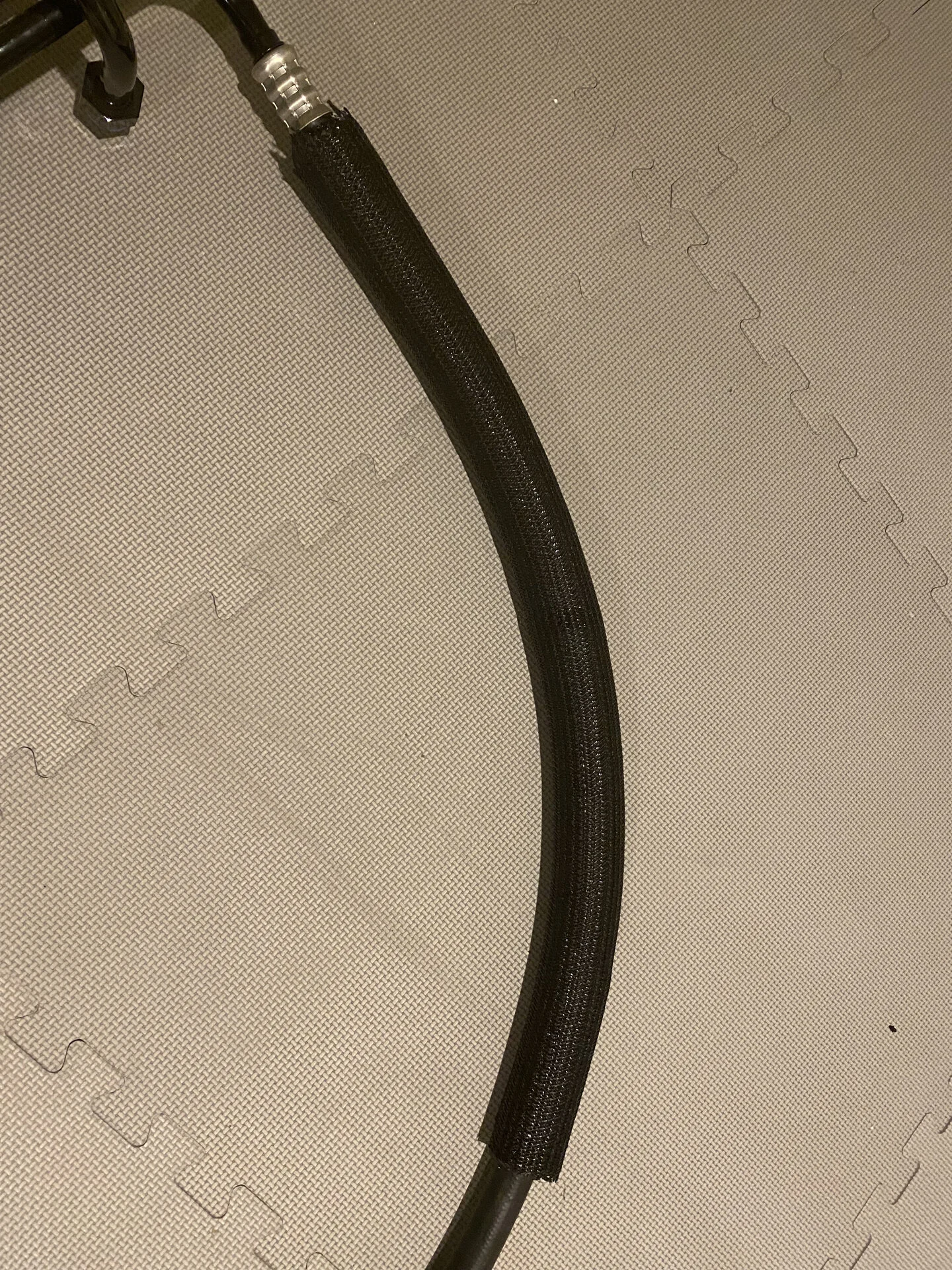

Fitting installed. Got my wrap for my AC line. I like it, but I need a clean way to finish off the ends. Ordered a few different heat shrinks to put a nice clean seal on the ends. So needless to say I held off on installing this
