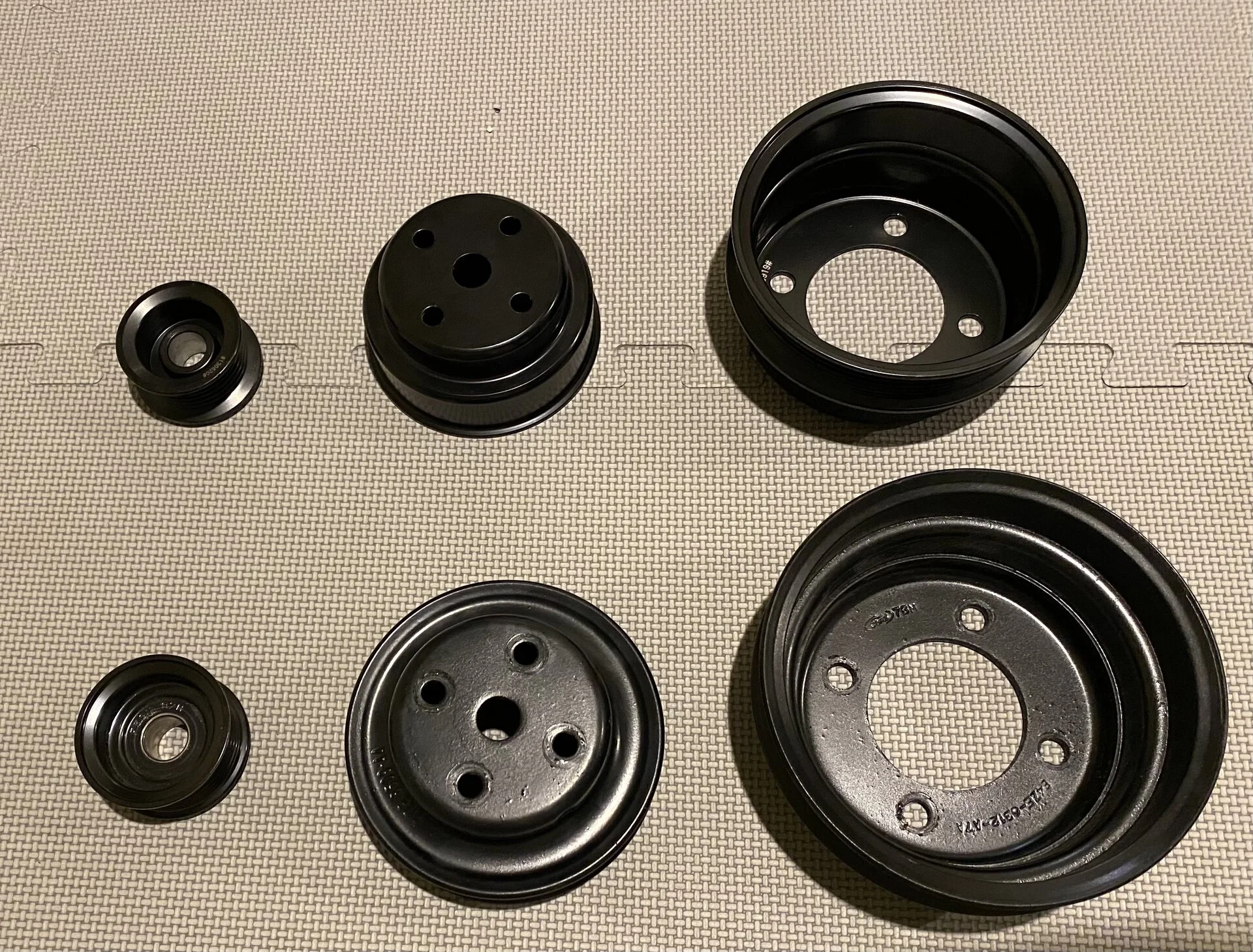

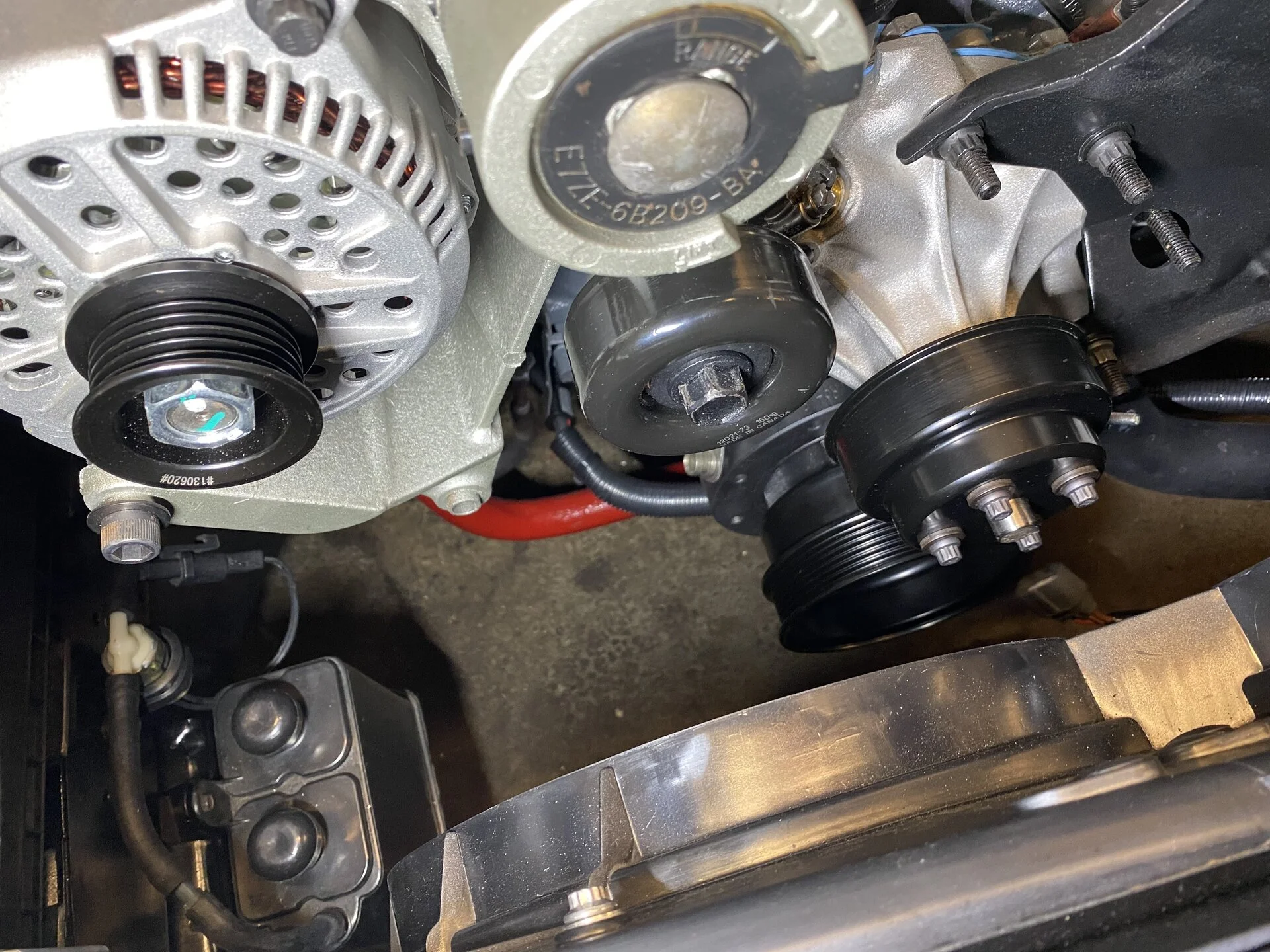

I did the maths on actual rpm if you search around for it if you’re interested . I think I did , idle cruise and my max rpm .Got around to installing my 93 Cobra pullies.
Supposedly they are an 11% underdrive on the power steering and a/c pulley only. Wasnt high on my list of stuff to buy but I was drinking…
Although there might be a benefit here since the crank and WP pulley are smaller the gap between them is larger. it give the belt a bit more room to shift if the pulley is misaligned. Going to move the PS pulley back in proper alignment and see if these pullies helped with the issue. That alone might make this purchase worth it.
Cobra on top vs stock
Installed. Now I need a new belt. I needed one anyway because the existing one was chewed up a bit due to the misalignment of the pulleys previously.
Part of me wants to put the stock WP pulley on to underdrive the water pump by 11%. I’m going to hold on that first though. While it is a high volumn pump, I want to see how well the car cools as is first before experimenting with under driving the WP.
I’ve run full underdrives (25% reduction) before without issue and feel they can be run fine if your cooling and charging system are robust enough. We will experiment with that later.
Yeah I had w/p speed in there too if not I have it in my phone for sureFound it.
I did the math on the alt pulley just to be sure and it works out fine.
I think later down the road, we will try going back to the stock WP pulley to slow it down a tad and see what happens.
One of these days I’ll build that fancy excel spread sheet with drop downs for the various pulley sizes.
I actually think you can then use that to have it calculate out proper belt size as well.

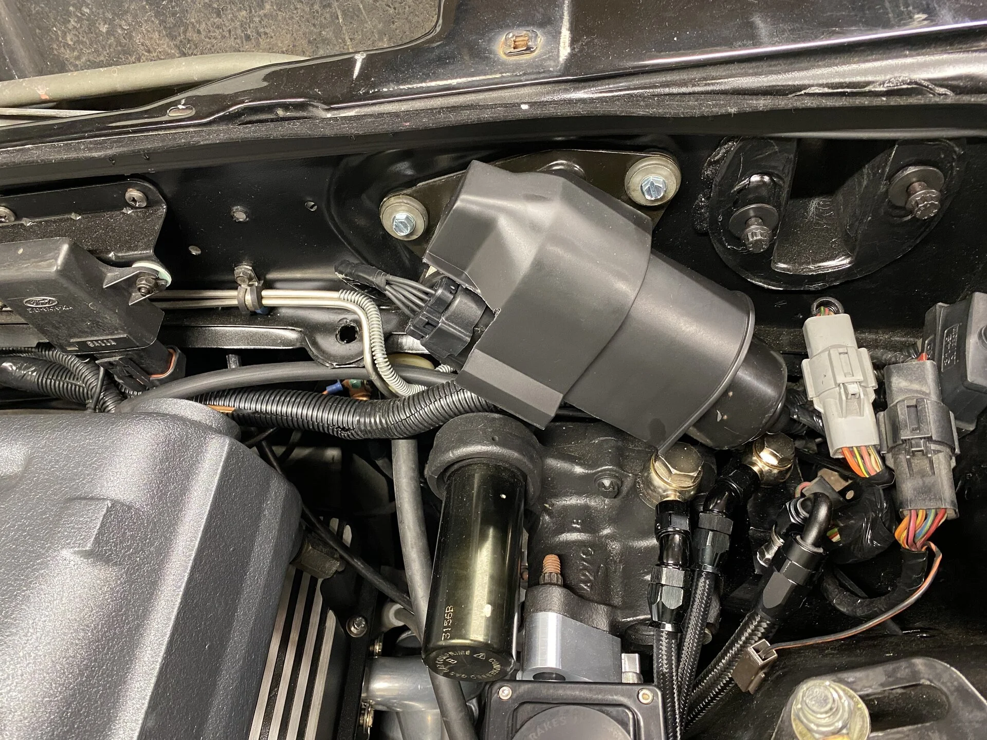

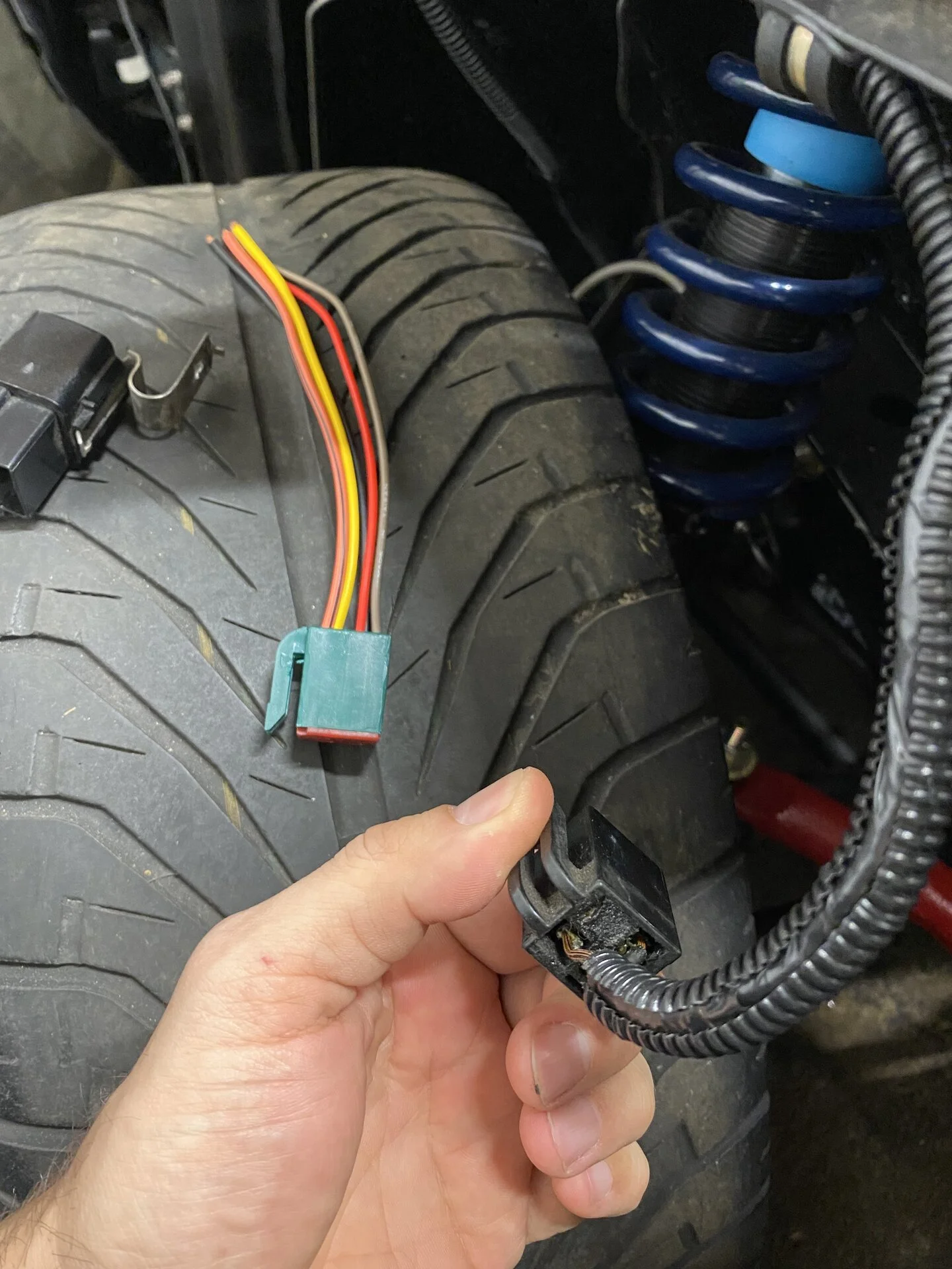

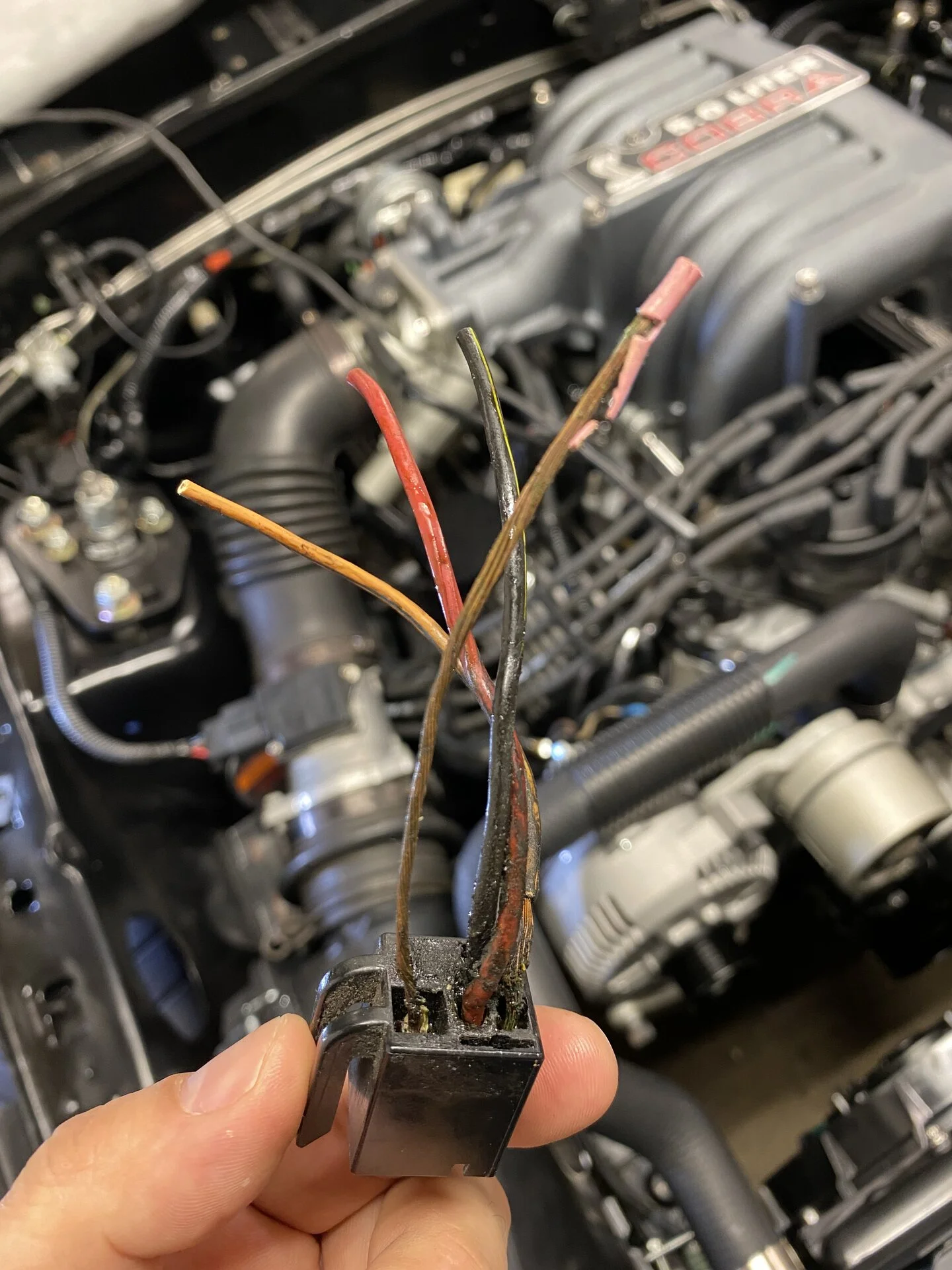

Ideas. 1. McMaster CarrFinally finished up the wiper motor. Converted to the modern 5-wire type and trimmed the LMR repop wiper motor cover to fit it. The SN95 motor is nice and quiet as an added measure.
Of course, I don’t drive the car in the rain so it’s really moot.
I need to find the mounting hardware in black. It’s an odd size thread pitch so hardware choices are limited. I may try and blue them using a few home methods by heating and oil soaking them.
