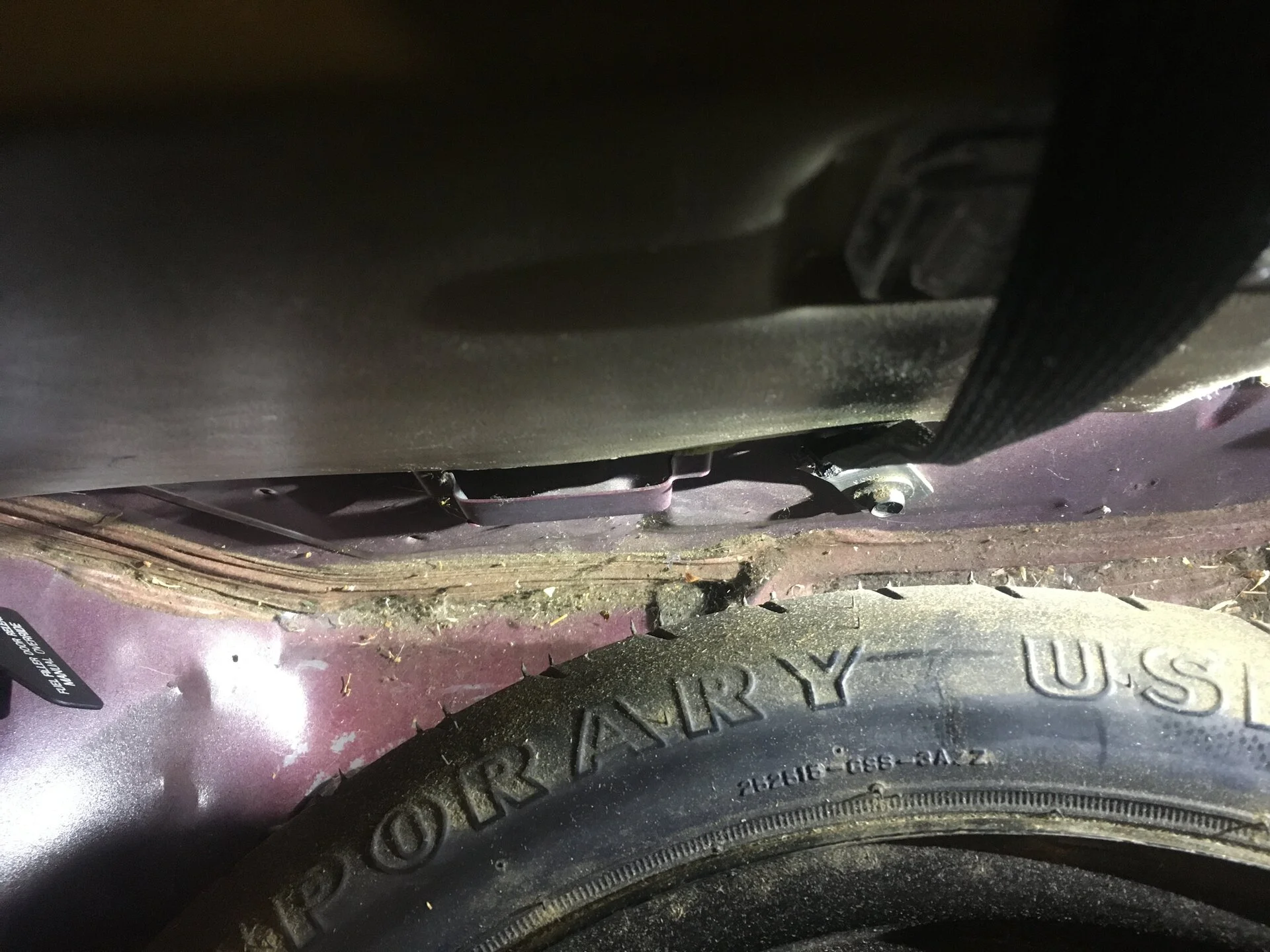

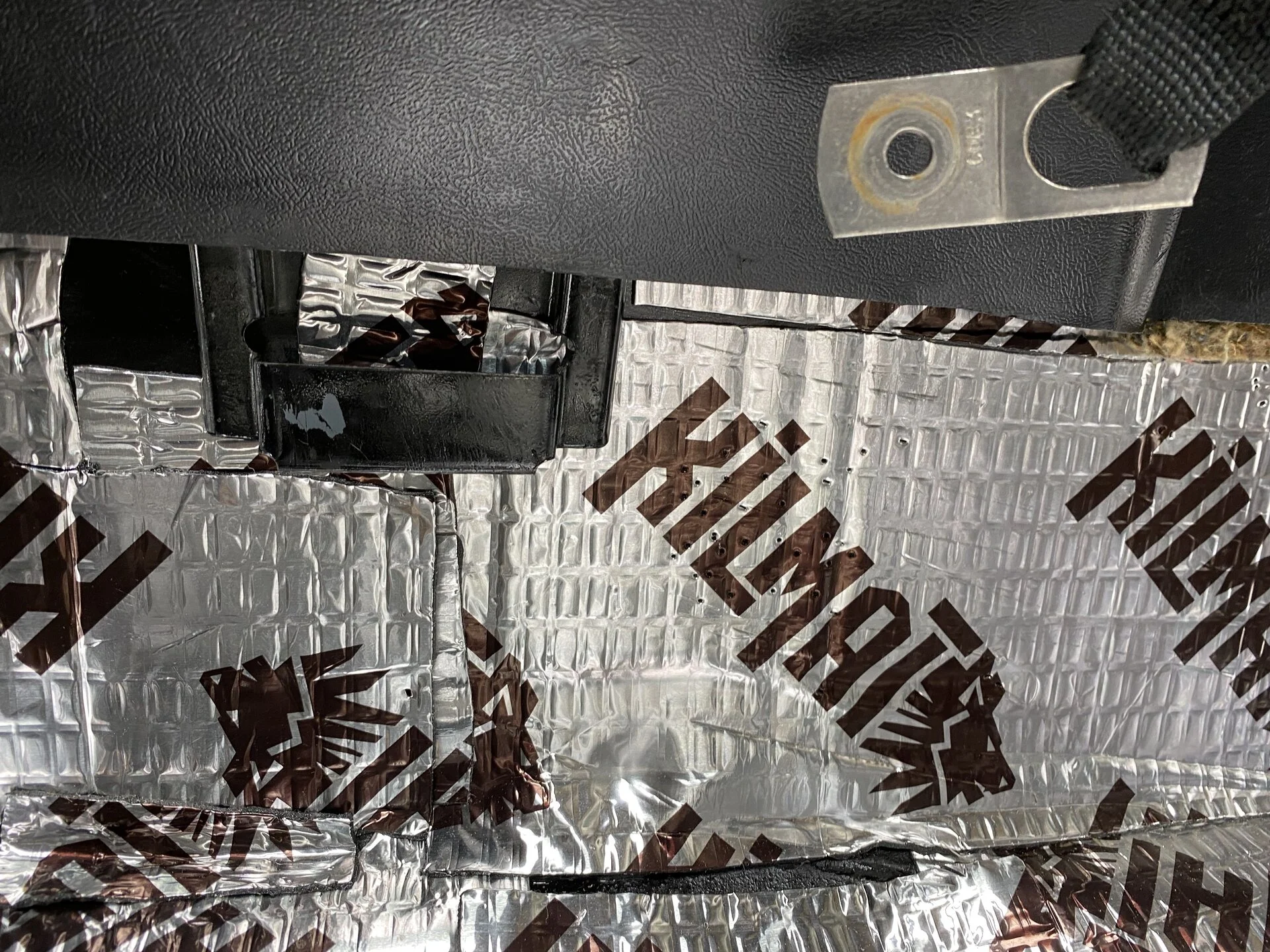

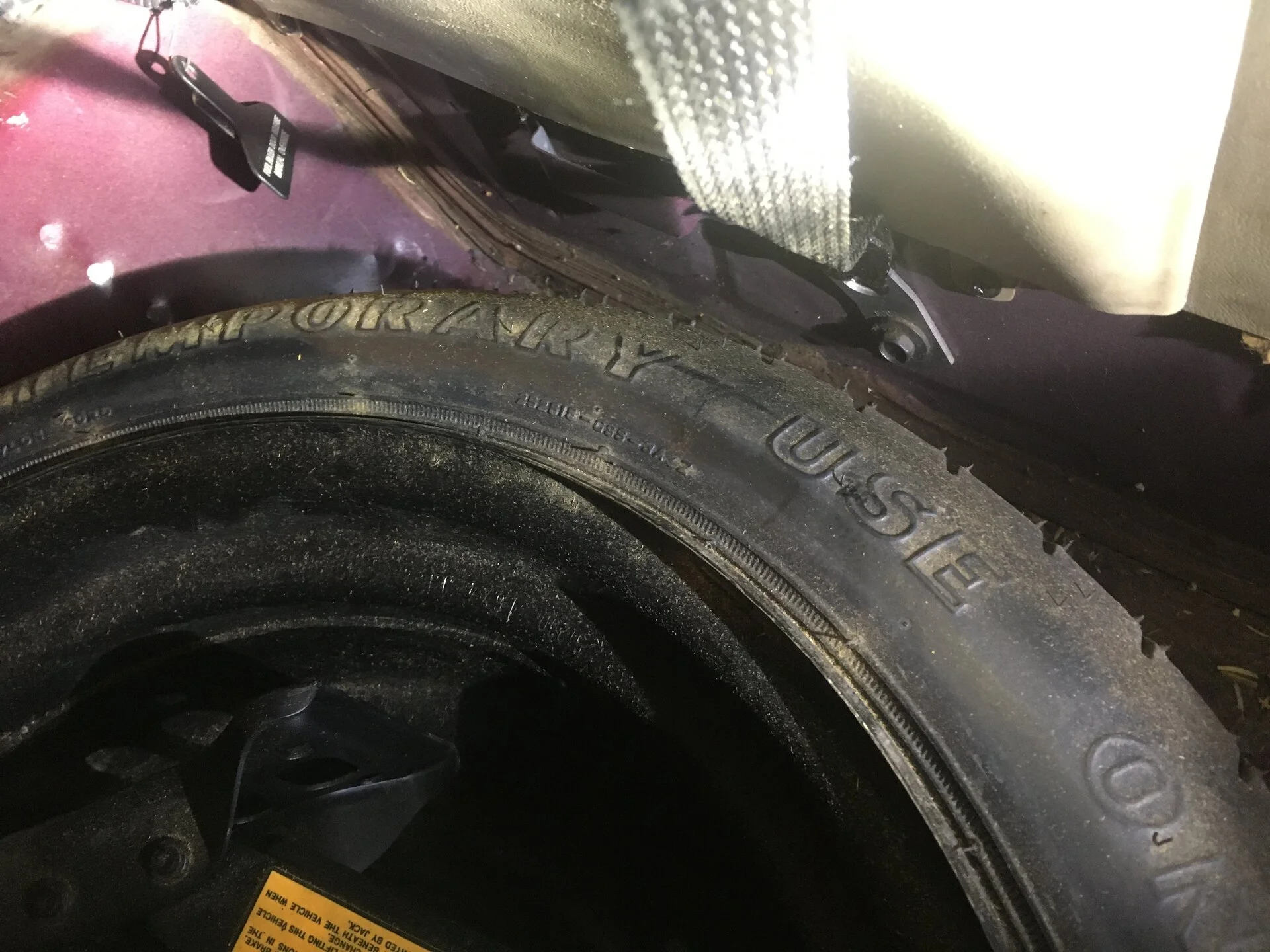

Anyone have a shot of the sunroof strap bolt location in reference to this bracket?
Can’t find the hole :cautious:

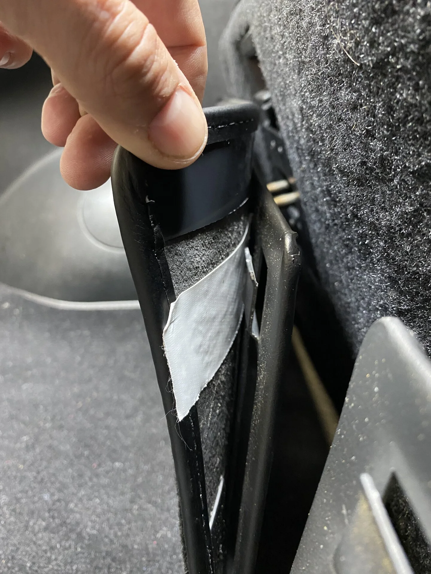

so I messed around with the carpet tonight to see how it could be made to fit. Seems the issue is the seatback flaps themselvss
If I set the flaps where they should be, it causes all the material to bunch at the rear of the hatch, like this.
However, if I lay the material in the hatch the way it should fit, the creases actually align pretty good, almost perfect.
However…
Now the excess material rides up the seat back flap. The white duct tape is where the new flap for the hooks needs to be.
So yeah, I need to tell ACC to chop 1.5” off te top of of the seatback flap, on a carpet they have sold thousand of.
This should go well.

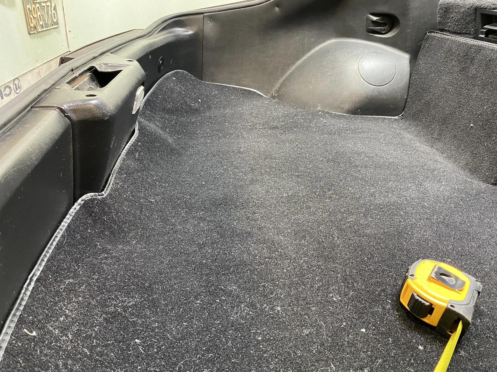

I watched a few videos on the carpet install and looked around a bit on FB and think others have the same issue but they just aren't as picky about it. For instance the install video on CJponyparts shows the carpet having the same overhang on the seatback flap. They play with it and then don't show the material bunched up at the bottom of the hatch. I've also seen a few pics online of the rolls of extra material as well.
For example. You can see the extra material is just bunched up at the bottom of the seatback. It's harder for me to do this because I bought the mass-backed Essex style carpet, which is thicker and doesn't bend as well like this.
Doesn’t it need a little extra there for when the seats get folded forward?
