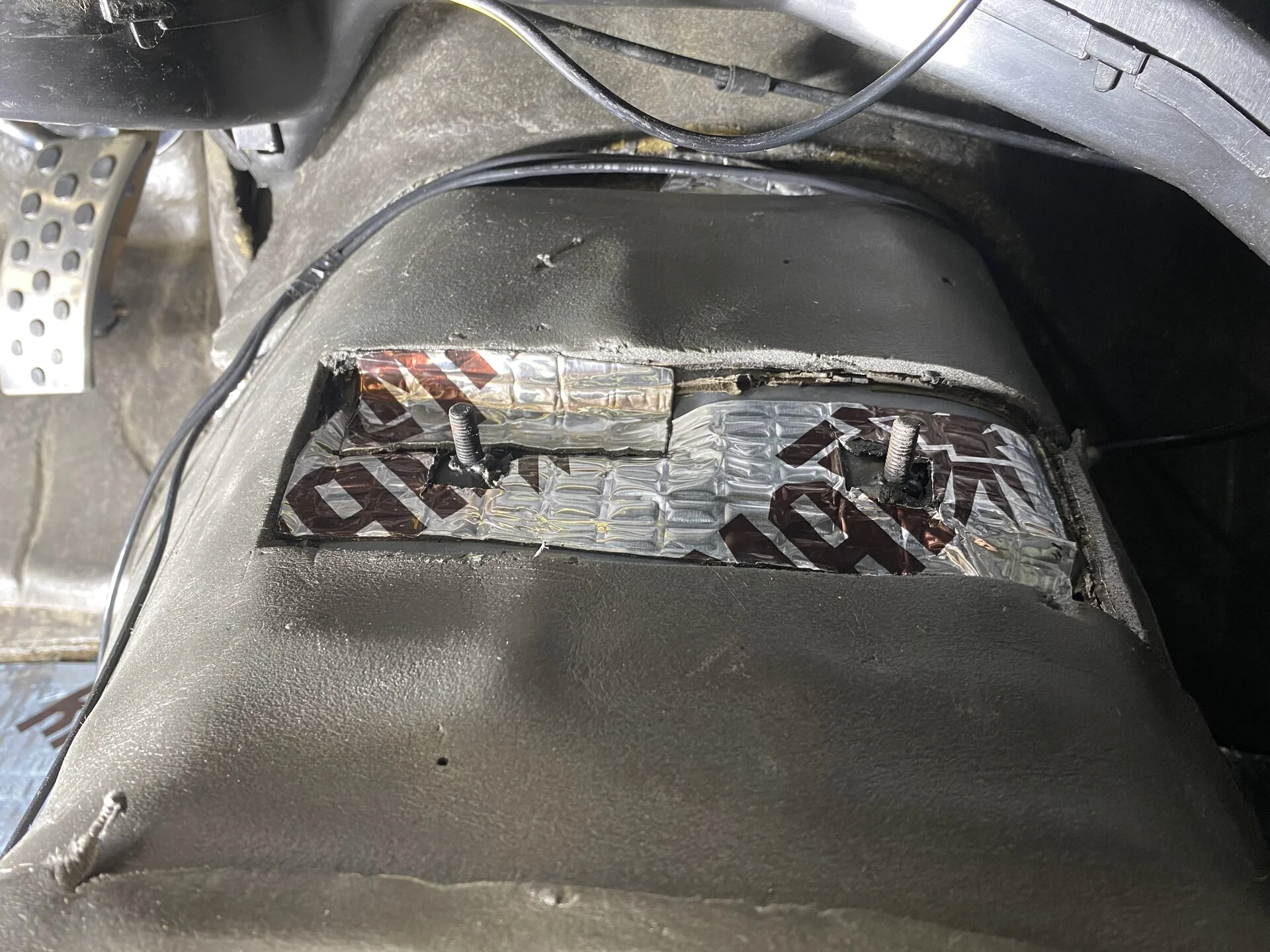

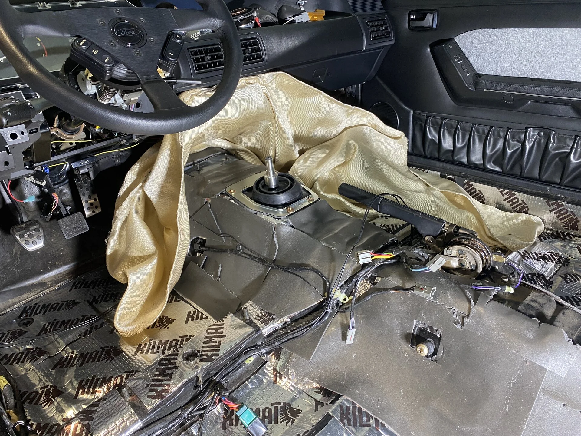

Like prepping for surgery.

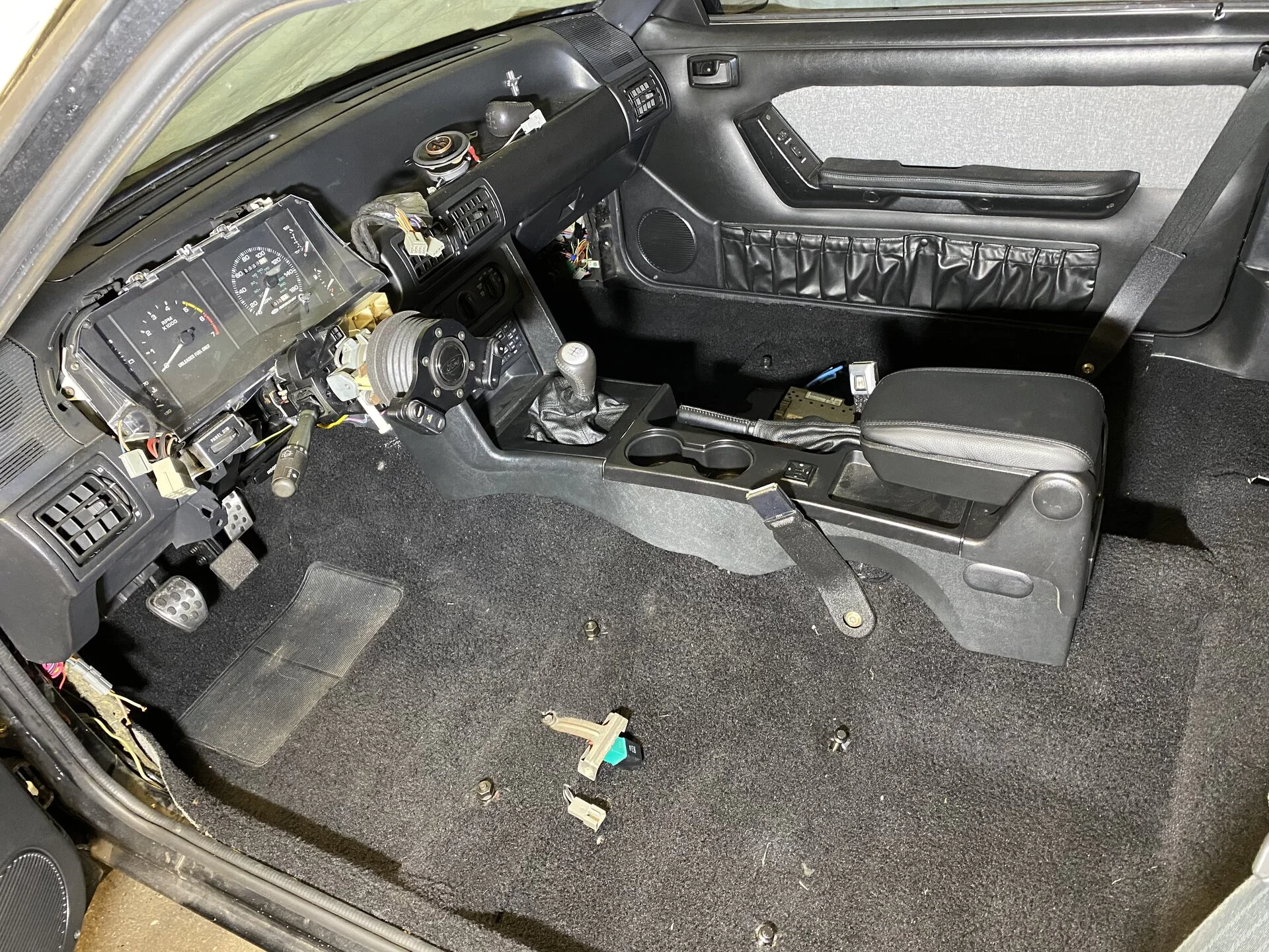

Both studs got a few tacks. Ran a thread die down to clean them up. Should be good to go to put the carpet back in….again.

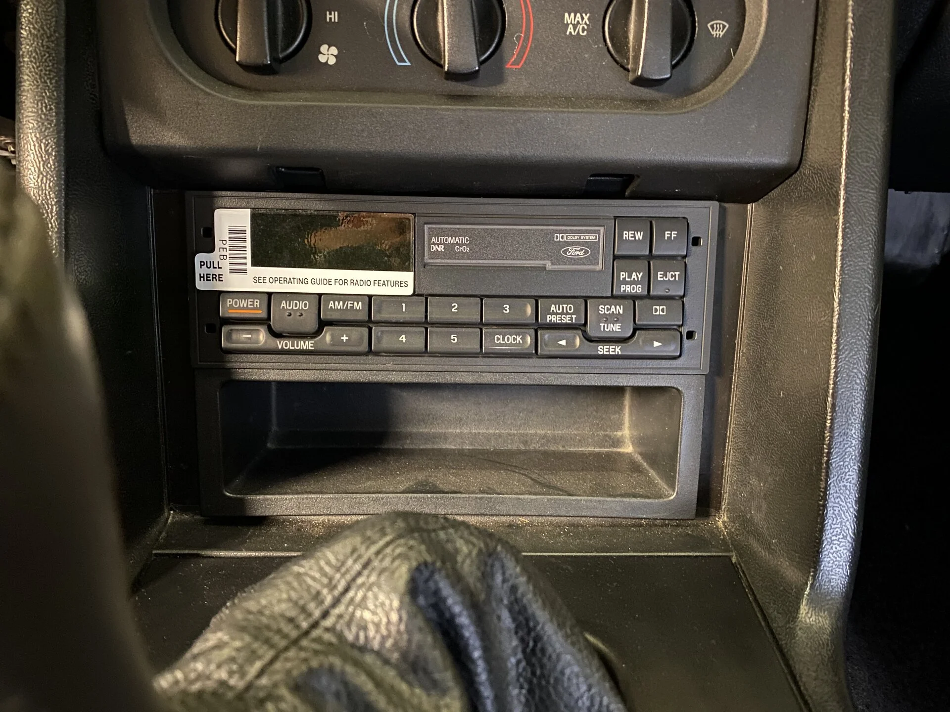

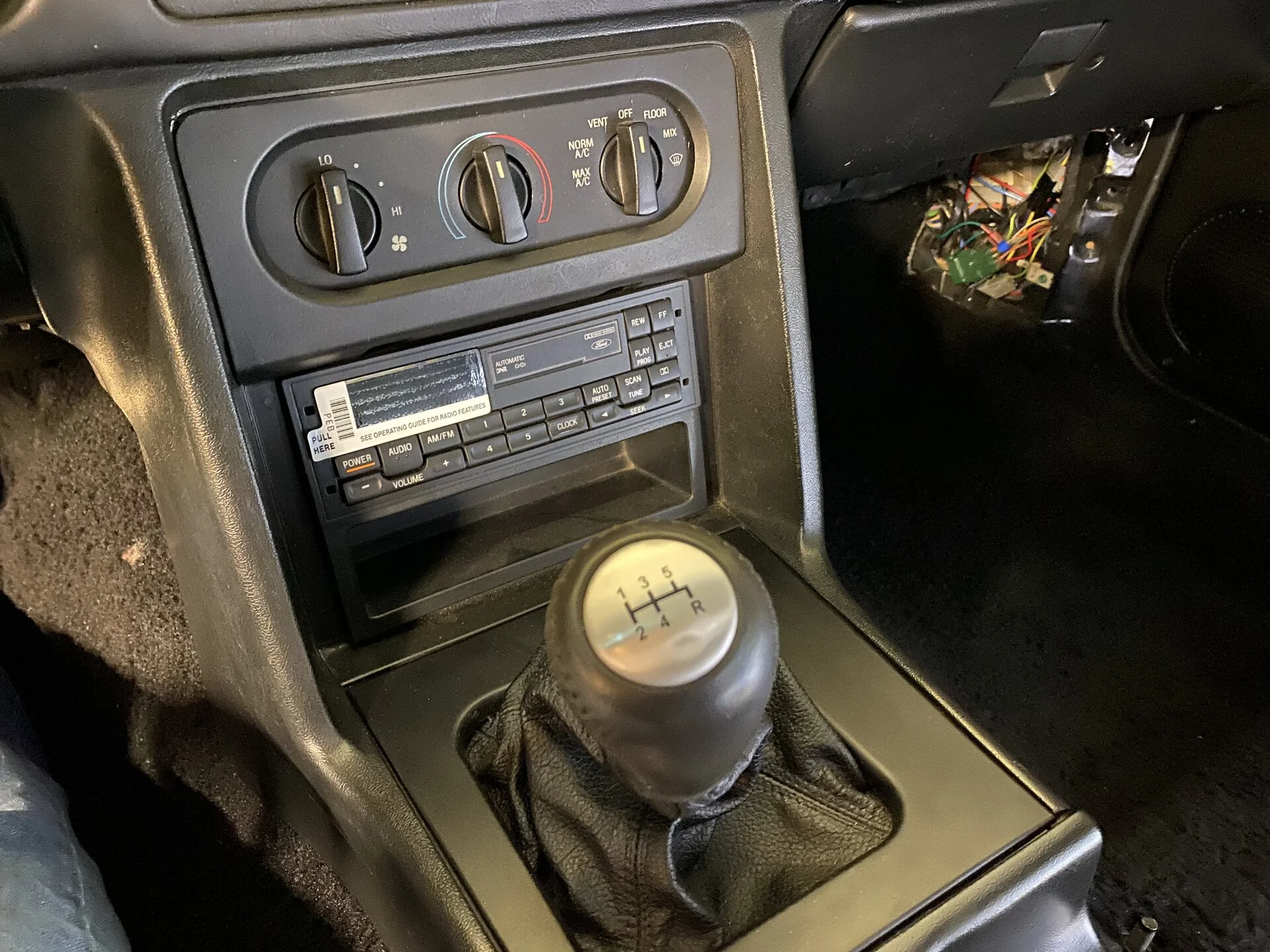

Carpet and console back in. Console was a bit tighter than I’d like due to the added foam, but it goes in.
Still a few more pieces to add back in.

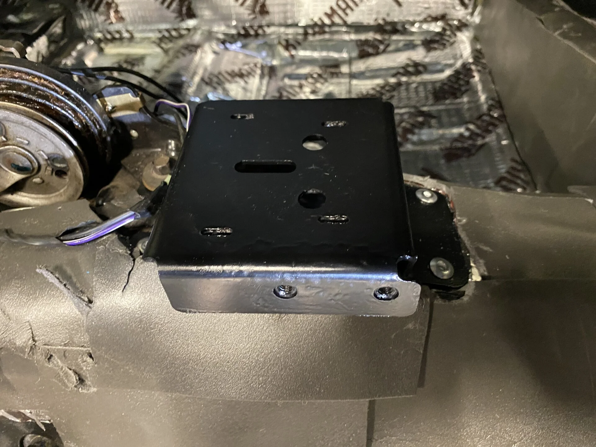

I managed to extract that broken bolt that I snapped off in the rear console bracket 20 years ago. Chased the threads, new paint and riveted back down.

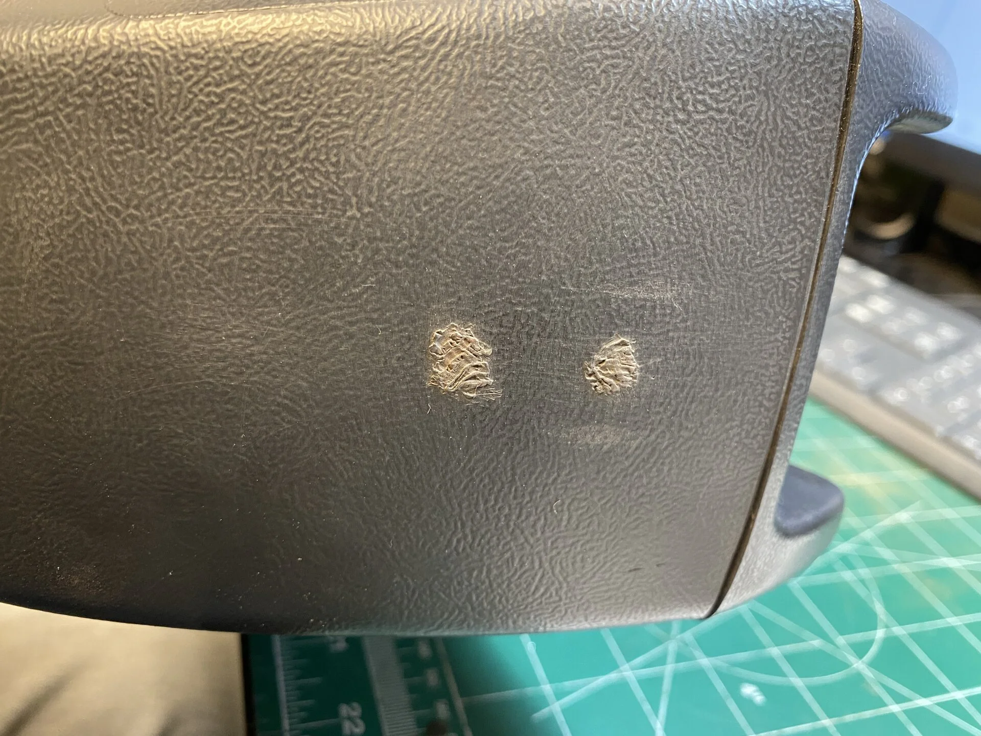

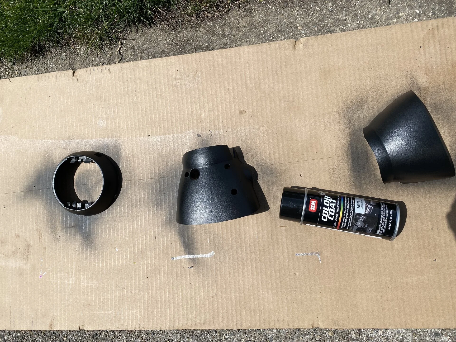

Those parts are off an 87-89 car since I’m using the 87-89 warning lights and the 87-89 tilt. One thing that always bugged me is the color of these never completely matched the 90-93 black. So I’m going to dye them.

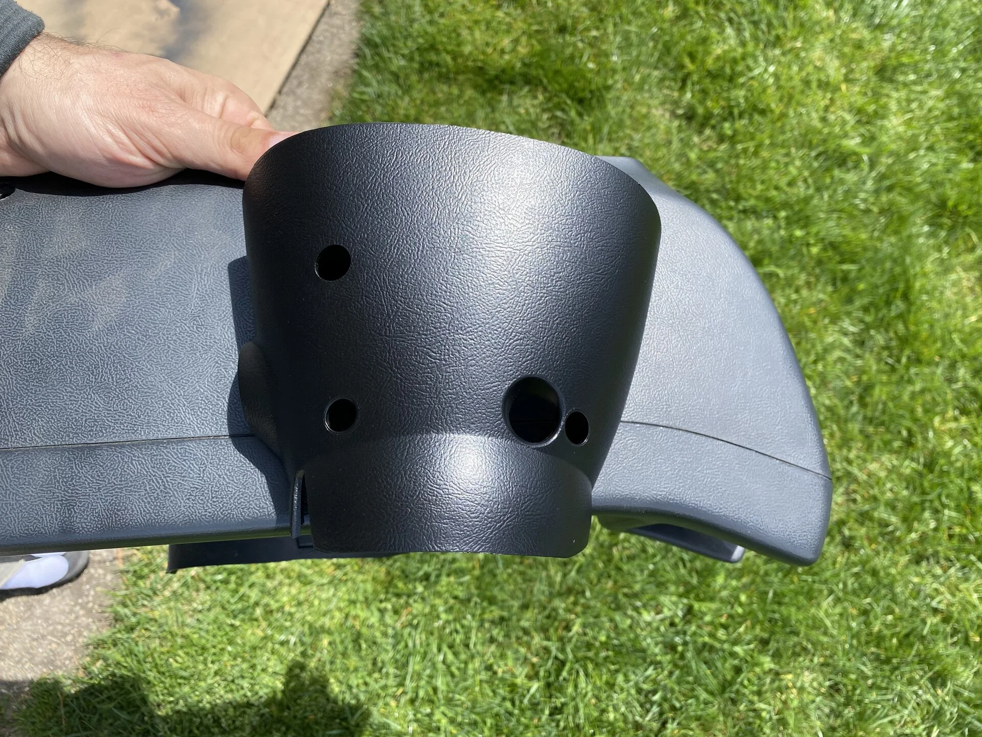

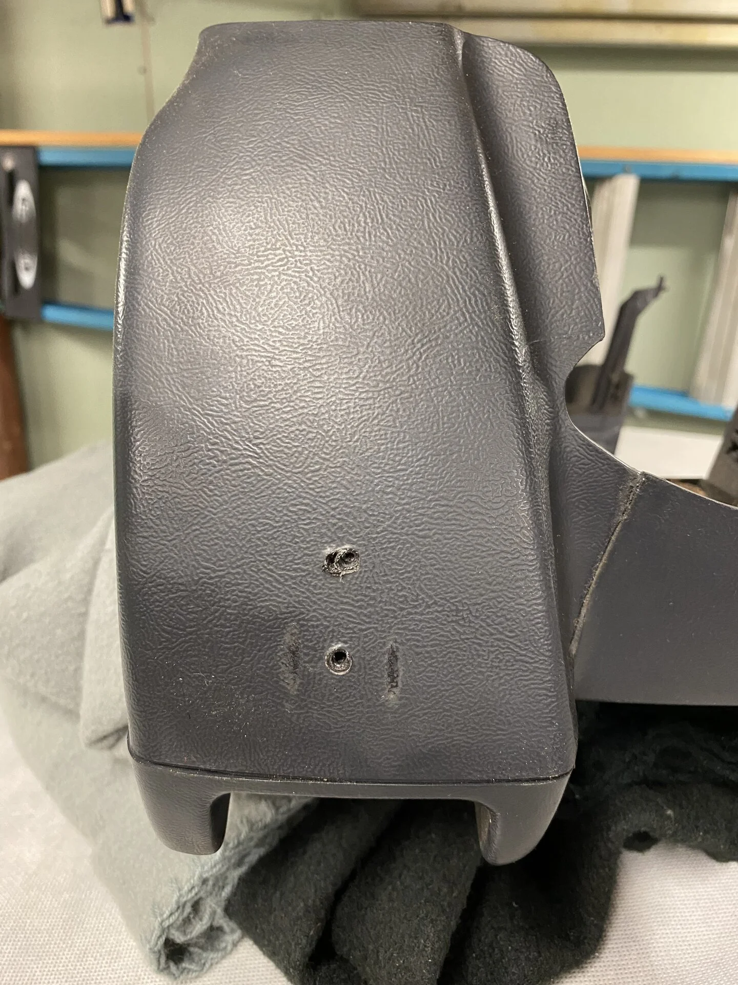

The guage cluster surround that I was using was one I got off eBay a few years back as my original had the typical 5” tach holes in the side. After comparing both of the surrounds, my original is in better condition.
So I need to fix this, and then paint it.

You might have noticed I have the guage cluster surround and console trim off.

What’s your plan to get the texture in the repair areas?

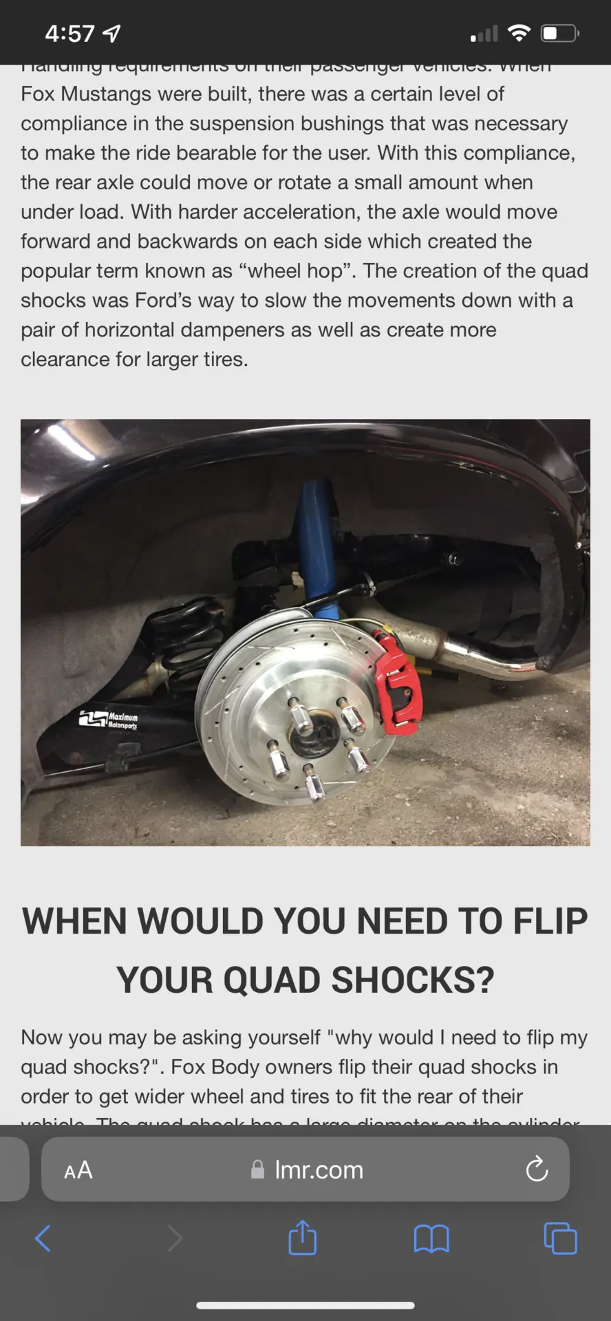

Tried it. Had wheel hop. Back they went.
My suspension setup has changed since that pic anyway. Even measured pinion angle. Stil had it. I’ll leave them it’s less work.
probably the metco upper and lower arms I got, they were top of the line way back.
they were said to be 400x as strong as stock .I can drop the clutch at 4,500 and zero hop.
Anybody experience the quads rubbing against the main shock when flipped? I too have the MM control arms and should just remove them, but its something about “they’re supposed to be there”.

I guess I should just take them off!
