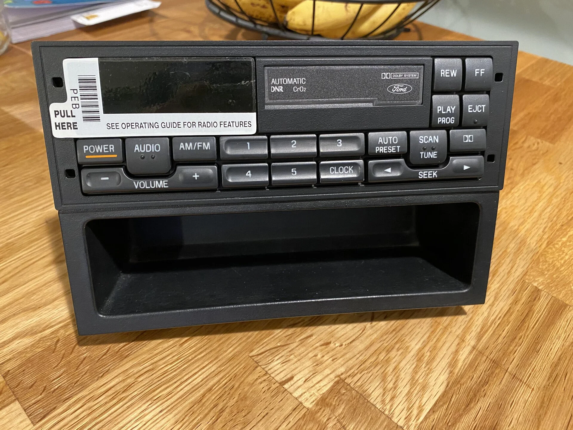

Also, I put this together for $50.
seller sold it as parts only because the faceplate was busted and a tape was stuck inside. Got it for $25. Found an NOS faceplate for $20. Got the tape out, tested it and it works.
into the pile it goes. I

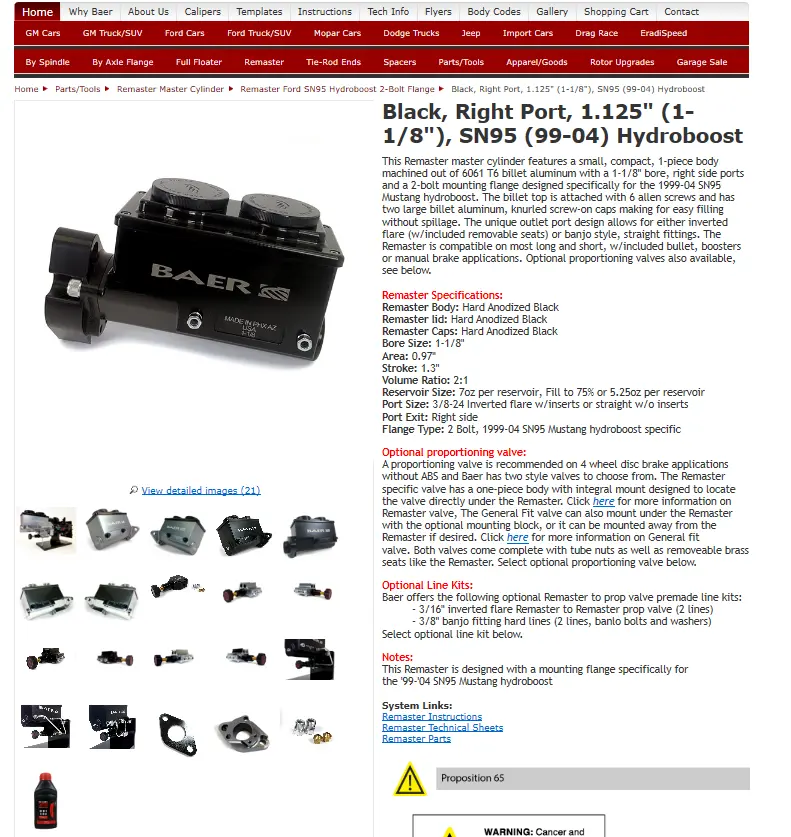

So, planning the hydroboost setup with the ATS front and Taurus 43mm calipers.
This is a hydroboost issue, so don't correlate this to vacuum setups.
The 2004 Cobra hydroboost uses a 1 1/16" bore MC. When installing the ATS and 43mm rears, you are increasing the surface area of all the pistons being used. Normally they requires an MC upside in bore diameter. Except there isn't one with hydroboost.
Except there is now.
1-1/8" Remaster Right Port Black Anodized 99-04 SN95 Hydroboost 6801328RP - Baer Brakes
That's an expensive ass master cylinder. But, it would be technically "right" for the brake setup. Why are cars such money pits?
We will try the oem hydroboost MC first
