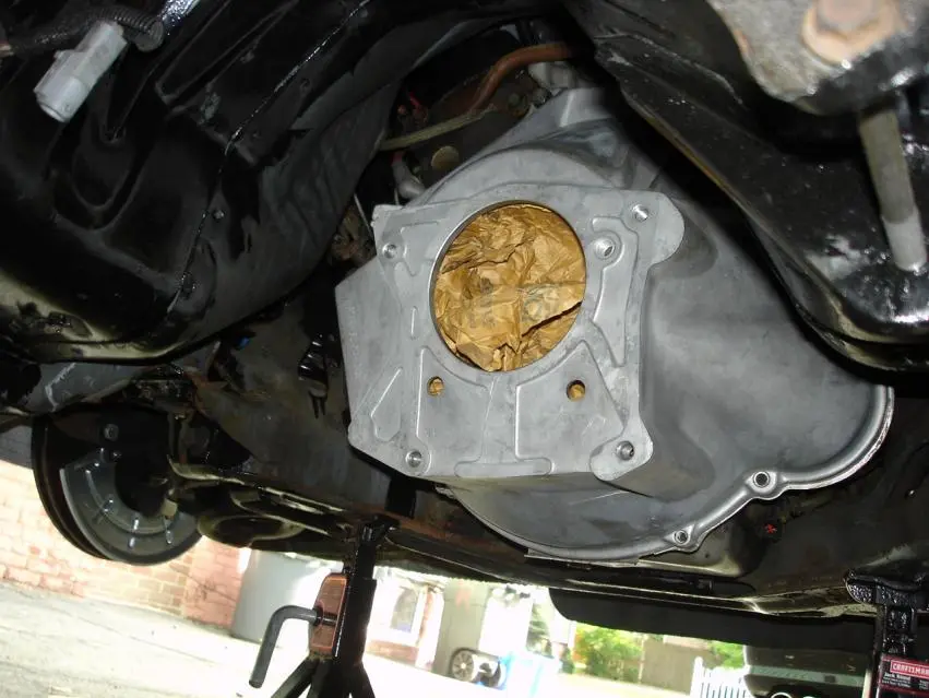

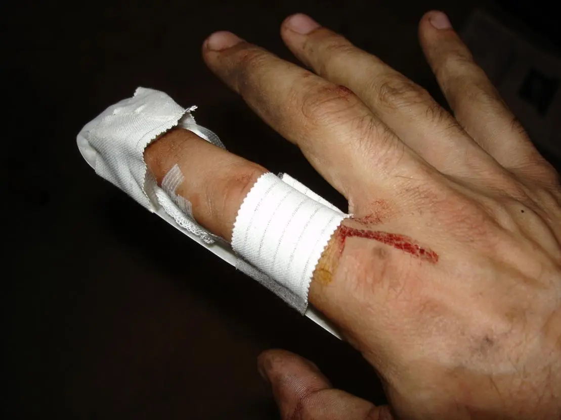

So i installed the bellhousing, was all set to put the trans in. I had two studs with the heads cut off. Plan was to put the trans on the studs and slide the trans in with the wight of it on the studs and a jack.
SOunded good, except the stud was about 1" too short. I went to bolt it in,the trans slipped from the jack and came off the studs
As light as a t-5 is...don't try to catch it
It crushed my finger into the ground. Sliced it open to the bone. Tendons are ok, but i needed stiches and a splint.
I'm pissed because i need the stiches and splint for 6-8 days, and i took all next week off from work to finish the car. :(
SO now i can't do **** til then :(
I got blood everywhere. I'm headed outside to wash it off the seats of my G35 right now.

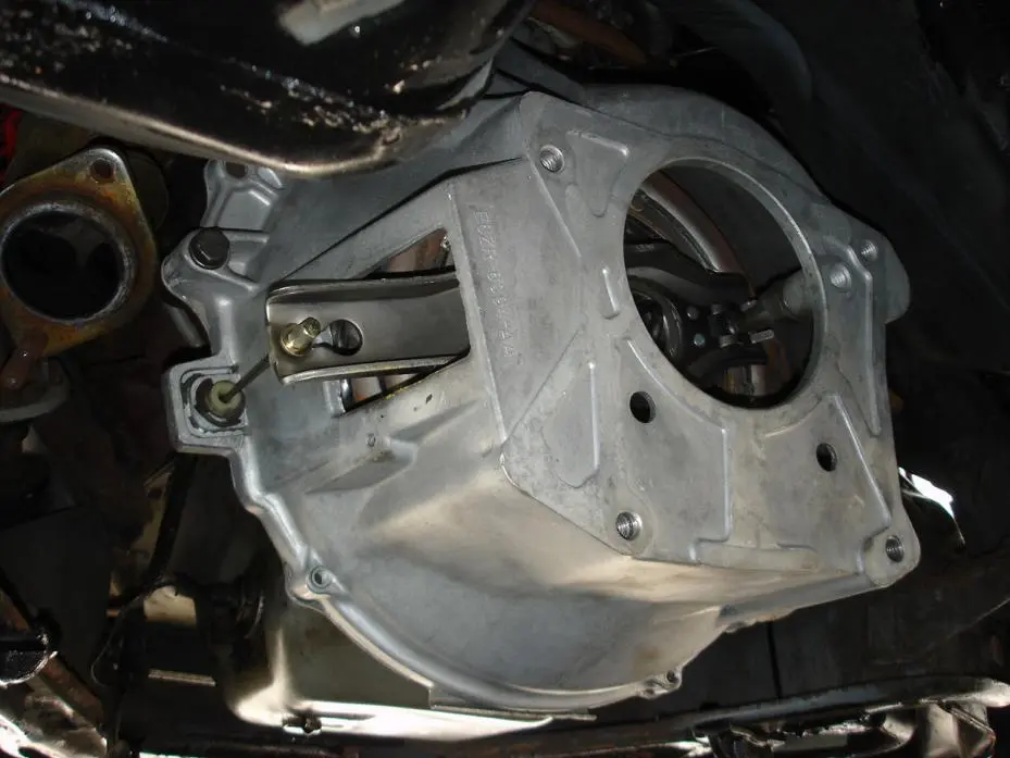

Okay, i got back to work today. Wore some heavy gloves on my bad hand but managed to do what I needed.
I found out i had the TOB installed incorrectly. Hmm, guess things happen for a reason because had i not cut my finger i would have slapped the trans in with it installed wrong.
So i fixed it and got the cable run. Clutch feels pretty good!

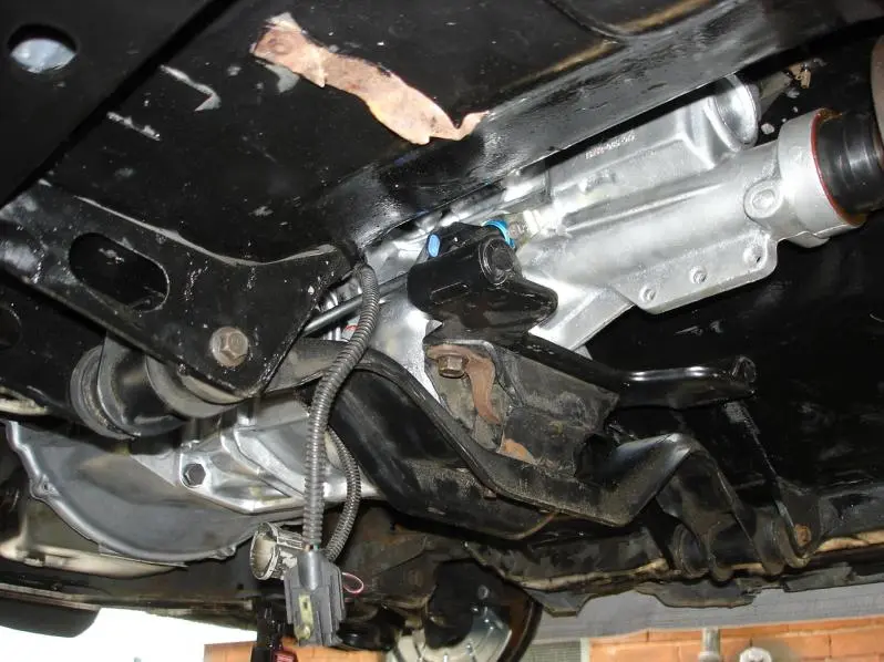

Wasn't that bad. I went and rented a trans jack. Sinc ei couldn't muscle it in on my own, i just inched it into place.
Pretty straightforward.

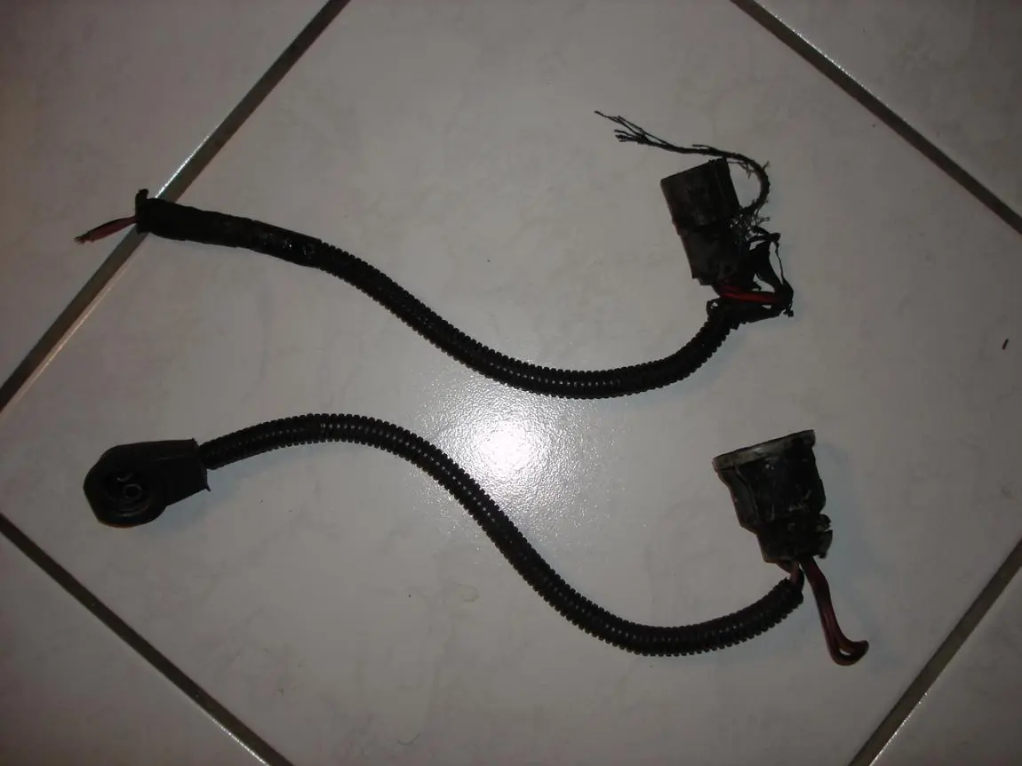

I have the wrong reverse light harness...more on that later
attachment.php

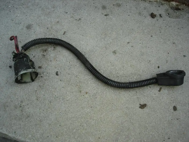

Okay, here's the one prob. Reverse harness is wrong.
I got this harness off a 1985GT. I've got the T-5 from it as well, but i borrowed the reverse light harness. The plug that plugs into the body is different.
Did they change the harness plugs later on? I assume yes?
When was the change? 1986? or 1987?
Looks like I need to find another reverse light harness. Anyone got one??
Yes, i know i could make from my AOD's harness and this one with some splicing, but I'd prefer an OEM harness. However if i need to get the car rolling, i'll just splice the head of the AOD reverse harness to this one so i can get the car running. Anyone know what color wires are the reverse wires?

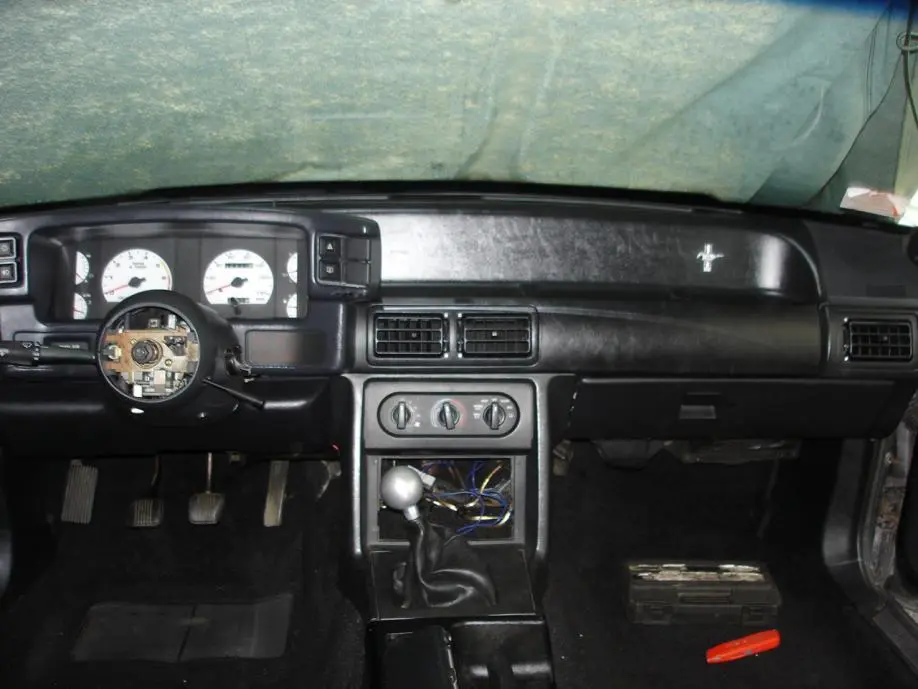

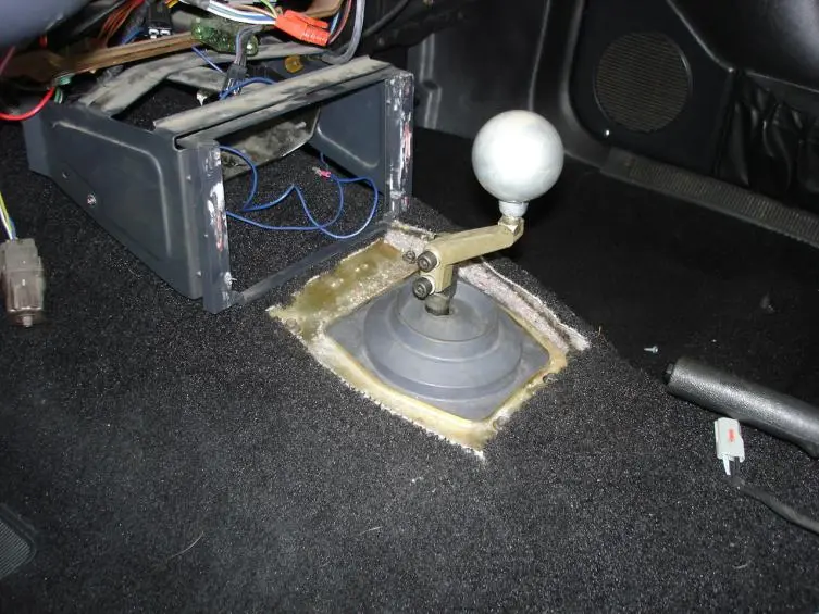

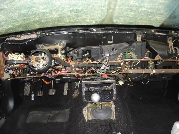

I put the interior back together. Took the time to loom some of the wiring behind the dash, clean up some custom wiring, fix splices, etc.
Before
attachment.php
After
(that's a weird reflection on the dash pad)
attachment.php

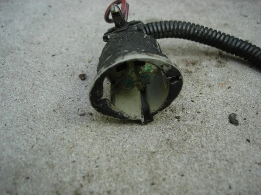

I might be good on the reverse light harness. I forgot I had this. I got it a while back at the boneyard but the head was frayed off so i chucked it at the time.
I can break out my soldering iron and heat shrink and make a good harness and reloom it.
attachment.php

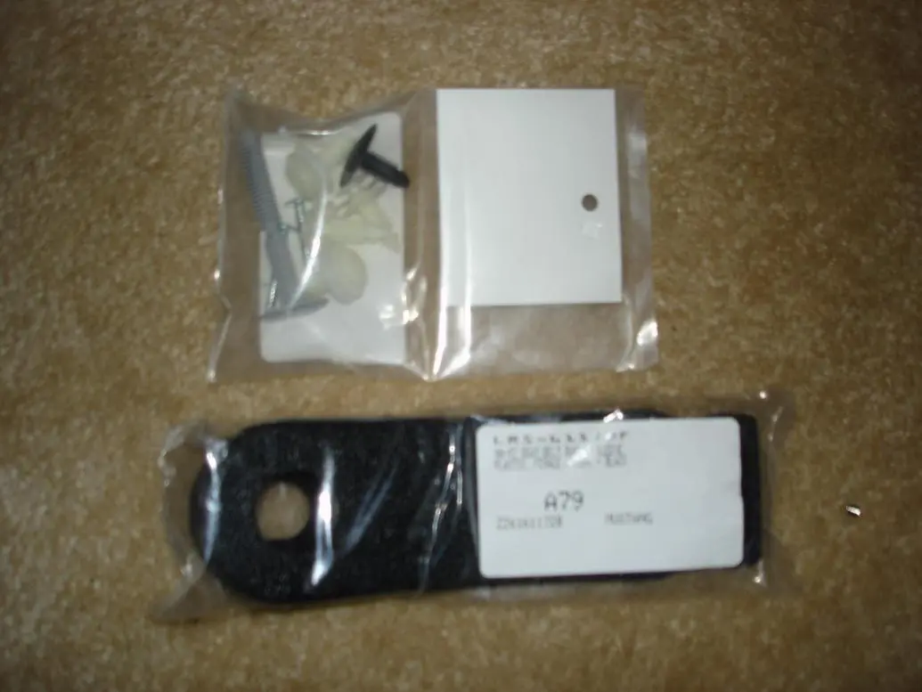

I also ordered some interior stuff.
First off the seatbelt plastic. I must have been drunk the night I ordered this stuff. Not only did i order the plastic for a 90-93 Mustang ( i needed 87-89 to recover my OEM red belts)...but i ordered ONE!
SO it's too short and i am 1 short.
I ordered the kick panel hardware kit, and one of the push pins is tan while the other is black. No big deal to dye it, but WTF.
Guess i'll have to rock red seatbelts a little while longer now

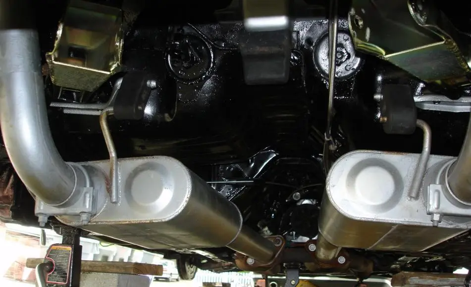

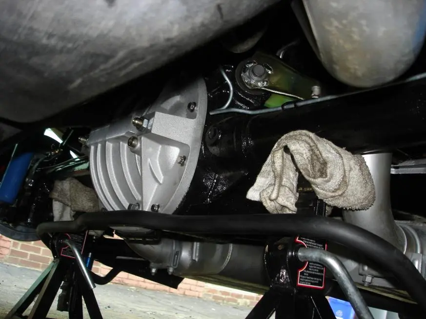

Got the rear axle in. A few odds and ends to take care of. I was gonna put the Aluminum driveshaft in but i realized i needed to adjust the e-brake still and it might be easier to do so with the shaft out.
Now i just need to tidy up my brake lines, bleed the brakes and then i think i'm all set to fire it up!
I siphoned the old gas out. Gotta pick up some fresh gas soon too.
I have a few things i'll be doing on sunday as well
So sexy! :)
It's a shame nobody will ever see my work.
attachment.php
attachment.php

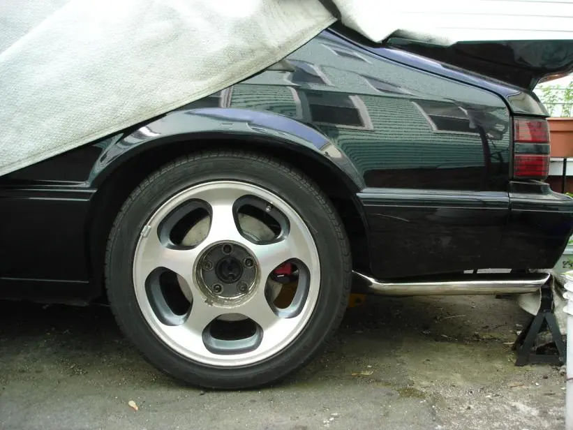

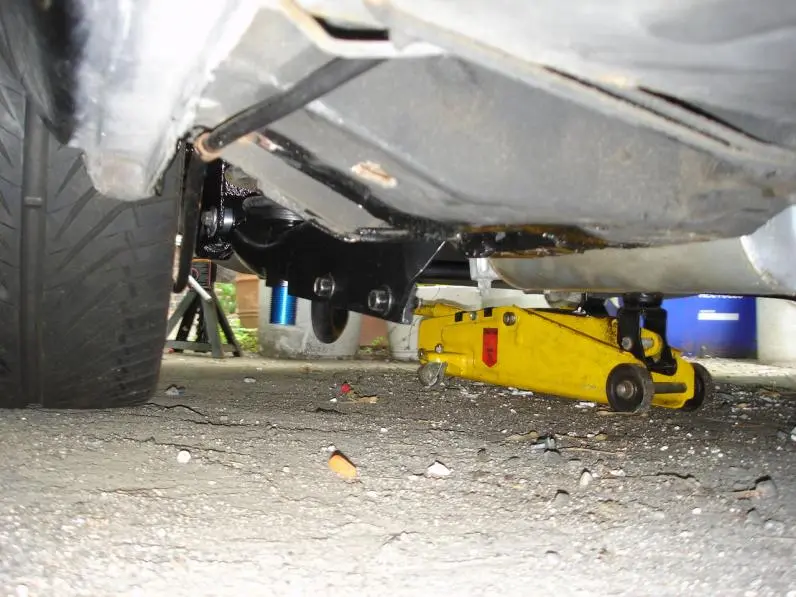

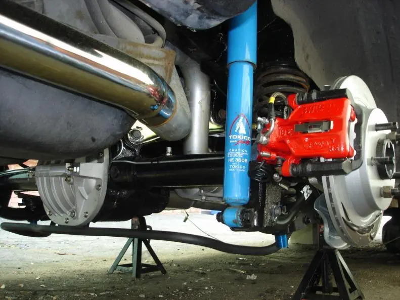

Well, i put the rear down on wheels today for the first time in 6 years. The springs have been off the car for about a year now, but i hope the car comes down a little more.
This is with the MM adjustable arms set at FULL DOWN. In other words i can't go any lower than this!
I know the ride height looks perfect here, but i was kinda hoping to achieve this in the middle of the adjustment range, and not at the very bottom of it.
But nice to know i can jack up the rear to put taller DR's on it later on. I just hope it settles down a little so i can screw in a little UP adjustment on the arms. I did put brand new POLT spring isolators in the rear, so maybe that has something to do with it. These are ford racing C springs uncut. I know i can cut a half coil off the rears, but was kinda hoping to not have to do that with the MM arms. But then again, i doubt i'd ever want to go any lower than this anyway. Looks perfect to me
PS: the front of the car was still on jackstands...so it looks high in front
attachment.php
Might have to roll the fender lips a bit. With 17x8 SN95 wheels with the SN95 brakes, the fit is perfect IMHO
Of course, i want to put 18x9's on here...so we'll see how that looks.
attachment.php

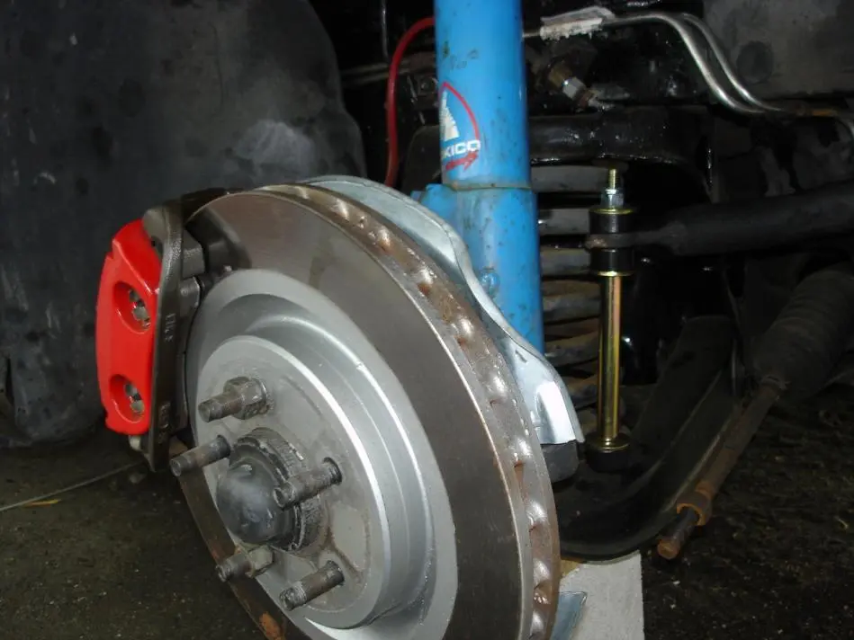

Taking car of the little things for now.

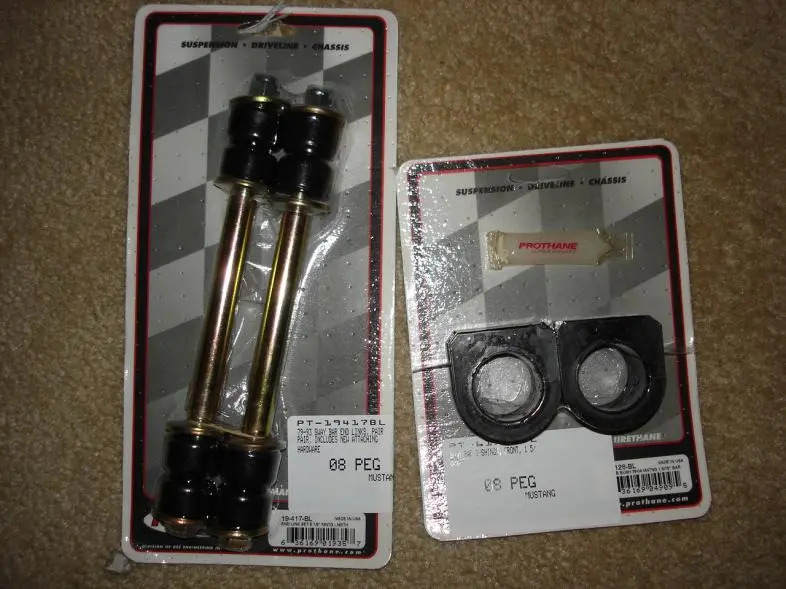

Front sway bar is back on. Sandblasted it, primed and painted it black. New poly bar bushings and poly endlinks.
Also, put the "good" front rotors on and torqued everything down up front.
attachment.php
Last post for today.
The sway bar with the MM arms hangs a little low. I prob have 3-4 inches of clearance here for the bar and the adjustment screw.
However, it's where the tire is, so if i go over a speedbump i would be fine. I just need to watch out for raised things
PS: you can see the adjustment screw is all the way down
