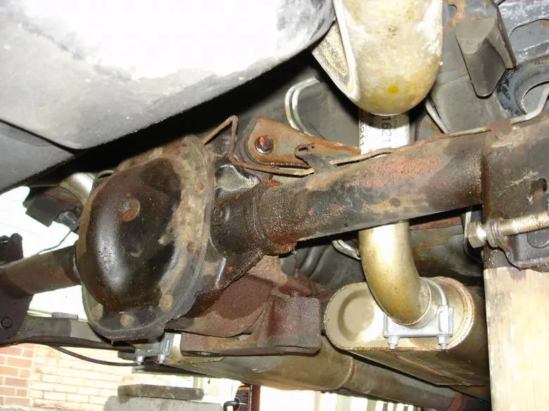

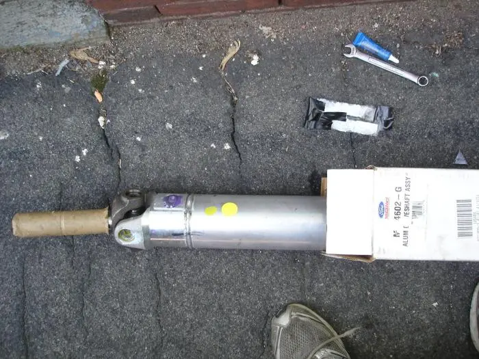

Ah, just browsing photos putting together an album.
BEFORE
attachment.php
AFTER :)
attachment.php

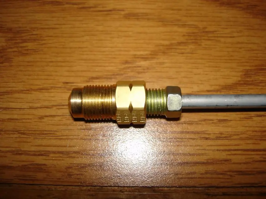

I ordered a line from Classic Tube ($25 or so) for a 93 cobra for the left front brakes, but couldn't wait. SO i took a trip to NAPA and came up with some fittings.
I found a Weatherhead 7936 which is a M12 Bubble to 3/8-24 Inverter flare adapter. I simply screw this into the SN95 prop valve plug at the rear, then custom bend up a 20" or 30" lenght of preflared 3/16 tubing and then use a Weatherhead 7818 to connect to the soft line.
So anyway to make a LONG story short, here is my "OEM" 3-2 conversion.
I gutted the stock Fox prop valve like usual. Other than that I didn't touch a thing, i just removed the factory MC and put the SN95 MC in place.
What i did for the 3rd port line is to remove the plug from the REAR of the Fox prop valve and replace it with the unique fitting from a 94+ SN95 WITHOUT ABS, a 93 Cobra or a Pre-87 Fox with a 2-port MC. This fitting allows a M12x1.0 bubble fitting.
then i used the 7936 weatherhead to change to a 3/8-24 inverter flare line which i'll custom bend. At the other end, i use a 7818 fitting to connect to the soft line.
And that's it.
Reason i did this is because classic tube quoted me 3 WEEKS for a custom order! Until then, i want to get the car not necessarily driving on the road, but moveable on it's own power. I want to bleed the brakes, so i can adjust the e-brake, and then finally put the driveshaft on and move the car. I just don't feel like waiting 3 weeks to do so. SO i'm doing this temporarily...but it could very well be permanent as well.
So anyway here's my 3-2 conversion
SN95 non-ABS rear port prop valve fitting
Weatherhead/Eaton 7936
Either 20" or 30" lenght of 3/16 tubing with 3/8-24 nuts
Weatherhead 7818
Total cost $10 (assuming you can find the SN95 fitting in a boneyard)
Yes, i put more work into this than most do...but i wanted something OEM appearing. I haven't installed it yet....so I reserve the right to come back and say "whoops....it didn't work!" :)
The 7936 fitting with the preflared line installed. This would screw into the SN95 fitting at the rear of the prop valve

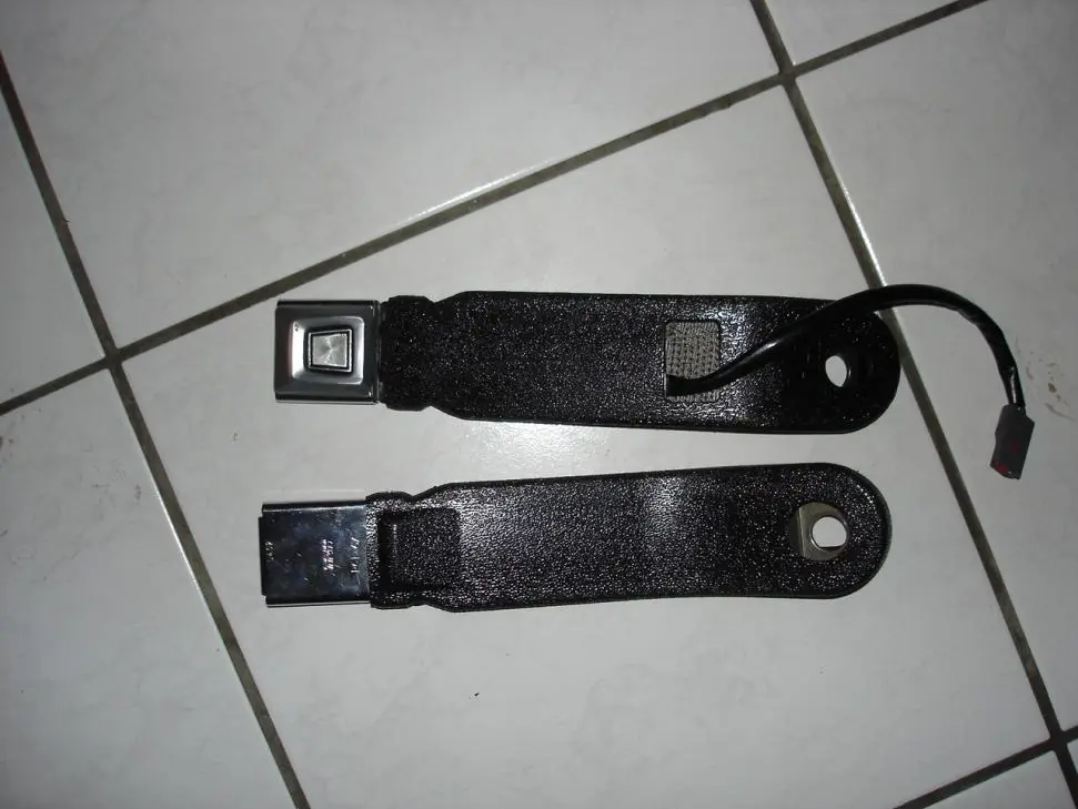

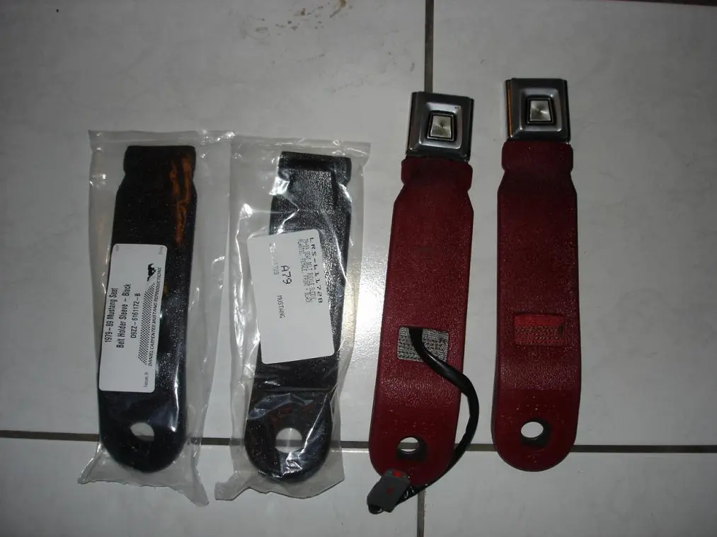

Got my seat belt plastics in....the CORRECT ones this time. Now i can install them and put my seats back in and the interior is done.
I know a lot of guys sometimes have gripes about late models repro interior parts, but these buckles are pretty solid.
You can dyd your original belts black before putting them in the sleeve, but i left mine as is. You can't even see the fabric really except in that small square. If you notice, the belt with the wiring harness had a grey fabric belt inside. It's factory original as far as i know. Was interesting
Back to the car in the AM. I hope i can get a lot of stuff done this weekend.

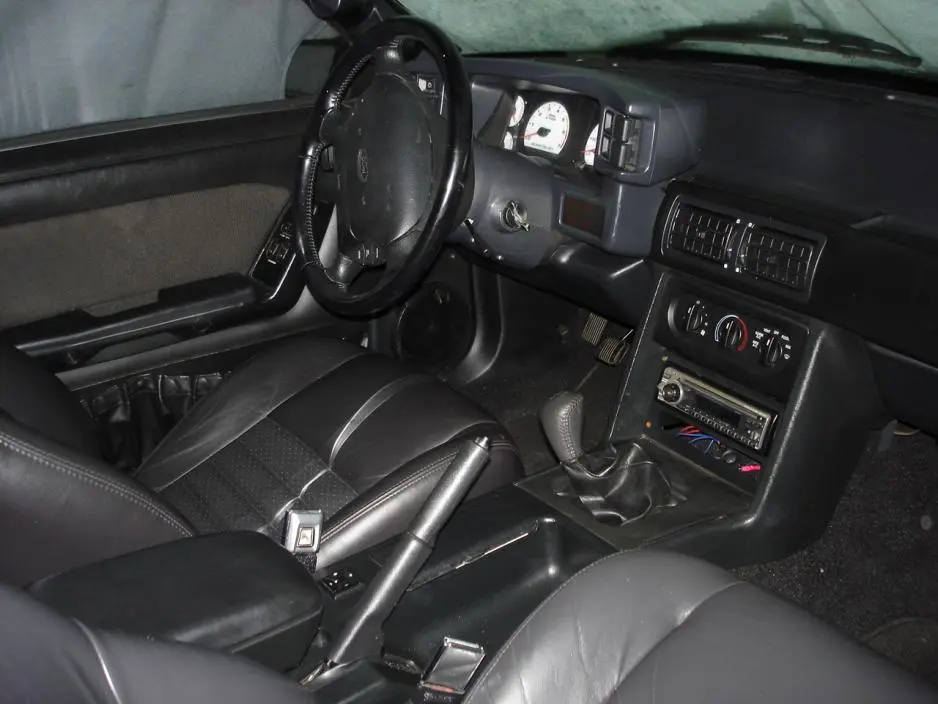

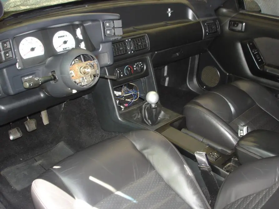

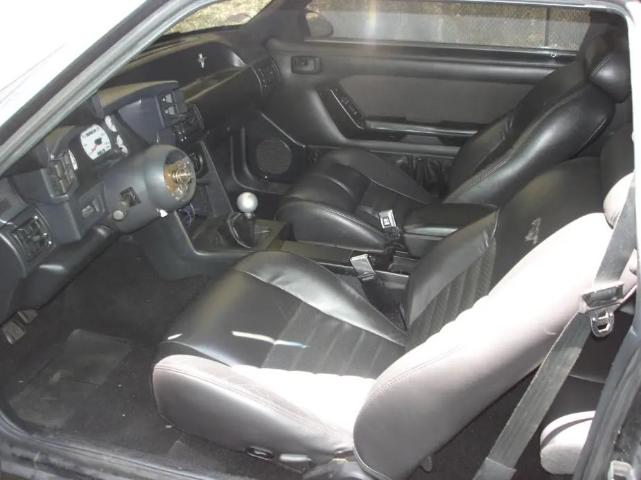

Okay, did some more work today
Interior is back together. All that's left to do is install the old stereo that I had in the car. I'm saving installing the Cobra 5-spd shift knob i have for last.

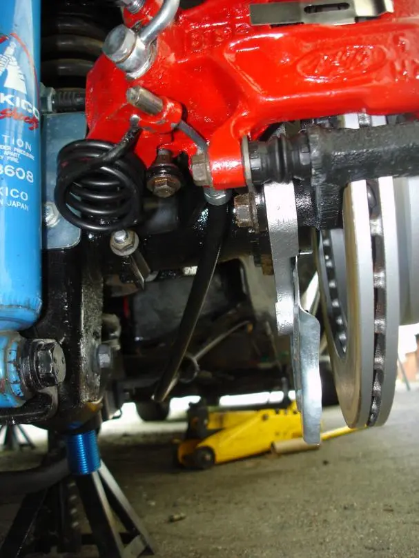

I tackled the brakes today. All the hard lines were run, i bench bled the MC and bleed the brakes and everything was nice and tight! :nice:
So, I went under the car and adjusted the parking brake, and then I installed this bad boy.

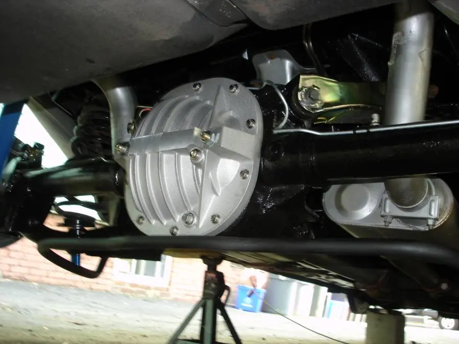

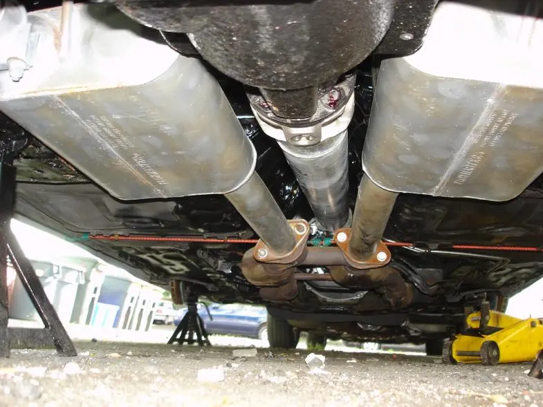

So...in terms of undercar, what needs to be done?
Tie rod ends up front.

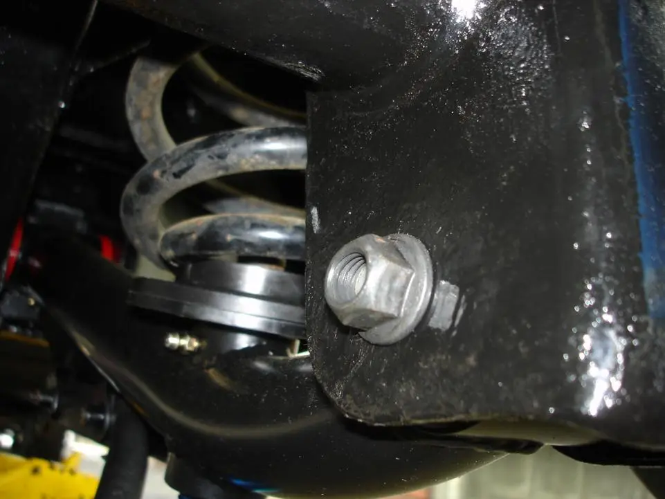

And this bolt. First off, don't buy the Ford Lower control arm bolt kit from Jegs. It claims it's a complete kit for $25, but all the bolts are the lenght of the upper control arm bolts. The lowers are too short.
So i reused the front one but had to cut the rear one off the axle when i removed it...so I had to order some.
In the meantime...this isn't safe to drive on. :)
attachment.php
I should have the bolts Monday, gotta pick up some tie rod ends during the week and then the underside of the car is DONE!!

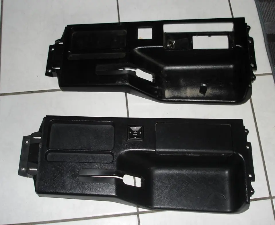

FOund a new center console on ebay. Now i can finally get rid of the painted console I had. It was originall tan and dyed black. As you can see, it started to wear and didn't match any of the OEM black stuff.
It has a WORKING ASHTRAY TOO!!
Just gotta pop this in and no more painted crap! :nice:

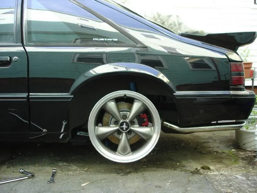

Small teaser shot. I haven't installed the smoked headlights yet. So that's still on the list of stuff to do.
I loved the Cobra rims when i put them on, but I need a new look. I'm currently looking for a set of Bullitt wheels. That's what I want to run on this car.
(btw, the hood is open)
attachment.php

Changed out the center console today, now it matches. Amazing how the pics show every smuge of dirt in there. In person, it's tough to see it. Guess i'll have to print out the photo and get in there and clean
I changed the shift knob to the one from my 2003GT. If you notice, i need a new shift boot and shifter bezel. My junkyard bezel and boot show their origins.
I dunno if i'll run the SN95 wheel. Feels too bulky. I kinda like the small, original '88 wheel and might put it back. And yes...i still need to clean the smudge marks from the wheel

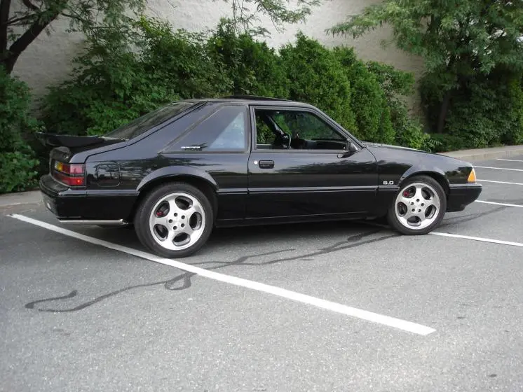

Anyway, first pic out in the wild world.
I have the rear adjusted high because I haven't rolled my fenders yet. When i do, i'll drop it down to a nicer ride height in the rear
