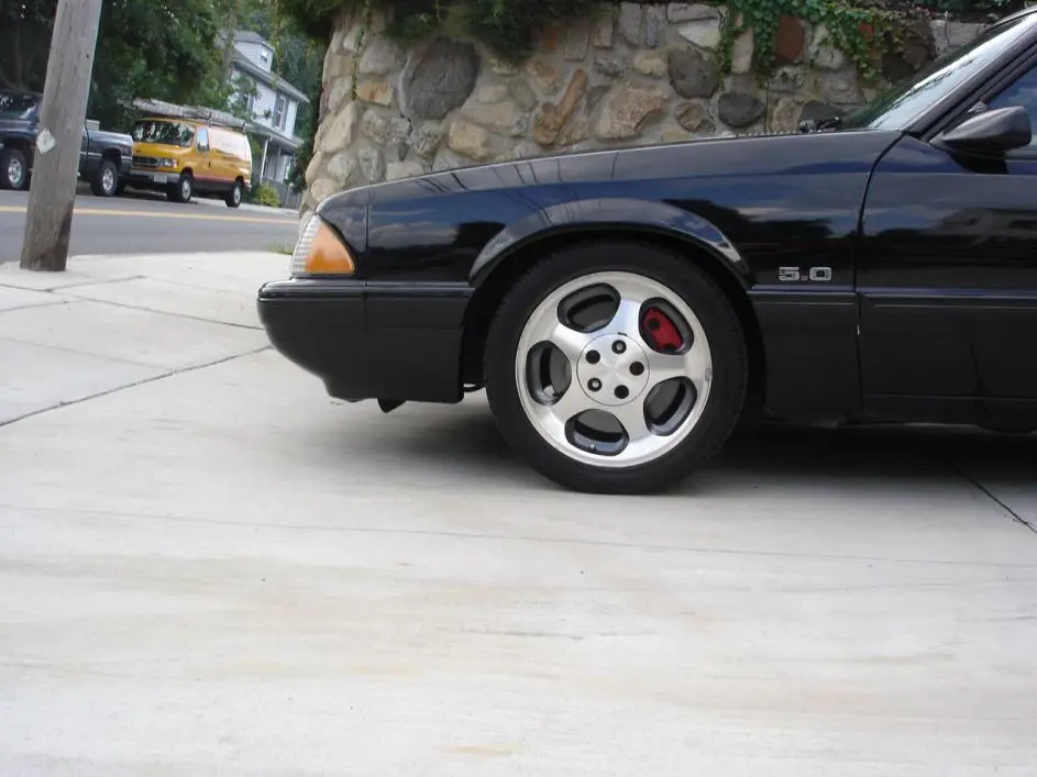

Looks nice, but a tad on the low side

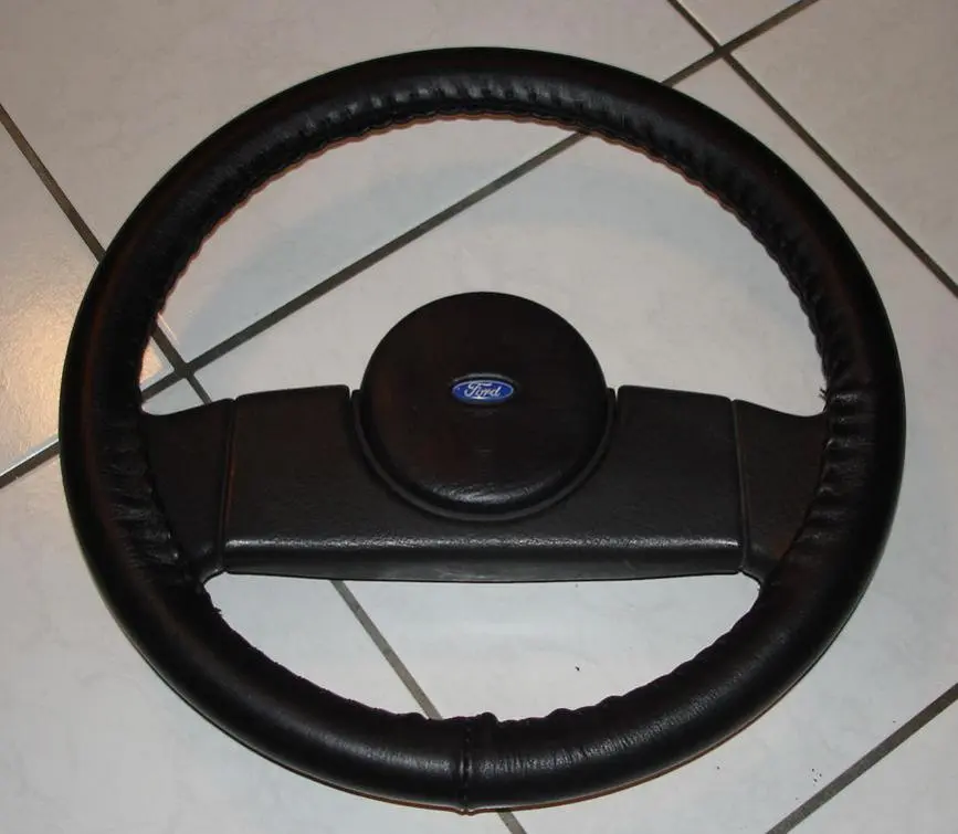

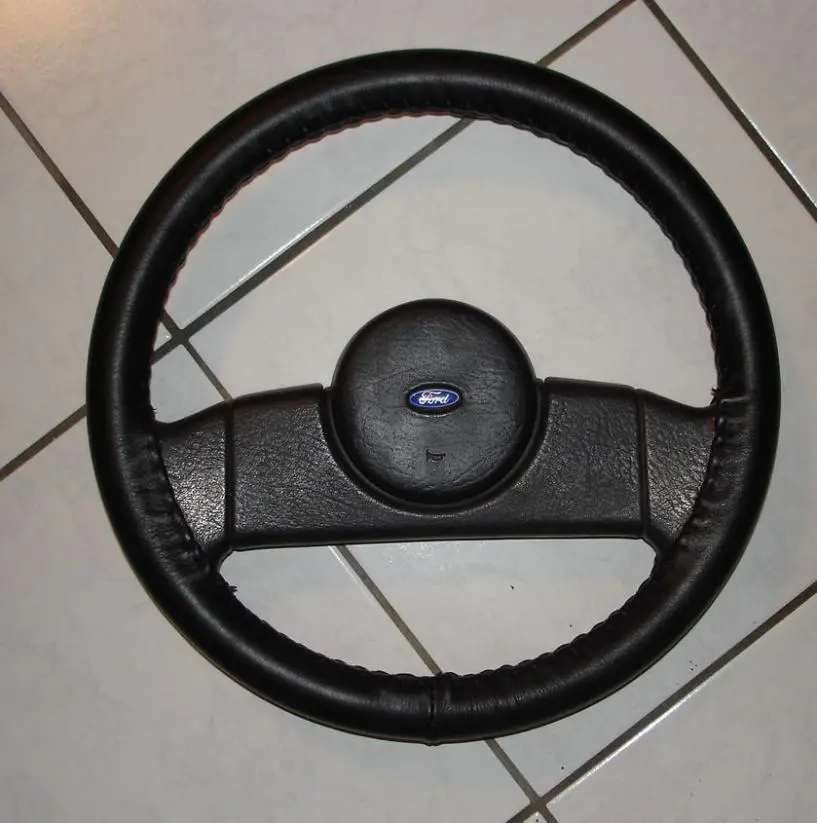

I ditched the SN95 wheel setup i had. On a non-airbag car, the wheel was way too close to the driver. So i chose to put the stocker back in.
But, i wrapped it in leather first. Feels nice. Took me almost 2 hours to do though. :(
Looky...a rare non-cruise 87-89 wheel ;)

I took the car for a spin this AM with the wheel and it felt comfortable. I def like it now.

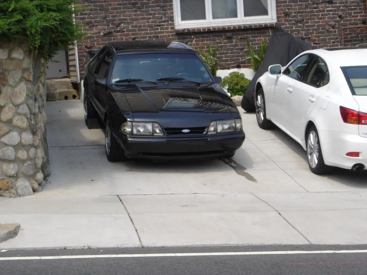

Got my new headlights on. What do you think??
attachment.php

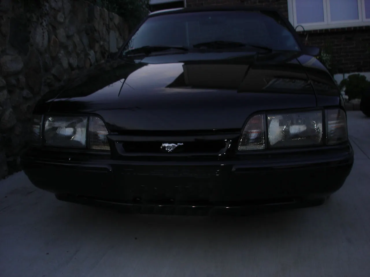

Also, should I? Or should I not put the Cobra Grill insert on? It's all painted and ready to go.
Sorry for the bad pics...was losing the light.

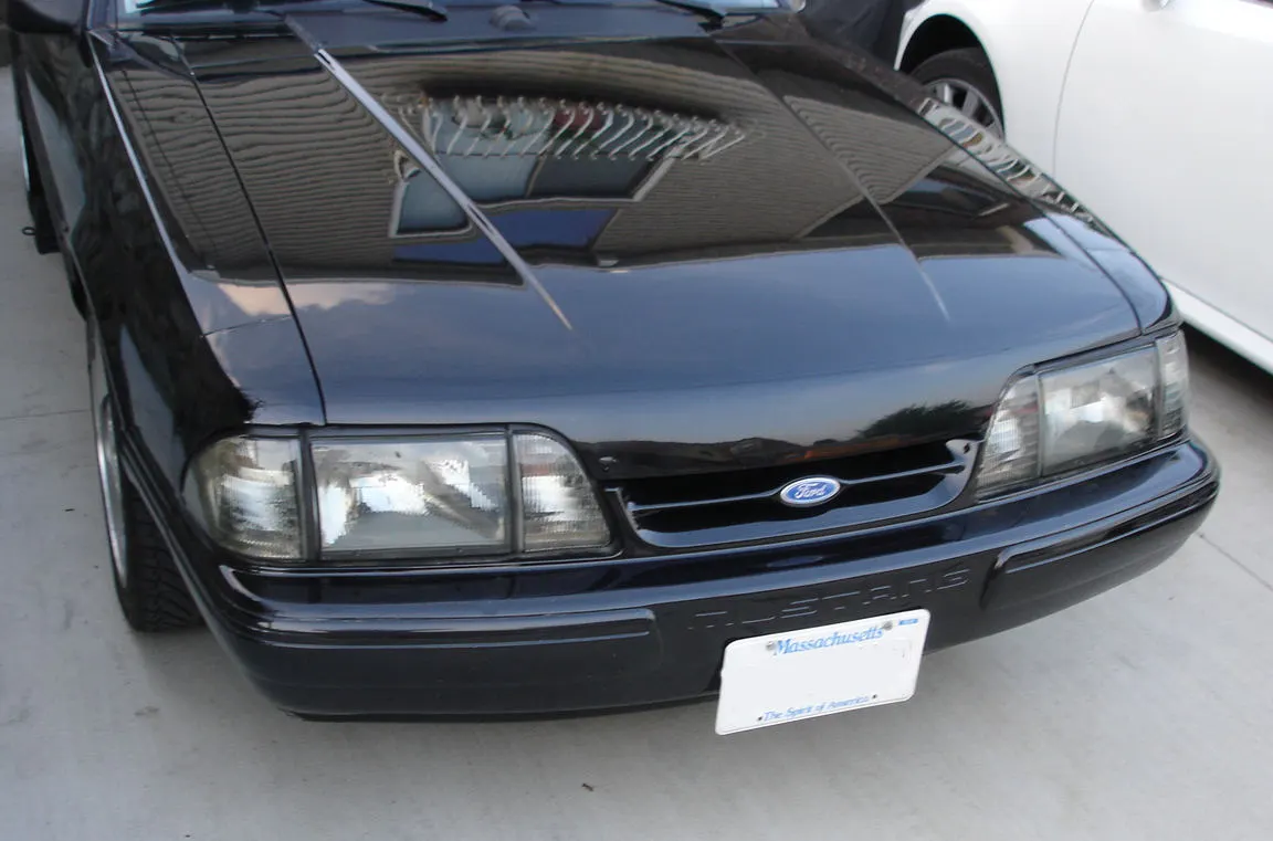

One more pic with the new lights. I really can't decide if i want to do the cobra grill or not. i would think it would look nice, but part of me wants to keep the body stock. I like the look of a clean stock car, but wonder if a Cobra grill would not take away from it. Next time i paint the car, the Saleen wing is coming off and a stock LX wing is going back on.

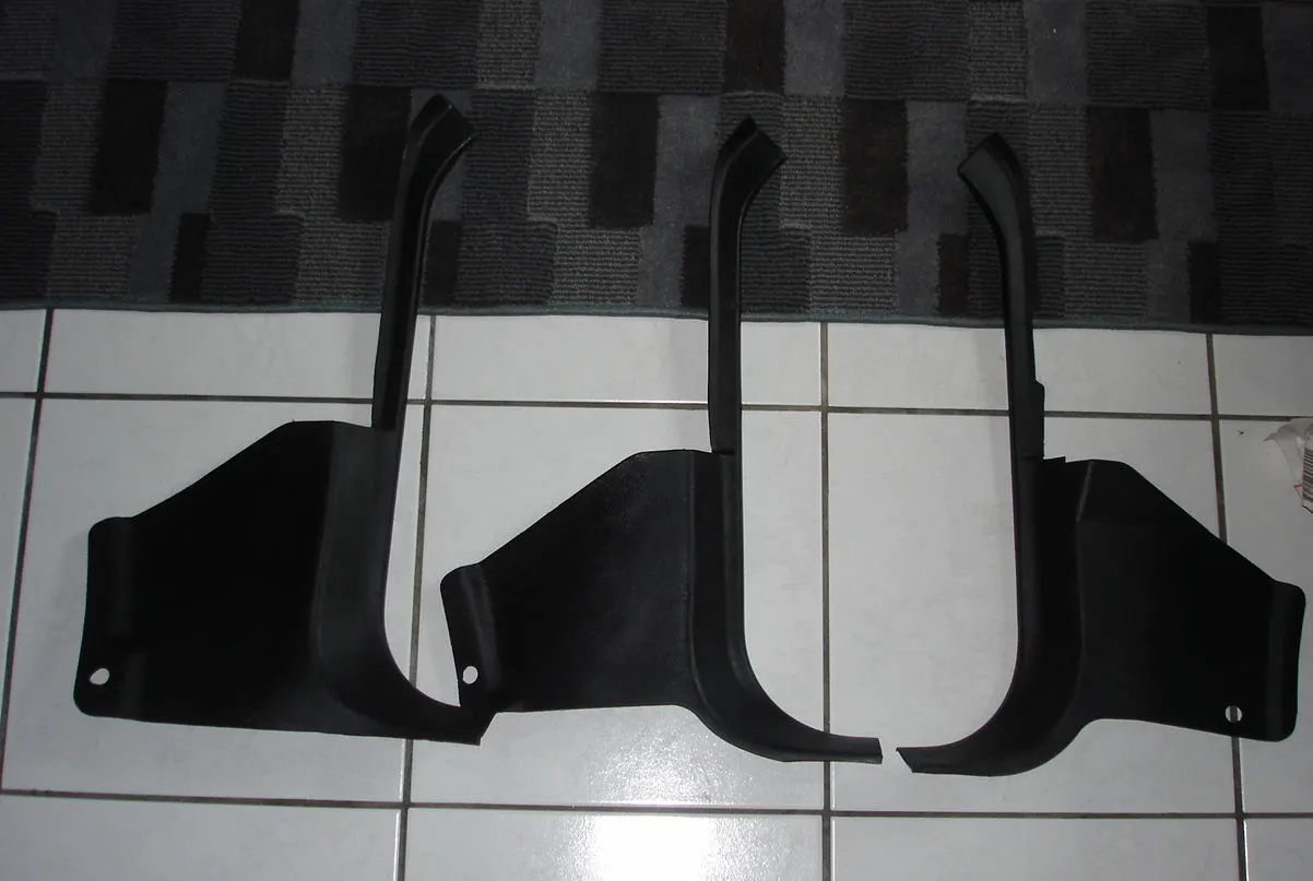

Changed some of the interior plastics around. Changed out my sill plates for some black ones in MUCH better condition. Also, scored the Late Model resto kit with new push pins for the kick panels.
I was going to swap kick panels until i made this interesting observation.
Left is a kick panel from a 1990. Right two are from a later year. When and why did ford make a change to the kick panel design after 1990? Very weird, but as a result i could not use the newer panels because the carpet did not go up that high.
So these may go on Ebay now.

The kick pannel thing was because of having more wires for the air bag. Caused the older pannel to buldge out by the computer. The drivers side got changed to match the new angle thats on the passenger side.
So whats the problem? Shouldnt see up where they stop anyway. :shrug:
Prob was the carpet wasn't that tall on the edges, so you would see the wires and stuff behind the kick panel.
My black interior is mostly from a 1990, so it's 1990 OEM carpet and the kick panels were from a 1990 as well.
I snagged a new dash and those kick panels from a 1993 vert in much better shape. I swapped the dash and when came time to swap the kick panels, i noticed they were different. Both sides were higher than the 1990 panels, so it showed the edge of the carpet. I had no choice but to keep the 1990 panels unless later carpet came up higher? :shrug:
