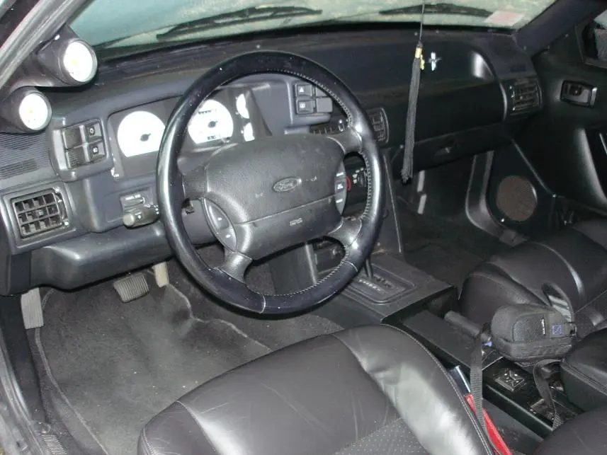

Got a little bit more done today. I finished the steering wheel install.
Write-up is here
http://forums.stangnet.com/763027-sn95-steering-wheel-into-87-89-fox.html#post7692191

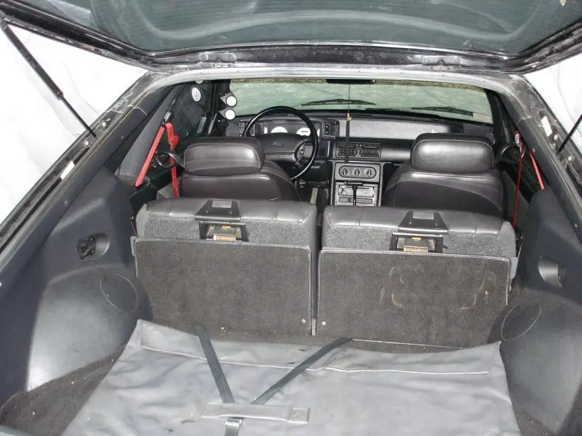

That wraps up the interior for now. I know i need to change my red seatbelts, but i need to pull the interior quarter panels out and i said the next time i rip my interior apart, i'm taking it all out to do sound deadener. I don't want to do that at this time, so the red belts stay. I do have the black belts though.

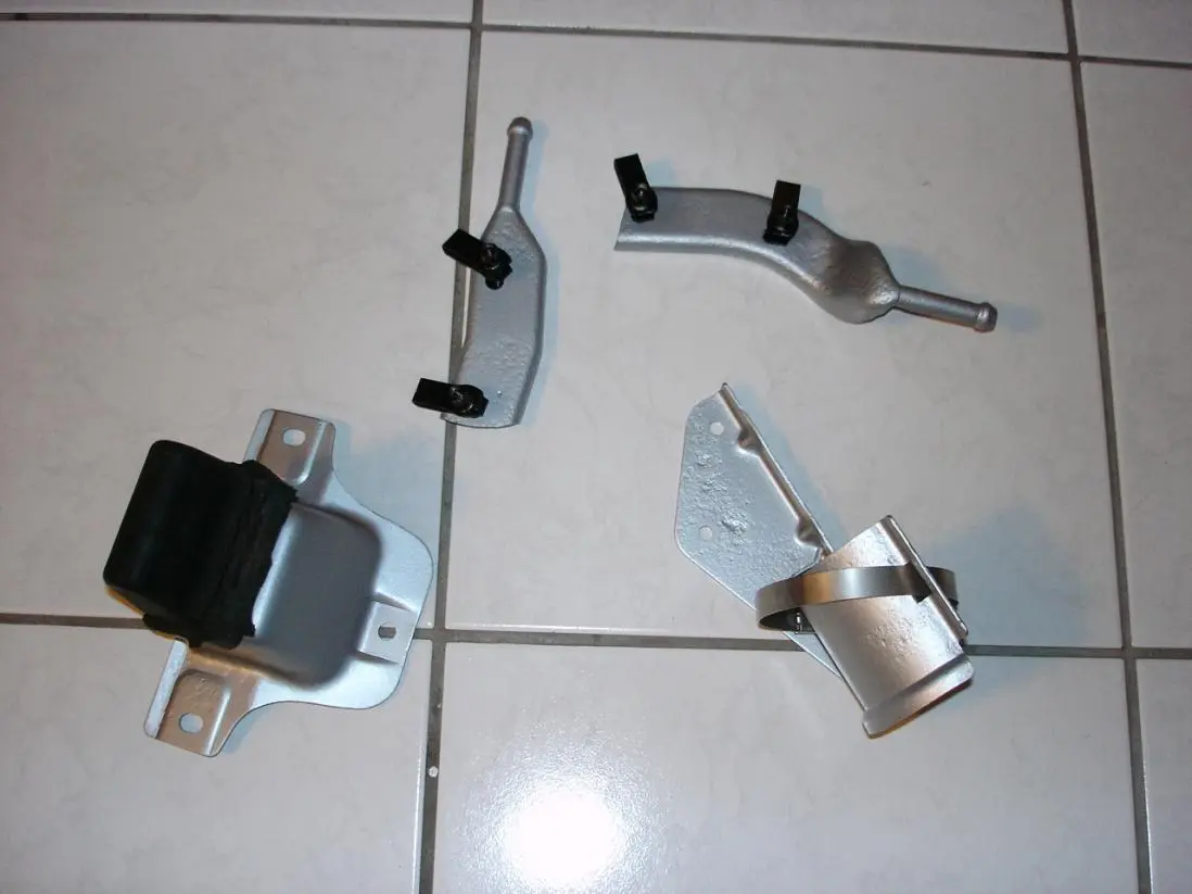

Under the car, i removed and sandblasted all remaining clips and brackets. I also sanded down the existing fuel and brake lines and spray painted them grey with rust-proof paint. I'm not building a concourse-quality car so i didn't want to start replacing every single line and bracket on the car.

Some interior finish pics....again

man that steering wheel looks soooooo much better than the stock pos. are the 99+ wheels the same as the earlier sn95's? i think the dark charcoal would go better with my interior if i decide to do this too, espically with my 35th anv. seats.

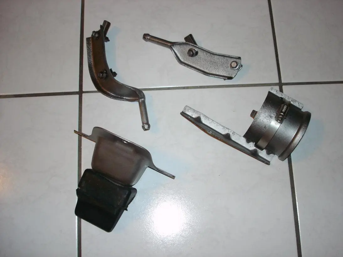

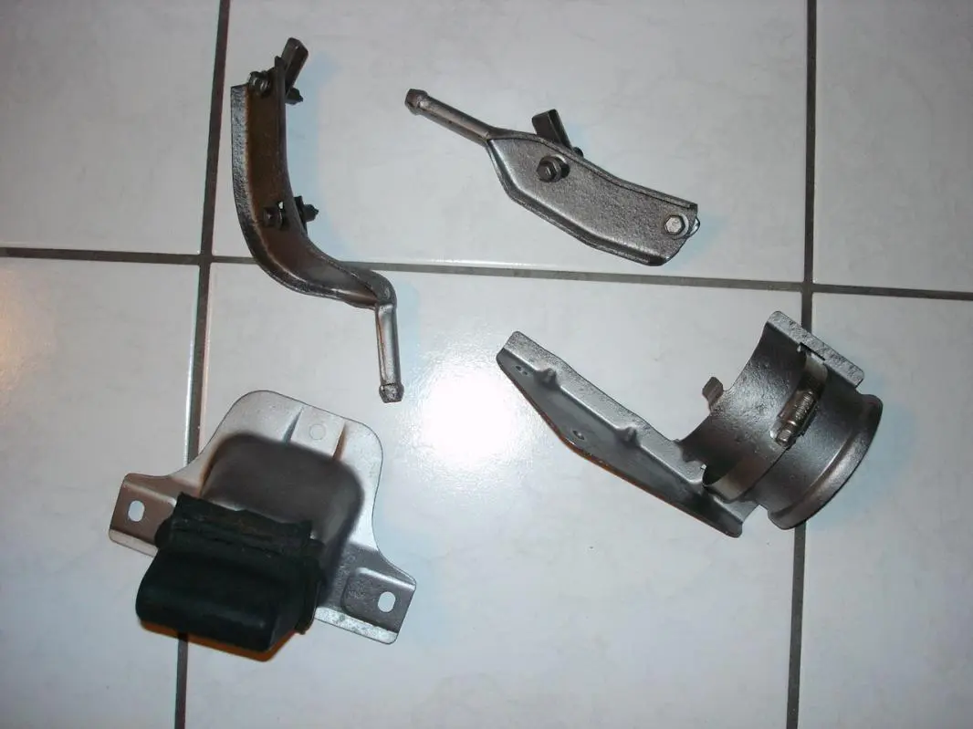

Some stuff sandblasted and waiting for paint.
Sway bar is being painted and will be powdercoated red. It's about the only suspension component i will be reusing. The UCA's and LCA's went into the trash.

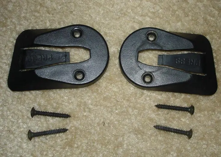

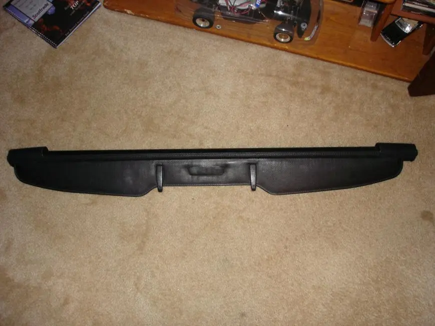

90-93 Black pullshade. Been looking for one for a while. Picked it up today.
I need one mounting clip that screws to the interior panel though. If anyone has one, PM me. WOuld prefer black but if you have another color i might go for it just to get it in.

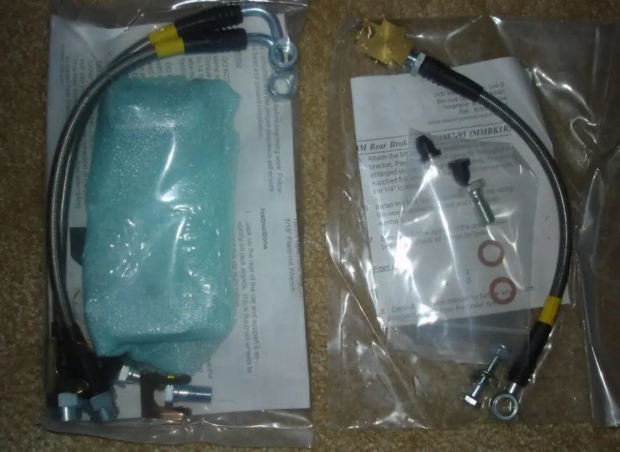

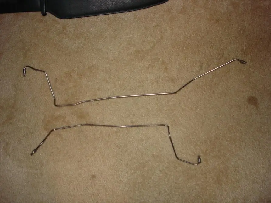

Also, got some SS brake lines for the rear axle. They are for a '93 Cobra, but i hope they work with 94+ Cobra disk brakes.

I think I might have one of the clips, but I'm not sure which one it is. I looked through some of my parts when I noticed you were missing one in your pic earlier in the week. If i find it, I'll let you know.

Ok, finally found some hatch shade clips. These things are tough to find because they usually go with the panels and don't get separated. I need to buy new hatch trim to replace one cracked peice next.
I've got SS rear 3-peice lines coming from Maximum Motorsports tomorrow. SHould be nice peices.

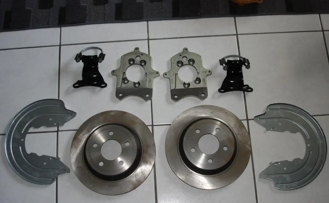

More goodies. FMS M-2300-M Cobra disk kit.
Anyone got a lead on where i can get the cobra-specific caliper U-brackets?? I have GT stuff right now with seized slide pins. I need new brackets anyway so i might as well get the right stuff.

Since the car is all apart, technically nothing is installed.
This is what's going into the rear:
Cobra disk-brake equipped 8.8 with 3.73's
