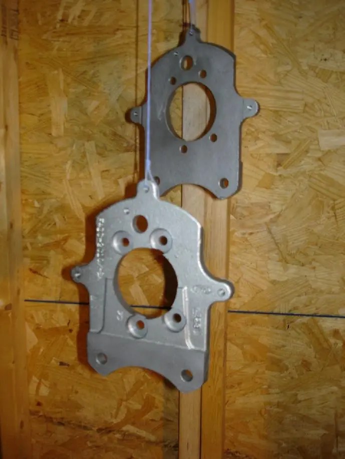

Cobra Axle Brackets primed and painted!!
I have my friend sandblasting all the hardware. I will paint them up black and then start my assembly after the POR15 dries.

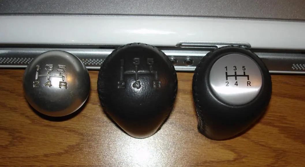

Also, 3 shift knobs to choose from :) Can you tell i'm getting eager!!

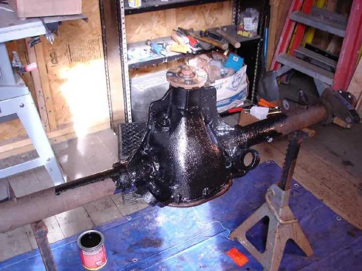

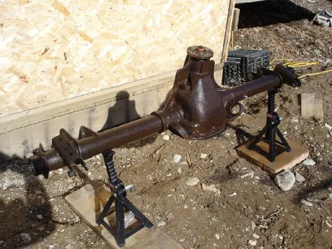

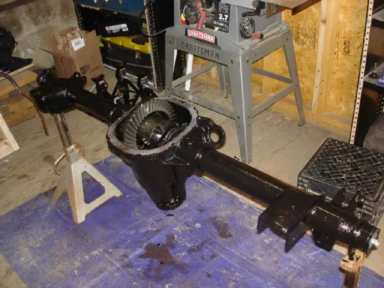

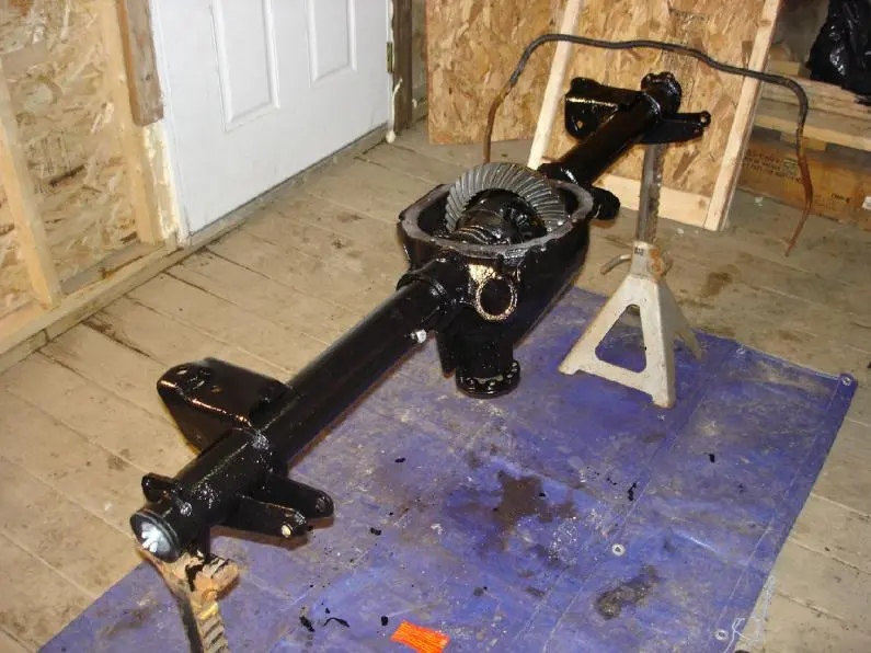

Got to painting the rear today. Took about 2 hours start to finish including using the prep product.
I highly recommend you use the Marine Clean and Metal Ready products POR sells along with their paint.
I had degreased the axle prior to this, but the marine clean took it down even further. I was amazed at how clean i got it with this stuff.
Then i wet it down with metal ready and let it etch the metal and then rinsed it off and let it dry in the sun. You could tell it changed the properties of the metal.
And then I painted the rear. Was pretty easy. I used a sponge brush and it made dabbing it in the crevices nice and easy.
I'll let it dry a few days and then start putting my brakes on and other parts once i get them back from my buddy who is sandblasting some parts for me.

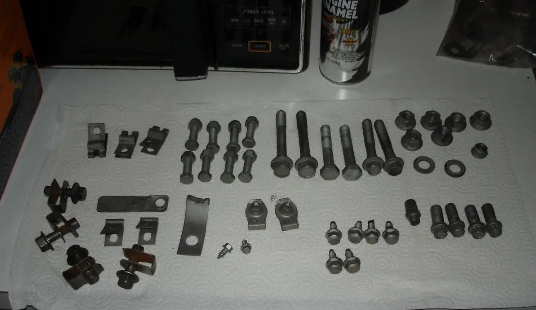

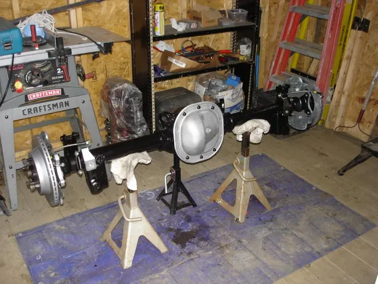

Got the hardware sandblasted. Tomorrow i'll prep and paint it up and then start installing the axles and brakes and stuff.
Today is my bday, so hopefully i'll score some cash for more goodies :)
Leave the drain plug out while filling(only option you have if you don't have an aftermarket cover with a fill plug). Fill the case until the fluid starts flowing out of the drain plug(squirt in the friction modifier first). Allow fluid to drain until it about stops. The fluid should be level with the lower(bottom) threads on the drain plug.

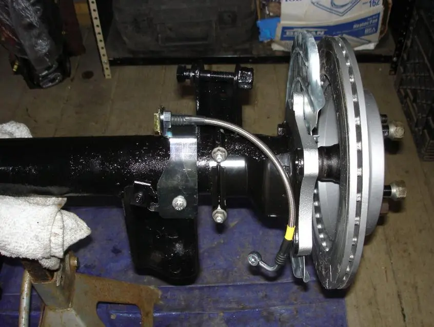

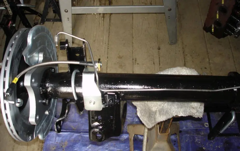

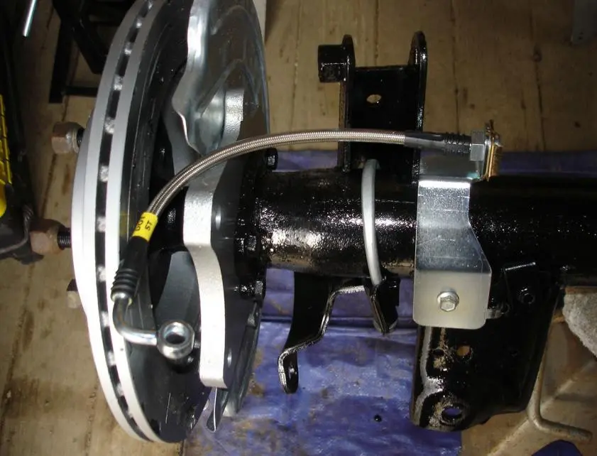

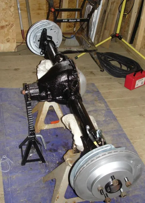

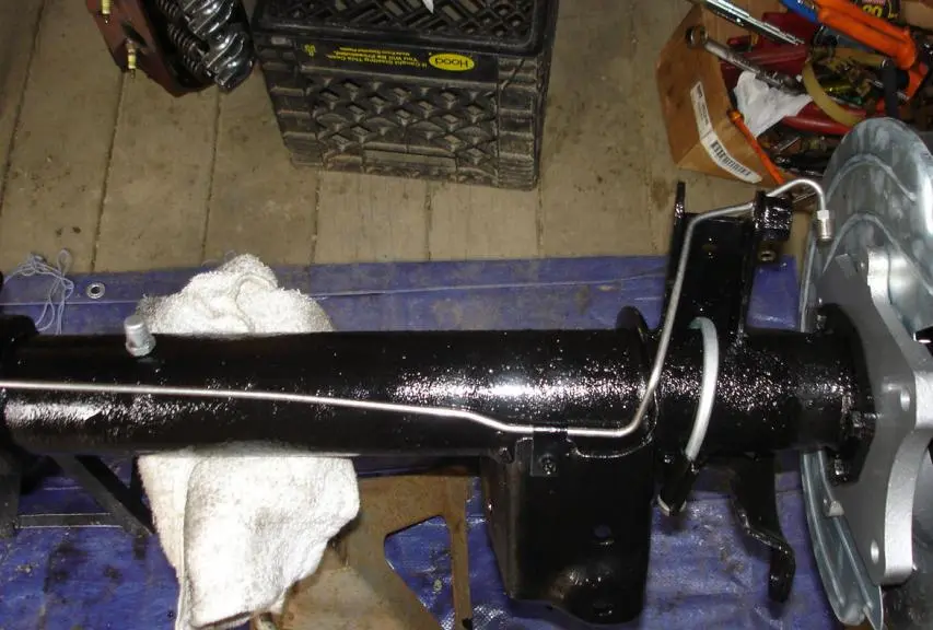

Got a good chunk done today.
Brakes and axles in. I need new caliper U-braces since my old ones siezed and I had to trash them. As soon as i find a pair i'll be putting the calipers on.
Couple shots of the MM SS brake lines.
I just need to put the calipers on, install the brake hard lines and center lines and get my girdle and it's done!
BTW...the ripply stuff on the rotor is the electrical tape i used to mask it. When i'm ready to install I'll take it off.
EDIT: I will be getting a girdle. I just painted the stock cover because i didn't want to see a crappy part on all my nice new stuff :)

Here's my first problem. I bought these off a guy who said they were for a '93 Cobra. I figured they would be the same as the 94-95 brake lines. I guess not.
Anyone know what these are for? I dunno if i should sell them off, or just get a tubing bender and reshape them to work for me. :shrug:
