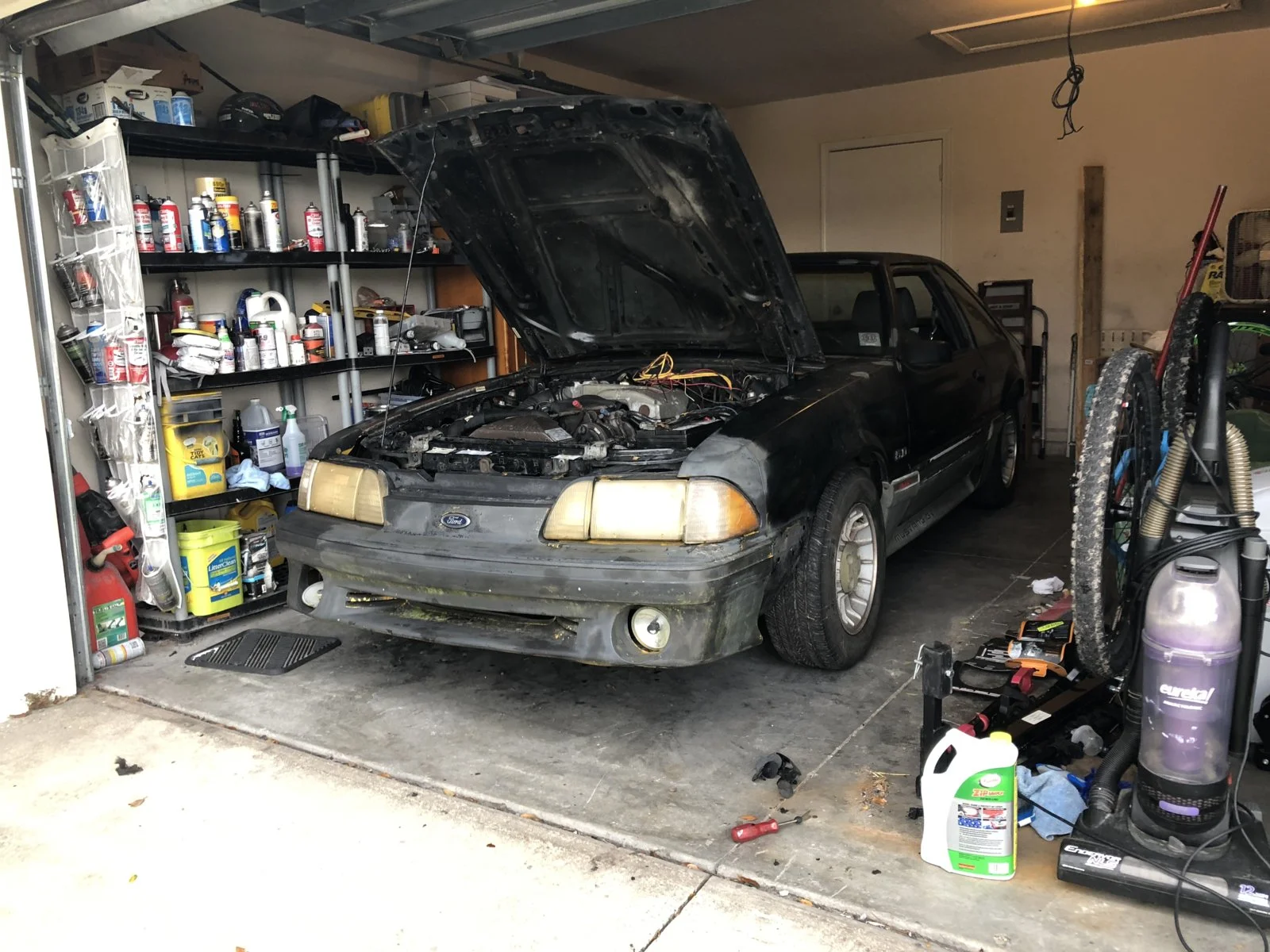

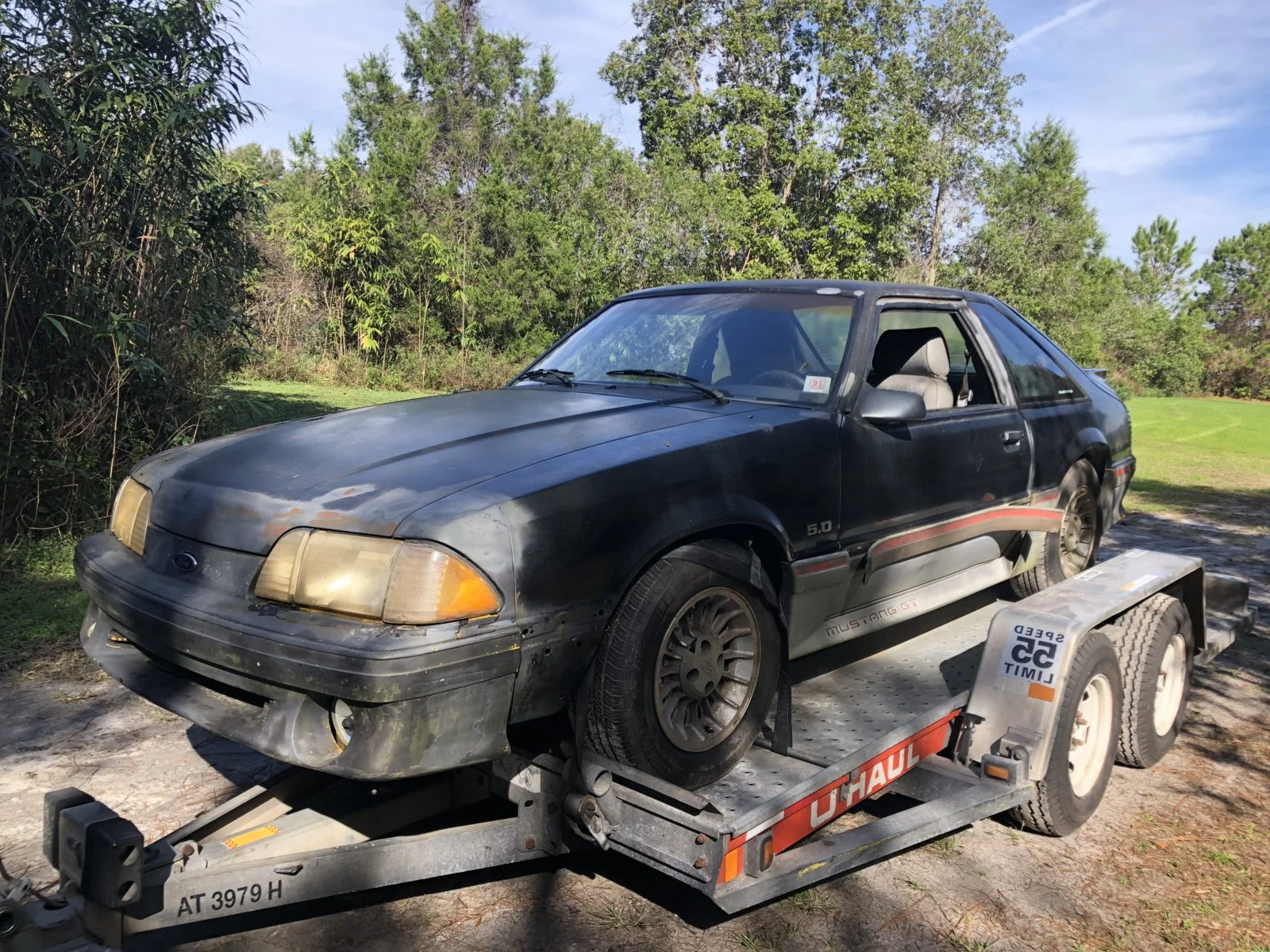

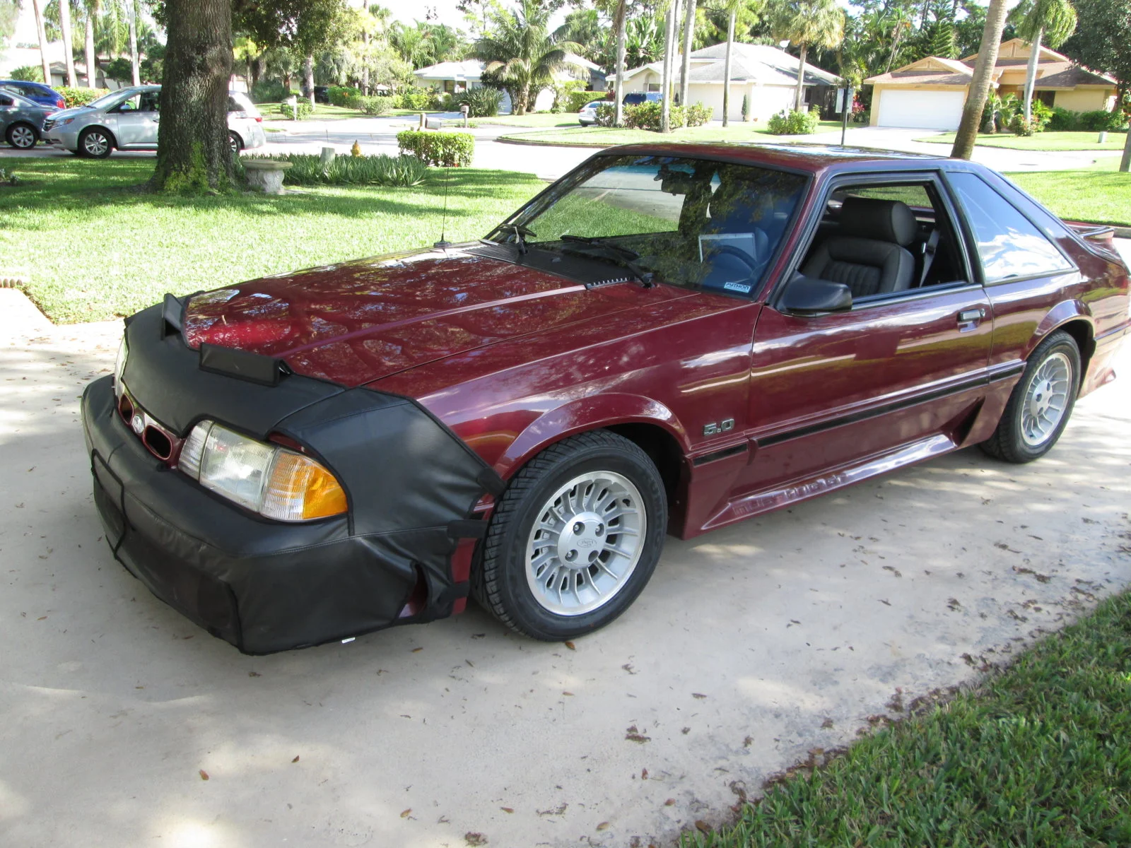

Picked up this GT about a month ago and just got around to posting the build. It’s a 5 speed. Ran and drove, but I’ve taken out the motor and gone through it. After I removed the heads, there wasn’t even a carbon ring in the cylinders!

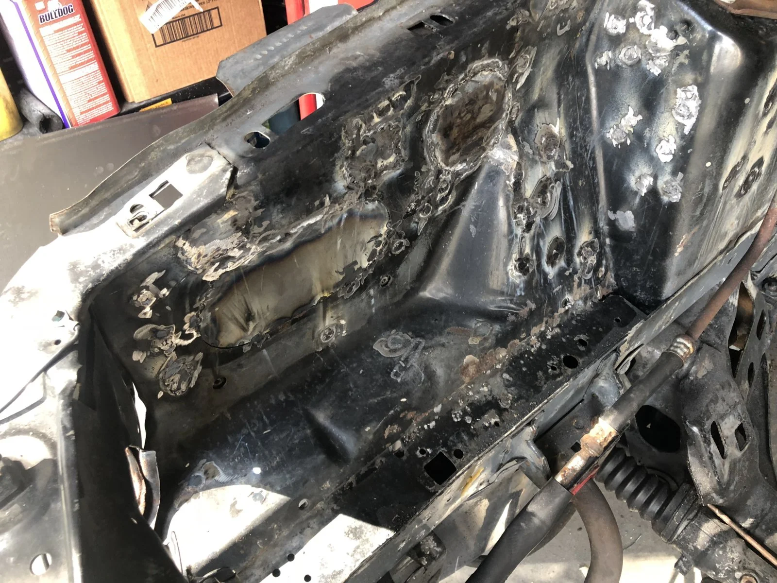

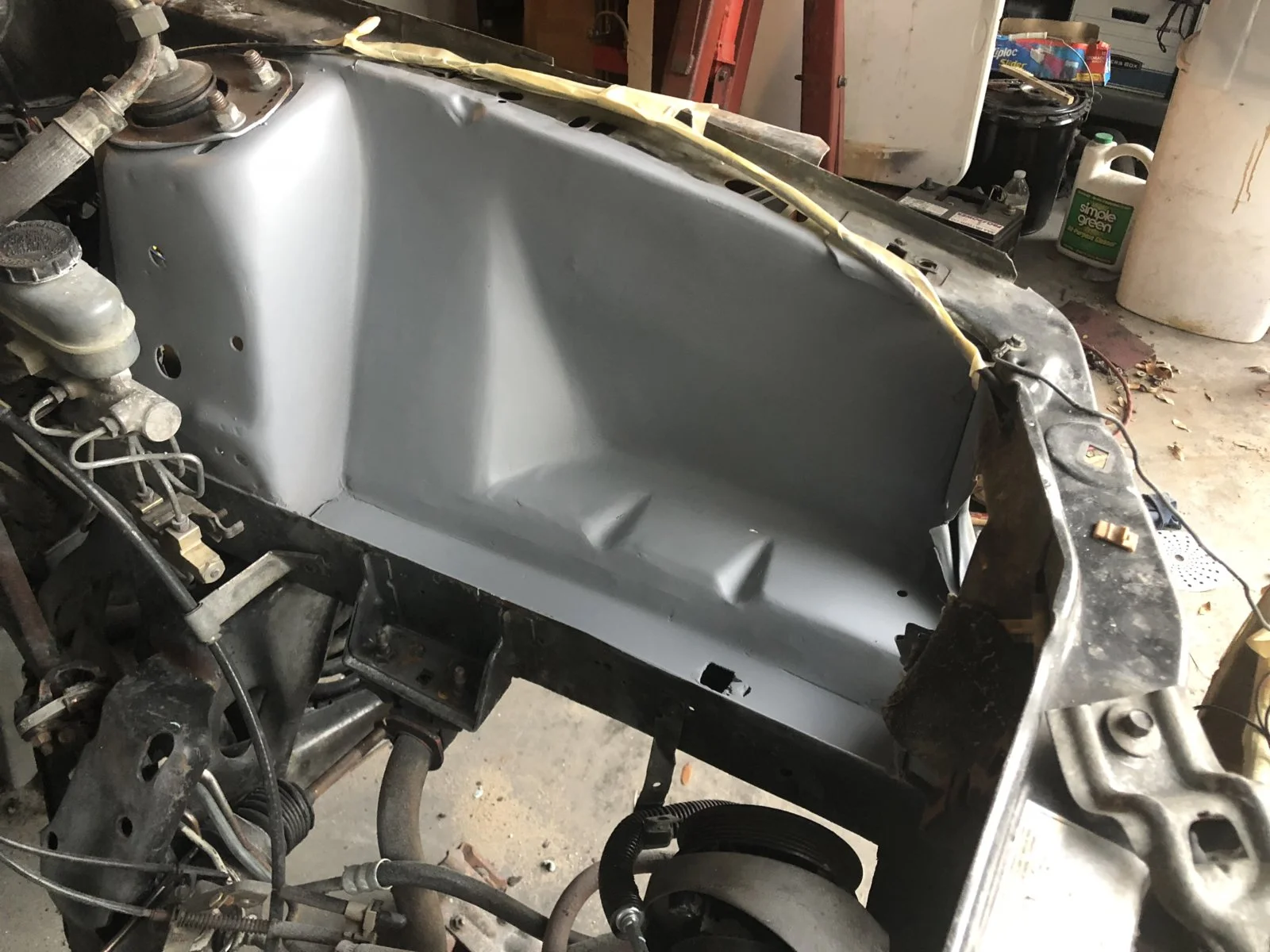

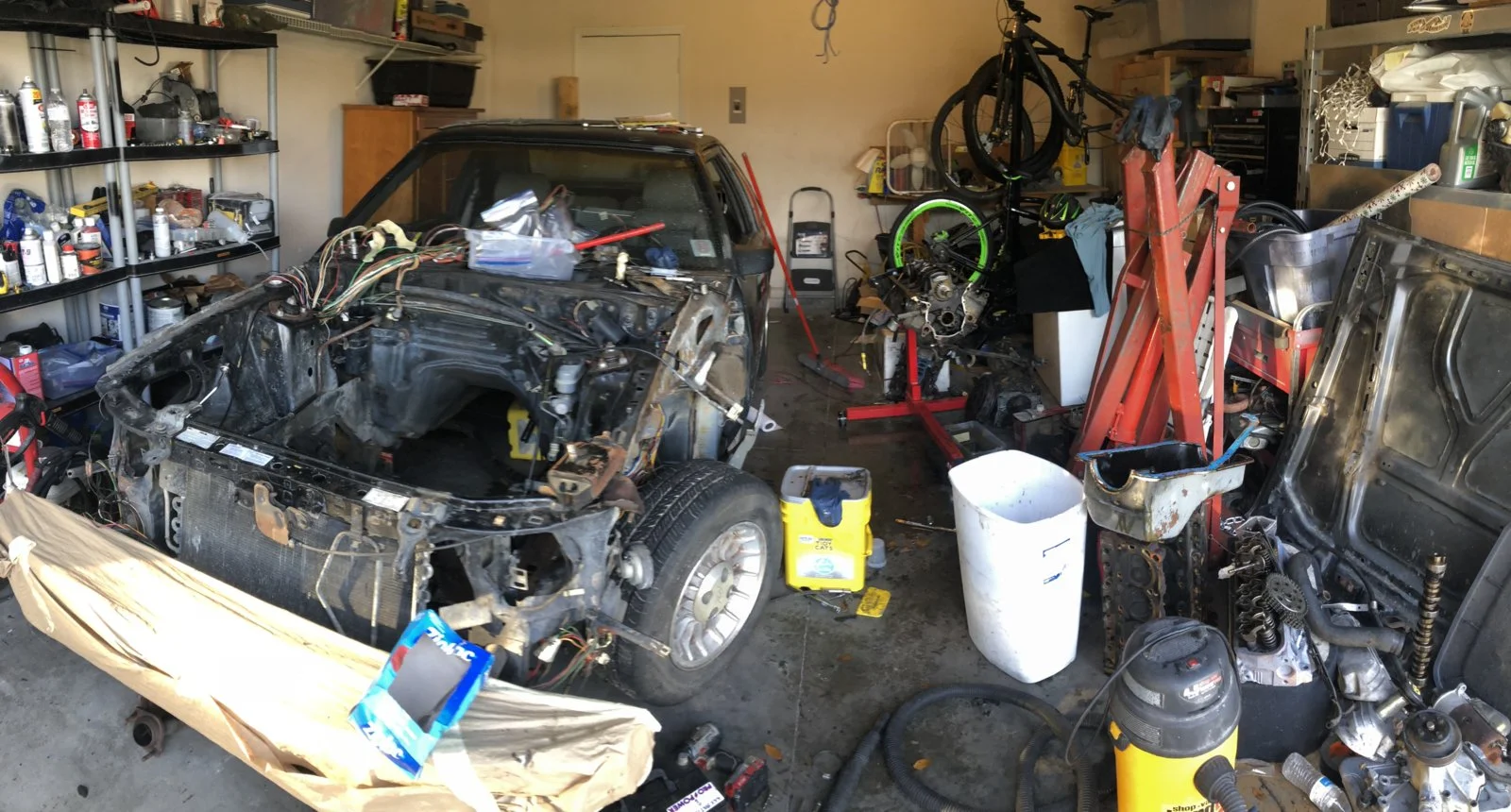

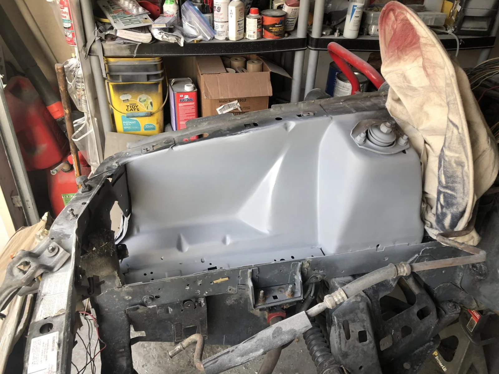

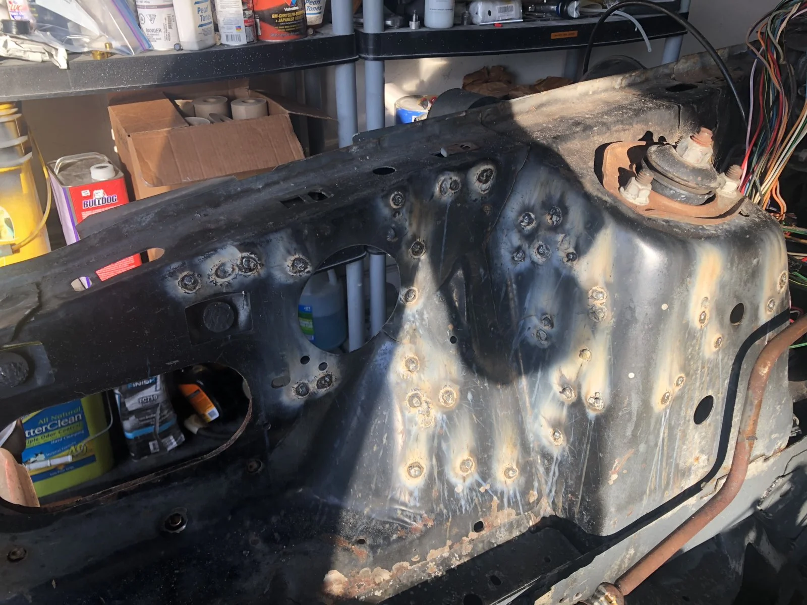

I’m welding up the engine bay and tucking the wires.

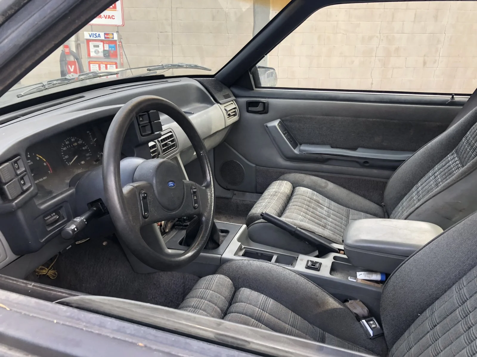

Driver seat has a small tear that I’d like to find a solution to...

Thanks y’all. I will post pics as things progress. Grinding is going slow. Note to self - learn to tig weld so there is less grinding.

Driver’s side is going slower. Spent a couple hours on it and still need an hour or 2 to get it where I want it. At least the passenger side is done. Still not sure what I should use for a new brake booster and master cylinder.
Plugging holes is easy if you put something brass behind it. Weld doesn’t stick to the brass. I picked up my Lincoln 135 mig in the box for just $350 and it does more than I’ll need. Watch some YouTube videos and give it a go!

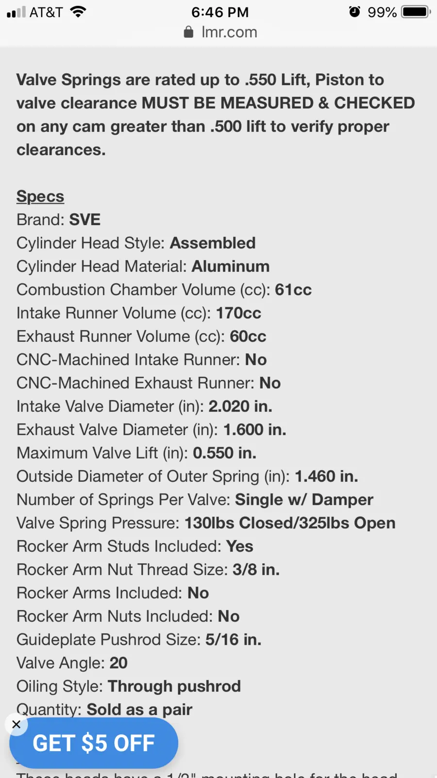

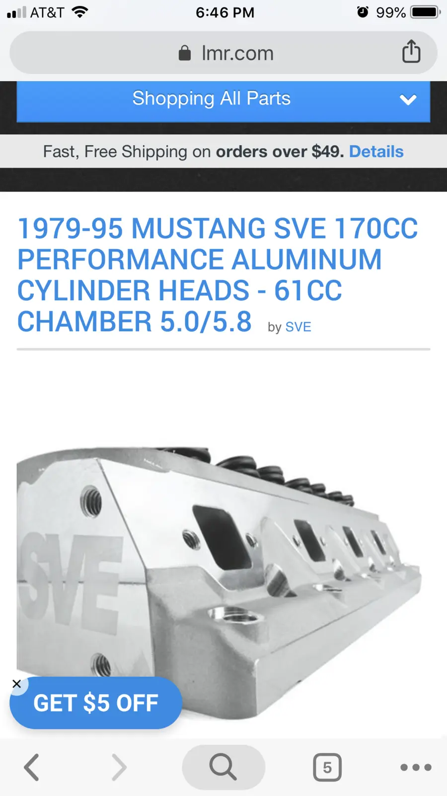

Sigsterrr, I note you mentioned that this engine has 2.02 intake valves in the aluminum heads. What brand and model heads? Also mentioned is the TF Stage 1 camshaft. It has roller rockers but you do not mention the ratio, 1.6 or 1.7. Is this a stock bottom end withthe original pistons or do they look like they were cut or perhaps replaced at one time? I really would be inetested in how the valve clearance was achieved in the setup. It would be GREAT if this combo worked without mods, cam straight up and stock pistons.

JimZim, I went with the lmr aluminum heads I think sve? List around $900 and I got on save for like $810. I went with 1.6 rollers. 89 has forged flycut pistons and the cam is under a .500 lift so it should all work together. Should.

Sigsterrr, Hey, thanks for the quick reply. You have lot of neat goodies that should make for a great engine build. I am really interested in the clearance. Will youe be checking it on one cylinder to play it safe. Keep us informed and hope all works out well for you.
Thanks. The only reason I had time to work on it today was because I had a crash on my mountain bike today, so cut my ride short. I am excited to finally be going forward on it instead of just taking old parts off. And the reason I went with those heads was the flow and I was pissed I bought a pair of real gt40 heads and one is cracked.
