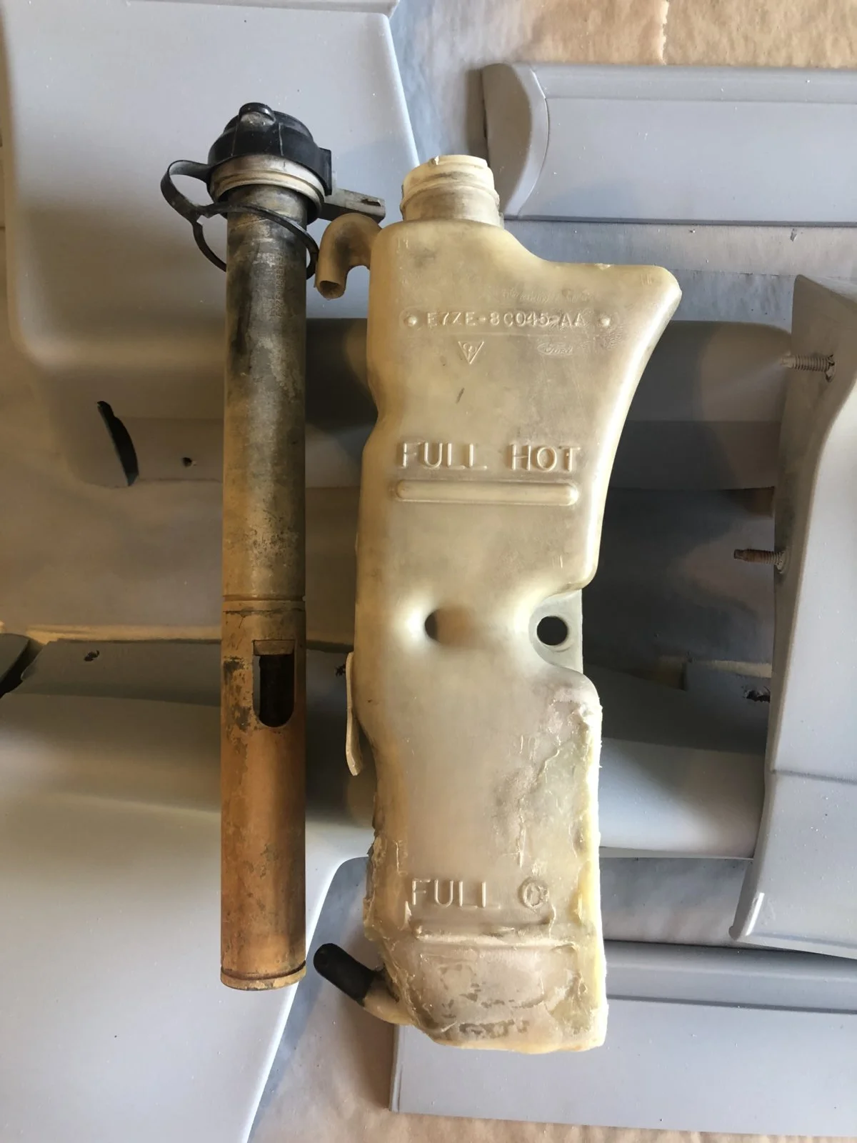

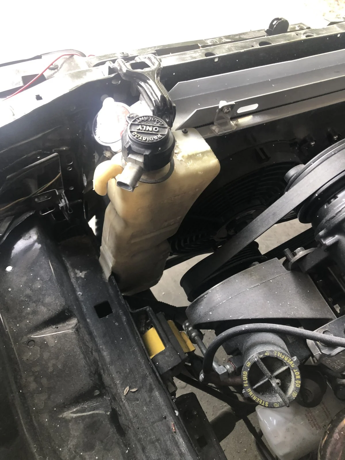

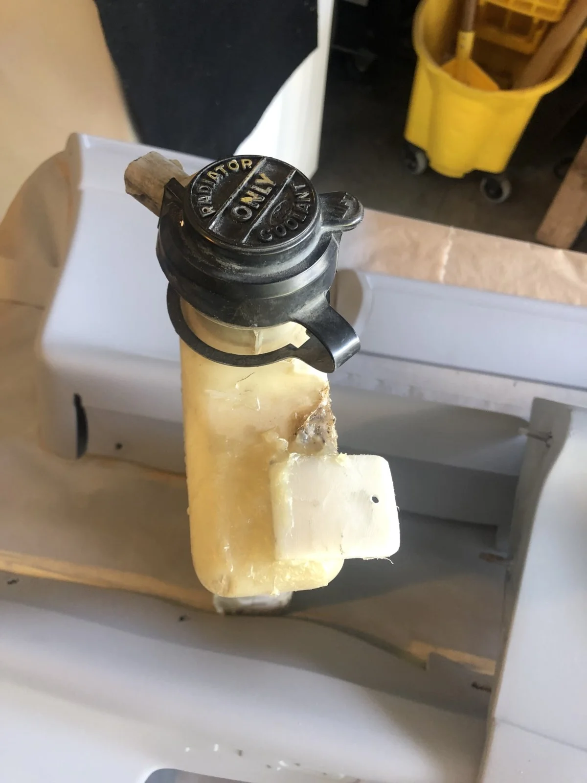

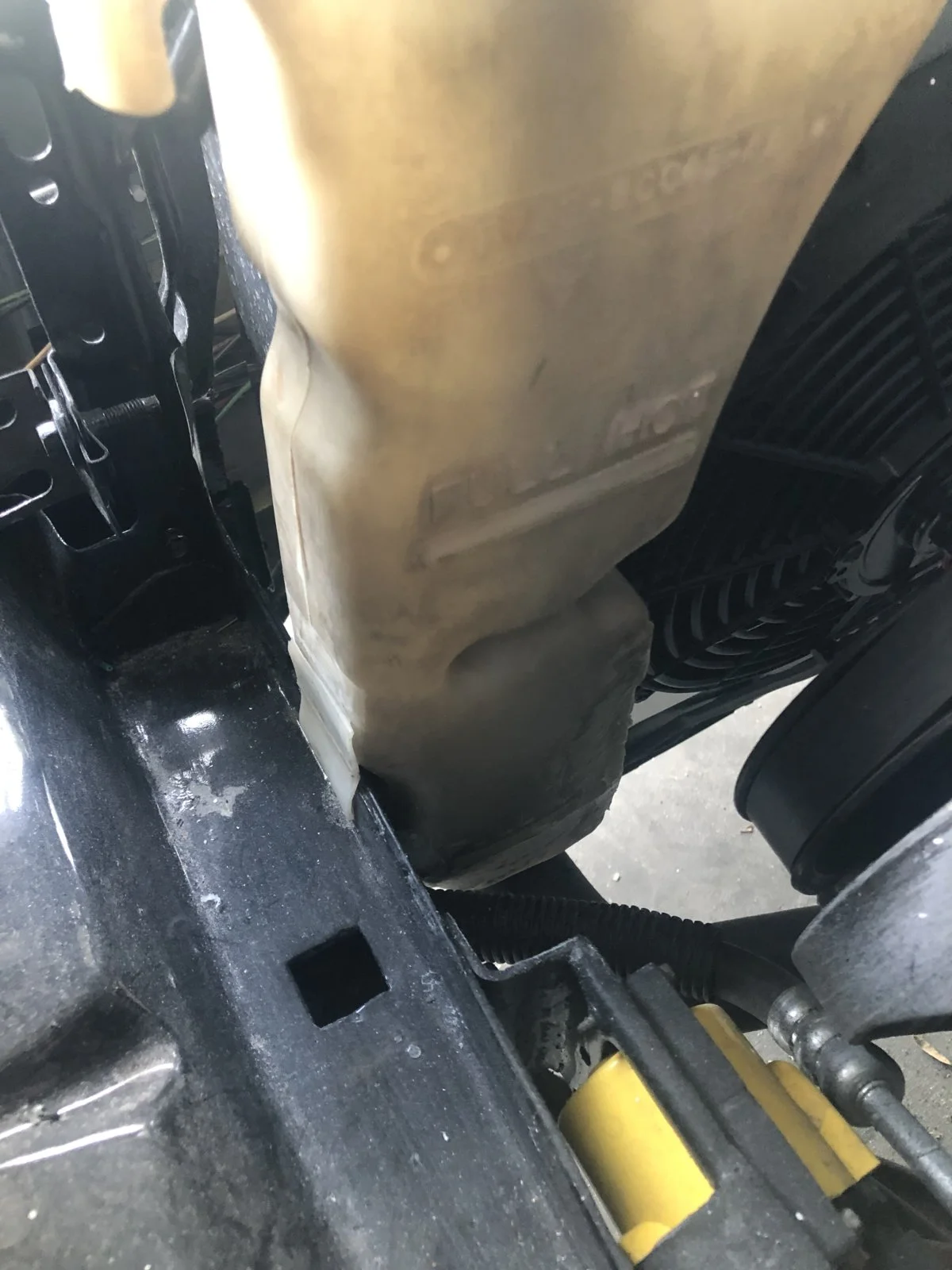

So I’ve been working on and off on the radiator overflow reservoir. I wanted to keep a stock appearance, so I’ve modified the original one and added 2 brackets. The top one mounts to the fan shroud and the other hooks on to the frame rail like the original one did. It all clears the hood too. Just need to coat the outside leaving a line to see fluid levels. What do y’all think?

I like anything that looks stock, but isn’t. So I say good job!! ( but I do like the custom look too)

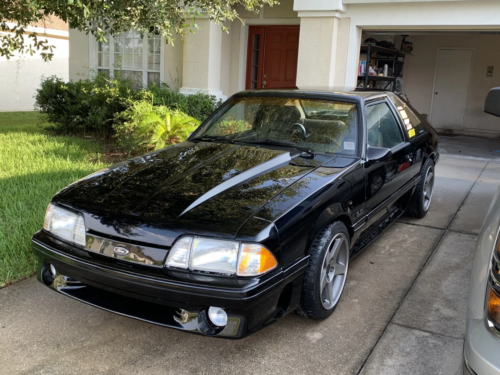

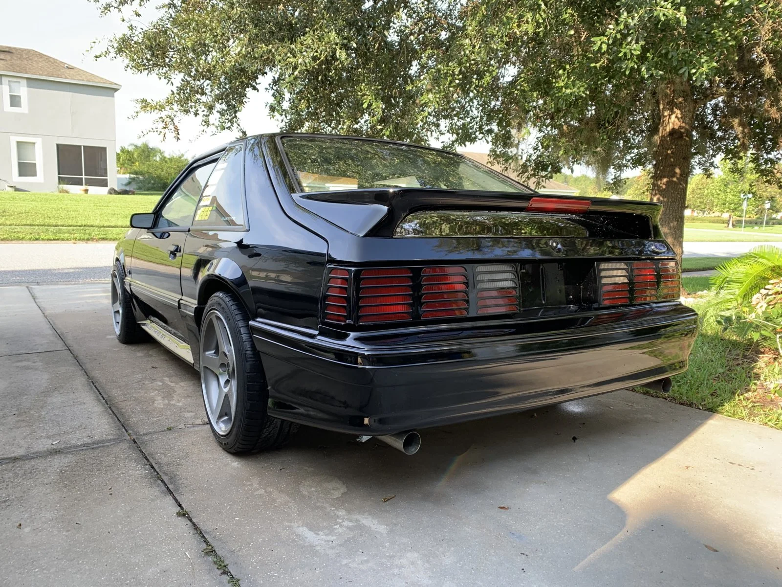

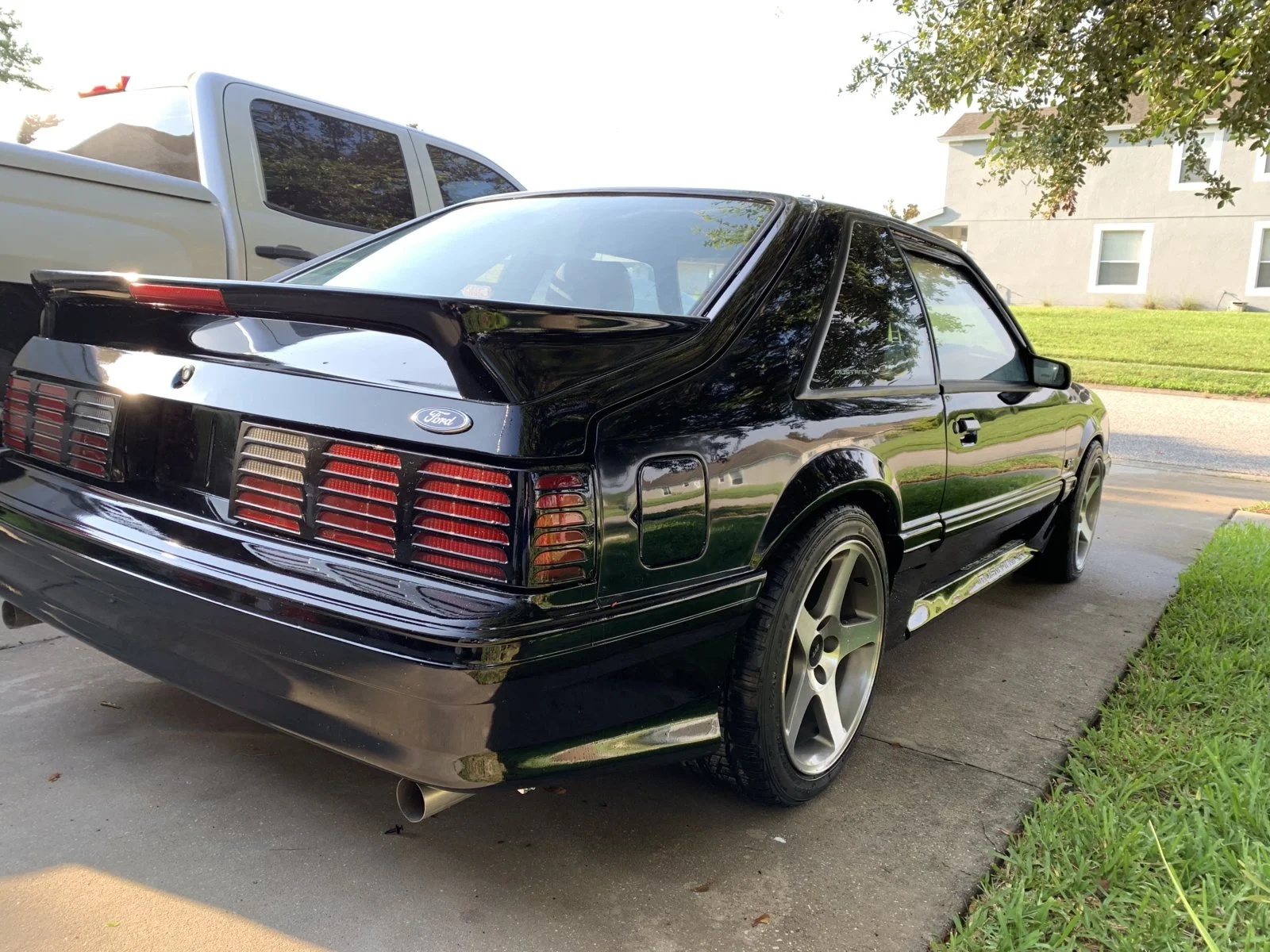

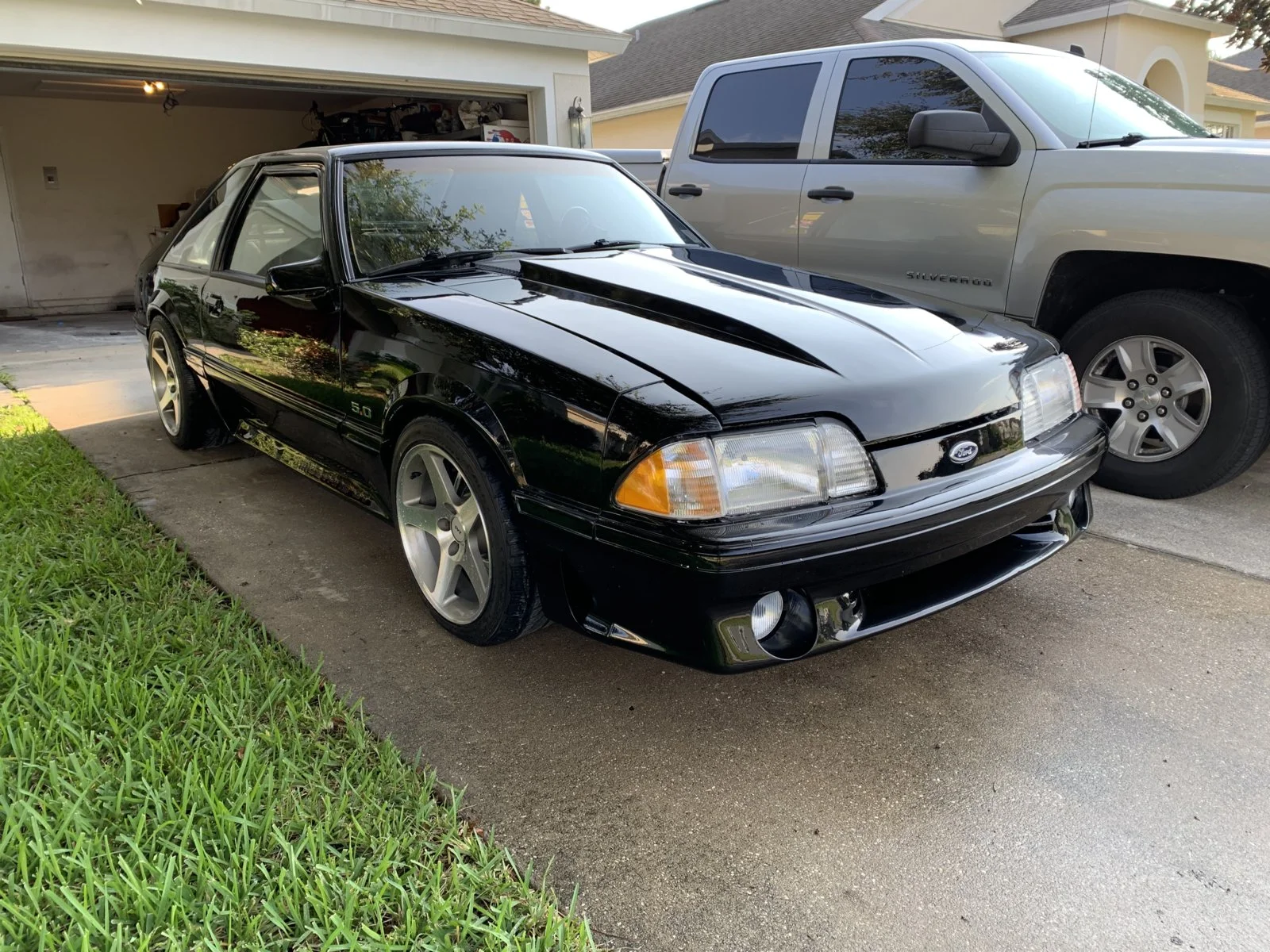

Well, it has taken almost 7 months and it’s almost finished. First stage of buffing done. A few odds and ends, like raising the h-pipe somehow, replacing the windshield and put in a few ground effect screws. Oh and fix my taillight corner since I dropped it.
The bumper isn’t tightened down yet so there’s a gap. Also need to lower the hood adjustment bumper slightly. So much work to get the hood flat. I would buy one new next time probably.
631068
631069
Here you can better see how I moved the taillights out 1/4” to sit flush with the outside of the body. I think it looks cleaner.
631070
Still have to wet sand the bumpers.
631071

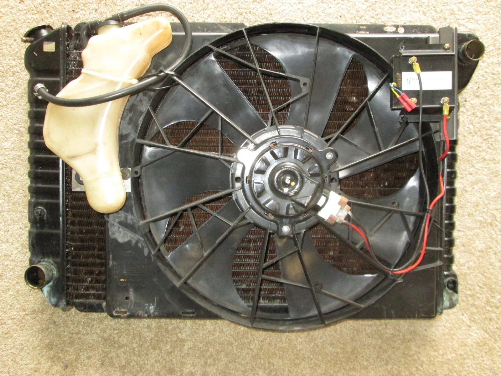

...I have a hole in my overflow and looking for something different that isnt going to cost me $45 bucks .
$33.99
or $34.99 if you want to keep the sensor, which never works for very long.
My new one is still sitting in a box. Found a better one in a JY for $1.
It was from a Toyota.
