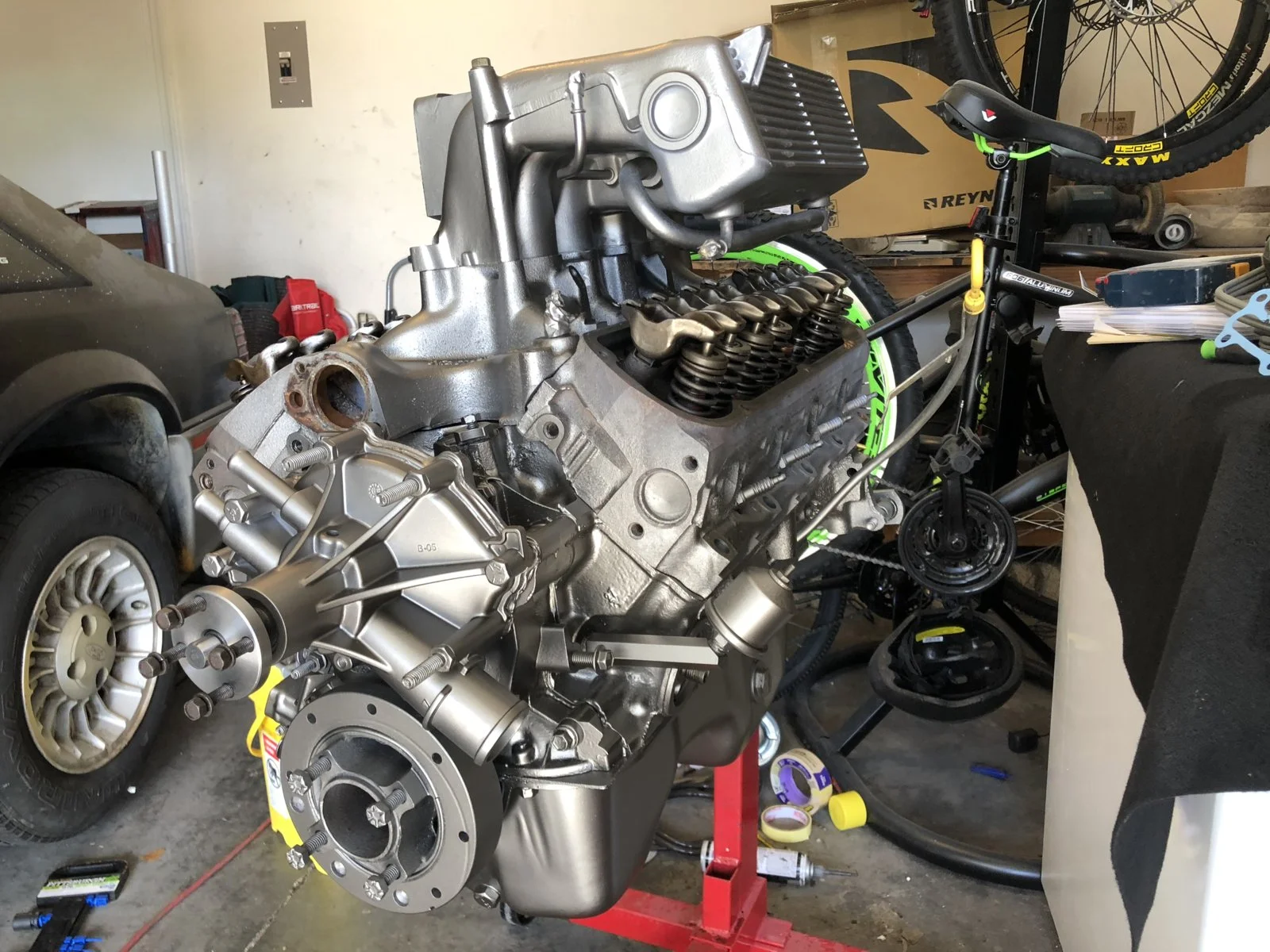

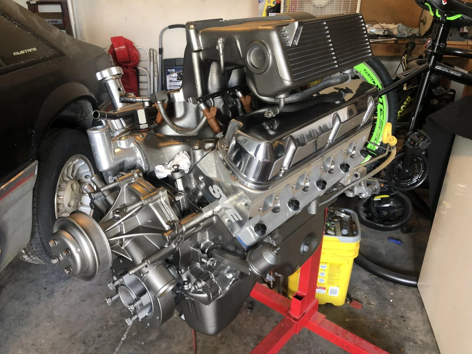

So I settled on a color for the engine and all accessories. It’s a Ford/Lincoln color “Luxe Metallic” and the code is H6. I like it much better than the silver I originally shot it. It will have a sort of satin finish. The heads are just a stock one and a gt40 one. If you know anyone in the tampa,Florida area I’ll give them the gt40 heads. One is cracked. I’ll be throwing them in the trash can. Already have one stock head in the trash for pickup Sunday. I can’t throw them all away at once. Anyways, I can now take off the intake and heads and finish the motor soon. Can’t wait to see the SVE 2.02 heads on there.
Side note, do I really need an egr plate since I’m deleting the egr? The one from the stock intake was stuck on.

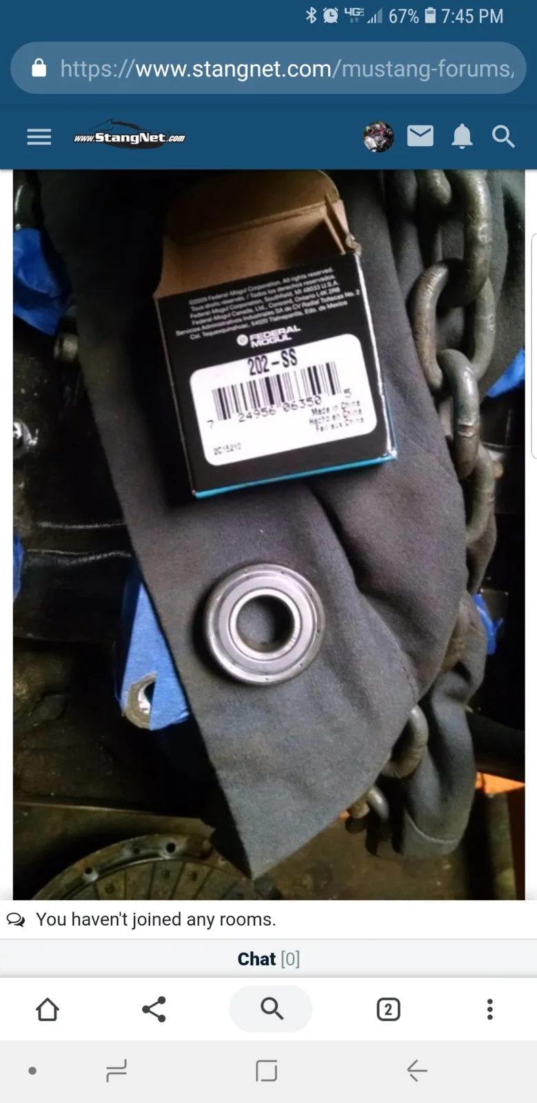

So I cleaned my T5 and was excited to put my steel input shaft sleeve only to find it didn’t fit right. Then I looked up the tag and it was 1352194 which is for a 4 cylinder. Well that sucks. Now I have to find a suitable t5. Recommendations on a reasonable replacement? I’ll only be at 350-400 hp.
I have been running a 4 cylinder trans for years behind a 302, 347, and now my turbo 331. The zspec t5 didn't last but a couple months behind the 347 before the second gear dog teeth messed up. If you use the 4 cylinder t5 it should have a smaller input shaft end that goes in the pilot bearing. The pilot bearing needed is a federal mogul s202. They are available from any local parts store.

That's awesome then! Did you do anything to beef it up? And that part doesn't come up on a google search. I do want to replace it before I put it all back together.
This is the pilot bearing...the part number is 202- SS. This is the pilot bearing that goes in the back of the crank. The v8 t5 takes a different pilot bearing.

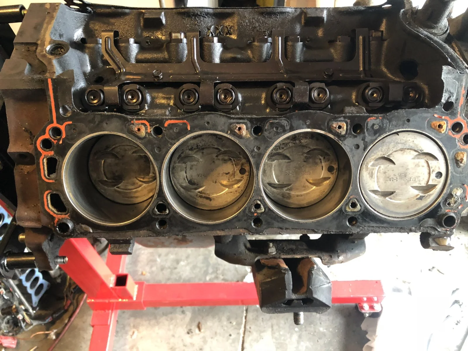

Looks like you got a lot done for certain. Did you install the Trick Flow camshaft and were you able to clay or check the valve clearance to the pistons with that camshaft and they new SVE heads with the 2.02" intake valves? Do you have a photo of the pistons in the engine?
