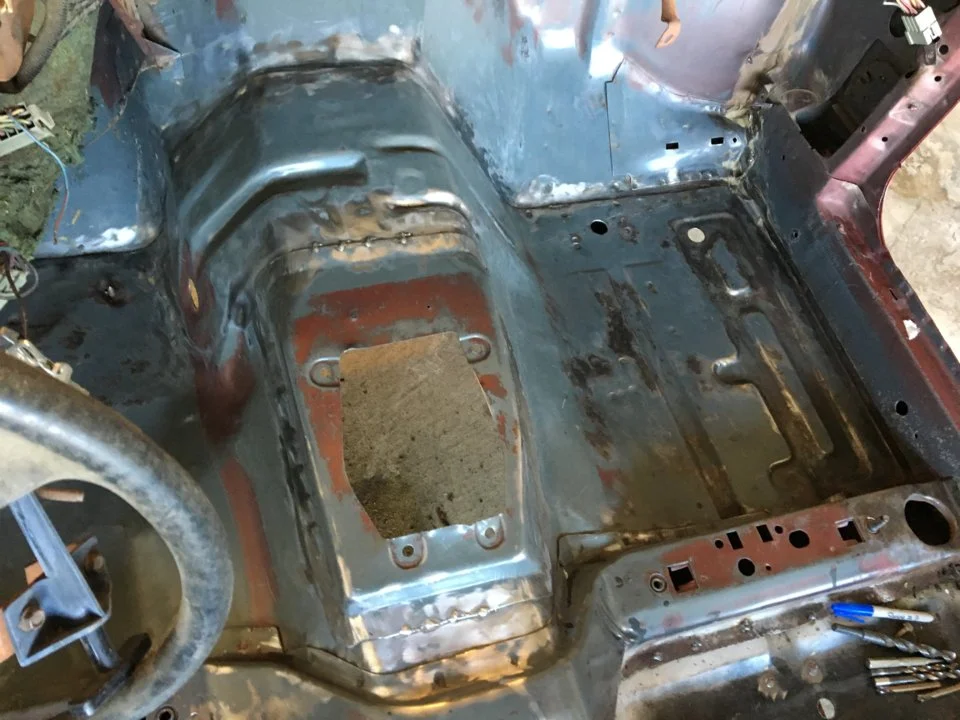

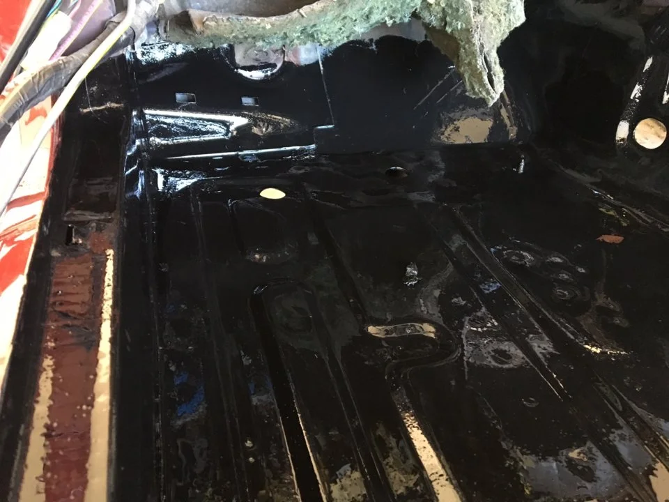

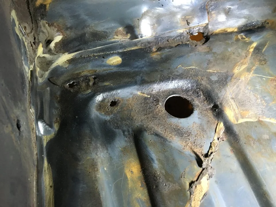

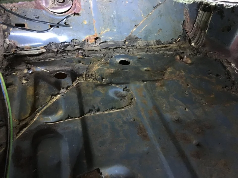

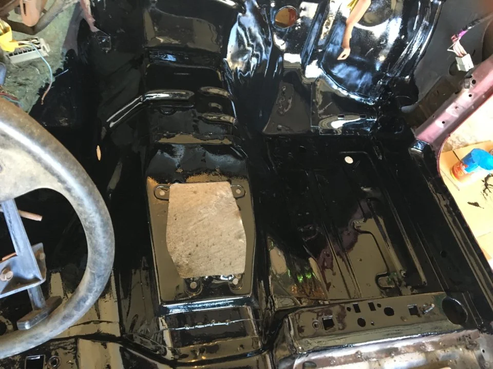

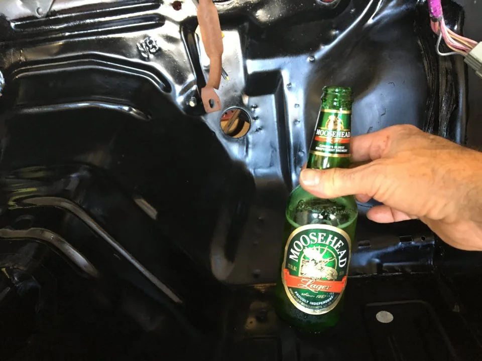

In spite of unwarranted accusations, here's what I actually did with the POR 15.
I finished taking out the factory seam sealer from around the front foot wells.
Proof of why I need to be doing this, there were several small holes rotted through on the driver's side. The largest was about the size of a quarter, and yet the seam sealer on it looked fine.
I welded those up and cleaned the surface rust in other areas and coated it with POR 15.
It ought to look pretty snazzy when I'm done with the white seam sealer outlining the panels, I forgot who it was that like the black and white theme....someone else with a thread.
Anyhow, pictures.
Reactions: 85rkyboby, A5literMan, FoxMustangLvr and 2 others

BTW, here's proof. So, whatever I'm doing with this beer and the POR 15, I'm doing it in the garage! @Noobz347
Reactions: 85rkyboby, 90sickfox, A5literMan and 4 others
