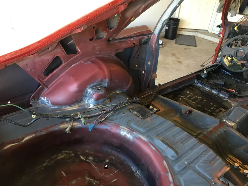

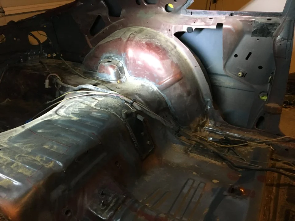

Well, got the wiring harness off and didn't break any clips! How do you like that? Still working on getting ready to POR 15 the interior

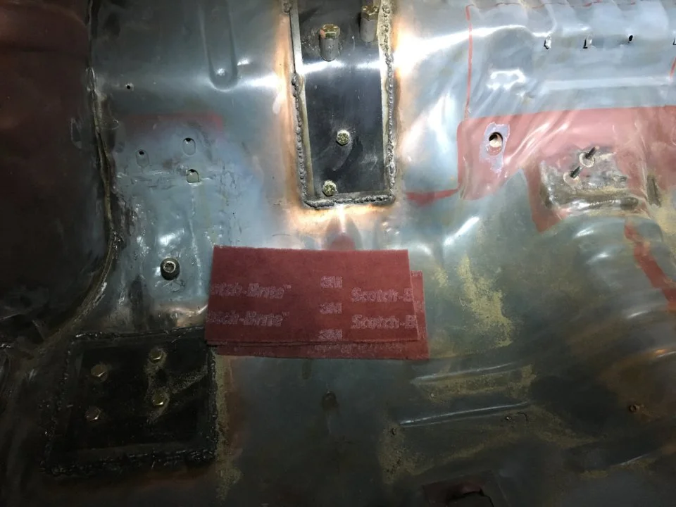

BTW, I'm using red scotchbrite pads to scuff the interior where it wasn't rusted to give the POR 15 Something to hold on to besides smooth e-coat.

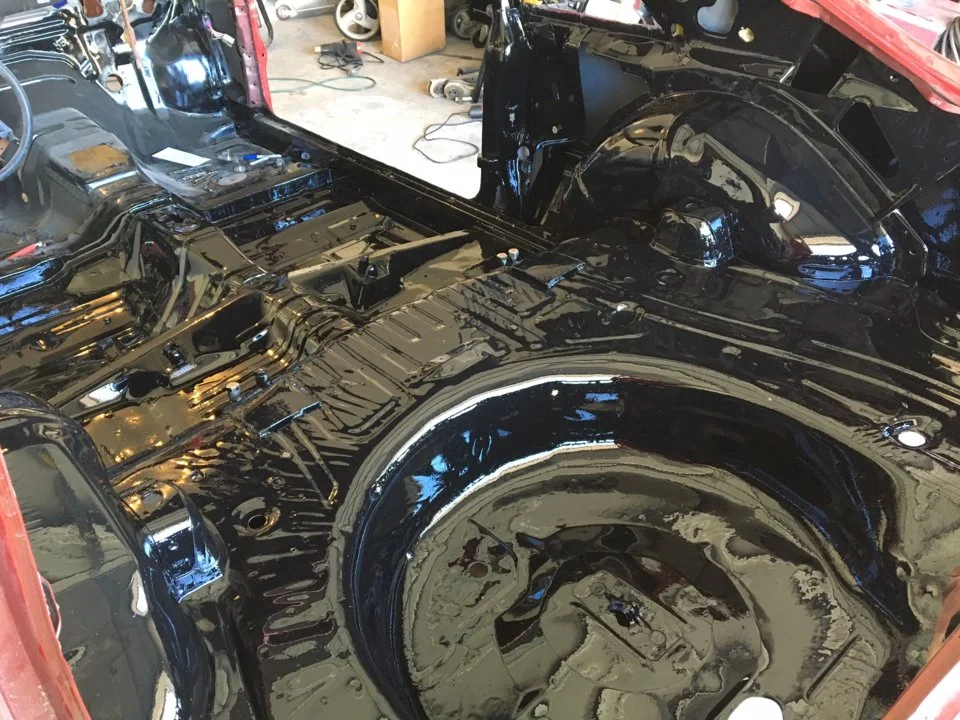

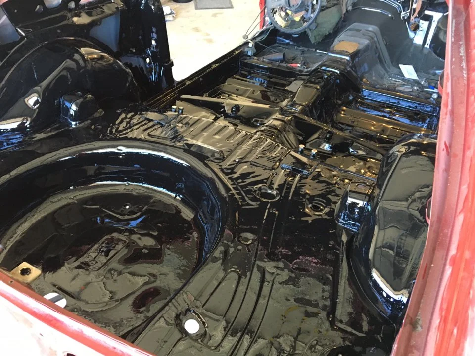

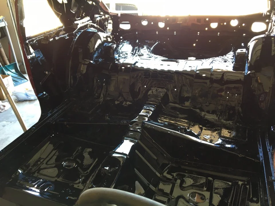

Here we go! I'm finished with the POR 15 for the interior! Yay! Go team Dave!
I decided to just take the wiring harness for the rear out to make life easier. Those clips with electrical tape holding them to the wires? It's not so good after thirty years. Easy fix, I actually keep enough rolls of electrical tape around to bind up all my children and hang them from the ceiling.
This is glossy POR 15 btw, my paint jobber at work gave it to me at no charge. Gift horse rode in, don't care if his teeth are shiny or not.

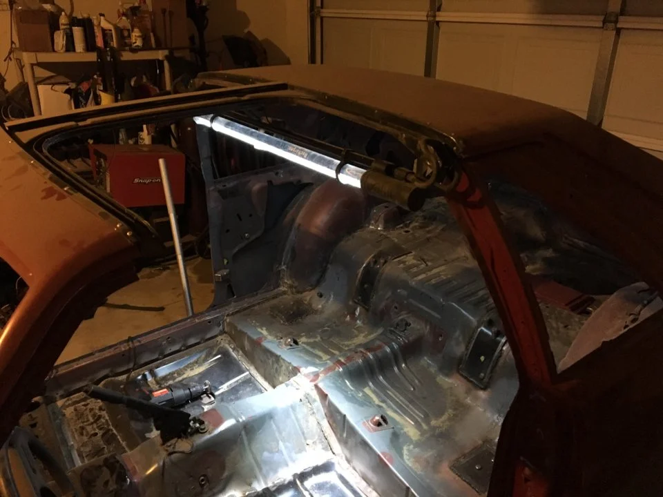

BTW, t-top brackets make a nice light holder!

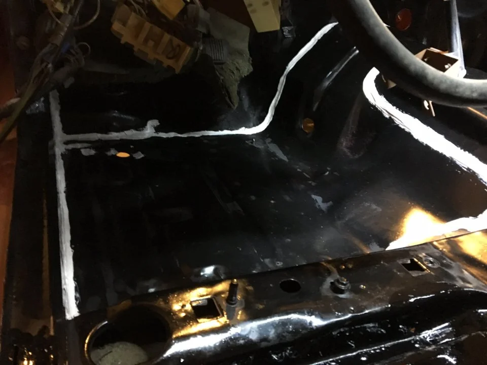

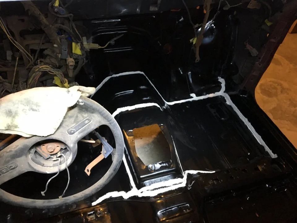

Snuck out to the garage before my wife woke up and did this. Just the front footwell area. I'll seam seal the rest next weekend when the POR 15 I put down yesterday is dry enough.
