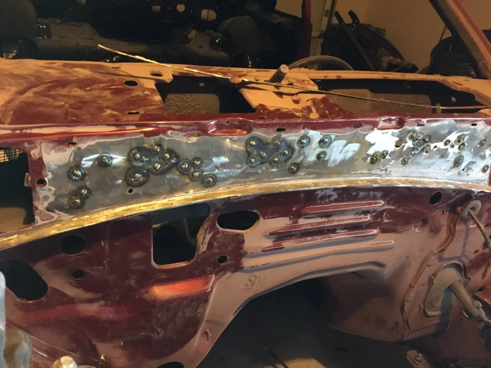

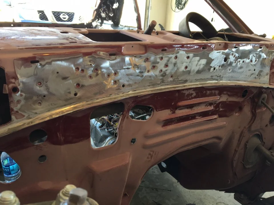

Alright then, I finally sucked up my being a wimp and went out and worked on the firewall. Here's pictures, so, before @madmike1157 :
Began to cut and grind:

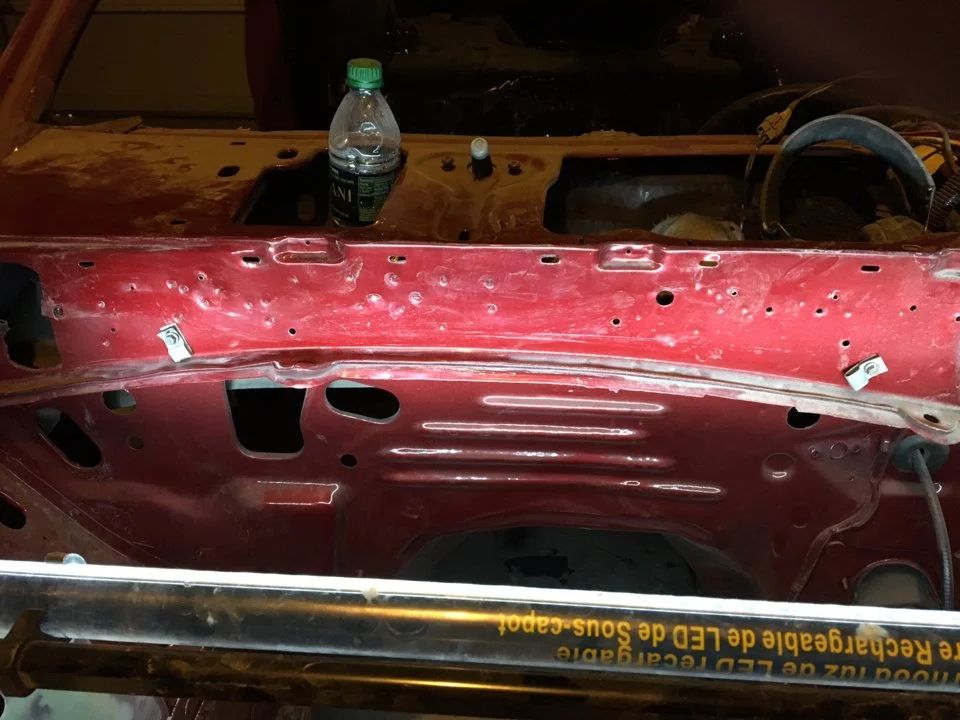

I cleaned out all of those little divots with my dremel, then I welded the holes and even welded into the divots because they were so deep:
You can see I left five holes, two for brake line brackets, two for the vacuum tree, and one for the wiper fluid hose.

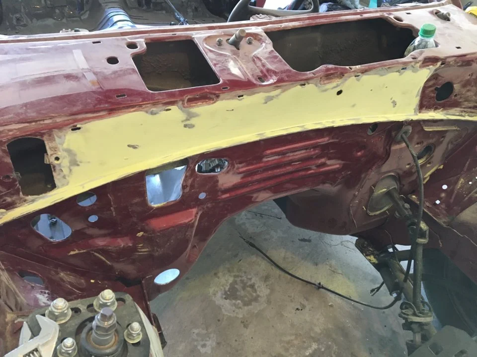

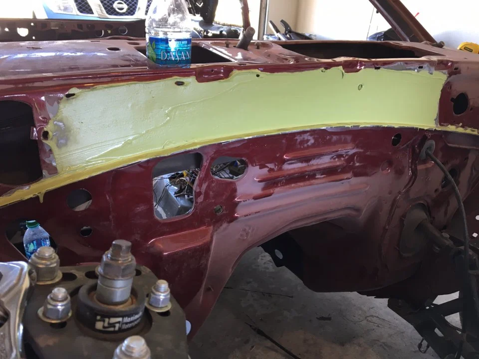

Ground the welds down and cleaned up the pinch weld seam. Then I spread some bondo, it blocked out MUCH smoother than I thought it was going to. It's actually close to being called straight!

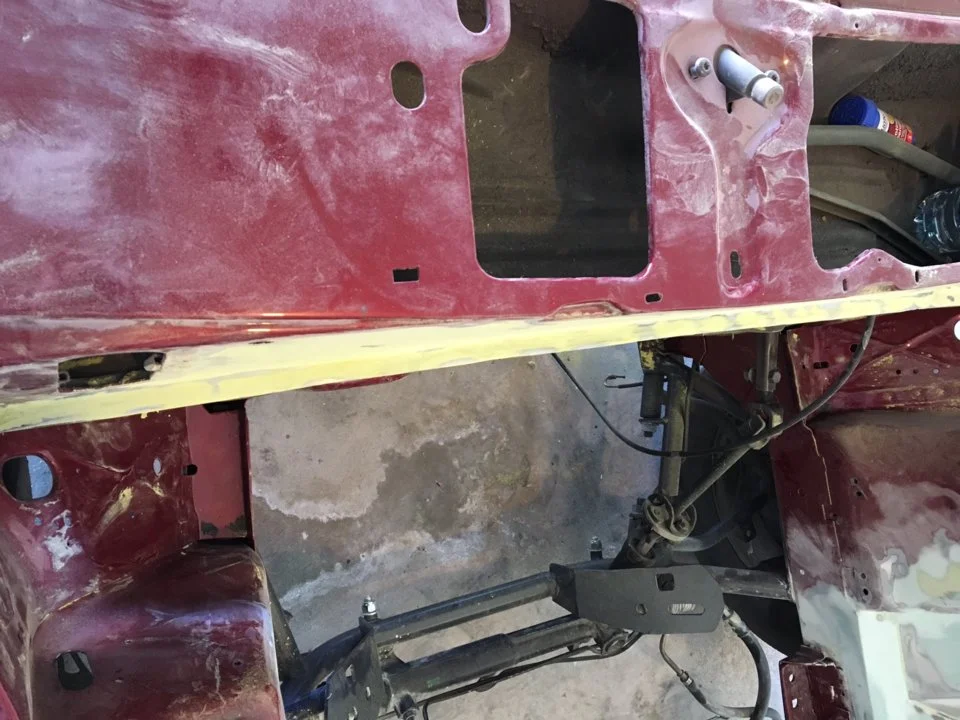

The seam is fairly straight as well:
So, tomorrow morning, gonna be 32* again, I'll just have to get cold. I'll glaze the firewall and finish the right side of the engine bay. This worked out ok then. I just wanted to be sure I primer the engine bay Monday night.
